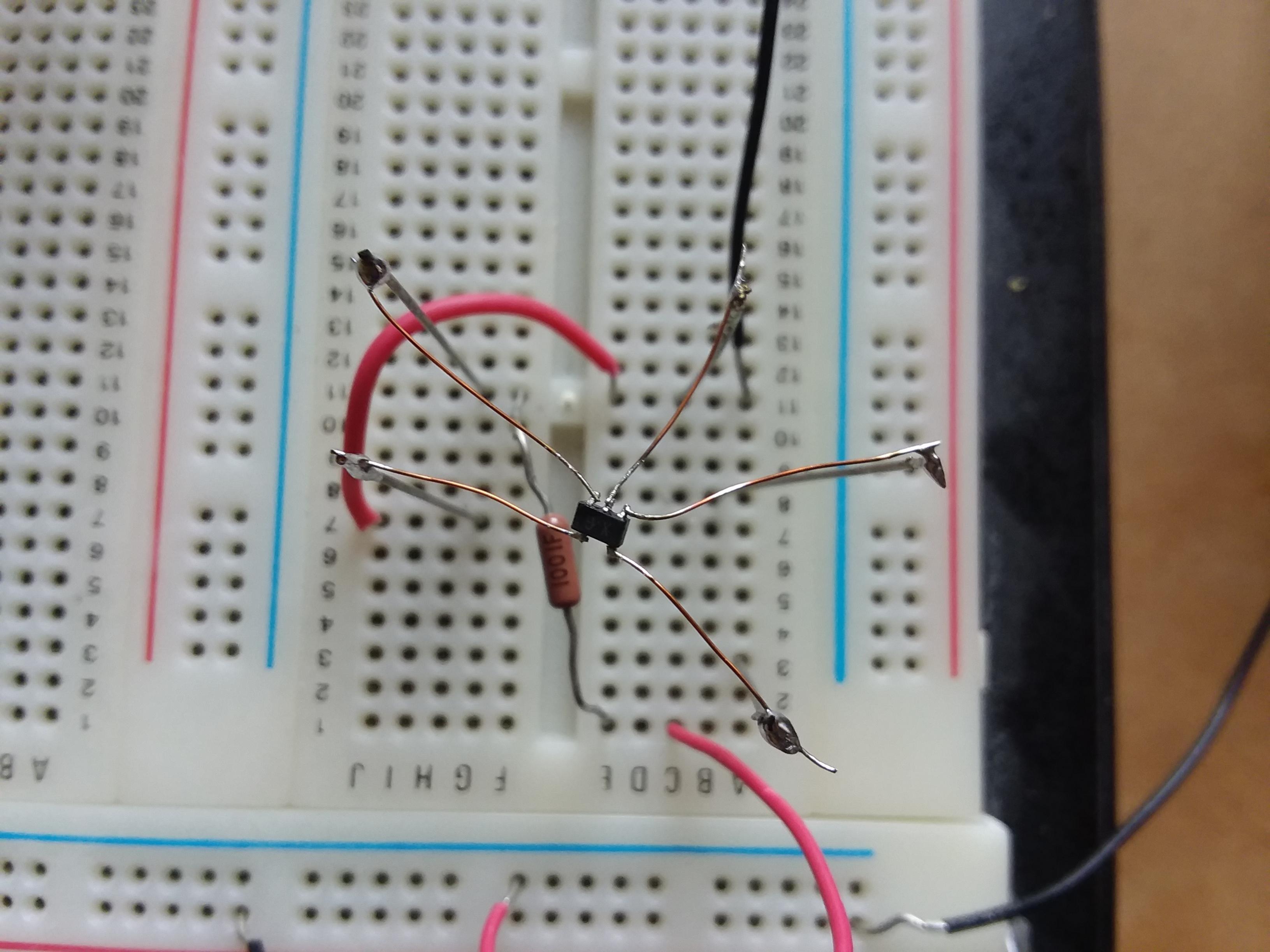

I was testing Idss of some 2sk2145, the dual version. I would have to find another way if I had many to do. Maybe some pads that the package can be pressed onto and take a reading.

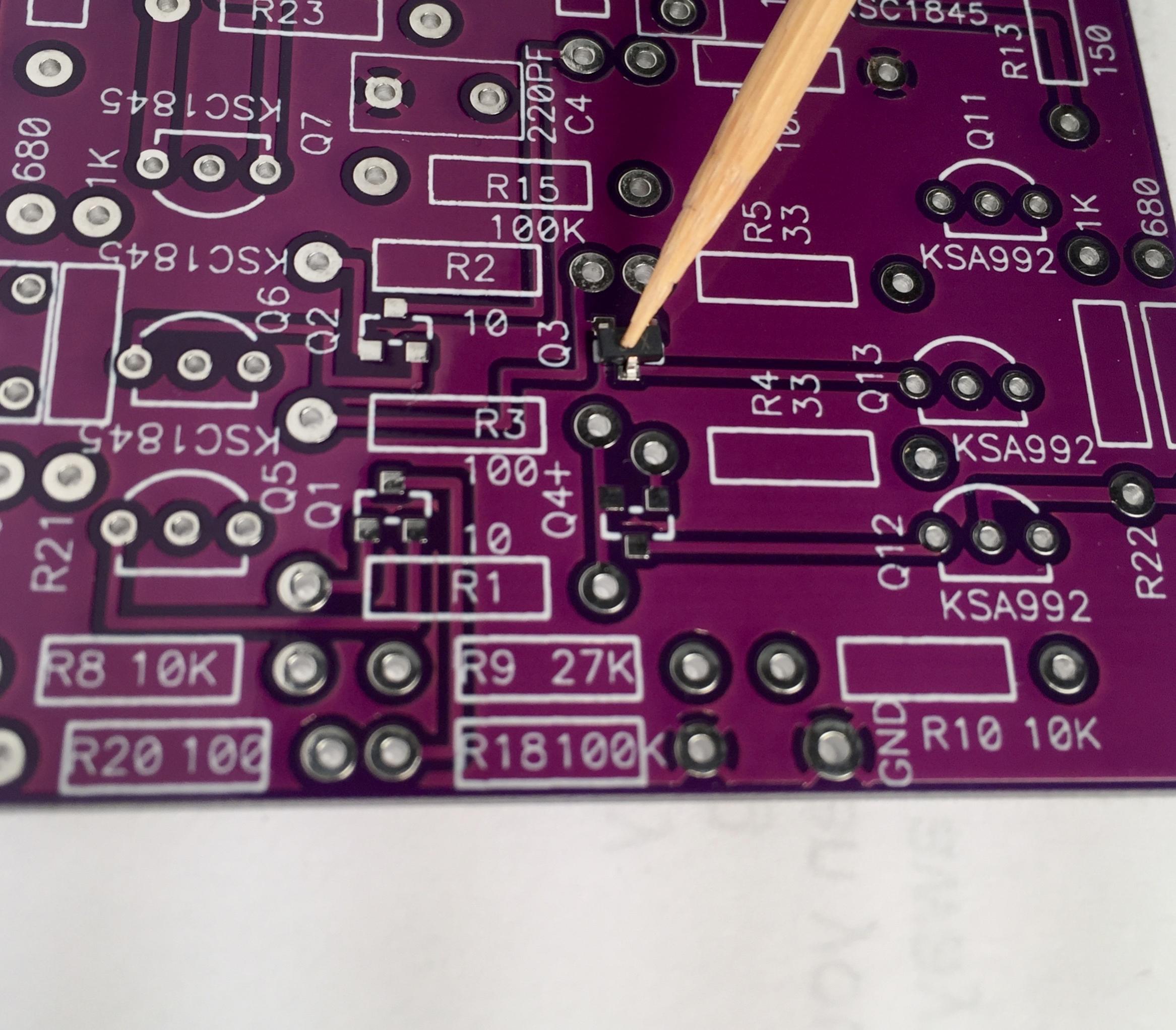

Put a small amount of solder on the pad then place the FET on top with enough pressure to hold it in place then heat the lead to melt the solder. Then like you said once the first is done the rest are easy.

BDP's suggestion of tinning a pad and getting one tab soldered is brilliant. I just soldered the K209's on my other set of boards (for the big outputs, I'll have photos and info in the next day or two) and it worked great! Once you've got one leg down and the device won't move around, the other 2 are super easy.
The good news with the SMD legs is because everything is so small the heat transfer is practically instant. Wear your good close-glasses, keep your iron's tip clean and be sparing with solder. It's not as hard as it looks.

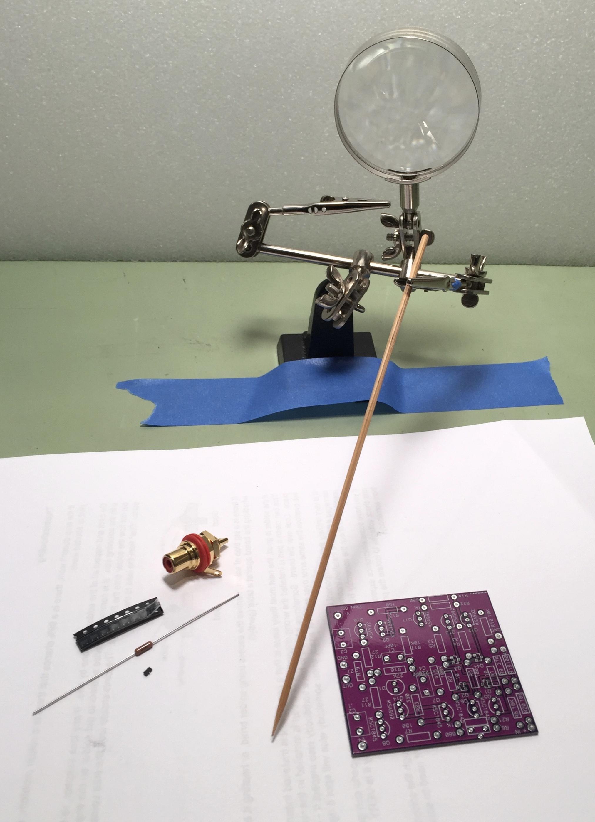

The super hack SMD station, made by someone who doesn't have any special tools for the job. The helping hands are taped to the bench so they don't move, the bamboo skewer is used to hold the teensy transistor in place while you solder the first leg. Tweeters (not photographed) or a small needle nose pliers are helpful for manipulating/moving the transistor.
attachment.php
Bamboo semiconductor retaining device, tapered actuating end shown.

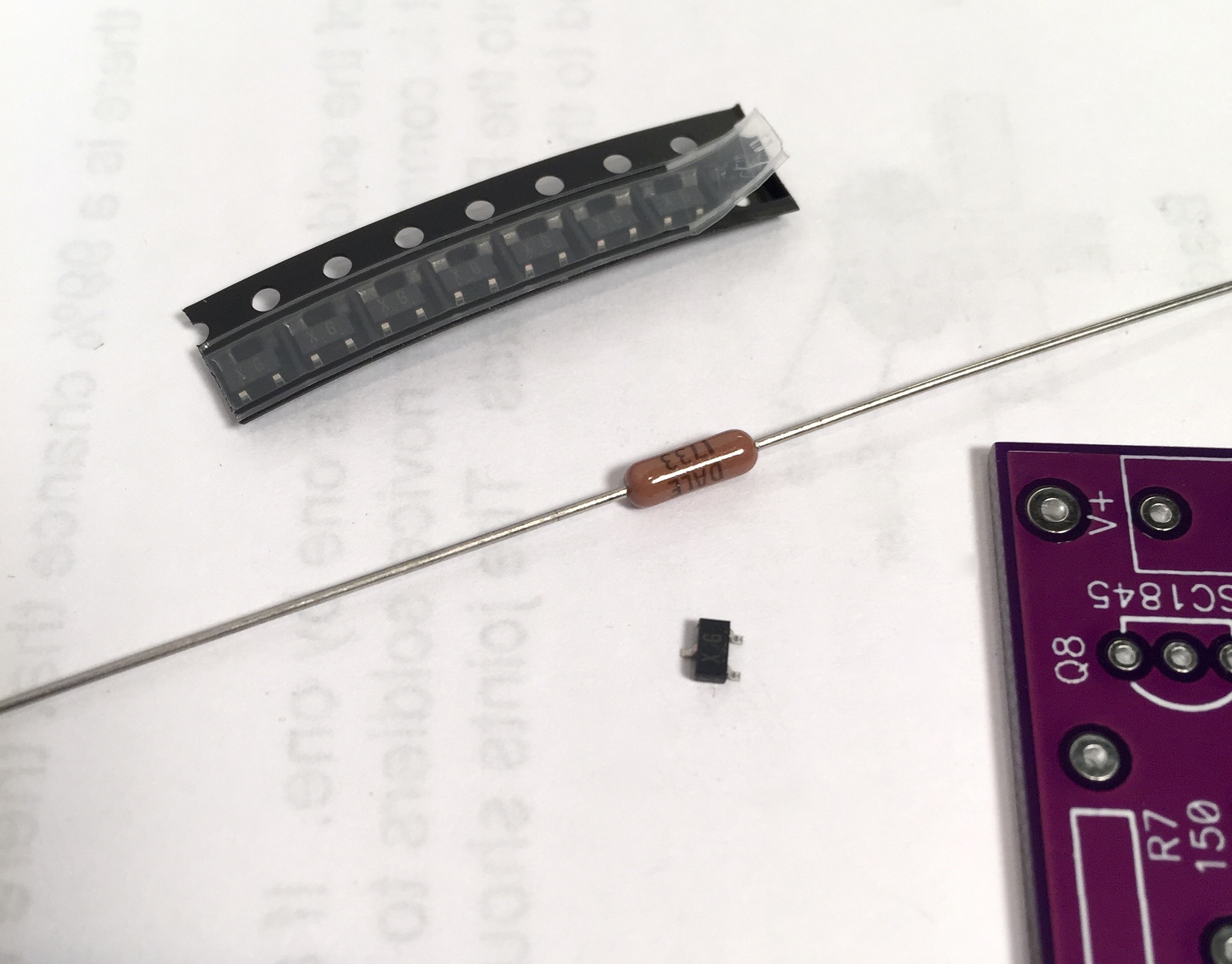

The standard 1/4w Dale resistors I like to use, shown for scale with the package of 8 shown above, and a single 2SK209 shown below. Don't sneeze. (Seriously) 🙂

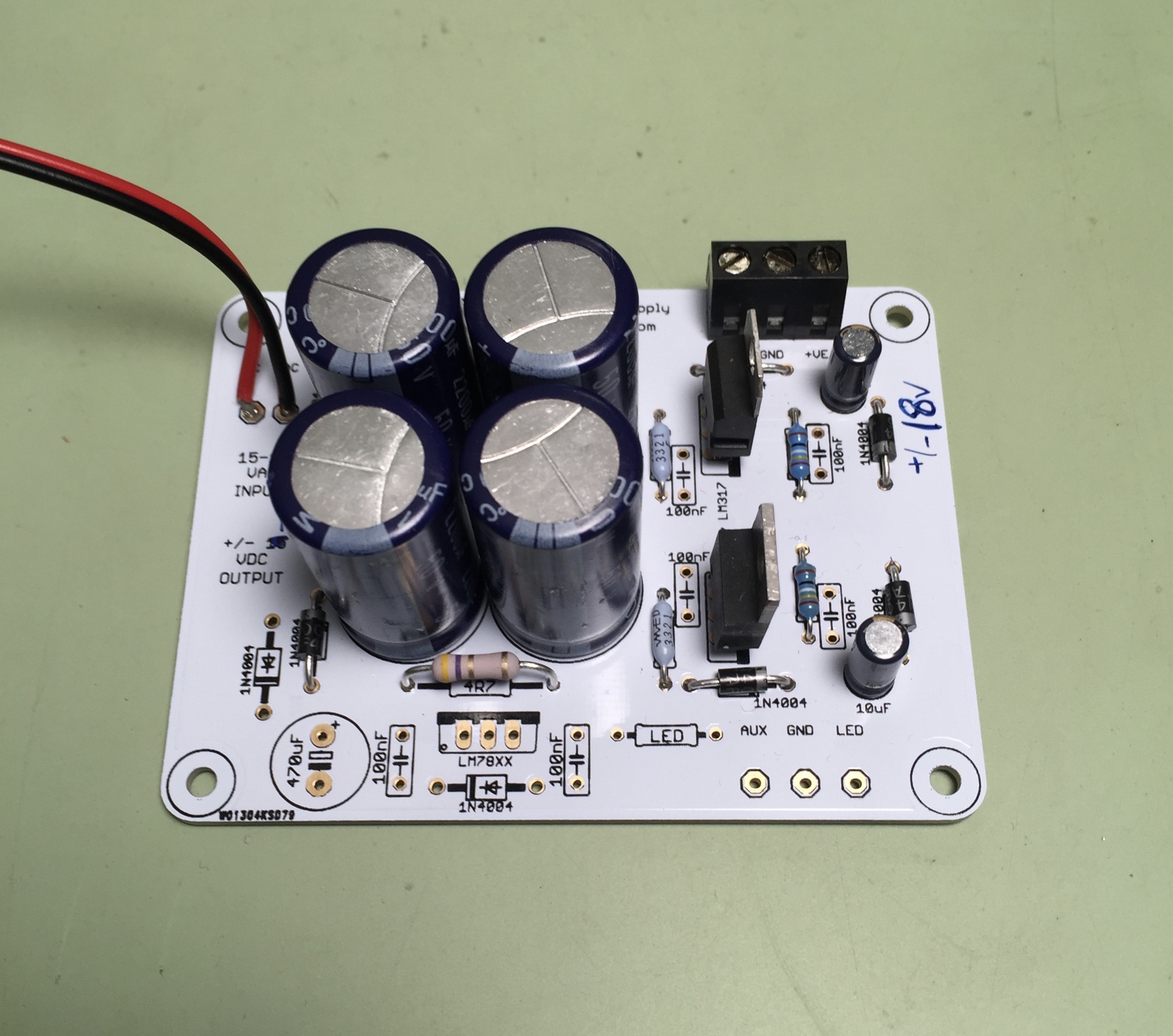

This is a neat PSU option, a board from Muffsy that runs of a 15-18 volt AC (AC, not DC, that's important) wall wart that makes +/-18v for the circuit. You can find them here - Muffsy Hifi Dual Power Supply V4 -Kit from muffsy on Tindie
If you want 18v you'll have to change 2 resistors on the PCB, the supplied resistors give 15v It's a standard 317/337 regulator implementation, a great choice for our needs.
You need to locally source the wall wart. If you buy the kit from Muffsy the parts are included and will have more and different bits than shown. (I bought a small quantity of empty PCB from him, the close-outs of his previous layout. He's also got a killer phonostage that the PSU is actually made for, it's worth looking at.)

Curved tweezers work great with a little quick chip flux. lay down some flux, position the component then rest the tweezers heal down and put pressure on the top of the component. bring in the pre-soldered iron tip and the flux will pull the solder into place.
The flux really helps with sneezes. :rofl:

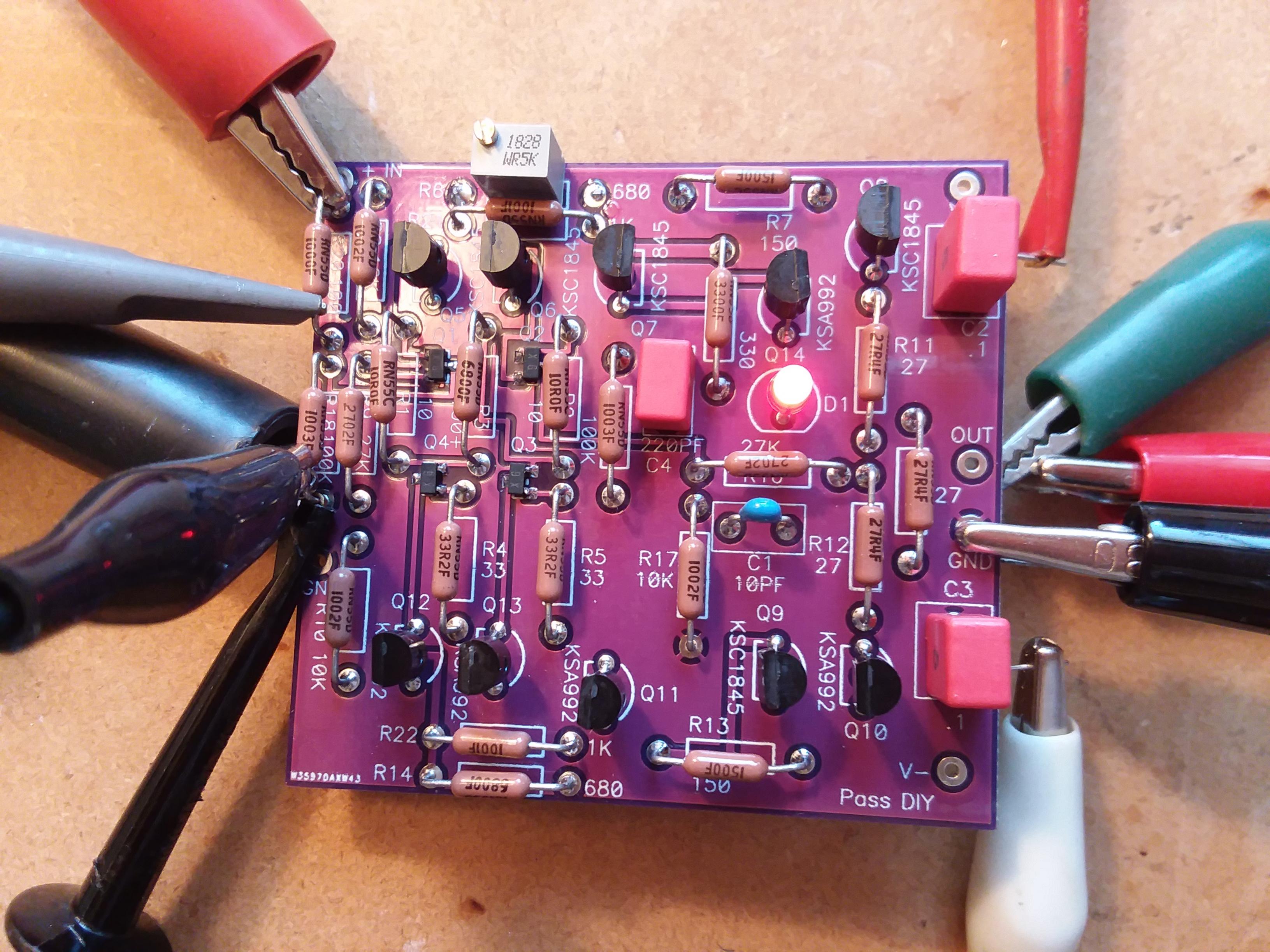

Completed the first board. 11mA in the output stage. 2mA for the current sources.
I soldered up the front end without Q3 and Q4 current sources.Then I placed the small FET on the pads and took a voltage reading across the 33 ohm source resistor. I went through the supplied FETS that Jim sent in the kit and they all measured 2.0 to 2.1mA.
Offset was easily set and stable. Gain was 3.7 (11.4dB) as expected.
Small 2nd harmonic at 2Vrms output.
