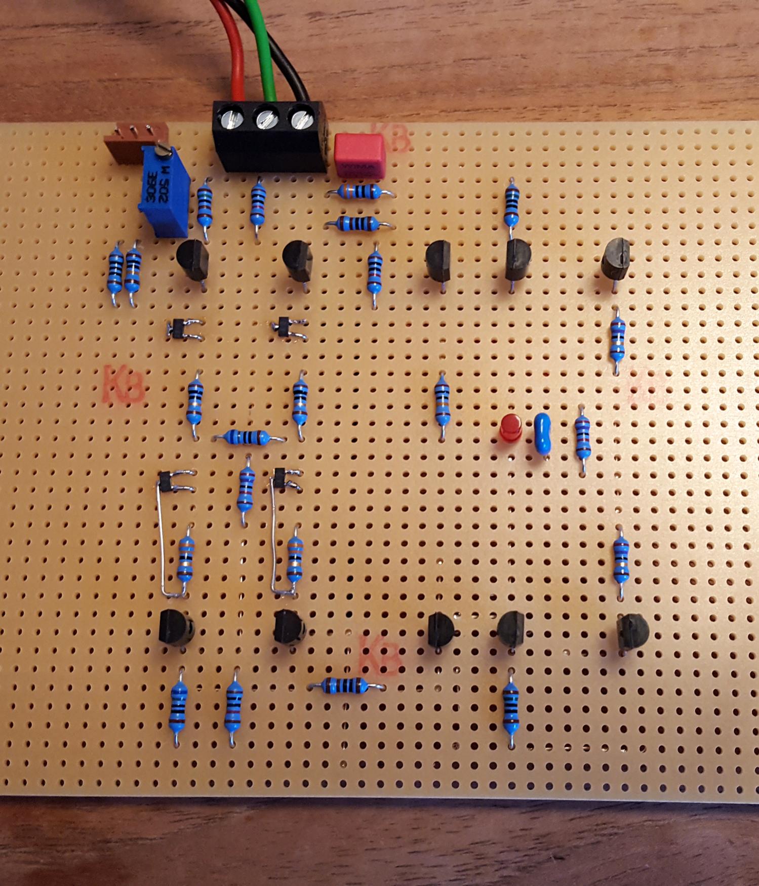

Hello,
i have a problem with the preamp.
After soldering i checked some voltages and found no voltag drop on R12 (Drop = 0V). The voltage drop on R7/13 is 1,45V, that should be okay. On R15 it is 39V, representing the 0,36mA figure, so this should be fine, too (rails are at +/-21,5V). At the moment the feedback resistor (R16) is not in the circuit, because i adjusted P1. Voltage drop on R6 and R14 are both 1,5V.
With the feedback resistor (R16) installed i found a voltage drop on R11 = 1,2mV, R12 still 0V. But something else changed: the drop on R2 became 26mV, befor it was 15mV, same value as on R1.
After that i checked the base voltages on the transistors: Q7/8/14 in the range of +20V, Q11/9 at -20V; but Q10 at about +16,6V. I expected it to be -20V or so. Can someone give me an hint? Thank you!
Best regards,
Michael
Hello,
first of all i want to thank you for your input! After changing Q10 the circuit works as expected. I can now measure an voltage drop over R11/12 of 0,33V, over the diode its 1,85V. Q10 and Q8 are getting quite hot, so i will lower the rails a little.
Best regards,
Michael

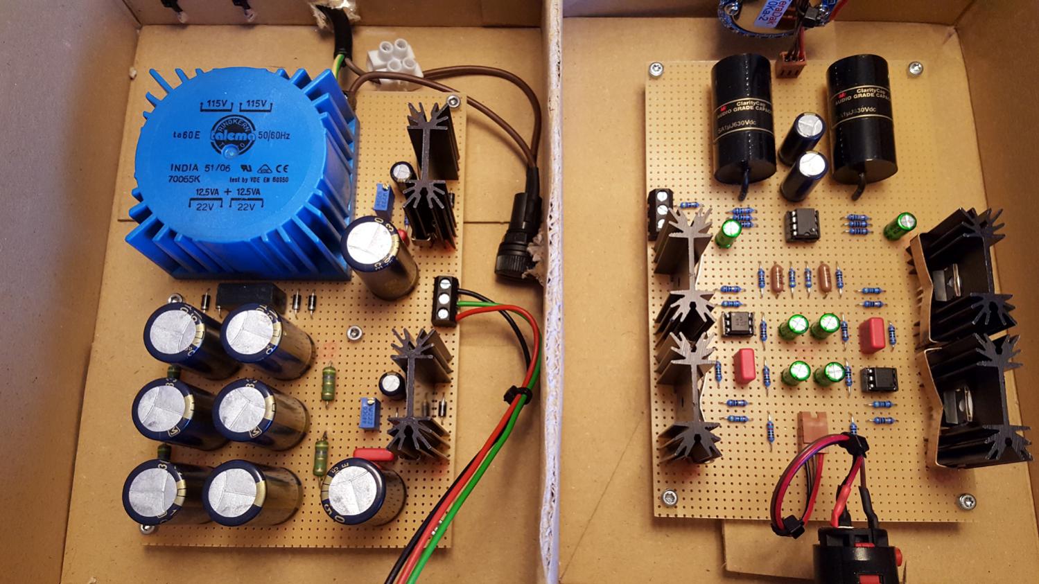

I'm using my Whammy PSU for the tests of the preamp. It's quite the same as the original design, except i built it as an variable supply and changed one or two capacitor values. Added two pictures...
