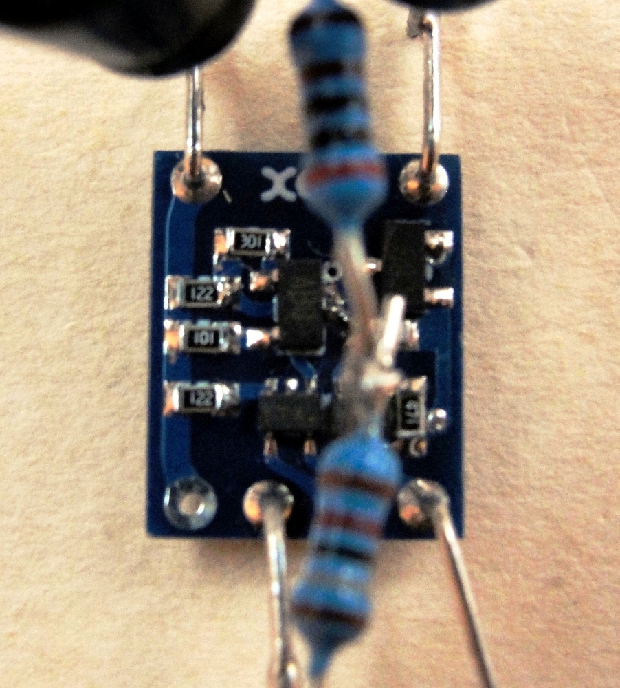

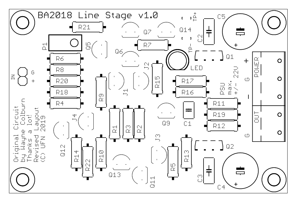

Surely I can't be the only one contemplating doing a clone layout of this design, but I might be the first one to actually finish it? 😀
It's going to be a month or so before the boards are here and tested (just ordered yesterday), so let's hope it works - normally publishing anything before testing risks jinx'ing the design but I'll take my chances 😎

What is special about this line stage / Preamp compared to the other DIY projects like BA3-pre, Korg Pre and Whammy?
The line stage is quite complex with 14 transistors pr. channel. I build BA3-pre because of the large voltage swing to be used for MoFo and the interesting P3 adjustment and also because it is a class A non-feed back amp. I build Korg Pre because it is very special with a 2nd harmonic / triode SE signature and I build Whammy because it can be used as a good head phone amp and also as just a preamp and also because it seems to be an easy build with on board PSU. Where does this line stage fit in? …...why do I want to build one?

This is a pretty accurate gain stage it was done just for BA 2018 as a quick project after Paul Norton brought us a batch of LSK170 SMT parts. I had just purchased the KSA992 KSC1845 bipolars and just combined the parts. The JFET input I borrowed from Scott Wurcer with permission. A little simulation and a layout was done in time for BA. The alternate outputs can be biased up and have quite good drive capability. Just a monkey with a Audio precision and people that can hear.

Don't forget that one of Wayne's design goals was to use current production, LOW COST, components exclusively. And he succeeded!
Look back at the powerpoint slides of his presentation, where prices are discussed. You'll see that he wasn't exaggerating when he described the talk as
That's not easy to do, and get measured performance as good as Wayne got.
High performance + low cost + lots of fun. What's not to like???

A discrete opamp made from 3 cent bipolar transistors and 15 cent JFETs

Ok...….I have sent a PM also to get a set of these line stages. High drive capability and stability is a good thing and I also realized the very small form factor of the boards. Then I have to learn to solder smd components. I have only done that once. For that I used a hot air attachment I have for my Weller gas solder iron.
Why build this pre? Price the Passlabs linestages. This linestage is from a designer that works there and you will find your answer. I have built a couple of BA-3 pre's, not my cup of tea. Great with my BA-1 and BA-2 but not as a standalone. Nothing wrong with it just not my favorite. When possible I usually use my B1 buffer because of it being so simple and neutral sounding. When using a pre with gain I reach for my LSK pre Nelson presented at the BAF a few years back. Excellent sounding to my ears. I am sure with some tweaking both the LSK and this design can be improved to a real high standard of audio perfection. The LSK linestage with no feedback appeals to my brain but in reality feedback is not that awful a thing if used correctly sonically. With both the LSK and this linestage I feel like Nelson and Wayne are giving a peak into what is in the retail linestages they sell.
Which components limits the PSU max. to -+22 VDC?
I run -+ 26V for BA3-pre and would be nice if I could just swap without re-adjust the PSU voltage (I have built external PSUs).
