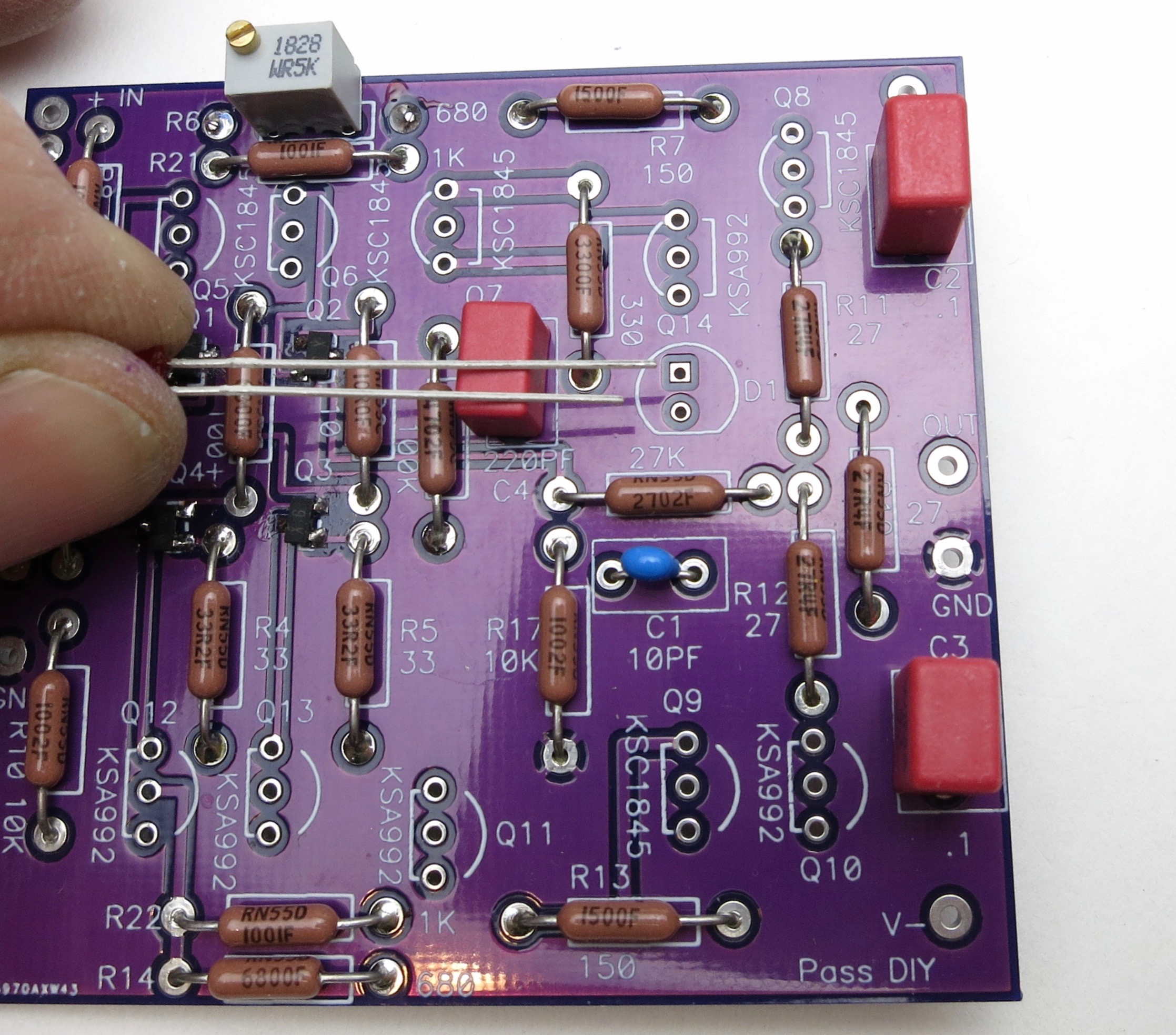

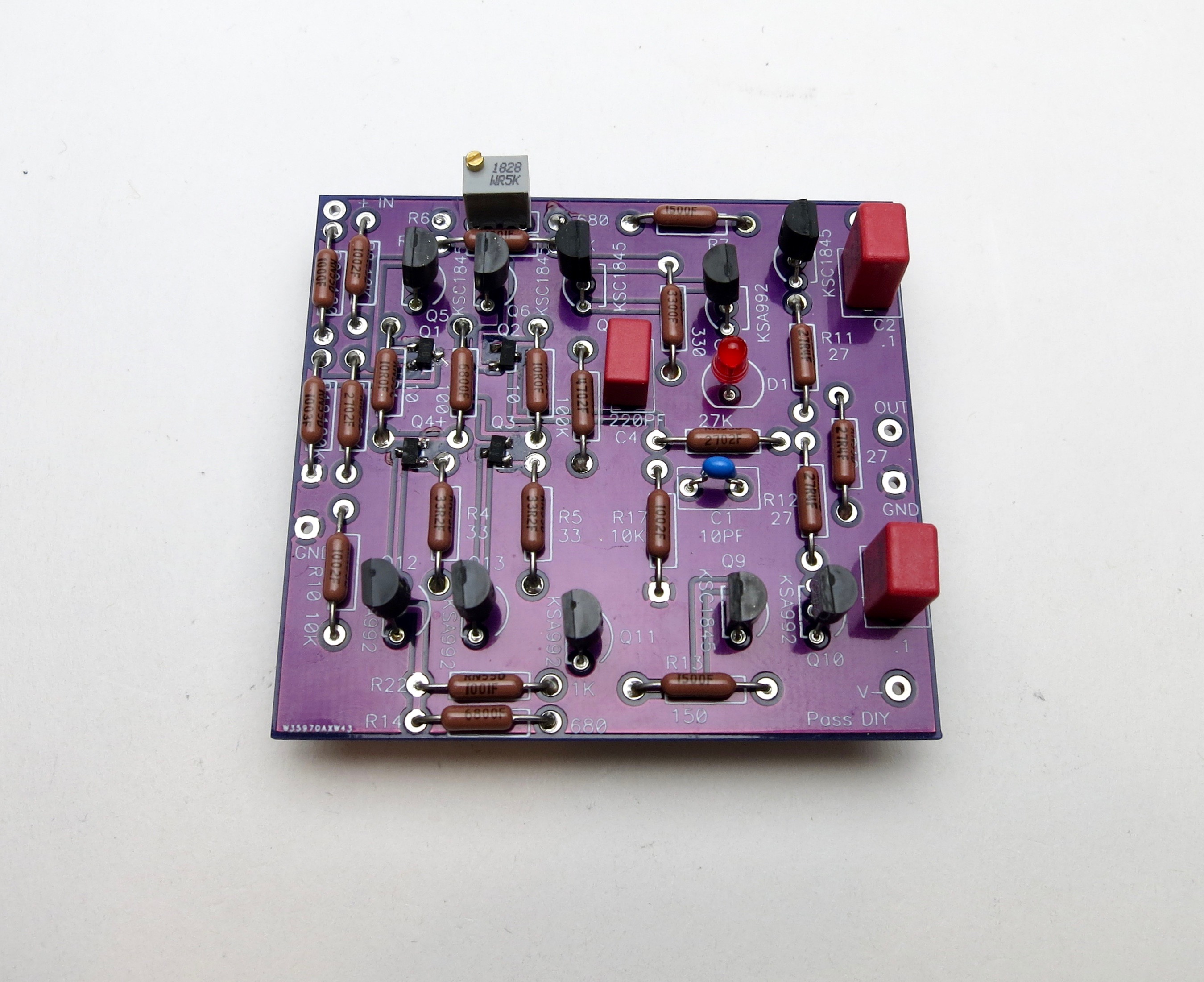

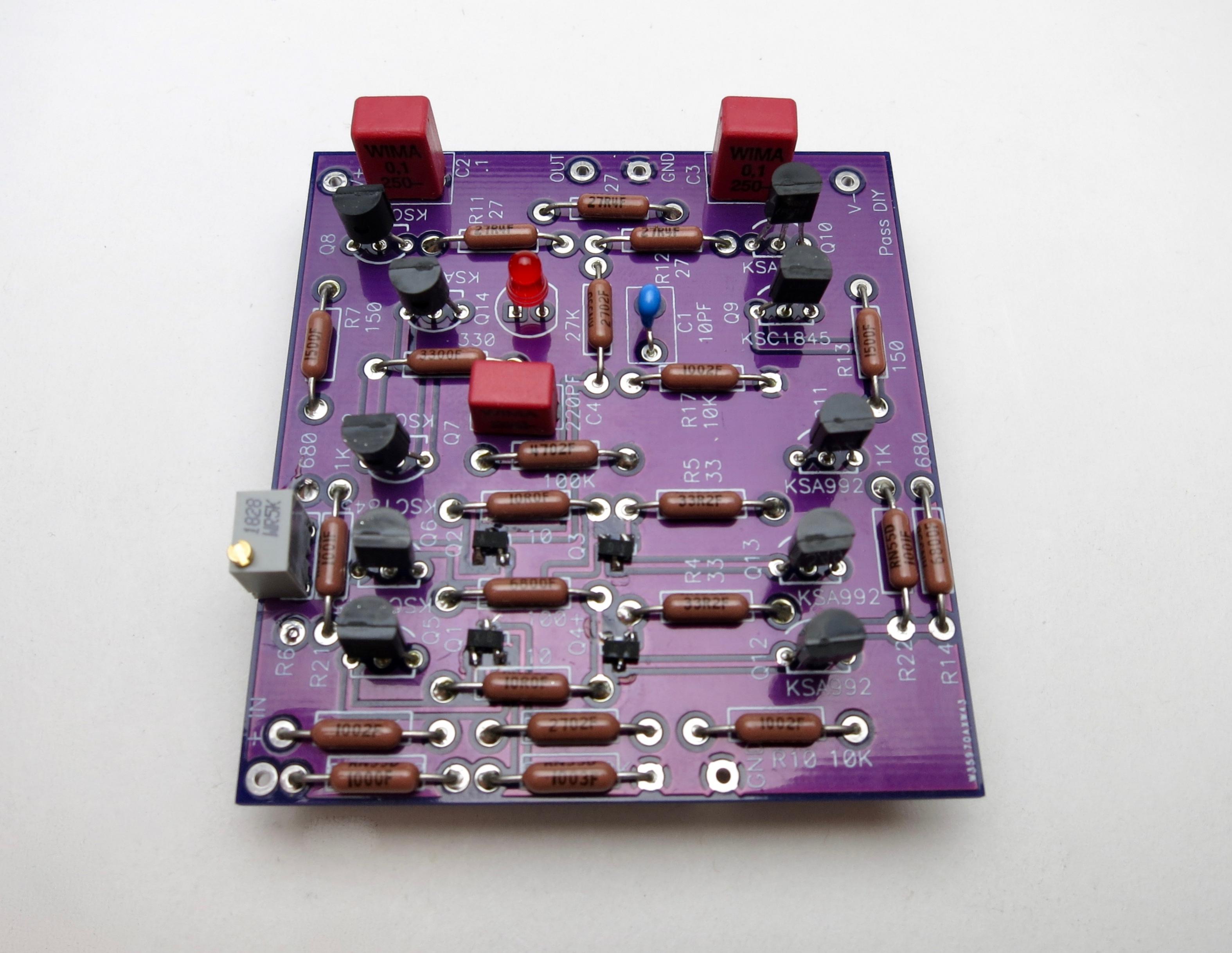

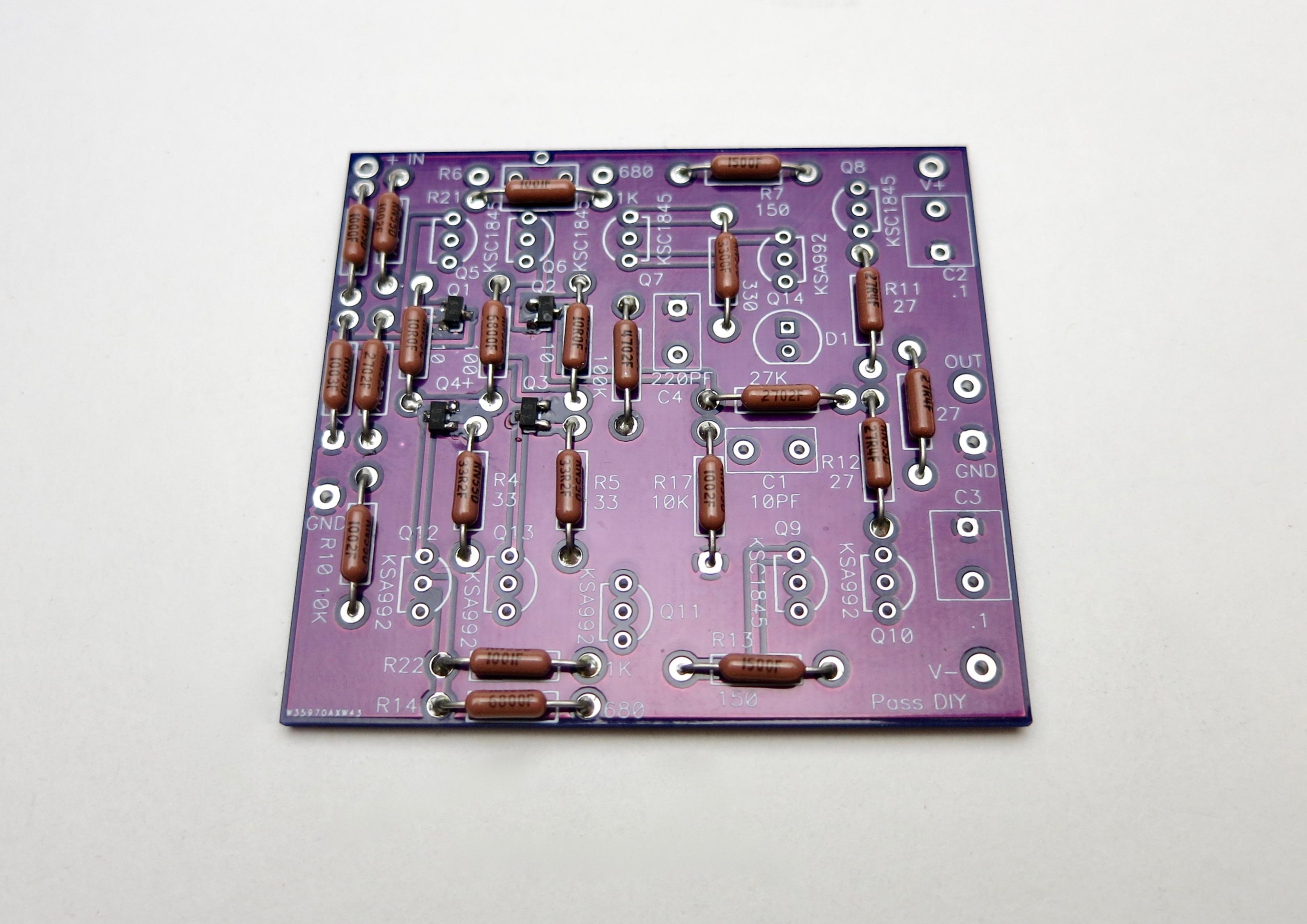

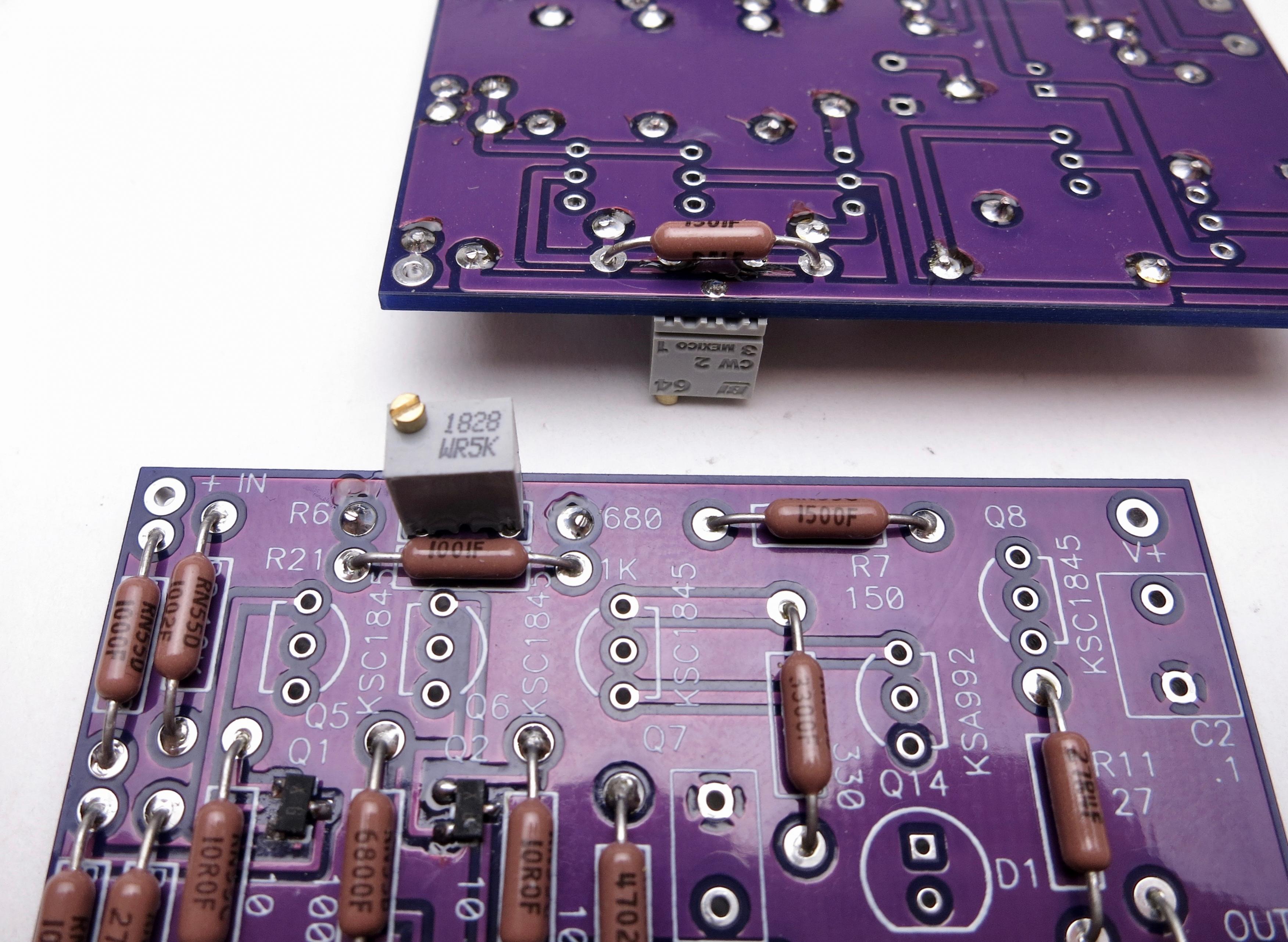

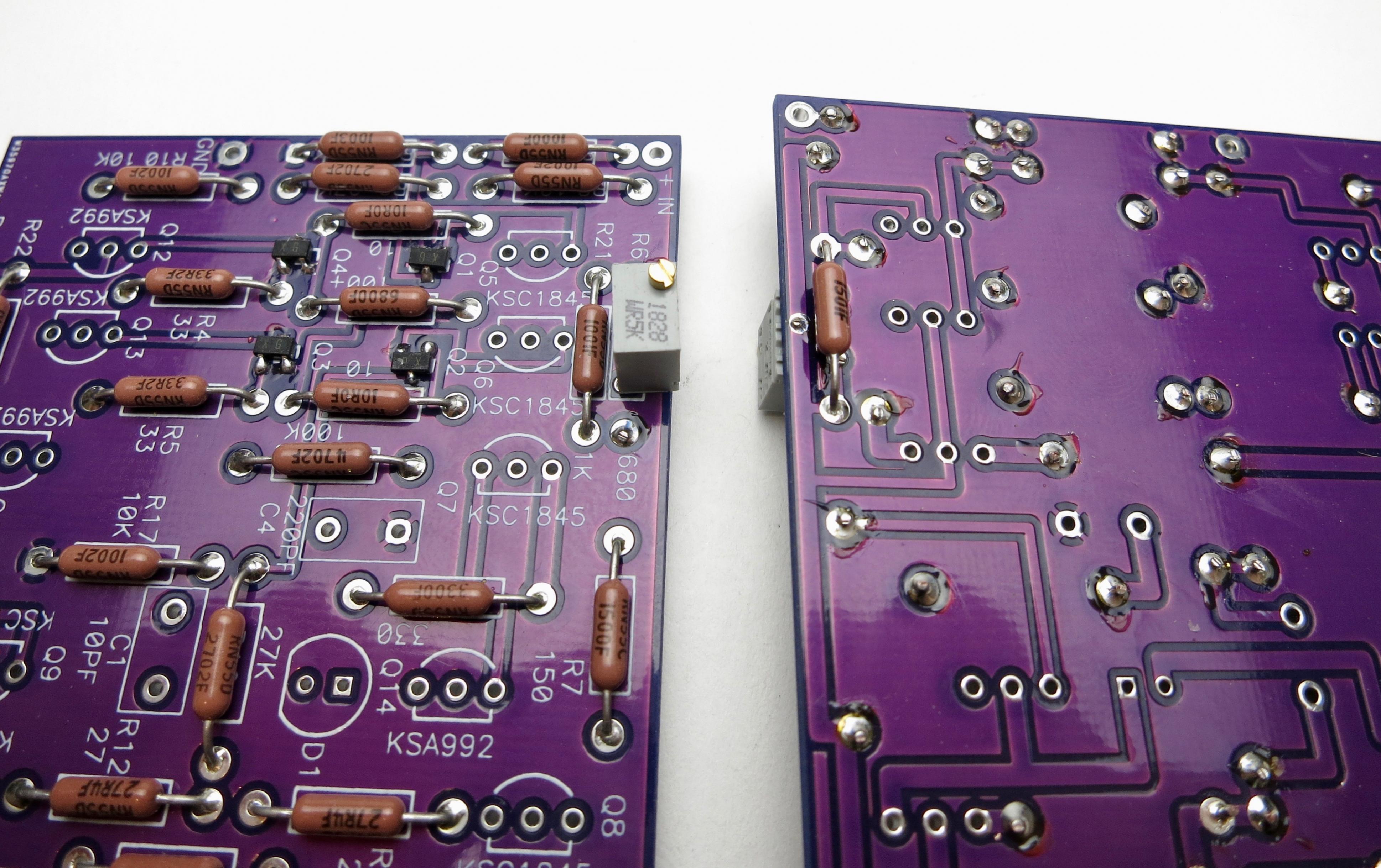

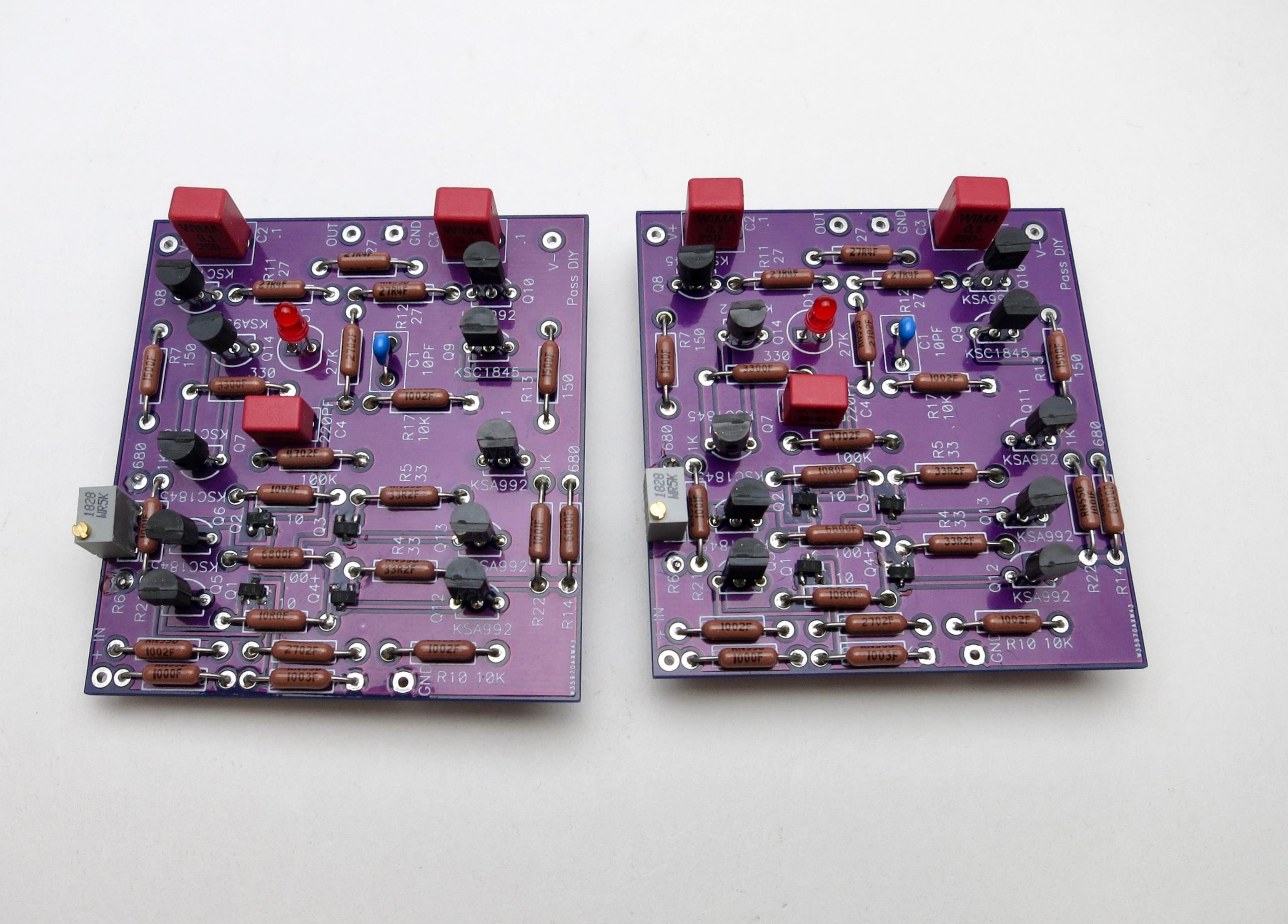

Parts in the kit will stuff the PCBs as shown -
attachment.php
attachment.php
Stuffing order is SMD jfets first, followed by the resistors.
attachment.php
NOTE - R6 attached to the bottom of the PCB, it's also marked 68- but 1.5k is on the schematic and that's supplied.
Attach ONLY after the pot is soldered. :)
attachment.php
attachment.php
LED has no notched side, so long leg into the square pad
attachment.php
attachment.php

You are referring to the 220uF electrolytic cans soldered in parallel with the film caps on the bottom of the board... The short answer is no;
Wayne added those because in that particular build he also added some series filter resistors feeding the PCB from the Power Supply - with that extra R filter, (which ended up being not necessary) the bigger caps downstream help keep the PSU sagging if there's a big transient. With no series resistance the film caps on the top of the PCB are more than sufficient fo the job, and the bigger cap is superfluous because the preamp board has direct access to the regulator's output with nothing in the way.
Look at the other photo from that post and you'll see those resistors the amp boards are connected to.

P1 pot adjusts what, dc offset?
With R16 and R17 both stuffed and soldered, DC offset is established at [Q1234_mismatch * (R16+R17)/R17)] and is not much affected by P1.
Instead, P1 adjusts the strength of the pushers versus the strength of the pullers. Perfection occurs when they are exactly equal strength. This minimizes distortion.
One way to make the adjustment is to proceed with R16 removed from the circuit (temporarily: R16 = Infinity). Then monitor the voltage across R6 while sloooooowly dialling P1. When the voltage across R6 exactly equals the voltage across R14, stop. You could get confirmation by verifying that the voltage across R7 exactly equals the voltage across R13.
