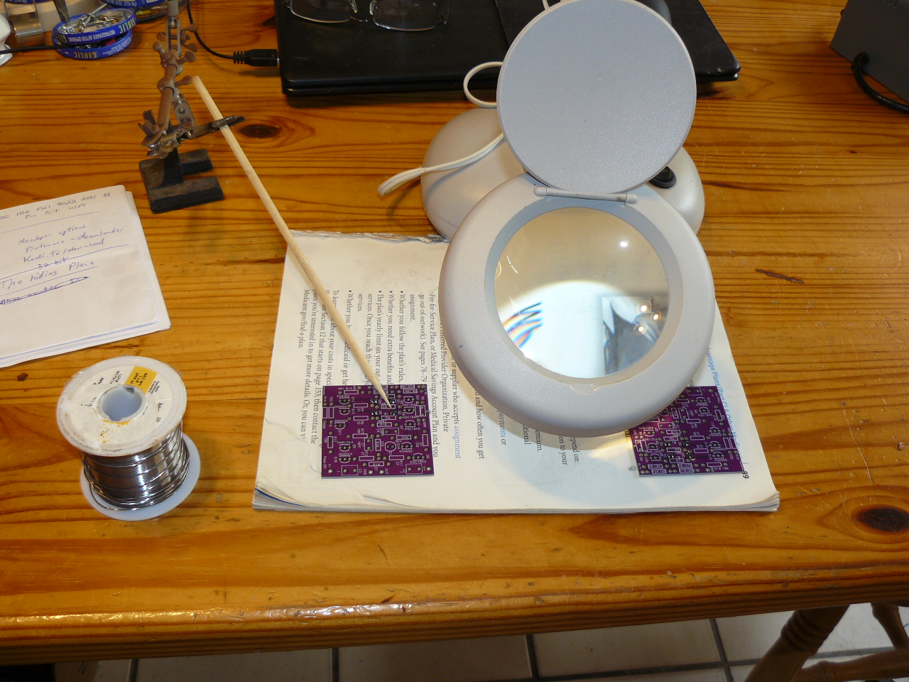

My kit arrived yesterday and my first thought when seeing those smd parts was darn I wish I had some extra's. Looks easy to lose one they being so tiny. I actually have seen smd parts before but it has been a few years ago. I am showing what I used to solder those tiny things in the picture. I would not have attempted the job without what is shown in the picture. What is not shown is a 10 power loupe I used to check my work when finished. Not really hard at all, just tedious.

Kit arrived yesterday as well. Thanks Jim! I should have my transformer tomorrow and be able to start slinging solder soon. I ordered an affordable hot air SMD station from amazon since I anticipate more SMD work in the future for various projects. I will be giving that a try on the JFETs. I'll let everyone know how that goes.

For soldering a few SMD parts I just put a touch of solder on one pad and tack in place while moving it around with a small tool. Get yourself a pair of optivisors with # 7 lens. These are very handy for multiple things besides soldering. My eyes are not what they once were and these help although I have used since my early twenties.
