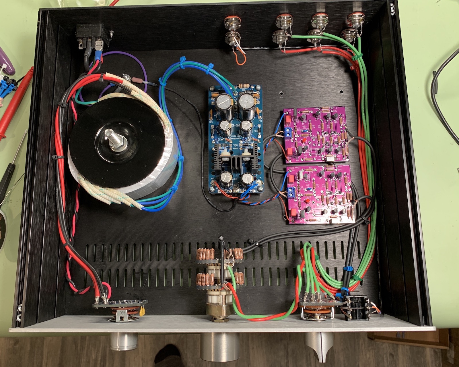

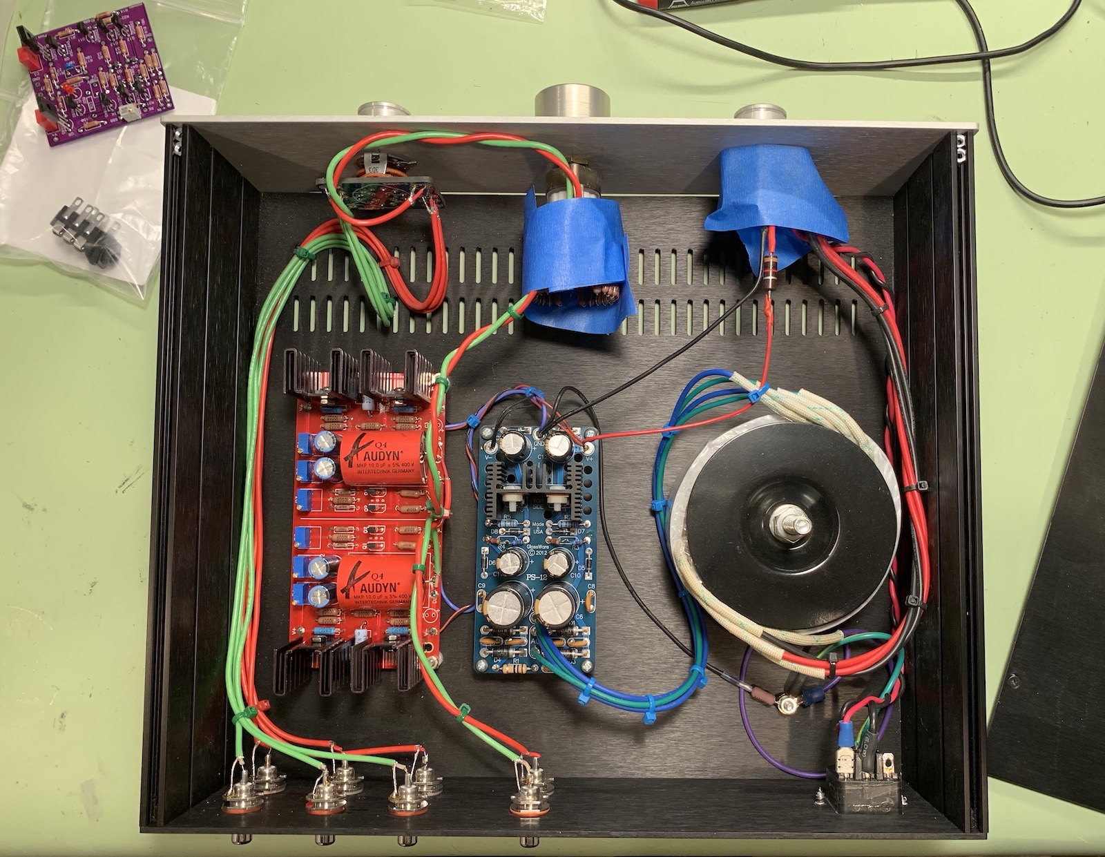

So I took the chassis with the BA-3 Preamp and removed the gain stage and replaced it with the purple boards.
These have the alternate outputs, in the TO-126 package, and have plenty of drive for my low-impedance headphones. PSU voltage is high enough to drive high-impedance phones as well.
attachment.php
The BA-3 preamp. Taping the switches and attenuator up as work is done on it. Yes, the transformer is enormous, it was intended for a chipamp project that never happened. It's super quiet and was the right voltage. And was on my my shelf... 🙂
attachment.php

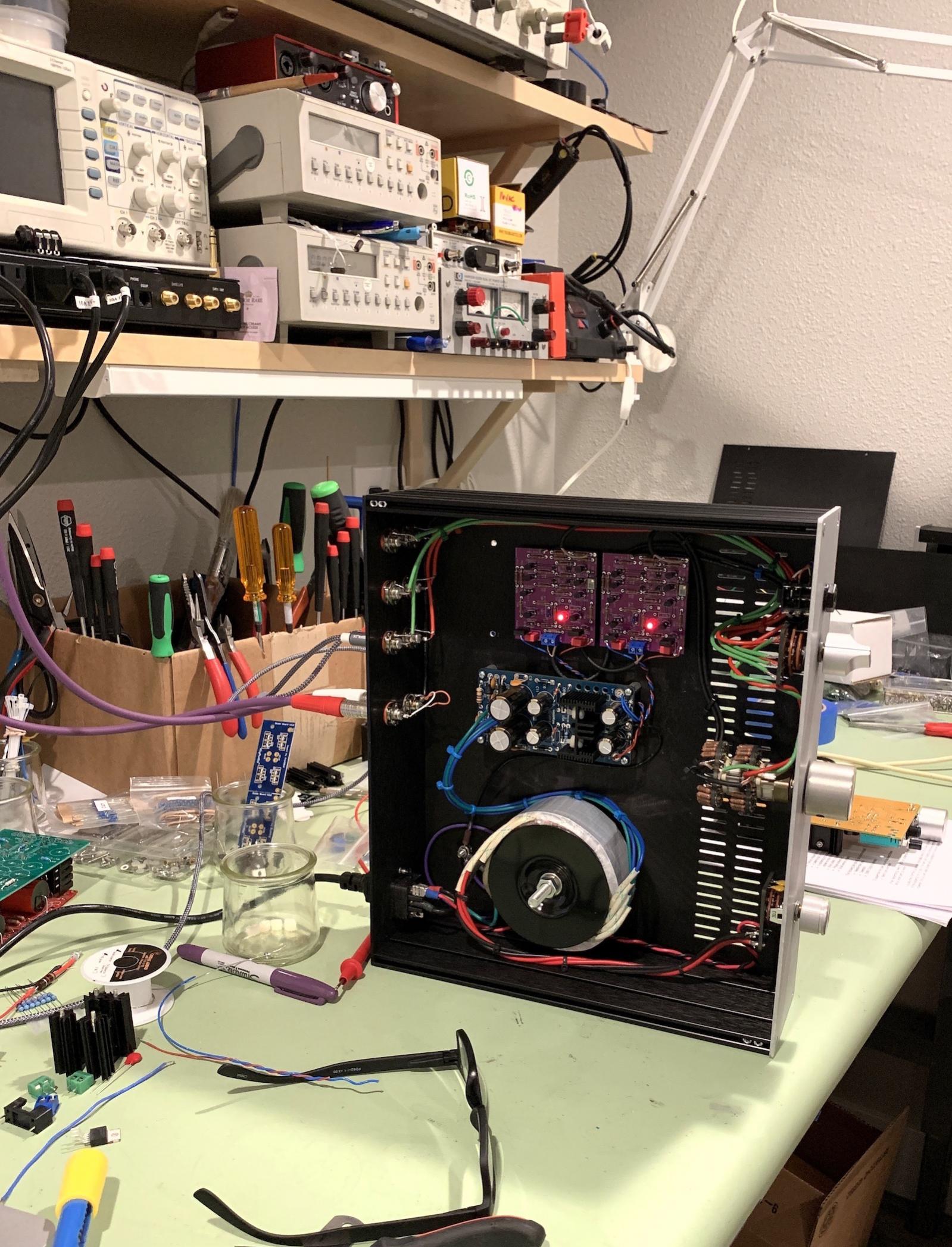

Installed with the purple boards.
attachment.php
attachment.php

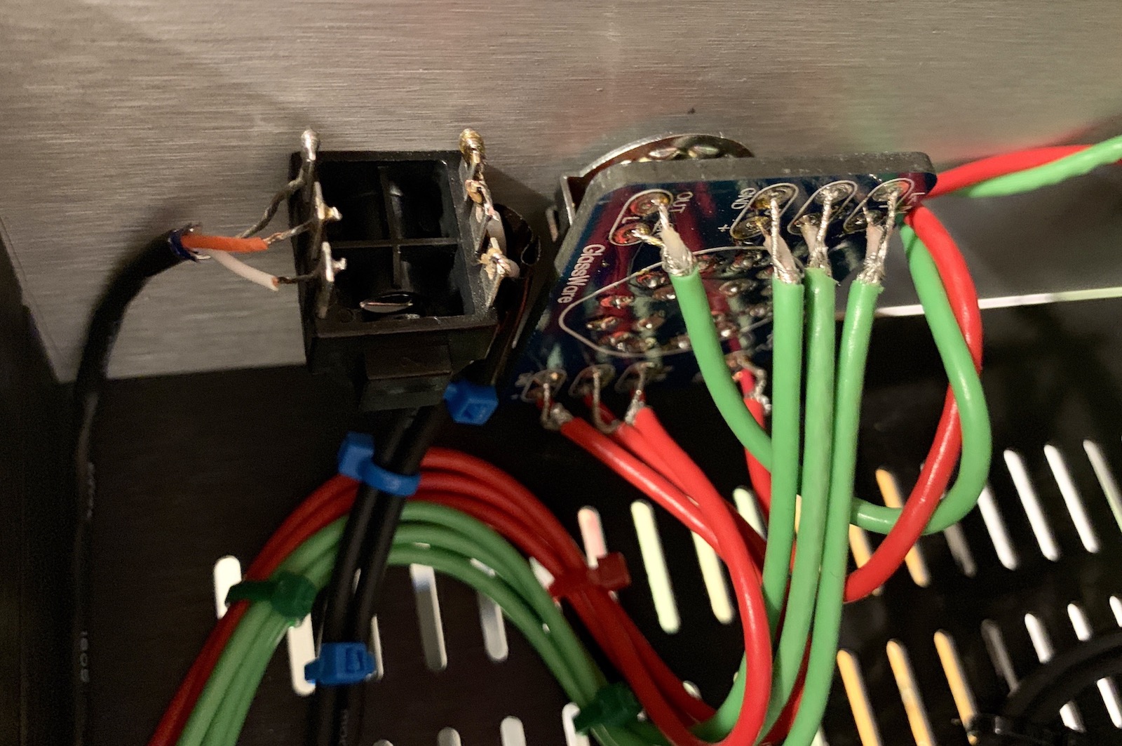

The headphone jack is a switched type, it will pass through the signal if no plug is installed, and send the signal to headphones if installed. So the jack is wired first on the output of the boards, and then output RCAs are further downstream.
I'm going to install the Broskie regulator (and a more reasonable transformer 🙂 ) next and take more photos of the connections.
