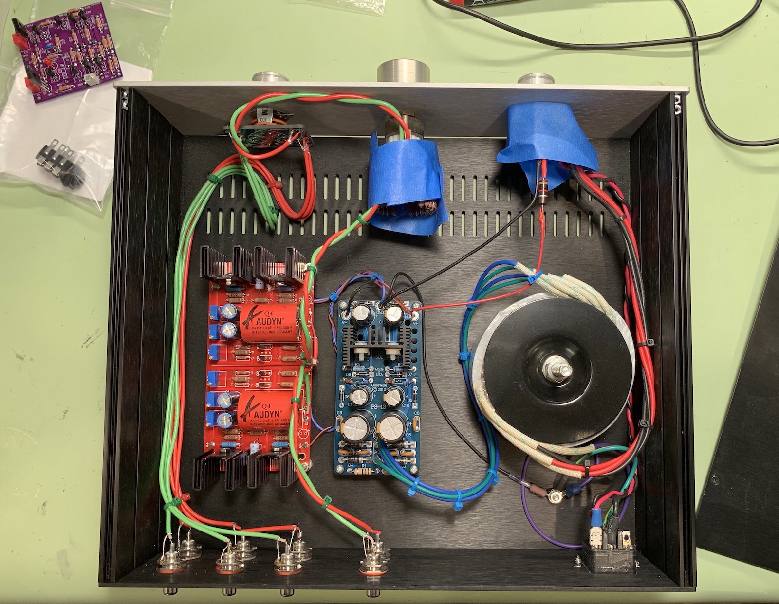

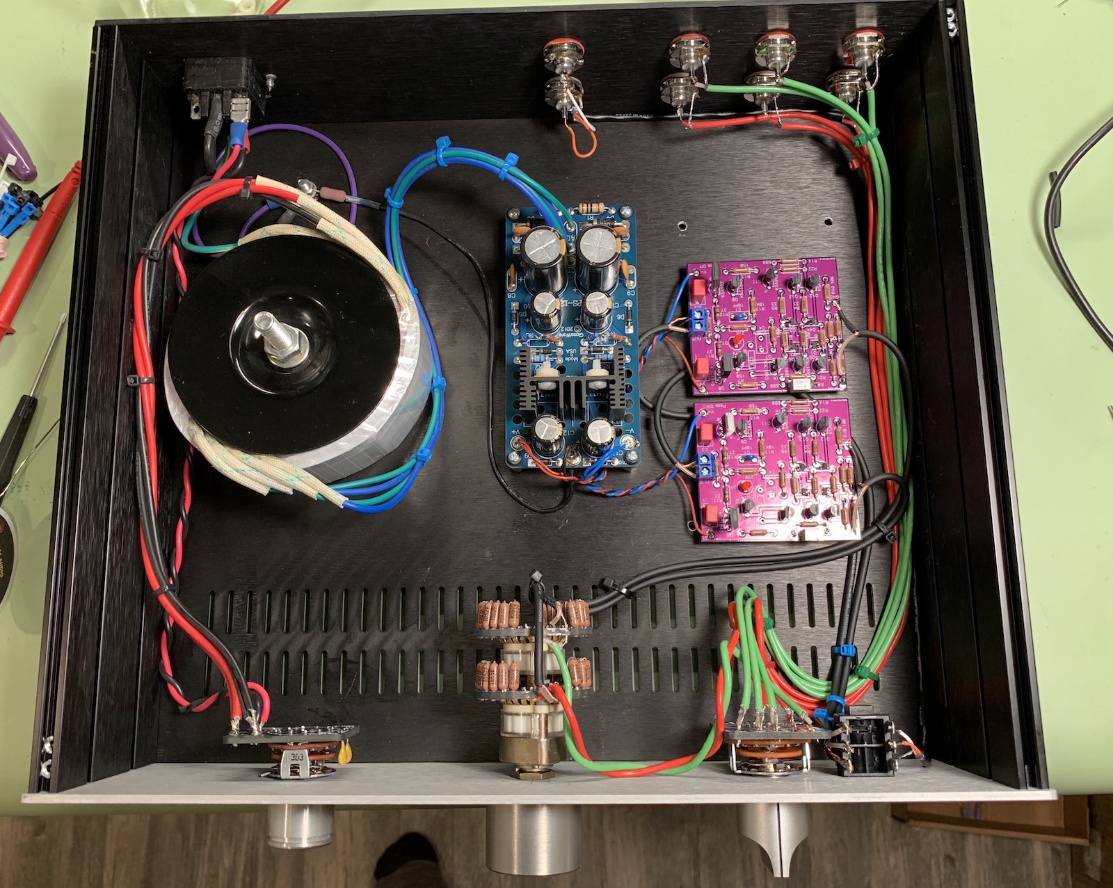

So I took the chassis with the BA-3 Preamp and removed the gain stage and replaced it with the purple boards.
These have the alternate outputs, in the TO-126 package, and have plenty of drive for my low-impedance headphones. PSU voltage is high enough to drive high-impedance phones as well.
The BA-3 preamp. Taping the switches and attenuator up as work is done on it. Yes, the transformer is enormous, it was intended for a chipamp project that never happened. It's super quiet and was the right voltage. And was on my my shelf...

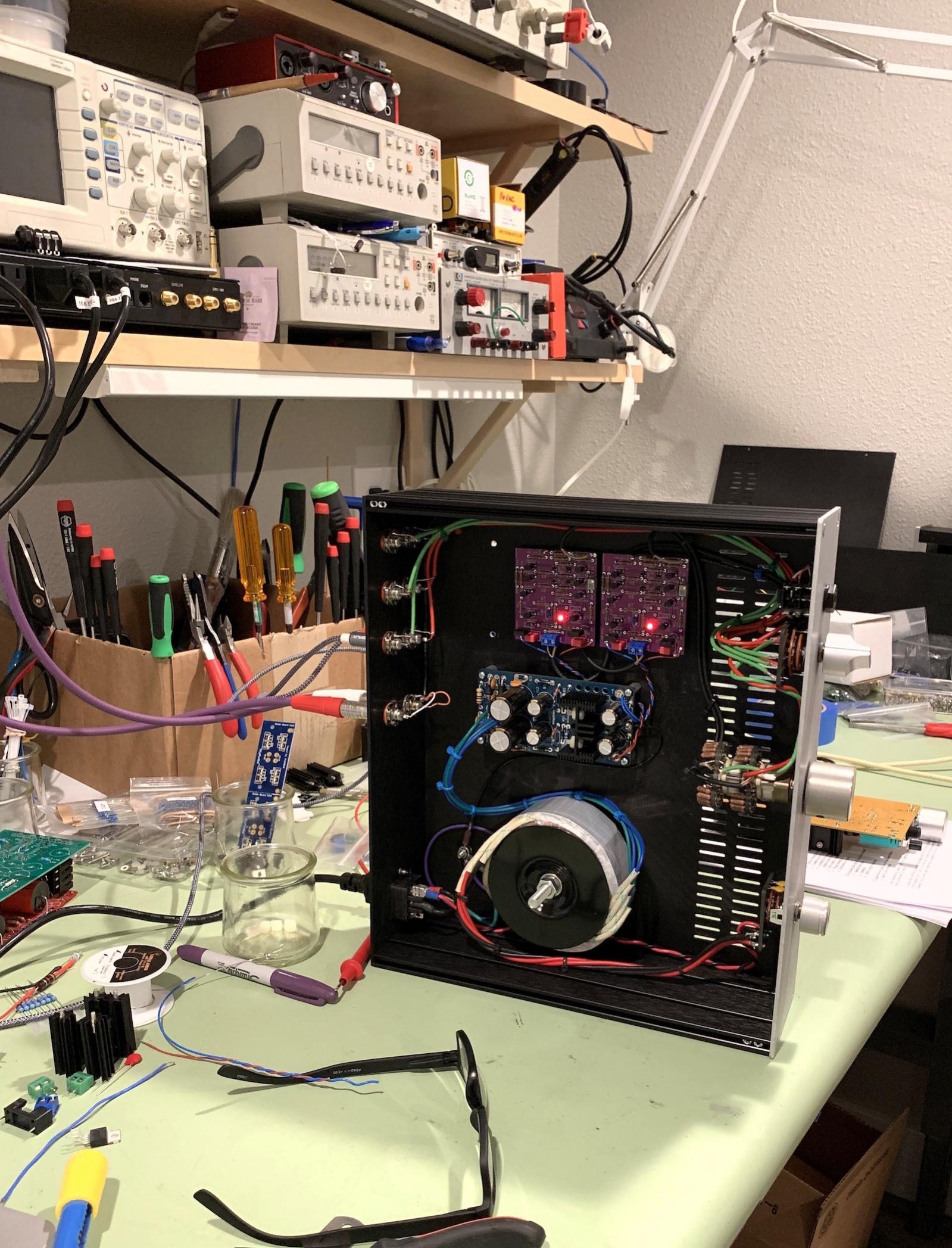

Installed with the purple boards.

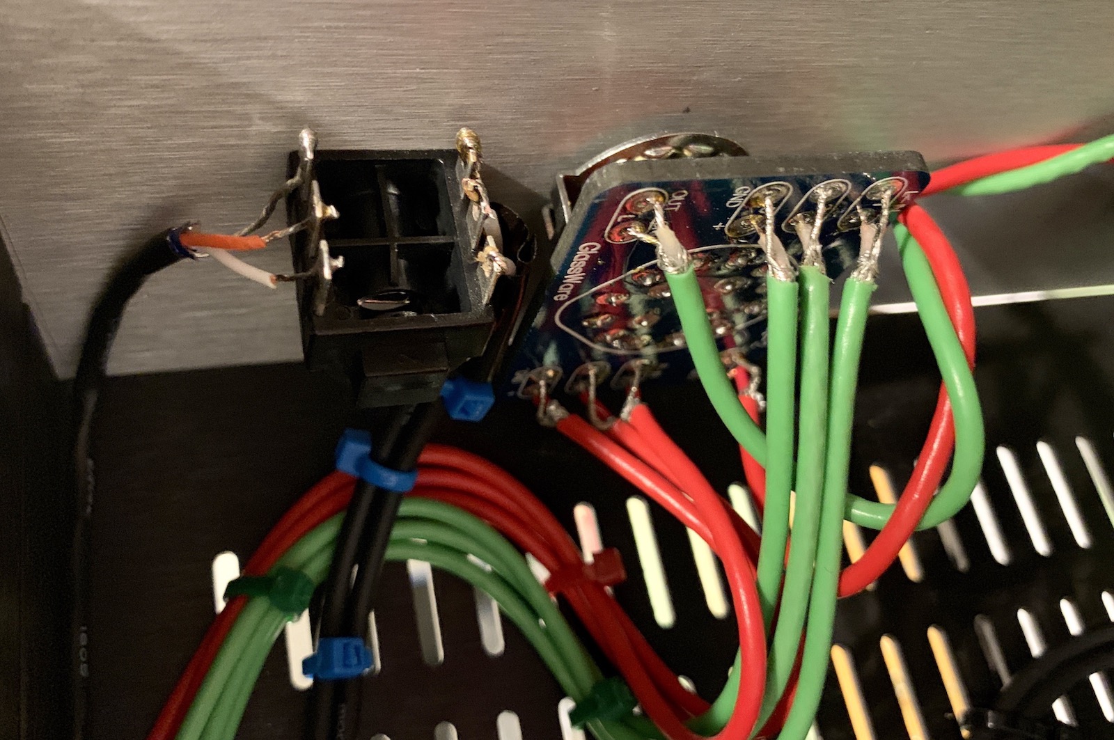

The headphone jack is a switched type, it will pass through the signal if no plug is installed, and send the signal to headphones if installed. So the jack is wired first on the output of the boards, and then output RCAs are further downstream.
I'm going to install the Broskie regulator (and a more reasonable transformer ) next and take more photos of the connections.

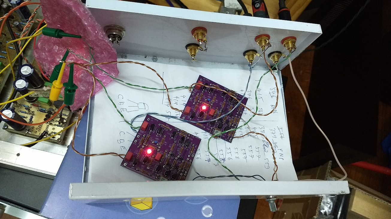

Nutz, I should have got another 3 position selector from TubeCad, (like I used in BA3 preamp) when I ordered the power supply. Oh well, lets see if I can dig something up in my various parts boxes. I have an extra 25K ladder stereo volume pot like I used in BA3 preamp build already, unless another value would be better? I'll check posts and see what others used.
Russellc
Russellc
Phew, all those numbers on the paper are making me dizzy!
