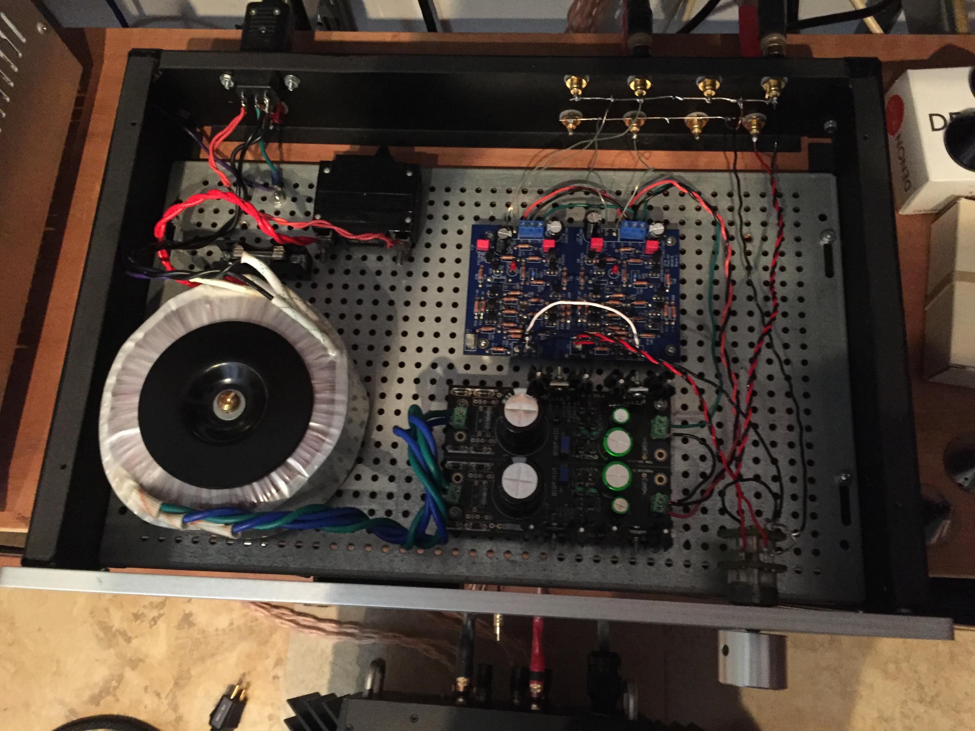

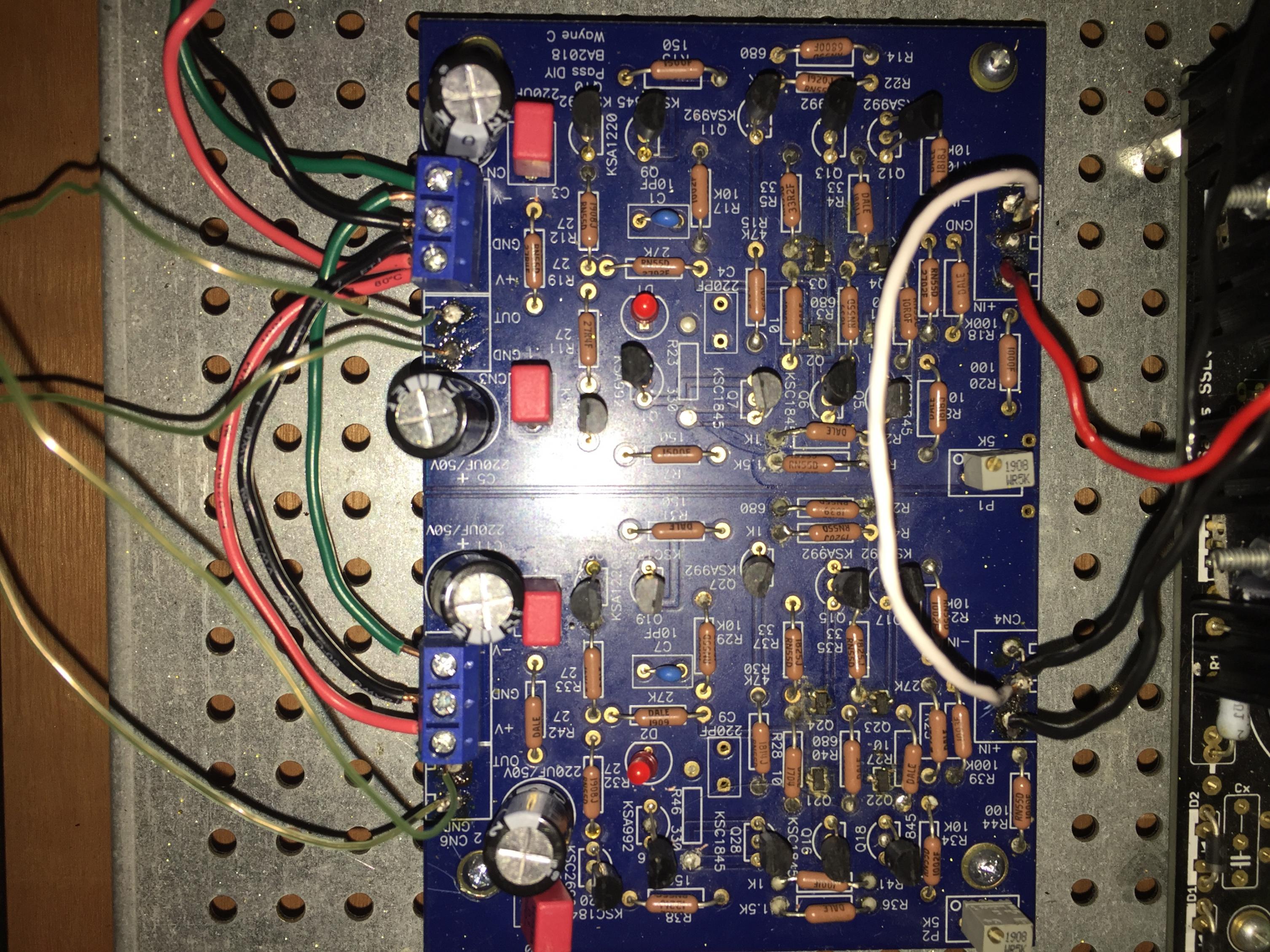

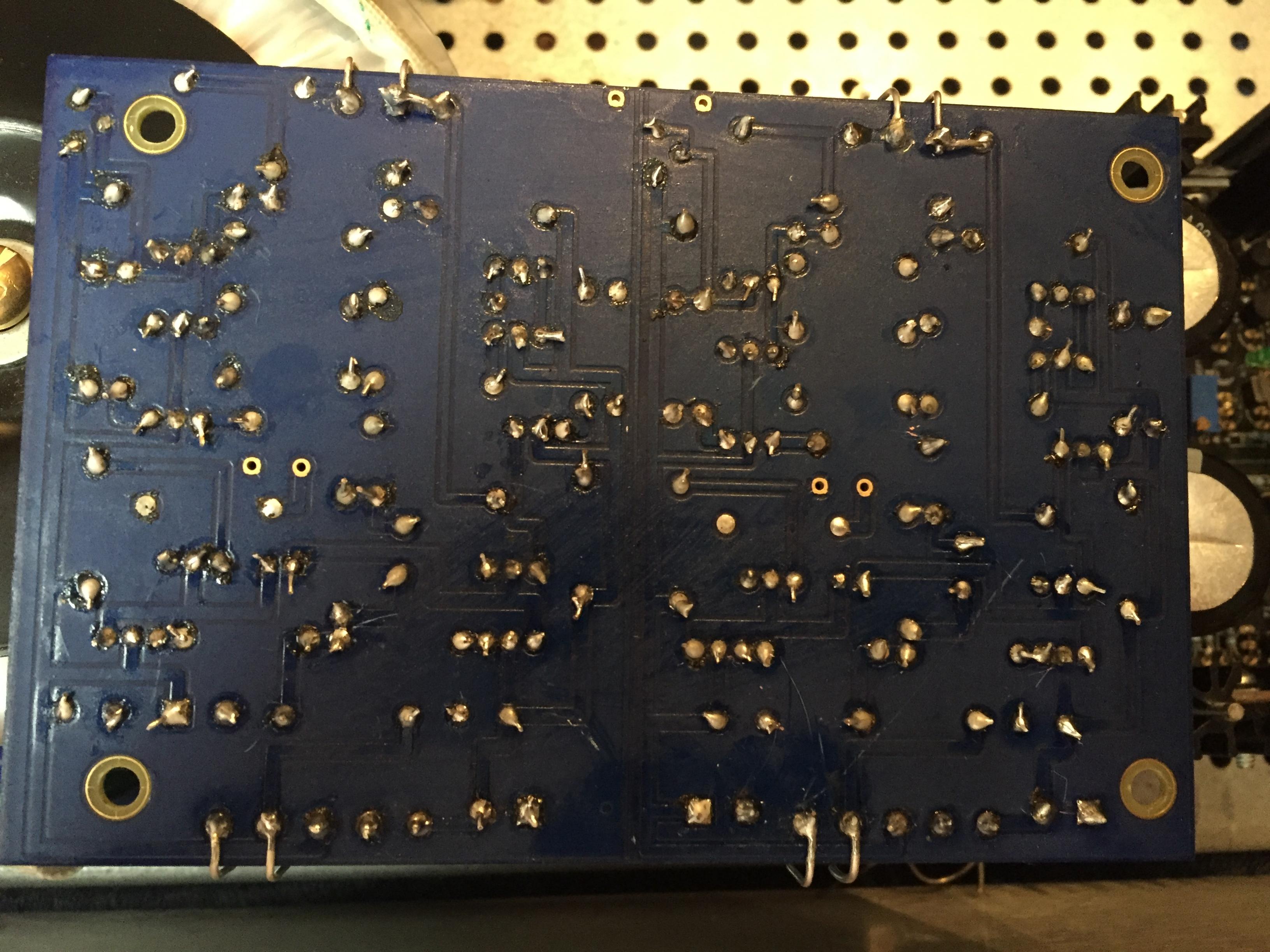

Status: left channel only producing sound because of issue that burned the right channel led which components might have been affected?
Hum is still there more like a loud noise and can be heard even with the amplifier off, still louder when amp is on, thru loudspeakers. Checked power supply and is ok. Shall appreciate any ideas. Thanks.

Well, it’s working. No hum or noise. I have it connected to my F4, no gain issues, volume control is at 3 o'clock with my 94 db efficient Spatial M4’s TM.
Soundstage is enormous and very dimensional. Even with only 30 minutes on, I do not
hear any sort of analytical artifacts very smooth and musical. The issue was one of grounding. I will redress the wiring with better wire and do it more neatly. The wiring I had on hand and used is too rigid.

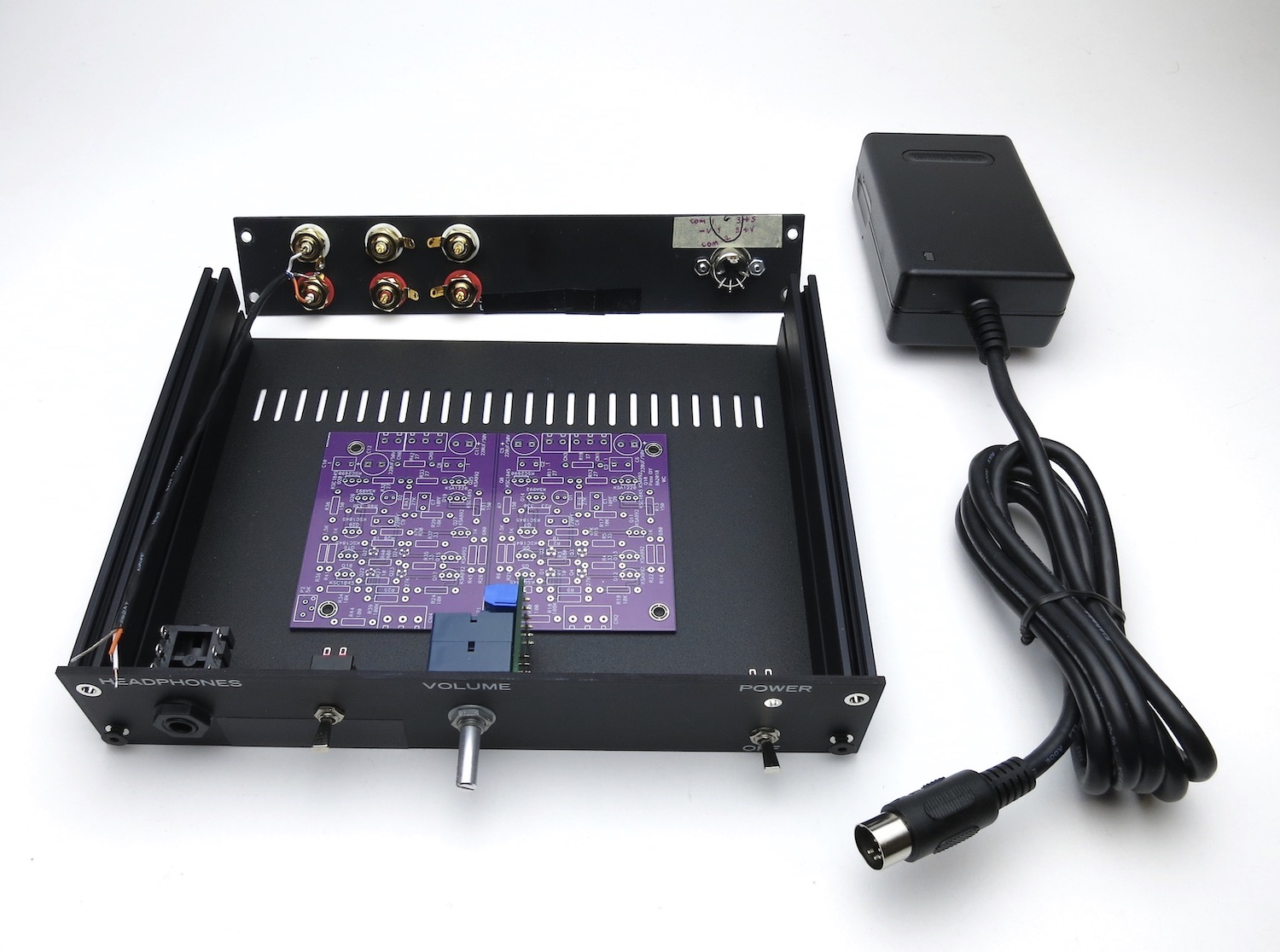

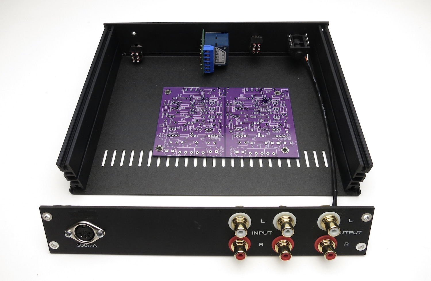

Quick little project using up some parts and pieces laying around. (The benefits of a well-stocked parts closet.)
Mean Well has a small selection of bipolar PSU bricks, this one is +/-15v (and also has +5v that will be unused for now) and I'm greatly looking forward to trying it. GP25A14E-R1B EDIT: I'm not having good luck with this PSU. Hold off from buying this for the time being.
Build will be the 'large outputs' version since I have an headphone jack to use up. :)
More photos as I progress.
