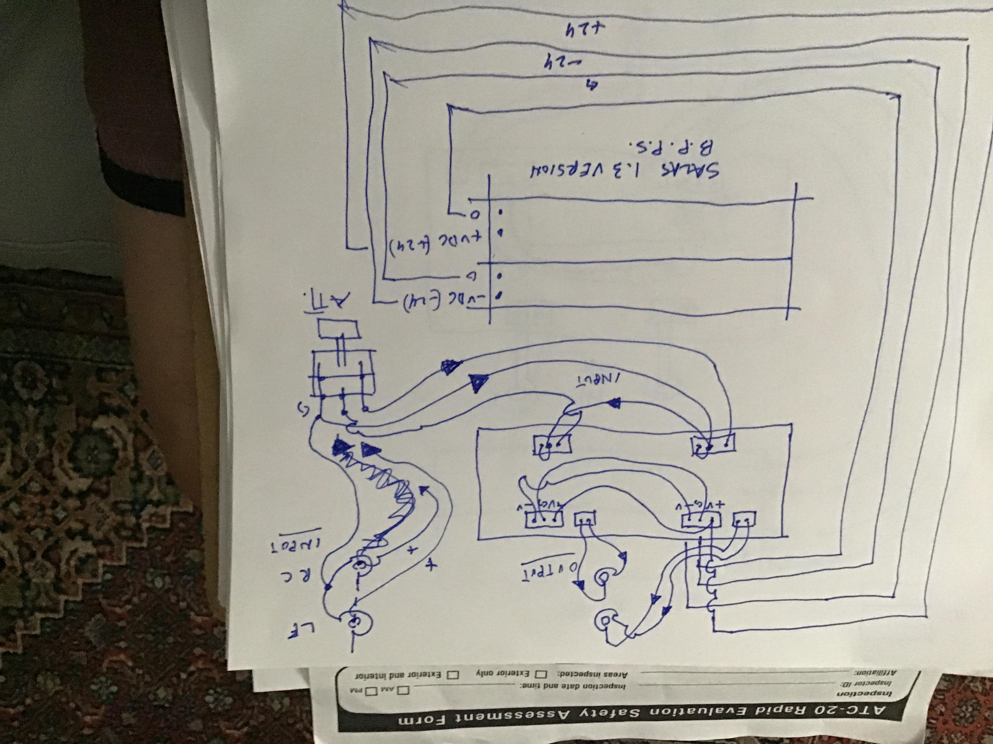

Looked into this topic in this thread but did not find it. Offset at 0v in both channels. Replaced the ba-3 board in my linestage using the Salas v1.3 bipolar powe supply set at 24/-24v., both channels produce music but there is a loud hum in both. I wonder what could I have done wrong. I guess it has to do with a ground issue, a lot of ps wiring from the ps board, etc,. maybe too many “grounds” what should I look for? I am including a photo of the connection setup.
Could we see a photo of the actual wiring as well?
And please bring the amp to a well-lit area so the photos are in good focus and sharp.

listening to it. Hum changes with the position of the wiper in the attenuator -Goldpoint 50k stereo- listening at 12 o’clock now, no hum, if I vary the volume there is a tracking noise and might hum again at different points. Read somewhere here about grounding the attenuator to chassis?
grounded the attenuator to chassis from -attenuator ground post to chassis- Hum gone but still tracking noise when turned. Strange, this attenuator worked fine, So there must be something else....Must be missing some ground connection or too many....
