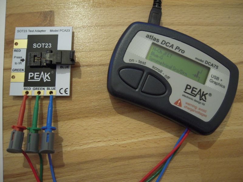

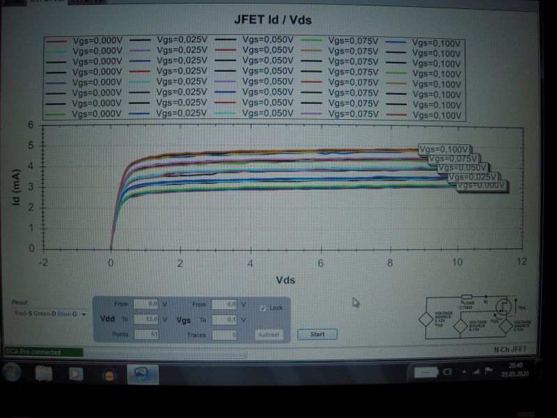

TOSHIBA 2SK209GR measurements
Hello members,
this late afternoon I thought that I could test/measure some JFets. I got most of my parts for Waynes -BAF2018 -linestage. Still waiting for the boards (hanging around at the customs).
I tested the first batch of 10 TOSHIBA 2SK209GR from the reel (I did not buy a complete reel!).
My measurements are really promising! No real need for matching - but I will do it.
V GS(off) V GS(on) gfs Idss RDS(on)
V V mA/V mA Ohm
1 0,43 0,13 17,6 2,87 44,5
2 0,43 0,12 17,5 2,86 44,1
3 0,43 0,12 16,9 2,81 44,2
4 0,43 0,12 16,7 2,93 44,2
5 0,43 0,13 17,3 2,89 44,4
6 0,43 0,12 17,3 2,92 44,6
7 0,43 0,13 17,6 2,91 44,3
8 0,44 0,12 17,1 2,93 44,2
9 0,43 0,13 16,6 2,96 44,2
10 0,44 0,12 17,1 2,94 44,2
I don:t know how exactly my measurements are? But the TOSHIBAS seem
to be very consistent from the reel....
Greets
Dirk
