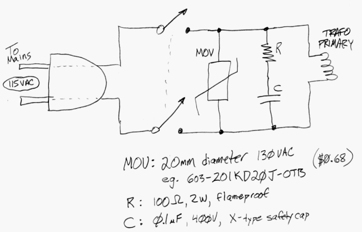

If your goal is to protect the switch contacts from inductive flyback (huge voltages!) when the switch opens (and dI/dt equals minus infinity!),
then I recommend providing a flyback return current network a/k/a "snubber" as shown below. This has the advantage that it does not contain a circuit path allowing AC current to flow, when the switch is in the OFF position. Capacitor-across-the-switch-contacts includes an AC current path from mains, to transformer primary, and back out to mains. Even at 60 Hertz. Even when the switch is off.

Sorry for the off-topic question, but I trust this won't be a huge distraction. I'm building an integrated chip amp with my younger daughter and would like to implement a snubber as suggested by Mark. How do I calculate the resistor and capacitor values where the transformer is 300 VA?

S. R. McGee is talking about an arc suppressing snubber to protect a power on/off mechanical switch -- not a transformer secondary ringing prevention snubber of the Quasimodo persuasion. Follow the hyperlink that SRM put in his post; it takes you to post #3230 where, as Ed McMahon of The Tonight Show often said, a child of four can plainly see . . . . . . it's an arc suppressor.
How do you calculate appropriate values for the arc suppression components? Let's see what the wise membership of diyAudio has to say about that.

Calculate? No idea. Pass uses 3300pF X1-rated caps that spark suppress the switch and do a little line filtering. I just blindly use those as I have a bag full of them... Seems to work so far.
How do I calculate the resistor and capacitor values [for a 115VAC on/off switch arc suppressor] where the transformer is 300 VA?
The market leader and "big gorilla" in this product space is called Quencharc, made and sold by Cornell-Dubilier and its licensees. Unfortunately Mouser offers Quencharc parts {containing one R and one C!} for ten US dollars. Ouch!
Luckily, Cornell Dubilier published a one page technical brief called "How Quencharc Works" which I am sure Google will find quickly. At the very bottom of the page, it left-handedly offers blanket advice: Buy our 100R + 0.1uF Quencharc, connect it in your product, and then use an oscilloscope to verify that arcs are fully suppressed. If arcs are NOT fully suppressed, just add a Metal Oxide Varistor in parallel and sleep soundly.
So I looked up Metal Oxide Varistors in the Mouser catalog and found that the ones rated "130V AC" appear to be a comfortable fit. In my opinion. 130V AC varistors won't fire under normal 115VAC mains operation, but they will fire if the switch contacts experience an arc event, even a mild one. And they cost less than a dollar so you still save Big Bucks building a three component arc suppressor, compared to paying for a Quencharc.
Schematic attached below.
