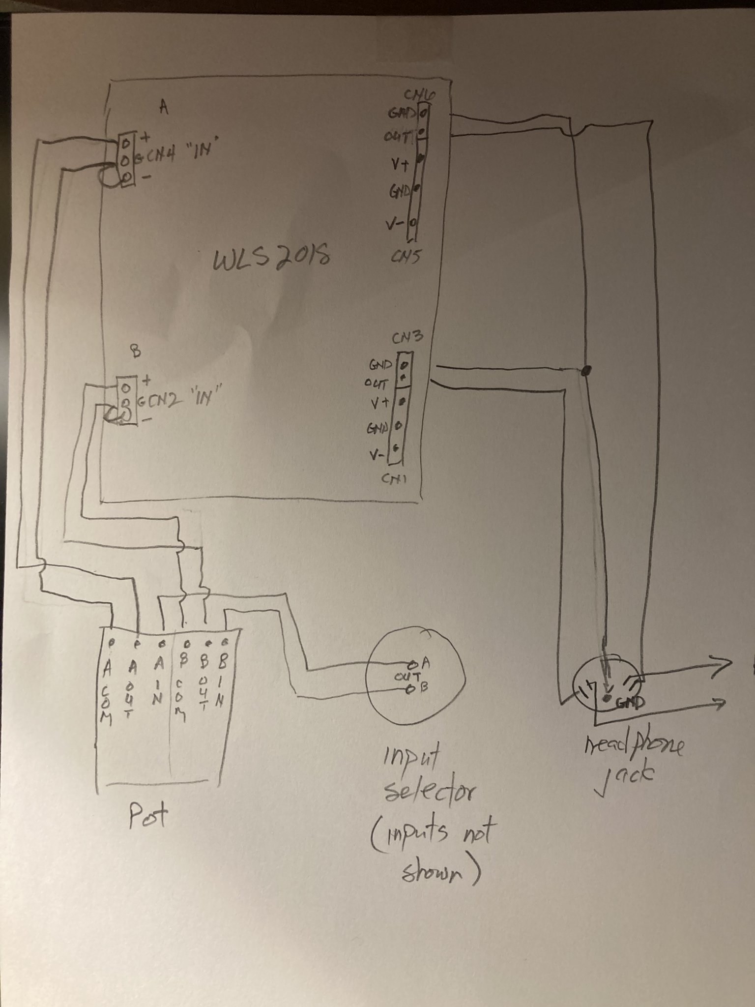

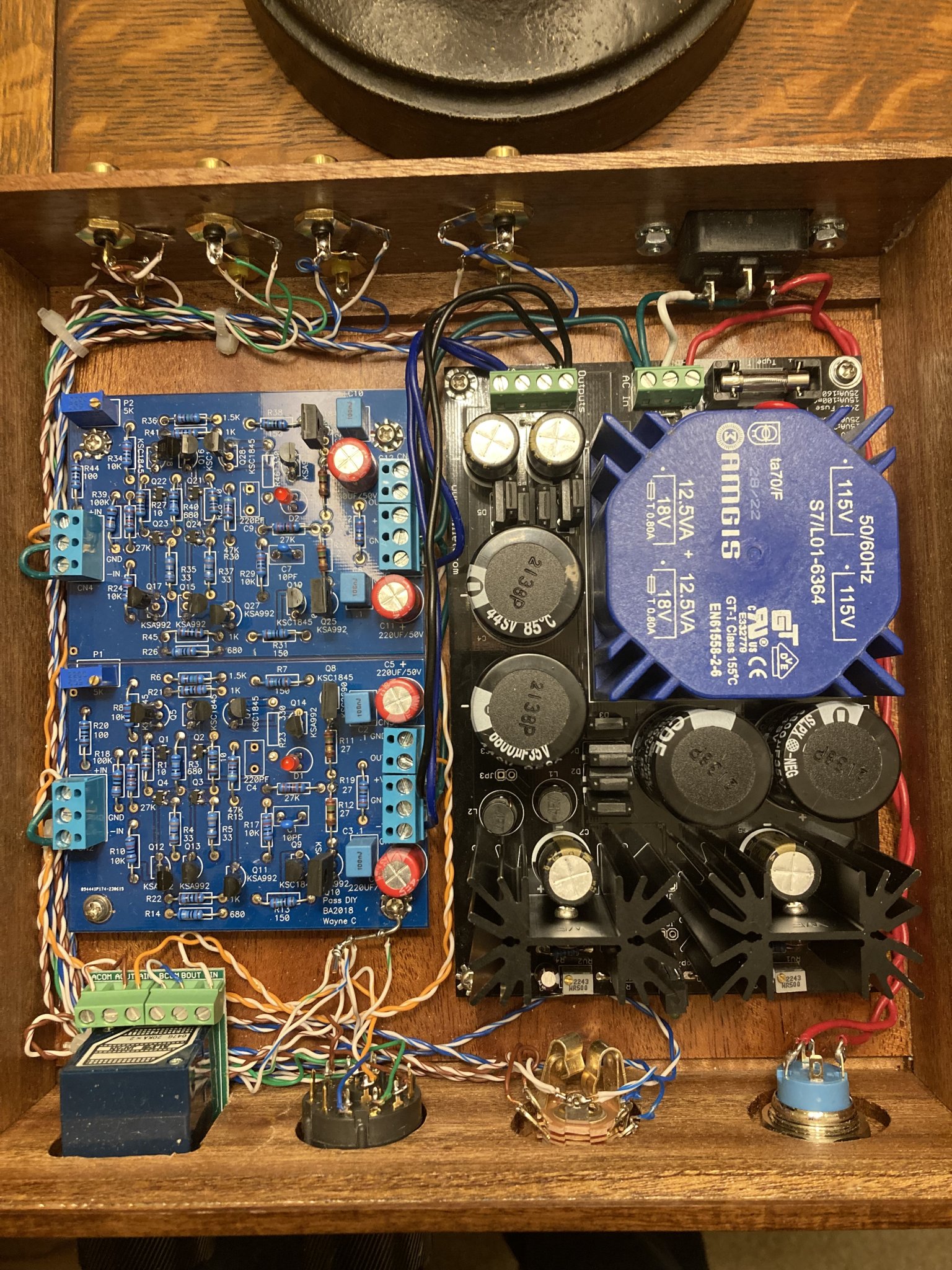

Need a few ideas. I built a Wayne's Linestage 2018. It's been terrific paired with an Aleph J. I wanted to try the WLS with my ACA mini. Connected it and got nothing unless turned up a lot and then it was very faint and distorted. Conected it back to the Aleph J --same result. I checked the power supply-- a Pete Millett 18-24 volt build. It seems fine. I rechecked all my soldering and it looked good except for those teeny tiny Q1-Q4 where the solder looks a little globby without a great flow. But, hey, it was working. Maybe that's it? I've included voltage drop measurements which seem to be requested a lot when others were asking for trouble shooting as well as a picture. LEDs are lit on pre-amp and PSU boards All of these are DC volts. Offset set very close to .000 volts. Picture included. would different measurements be more useful? Do these look like what they should be?

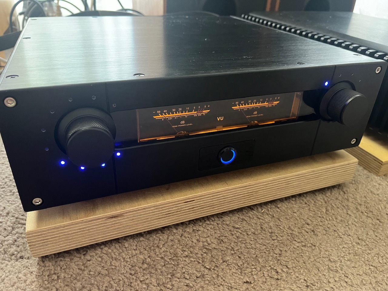

I’ve completed the third and final (Ha! As if!) iteration of my preamp. I'm starting to feel like Marge Simpson with her Chanel suit but I've had three or four other pretty good preamps in the system and I'm yet to hear one I like more.
The biggest change is that, after years of anxiously futzing about with balanced connections, cables and converters, I've allowed myself to become completely unbalanced (lol) and feel 100% better for it.
To some of you this box probably looks like an hilarious Rube Goldberg machine of redundant complications. I'm ok with that. This is just how I could do the things I wanted to do without four years of trade school and/or forty years of field experience. I've tried to use what I do know to have a bit of fun without causing any sonic degradation and, as far as I can hear, I've been successful in that.

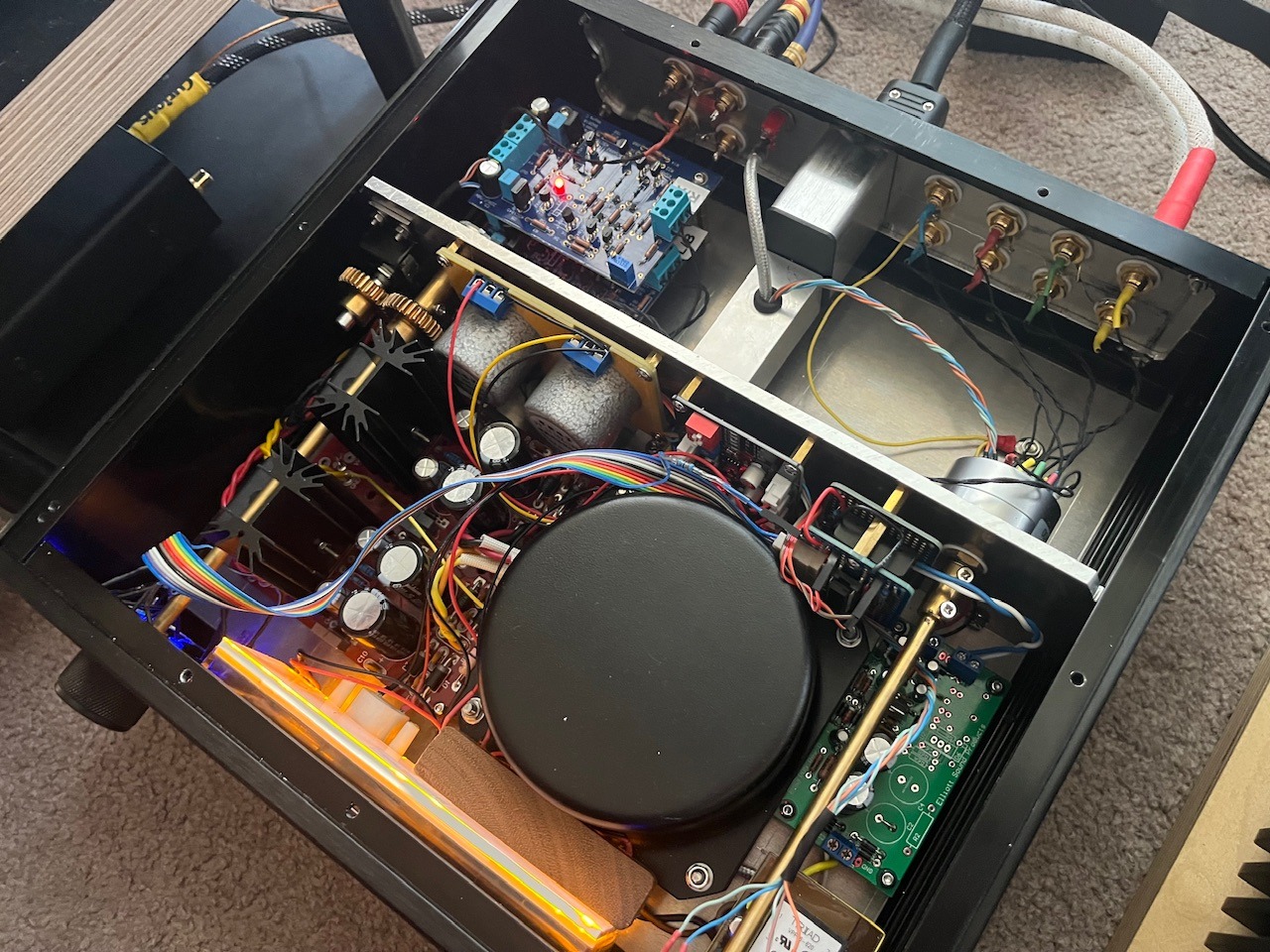

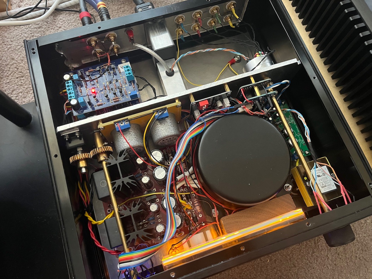

Here's where I've ended up:
- A Schurter filtered AC inlet
- a 50VA triad magnetics medical-grade (to utterly misquote Mr Pass, if it's good enough for dialysis it's good enough for music) toroidal transformer
- a Glassware bipolar lv-reg PSU
- An EIZZ 4-way input selector
- a DACT-style smd 21-stepped attenuator
- Duelund 26GA tinned solid copper wire in cotton and oil for audio signals
- Multicomp gold-plated, pure copper rca sockets
- half of a Rod Elliot P05 PSU with a discrete 10VA transformer, which drives:
- an LED input indicator
- LM3914-based LED volume-level indicators
- an AliExpress VU meter driver-board and VU meters, the signal wires of which are galvanically-isolated from the audio circuit with the redundant bal-SE converter transformers
- A slightly-modified/butchered 320mm aluminium enclosure from AliExpress
I was worried about potential interference from the VUs and LEDs (I worry a lot about interference. Can you tell?) so I put in a defeat switch for the P05, just in case any of it was audible. I don’t think it is, at least in my current system configuration. I still have an earth leak or some grounding issue somewhere. It's not bothering me enough to chase down at the moment but I'll need to address it at some point.
That brown thing is an organic, dielectronic, cryometrically-isolated quantum-state resonator and definitely not a bit of decking off-cut I jammed in there because my sticky came unstuck. No siree. Nope.
So, I've ended up pretty much where I wanted to - insofar as the operation and "features" go - and it certainly sounds superb (which I can’t really take credit for. But I didn’t F it up, which is something). It's not as elegant as I imagined, either in an aesthetic or tactile sense but it's not bad for a (mostly) first go. The LEDs are a bit bright but I’ll fix that when I get around to it.

6L6- Thanks for your comment directing me to the pot. I discovered a bad ground on it and fixing that took care of the problem. We're back to listening to music. Life is good.
Bad grounds do that.
Still, is the pot attached to the output? Trying to determine your wiring...
Yes, the pot is attached to output. It goes from the PCB to the pot to a switched headphone jack and then on to the speaker terminals.
Well not to the speaker terminals but to the RCA outputs to the amp and then eventually to the speaker terminals.
That isn't where volume pots go...
Input
input select switch --> potentiometer --> BA2018
output
BA2018 --> headphone jack- --> output jack
Input
output
They can of course go there. But he will not be able to take advantage of one of the key merits of this linestage: it’s very low Zout. Plus other disadvantages affecting frequency response. I still miss it, but way to gainy for my setup alass.
Zen Mod- Because in the absence of finding info on interconnections between components it "made sense" that this was the way to do it. It did work fine after discovering the grounding issue.
only in very rare cases does it make sense to put the pot before the output. In most cases input and output impedances make before the input the best position. For an example of a pass design that favours it before the output, see some of the zen pre’s on passdiy.com. Move it like 6L6 sez and enjoy an even better WLS.
