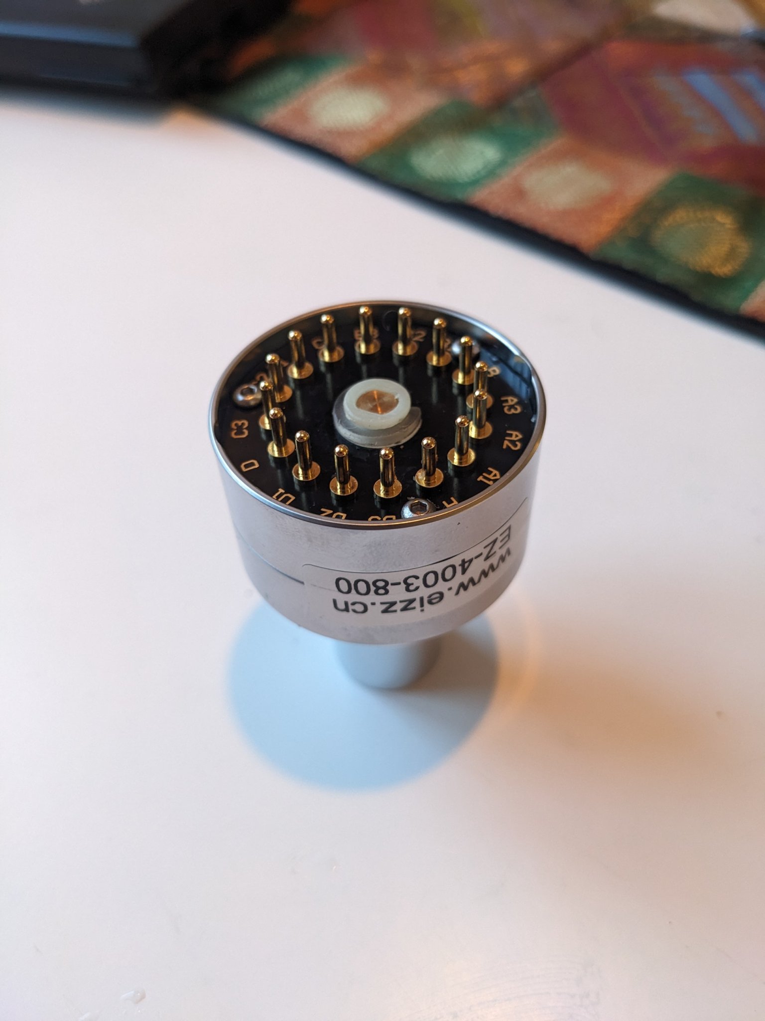

Ok I see mine has only one channel. Does this one work? And if so, is it of considerably lesser quality then the one you recommended?
https://www.audiophonics.fr/en/elec...ns-stereo-selector-notched-shaft-p-15495.html
I'm not familiar with that one in the link. But for the price point would estimate it is of lesser quality. I would still suggest the Elma after using a sub-part switch in a previous build. The audio sounded like crap until I completely removed it and tested it. Not trying to get you to overspend, just want to help you get a good-sounding build.
As for the one you already have, I'm not sure it is even operable. On one side I see a tab with extra notches - and do not see a corresponding tab on the other side - and there likely should be.

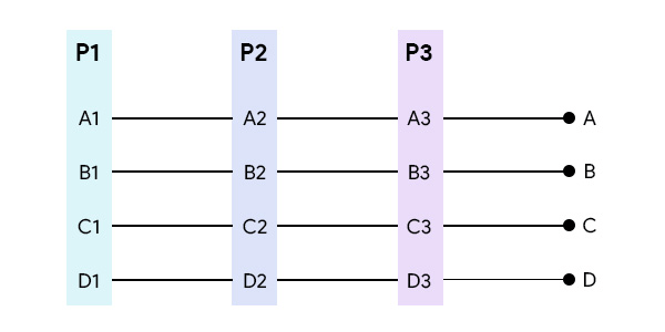

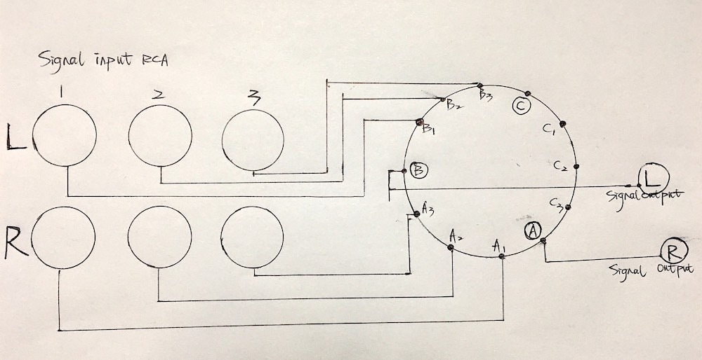

So I ordered this input selector and will try to get it to work. Great that I don't need to solder a PCB and order extra parts! Thanks for this suggestion. Can someone point out how I have to wire it for 3 input channels? Cannot find an instruction online.
Yes I have seen this, thank you. What do I need 4 contacts per input for? 2x hot, 2x ground? Sorry, never done this before.
