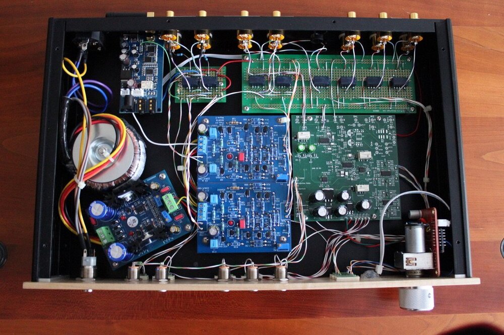

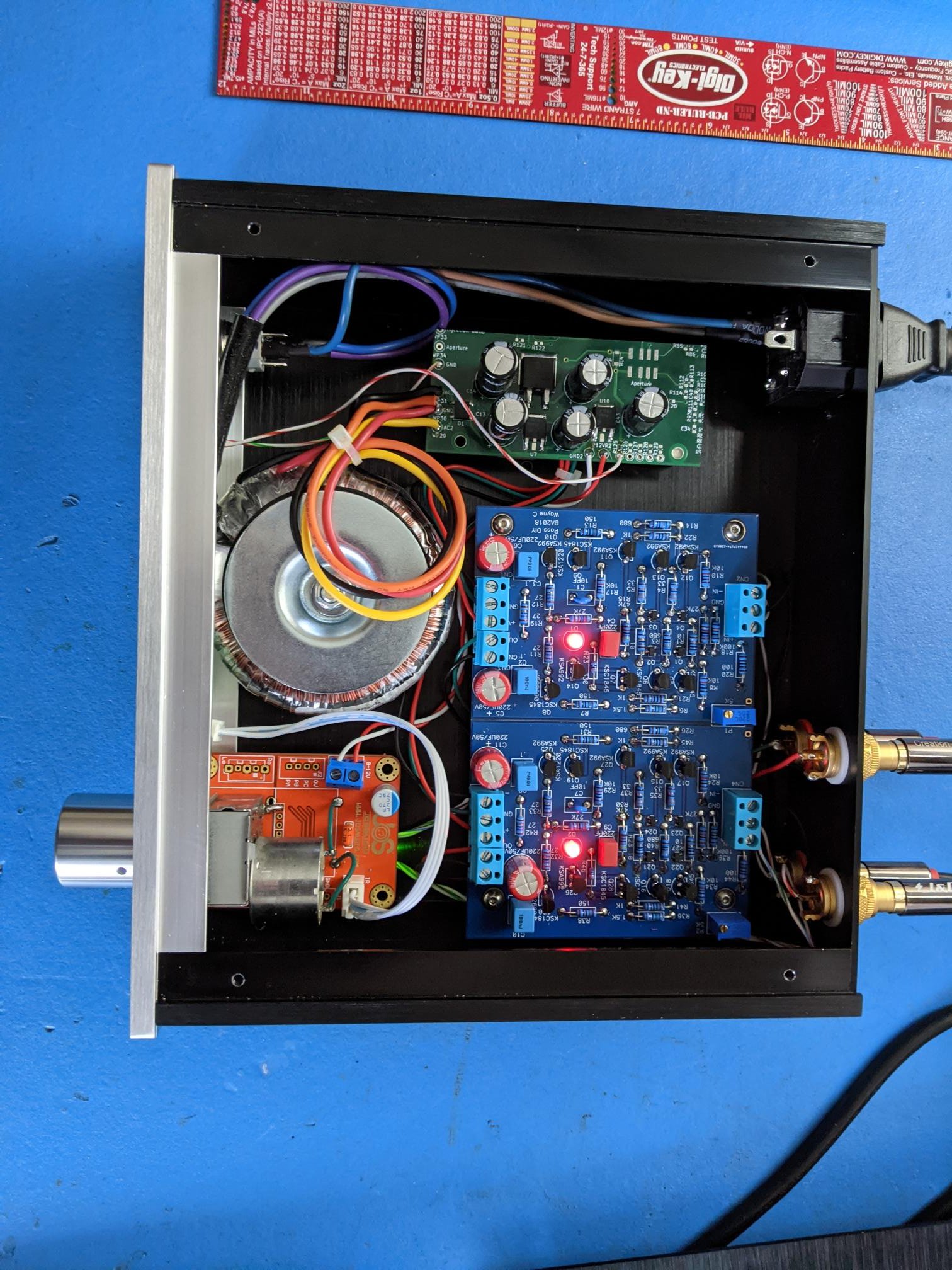

Really enjoying my preamp(s). Lots of interesting units here ..... you guys love your power supplies.
Thought I would share a few pics.
Left:
Remote volume and remote input switching.
Power supply is a knock-off of the "Super Regulator" which is out-of-stock here.
The other board is surface mount implementation of Carver Sonic Holography (default=bypassed).
4th input is Bluetooth.
External processor can be switched in (default=bypassed).
Right:
Remote volume
Power supply (hacked off another board) = +/-18V and +12V for the remote board power.
Left:
Right:
Remote volume

Left:
Super nice, smoovj! 👍 Would love to hear more about the surface mount Carver piece. I'm also a bit jealous of the Bluetooth input. What a great idea for when you find something on your phone and need to hear it now without all the hassles of cables and such. How do you put that device into search/connect mode?
Thanks for the comments.Would love to hear more about the surface mount Carver piece.
I think the Carver C-9 Sonic Holography Processor has an interesting affect that I sometimes enjoy. Thought I could shrink it using surface mount with relays for the switching. Make it small. I was looking for a project. I laid it out, got a handful of boards fabricated and built some up .... I think it has almost 200 surface mount components, mostly 0603 size. Built a few boards by hand. Note it has a 2 channel simple op-amp preamp in the upper right corner. I didn't load that part of it for this build as I was using the BA2018. Also has it's own regulation (+12V, -12V, +12V for remote board, also powers the BT module.
The BT was a bit of an afterthought. The module was cheap. I was worried a bit about digital noise. With BT selected, no input playing and the volume up around 12 o'clock, I can hear a bit of low level digital noise, but I'm OK with that. It can't be heard when BT source is playing and is non-existant with analog inputs selected. It's a nice feature for under $20. I did have to work hard to make everything fit ... much easier if it wasn't there. Easy to hook-up.I'm also a bit jealous of the Bluetooth input.

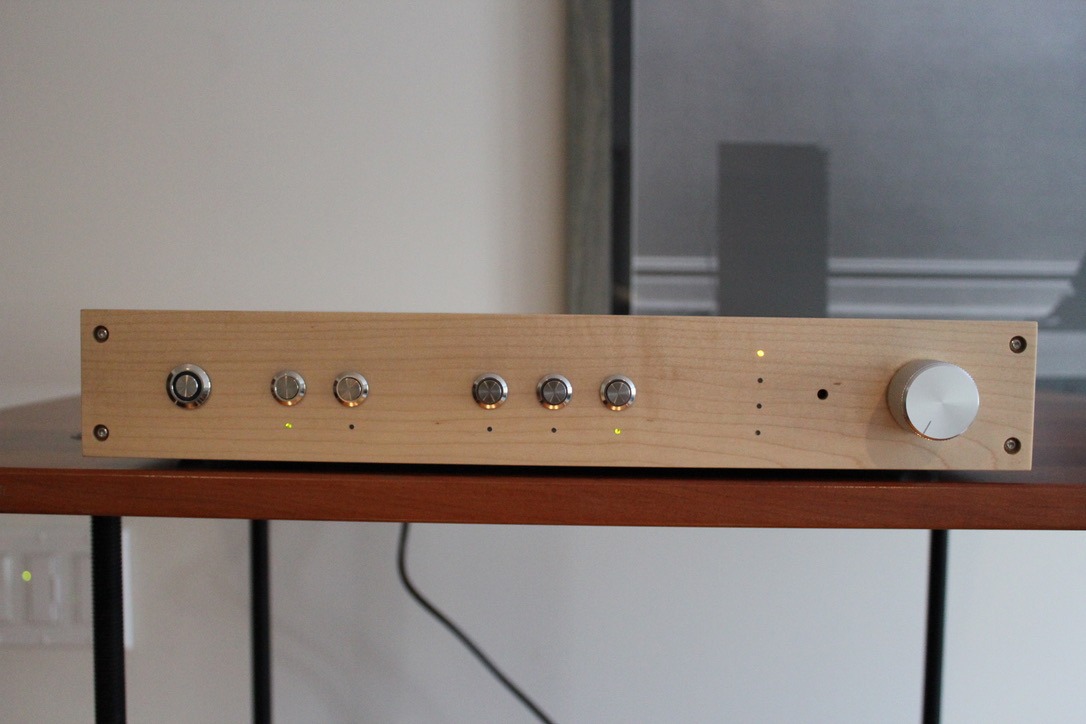

Front view attached.
Power
Disconnect (disconnects the outputs)
Ext Processor Select
Next 3 switches are for the Sonic Holography functions
Vertical LED column is input select - amber LEDS for 1-3, blue LED for BT.
