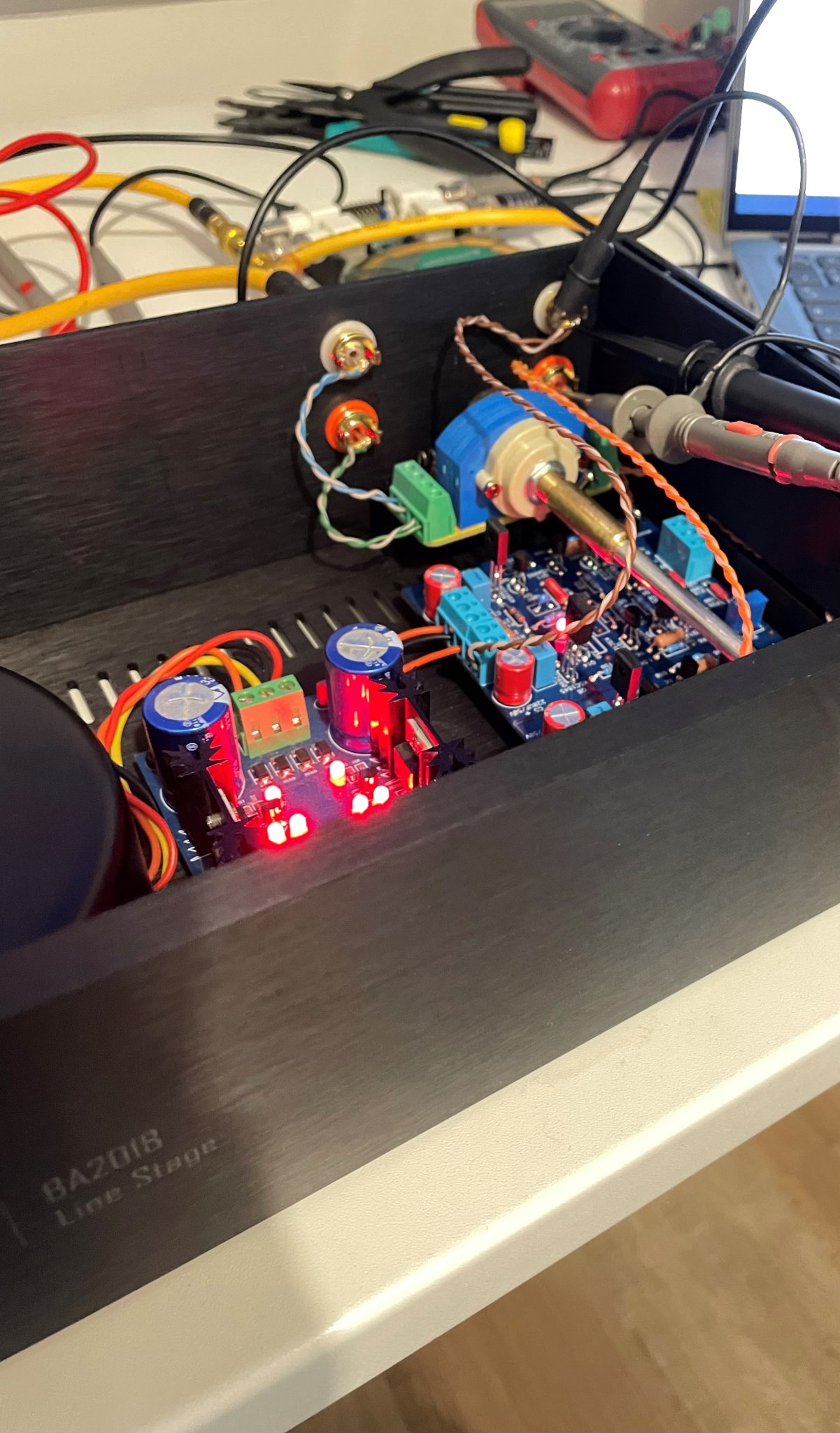

I've finish the build of the BA2018 LineStage.
Everything is Ok but i've a small oscillation on the outputs ...

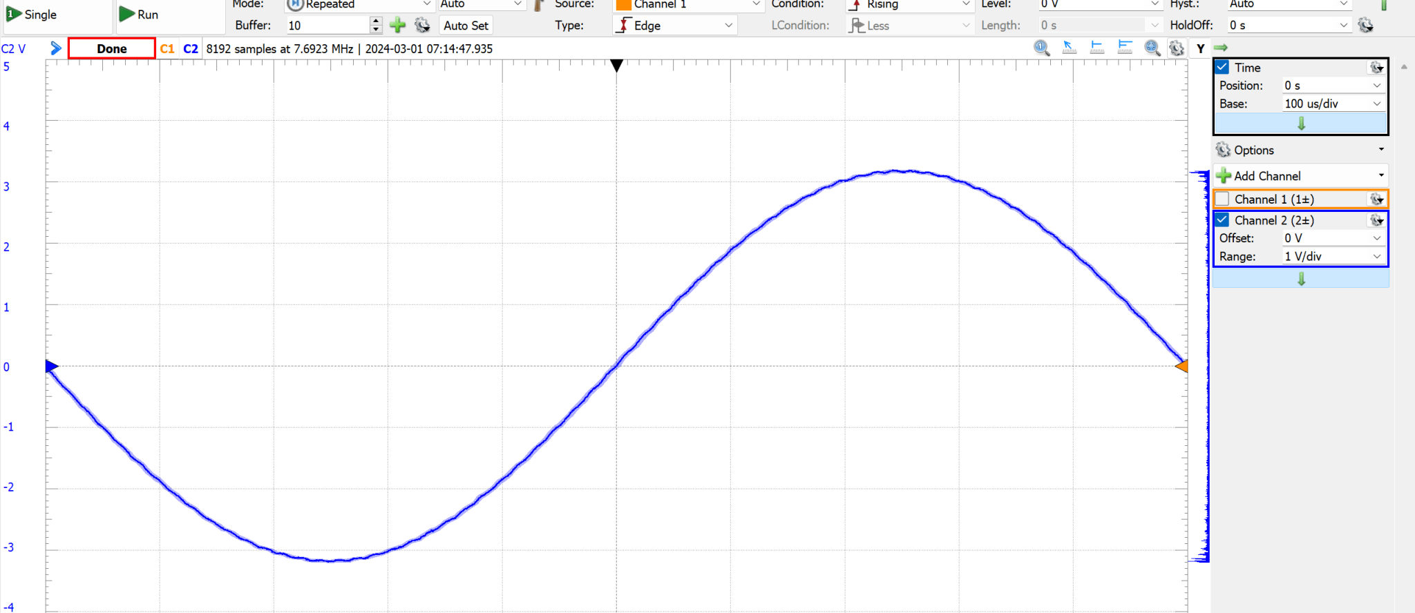

_Capture 1 : Signal 1Khz / 2V PP / Volume pot @ MAX / Wavy curve ..... (Do you think it's normal ?)

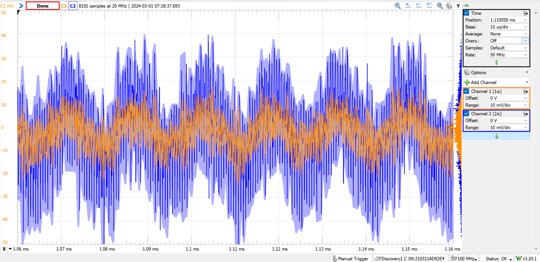

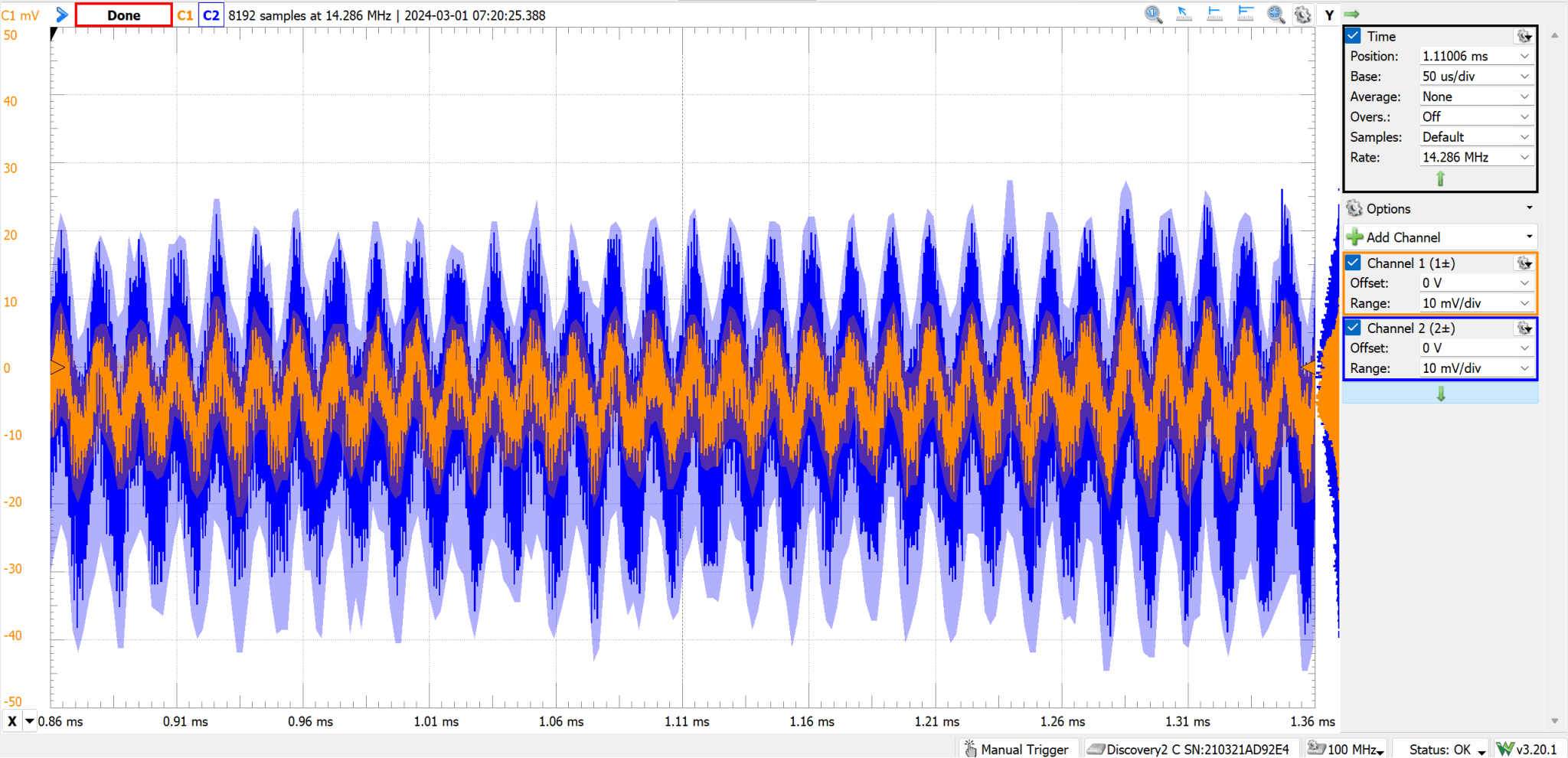

_Capture 2 : No signal / Volume pot @ MAX / 10mV/div
_BA2018 LineStage :

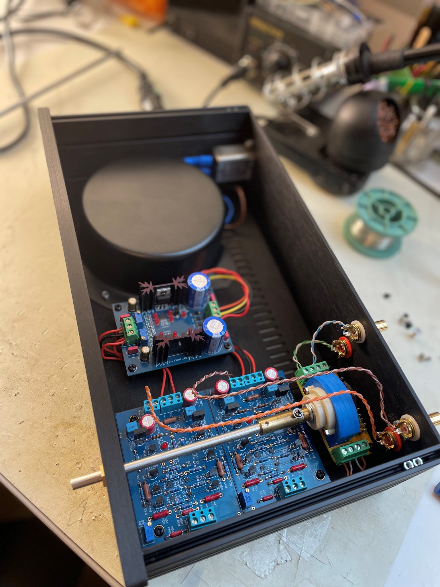

- IEC EMI Filter
- Talema toroidal transformer 50VA 2x18V
- Regulated Linear Power Supply Module Dual LME49710 / MJE15032 - +/-18VDC Output
- 100K Sterero stepped attenuator
Thank you again Mr Wayne Colburn & Community !
What was the load during the measurements?
Was the input shorted for no-signal measurements?
Can you make a fft spectrum of these signals?
Have you checked the output voltage from the regulators on the oscilloscope?
If you turn off the linestage does the oscillation disappear?
Looks perfectly fine. Short your inputs, max your pot, then make new measurements without signal. Since it also seems to sound fine, no reason to worry.Hi,

If still an issue, post exact circuit you used with all values, and tell us what you possibly changed from the original.
Might not be relevant but I see you have one PSU and a WLS board where ground planes for L an R channels is not connected together. At least on the board.Hi,
