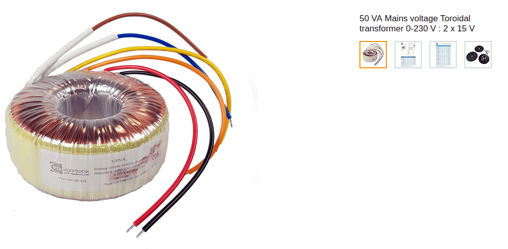

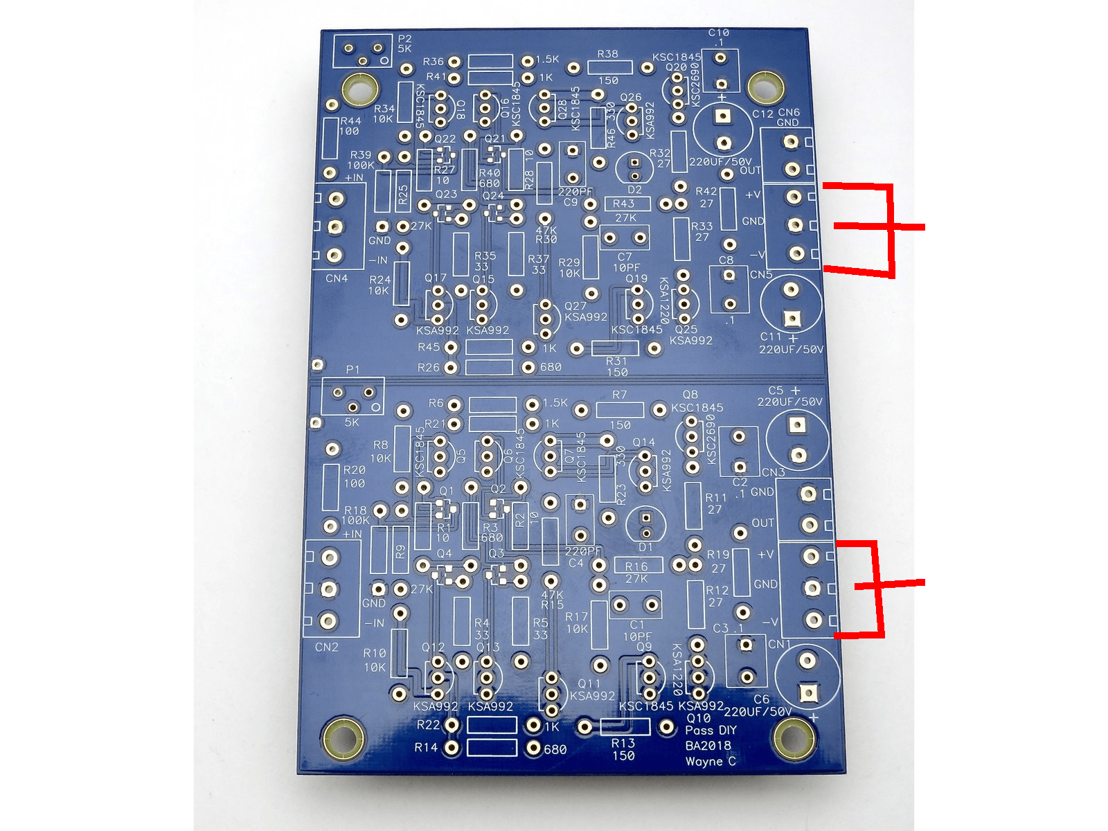

For me it's not clear how to connect the psu. I have this new toroidal transformer that I never used. It has 2 x 15 volt AC. Actually the voltage is a bit higher, 17 volt. So I need a rectifiers for DC power. How do I go from 2 x AC to 2 x DC with 3 cables (one for ground)? Most images here I can't follow the cables. I should take the ground from the case? Do I need a ground protector loopback?

I assume the photo you posted is just an example; the toroid's label indicates the secondaries are 25V. Using that toroid as an example, though, the red and black wires are the primaries -- they would be connected to the 230V AC live (after the fuse and switch) and neutral connections. The orange and yellow wires constitute one secondary and the brown and blue wires are the second secondary. The secondaries are also AC; they need to be connected to rectifiers (e.g., two bridge rectifiers) to convert the voltage from AC to DC. You need a capacitor bank for your power supply, and by properly connecting the DC output from the rectifiers to that capacitor bank you will end up with +DC voltage, Ground and -DC voltage, which is then connected to the two sets of power inputs on the BA2018 pcb.

You need a power supply board to give you rectified, DC filtered power. That isn’t part of the diyAudio store kit.
No, the red and black are not the primary on the pictured transformer. The Brown and Blue are the primary wires. As per the label on the transformer and conventional wire colours for mains.Using that toroid as an example, though, the red and black wires are the primaries -- they would be connected to the 230V AC live (after the fuse and switch) and neutral connections.
I'll follow up SRMcGee by suggesting that an easier route might be to use a different transformer, one that is AC in and DC out. For instance, the Antek AS-0518 is popular for the BA2018 build. https://www.antekinc.com/as-0518-50va-18v-transformer/ just in case.

pretty sure these transformers output AC if their input is AC.
you still need to rectify to produce direct current.

Bert, Your transformer is fine for the preamp. As others have said, you need a power supply circuit to convert AC to DC. A good one to use is the VRDN bipolar power supply by Mark Johnson:
