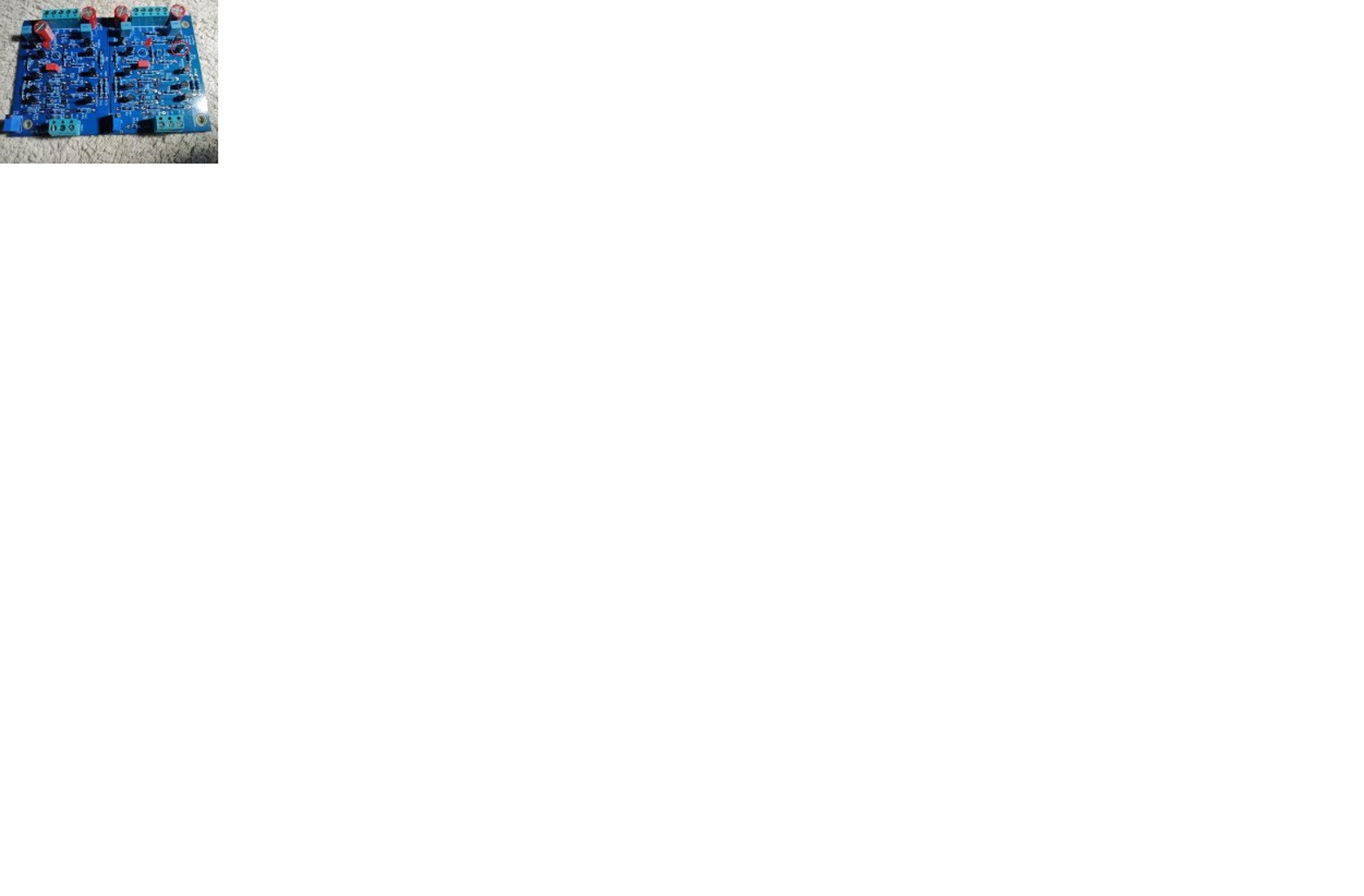

Hi you all,
The boards arrived last week, and so today I started assembling.

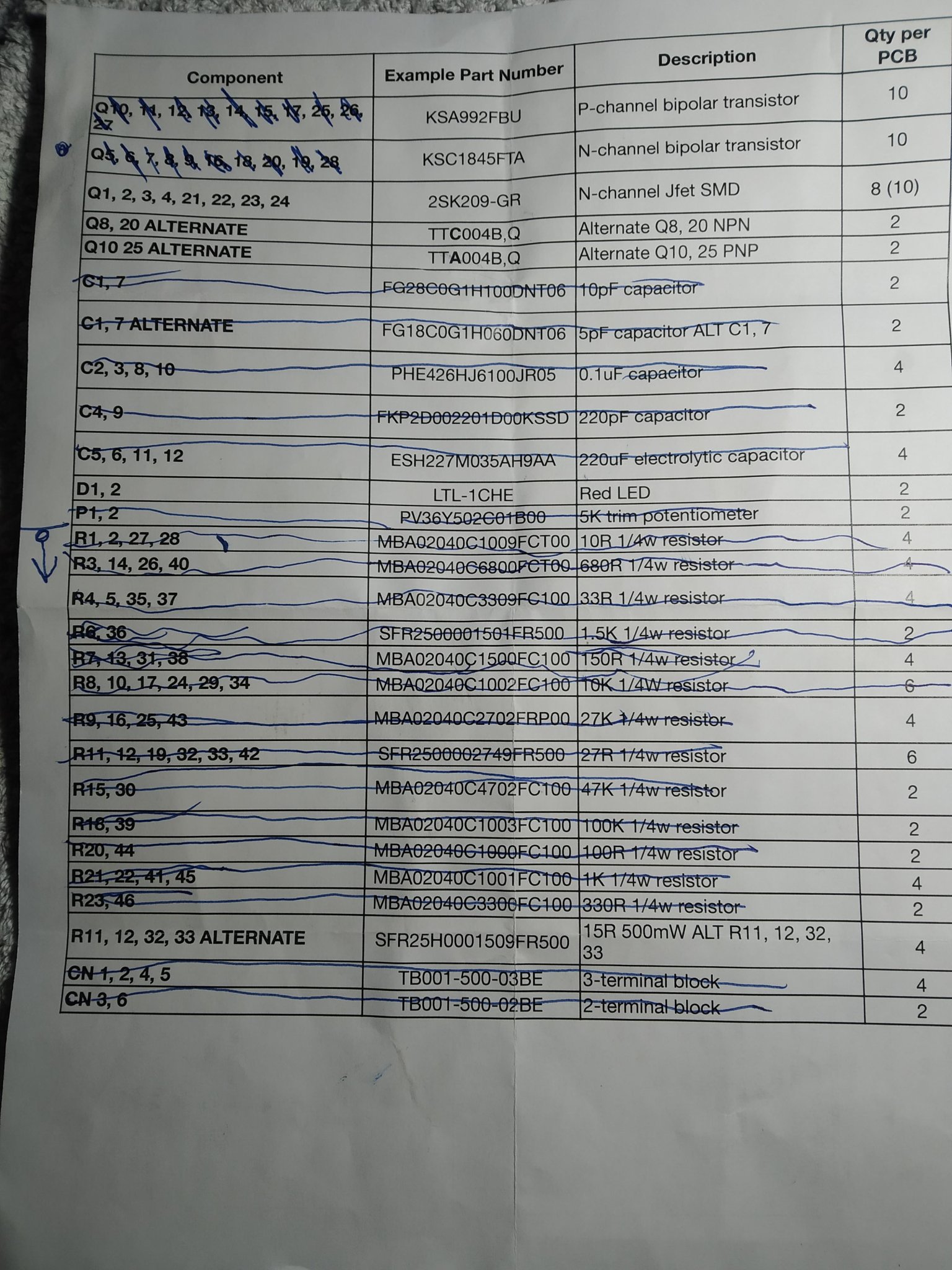

Now there is a note on the guide: ¨Please note that the PCB shown stuffed is setup for using the “big” output transistors, where R11,12, 32, 33 are 15ohm, and R23, 46 are omitted.¨
Well, at R11,12, 32, 33 I soldered the 27R and at R23 and 46 I put in the 330R. Is this correct?

Before soldering, first decide whether you'll use TO92 or bigger output TO126 for Q8, Q10, Q20 and Q25.
If you'll use TO92, then you're on the right track.

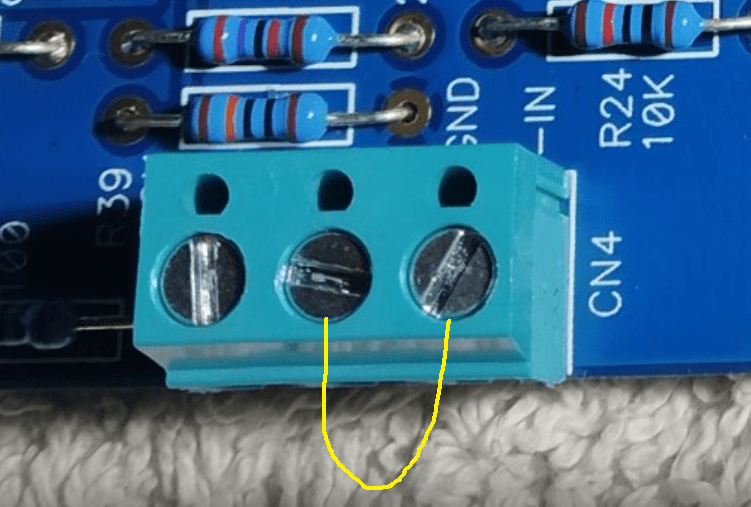

I have a question: both power and audio in have 3 connections, a +/-/ground. I only have 2 wires each for right and left audio and power? 🤷♂️
a look at the schematic should sort you out.
the three point signal connection on the boards is to facilitate an optional balanced mode.
the power connections are +/GND/- and you should have three wires from the power supply. if you don't...

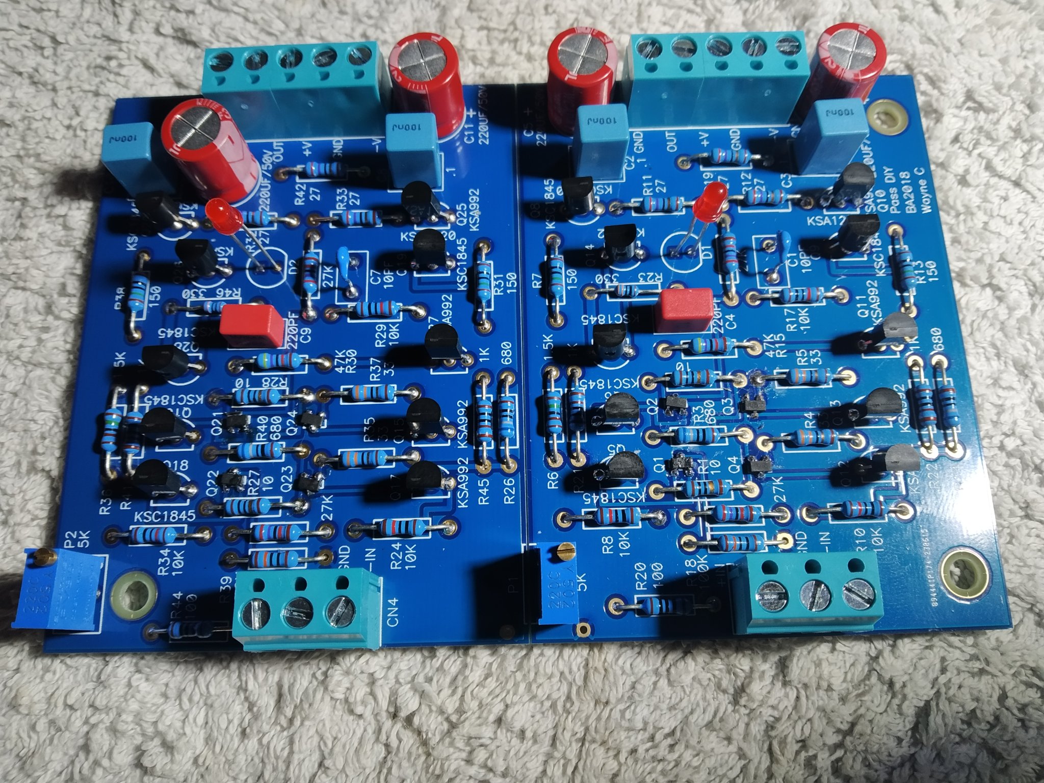

Sorry my pic was so small, you may want to check Q9, one of the 1845's looks like it is installed backwards.
Q9 has been fixed. Sadly the leds light up only very dim, and no sound 😒 Does this device need earth grounding from the wall socket? I dont have an earth connection in my livingroom.

Before anything else, check continuity between all jfet legs and the next point in the circuit (meaning a total of 12 measurements with dmm set to ohms). You want readings of about 0 ohms. Push the jfets slightly to dee if the measurements change (a bad sign).
Then please post even more pics, and verify that all the bipolar transistors are the correct type in the correct location with correct orientation, and also double check diode orientation. The diodes are part of the biasing circuit.
Also, please measure and post voltage drops across all the 10 ohm resistors in conjuction with the JFETs (dmm set to mV, one probe at each leg of the resistor).
Then, measure voltage drop across bias resistor.
Post results.
This circuit can be a real biatch, and jfet issues is the most common. And not to be impolite, but you - like most of us - could use some training in smd soldering - the most difficult part of the job in this case.
