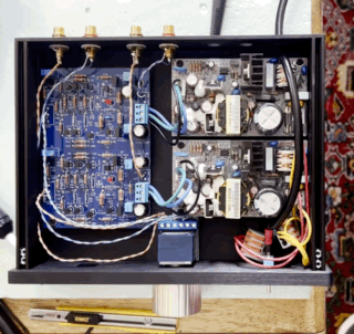

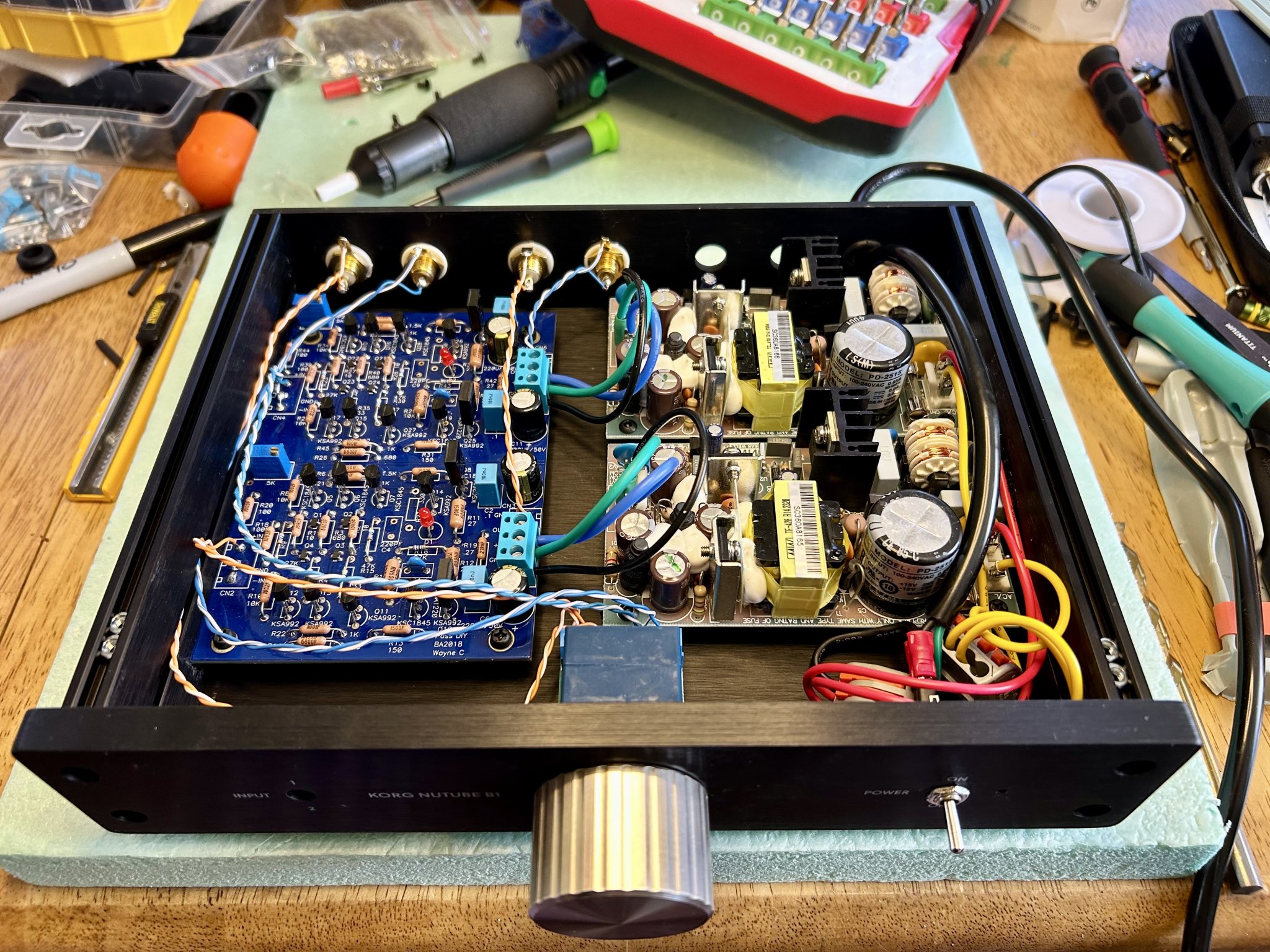

Today was the day for me to button up my WBA2018. I have 2 Meanwell +/-15VDC SMPS units in a Korg B1 chassis for full dual mono after the AC mains in. I added a switch on the front, drilled holes for/secured the PCBs, and added a grommet for the mains cable. Tight fit, but success!
Edit: it sounds fantastic with my ACAMini.
