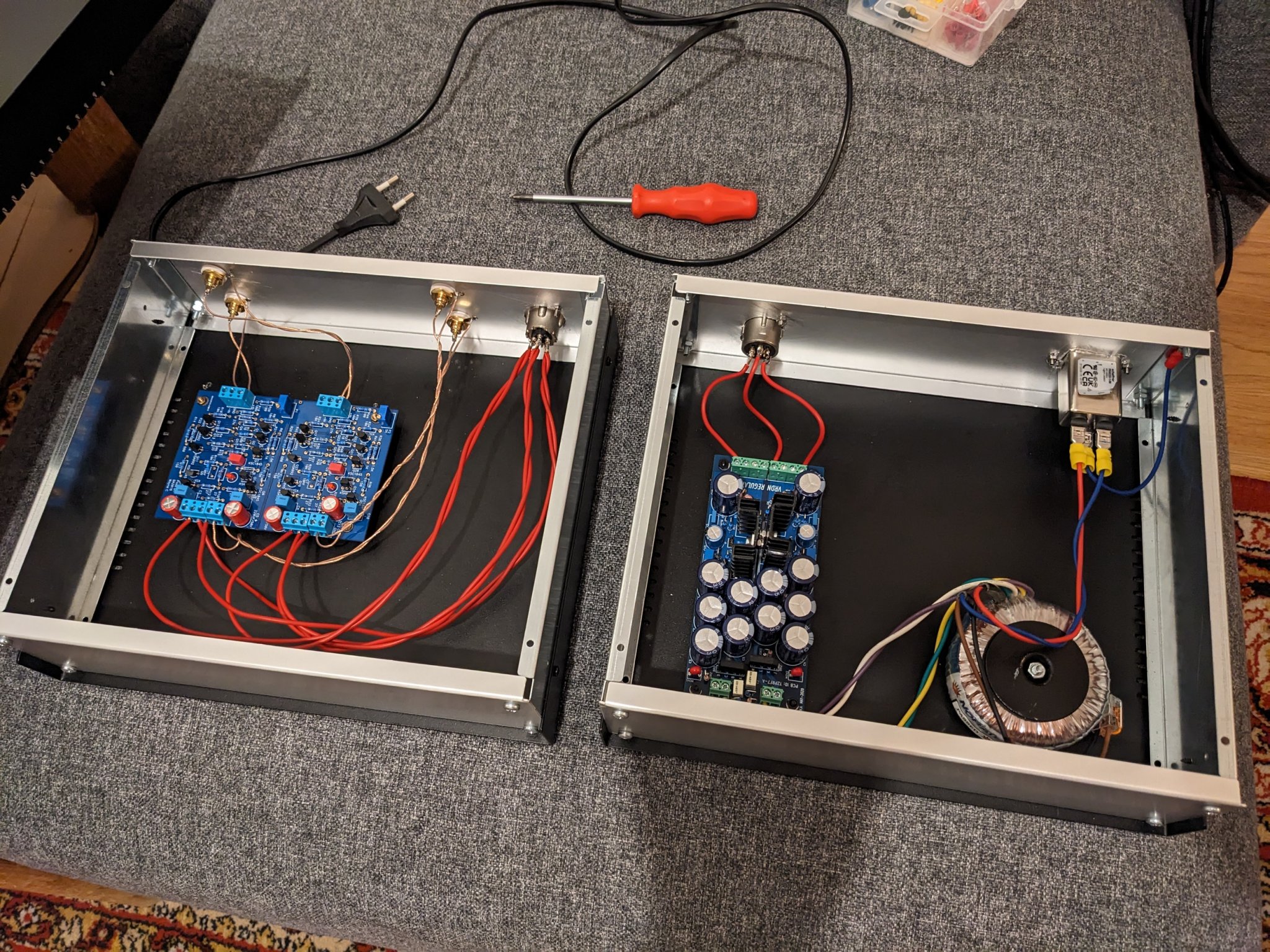

Dear fellow builders, I need some advice to finish my build of Wayne's Linestage Preamp. It's only my third build (after ACA and ACP+) and I'm quite frankly blown away by this one. I really like the premium ACA and Wayne combination a lot! I have just not found a source for a input selector PCB in Europe yet and I also don't have a clue how to assemble and implement it into the build. Can anyone help me with this? Also I would love to have a headphone output on the Wayne and I saw that this is possible. How can I achieve this? Thanks a lot for your help!

PS: a friend sold me his Mark Johnson VRDN and I have made a seperate LPS from it with XLR connectors so i can swap out my preamps 🙂 as you can see down below

peterpaan89, I'll agree with myleftear: the Elma would be a really nice selector switch. You'll wire your inputs directly to the switch as there is no PCB to deal with. Just keep the bundle of input wires twisted together on their way to the front panel and you'll be fine.
You mentioned headphone output from the Wayne. I can't quite tell from your photo but did you install the larger output transistors? You'll need those for headphone output.

Thanks for you suggestions. I'll try and get the Elma switch and then install the larger output transistors. So is the only thing I will otherwise need the headphone jack like NEUTRIK NJ3FP6C, right? 🙂
@peterpaan89 there are a few other changes with using the bigger outputs. Just wanted to be sure you realized that.
That Neutrik is very nice. You'll need to decide if you want the outputs to turn off when you plug in the headphones. If so then the Neutrik jack you mentioned is not going to work. That one in particular is a locking jack but apparently not a "switching" or "shorting" jack. (had to look that one up!) But if you still want the quality of that jack (and why not!) then just wire it in parallel and turn off your amplifiers while you have your headphones on. (This is what myleftear likely meant when he said, "(either a shorting Jack (plug in the headphone and the output is off) or both outputs parallel.)"

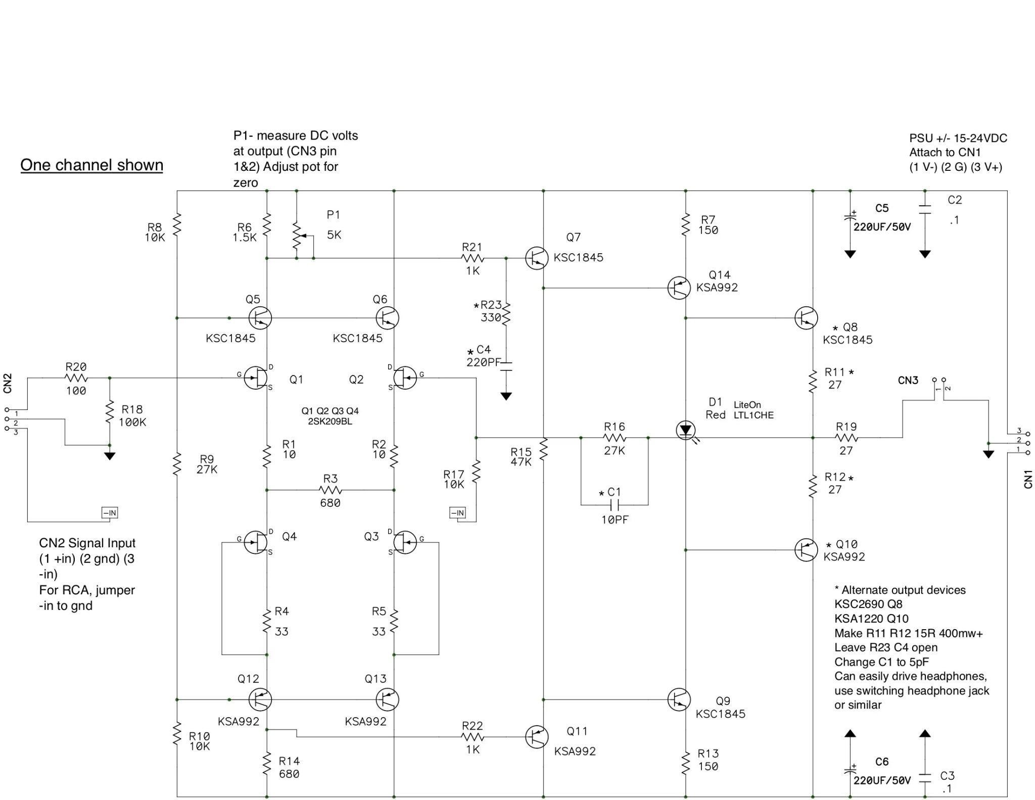

Here is the annotated diagram.
Hello Peter,
you will have to change to bigger output - BJTs:
Q8: change to TOSHIBA TTC004B (or KSC2690; difficult to get)
Q18: change to TOSHIBA TTA004B (or KSA1220; difficult to get)
I prefer TOSHIBA TTA004B / TTC004B. Watch out for correct orientation on the pcb!
You will have to change:
R11 and R12: change to 15 Ohm (0.4 W or higher)
C1: 5pF
R23 and C4: out /disconnect from circuit
Cheers
Dirk

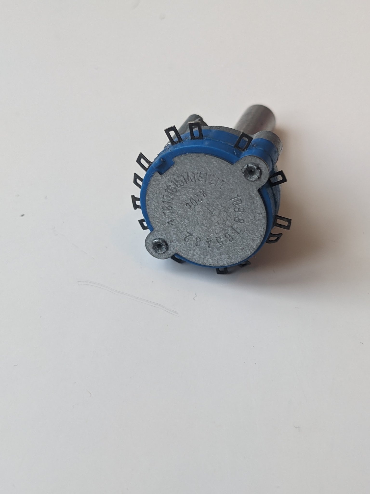

Okay thanks a lot so far to you all, this is very helpful. So I guess I need to order some stuff first before I can do the headphone output. Concerning the input selection, I already have this Alps 3 way switch. Do I even need the Elma then? I assumed it was only a switch and I needed a PCB for it.
The switch must be a shorting (break before male) one and 2 channels are required…
Ok I see mine has only one channel. Does this one work? And if so, is it of considerably lesser quality then the one you recommended?

Well, we males are often broken... no question...The switch must be a shorting (break before male) one and 2 channels are required…
You have it reversed - A shorting switch is a make before break.
Which one are you telling our friend to get and why?
MBB - Make Before Break - shorting
to avoid pops when switching inputs, due to statics and slightly different voltage potentials
