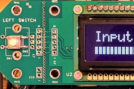

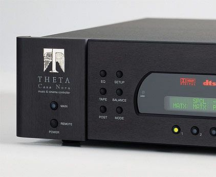

I recently received an Academy Audio MCL control board with my ISS kit. It has a momentary contact switch (LEFT SWITCH in the pic) which can be used for power up, if so desired. I am searching for some kind of rubbery button that could be installed on the front panel which would allow me to use the MCL switch, but am not having much luck. Specifically, I'd love to have something similar to what was on my Theta Casa Nova. It doesn't need to be lighted. I've searched Mouser for button caps, button hardware, etc., etc., but not seeing anything like this at all. Any guesses? Pics below of the MCL switch and the Casa Nova buttons. Thanks!

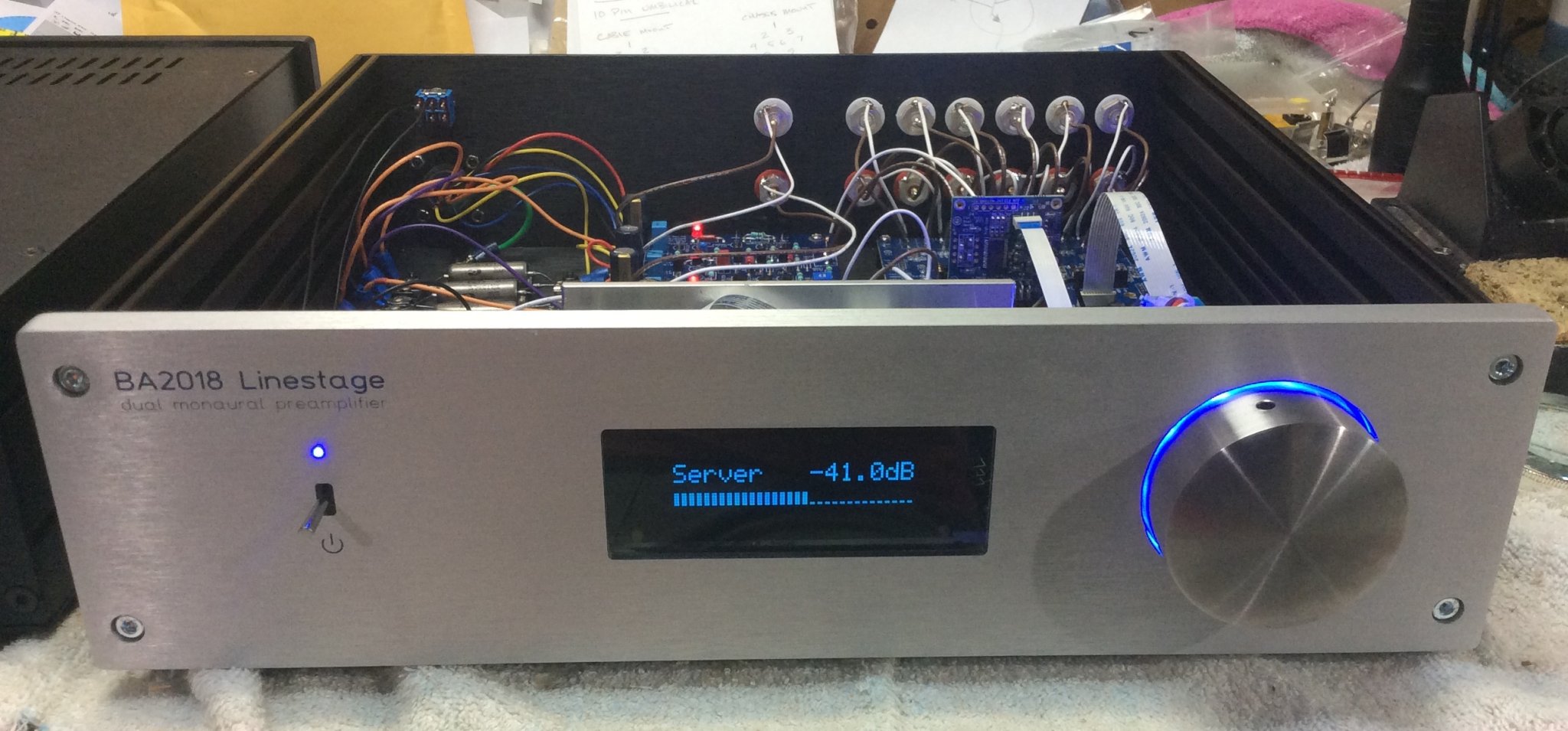

This will probably be of no interest to you but I dispensed with the breakaway left end of the MCL board, replacing it with a toggle switch. If you can't find a nice quality, rubbery momentary switch, perhaps you'll consider a toggle alternative?

Hey there, SRMcgee! I was studying the pics of your build just last night and was thinking about implementing a toggle, but really want my front panel to have little or no silver/chrome except for labeling. It will be mostly anodized black which is why the rubberized button was what occurred to me. Maybe I'll have to search for an anodized black toggle.
Edit: I think what I'm up against is that the existing switch is flush to the board. I either need something to get through the front panel to activate it, find a taller switch or do what you did and move it somewhere else...

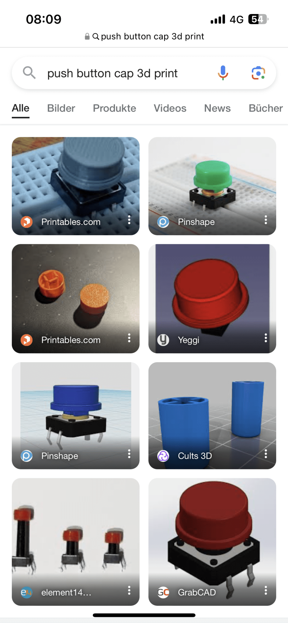

Try google!
https://m.littelfuse.com/products/s...r-caps-for-push_button-switches/83280_03.aspx
https://www.we-online.com/de/components/products/PBTU_PBSU_9_8_X_18_5_CAPS
Or
Which is inspiring: you could print a mold (the button in negative, inner and outer shape) and make your own button cover out of silicone… 🤠
Or
Nice! I did try Google, but didn't quite get the same results. The German PBTU looks nice.
The 3D print idea is really cool. I have avoided that world mostly because it will take time away from my DIY audio building 😱 but I do know someone who would take the project on. Cool!
There are enough ideas which have surfaced today that I can probably move on with. Many thanks to you both.

It might be easier to 3D print or otherwise fabricate a little top hat shaped post, with the larger end (brim) toward the switch. That post can go through your panel and with the brim is larger than the panel hole and will keep it from being able to be pulled out.I recently received an Academy Audio MCL control board with my ISS kit. It has a momentary contact switch (LEFT SWITCH in the pic) which can be used for power up, if so desired. I am searching for some kind of rubbery button that could be installed on the front panel which would allow me to use the MCL switch, but am not having much luck. Specifically, I'd love to have something similar to what was on my Theta Casa Nova. It doesn't need to be lighted. I've searched Mouser for button caps, button hardware, etc., etc., but not seeing anything like this at all. Any guesses? Pics below of the MCL switch and the Casa Nova buttons. Thanks!

🙂 Yes!It might be easier to 3D print or otherwise fabricate a little top hat shaped post, with the larger end (brim) toward the switch. That post can go through your panel and with the brim is larger than the panel hole and will keep it from being able to be pulled out.
And that's the exact part I was looking for in a rubberized form. The brim part is what I'm not seeing online, but am actually finding some rather cool alternatives.
