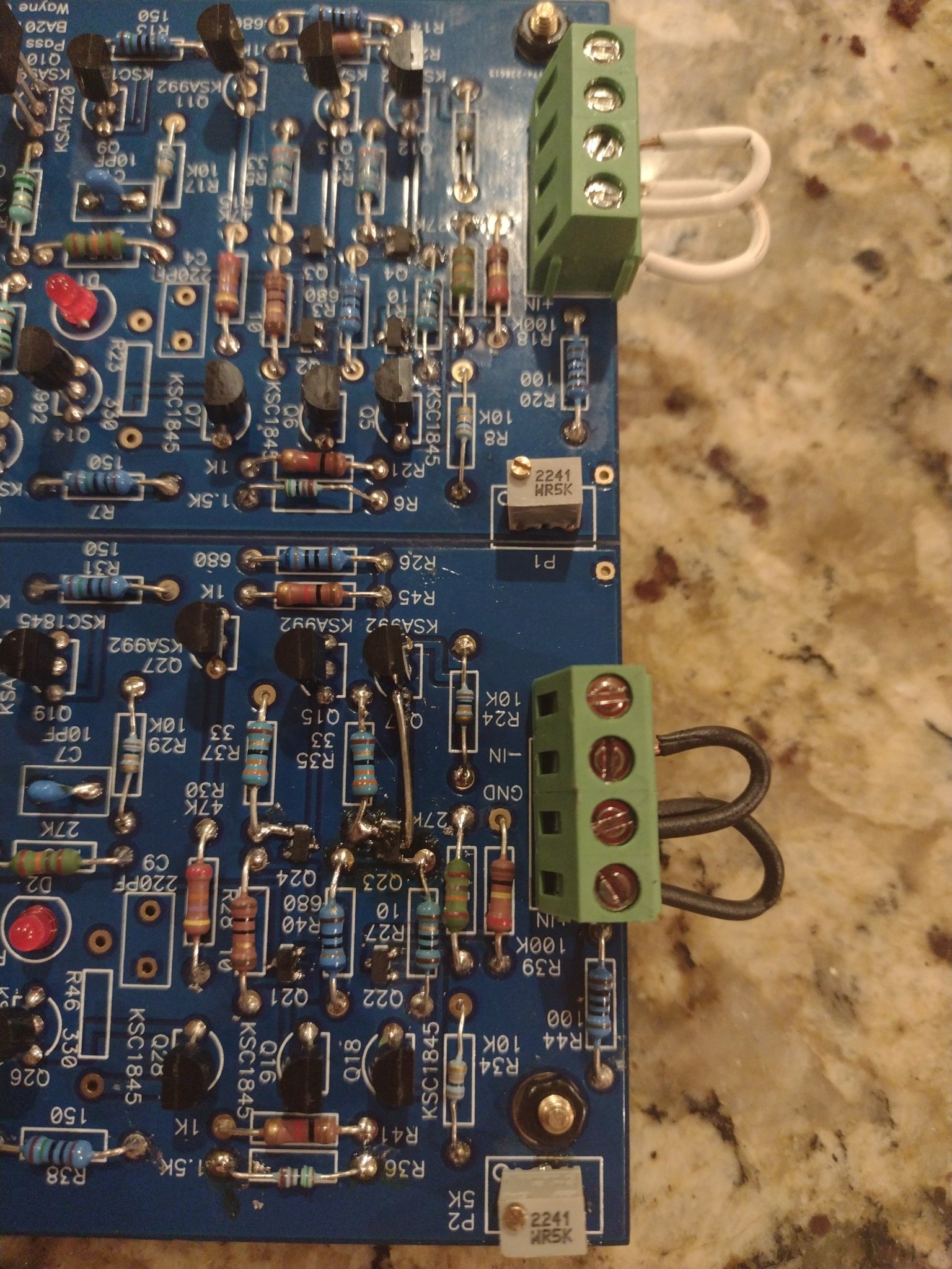

Warning....graphic PCB carnage. I thought what the heck, nothing to lose at this point. Soldered two pieces of a resistor leg cutoff from the sk209 to the one proper points on the circuit. And guess what the darn thing got down to 10 mv of DC offset. No idea if it makes sound but that's next. Thanks for the encouragement 🙏. Still gonna build another board up.
darn
thin wire, not Palamar - you're lucky if you didn't cook tiny SMD that way
you certainly have some stranded wire around, take one tiny strand next time

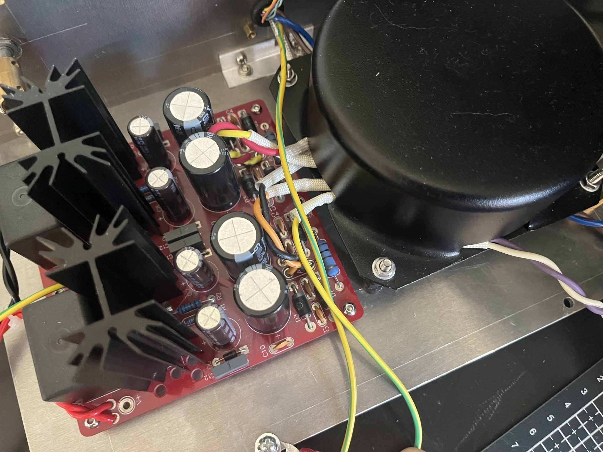

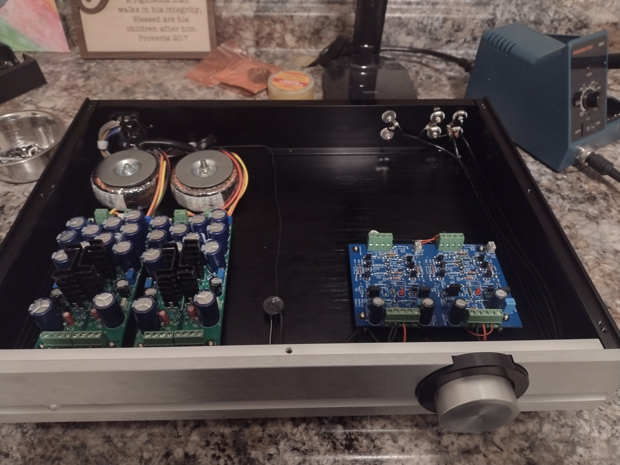

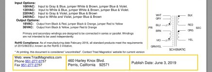

Can someone please let me know if I’m interpreting this incorrectly?
I have this transformer https://www.digikey.com.au/en/htmldatasheets/production/1837742/0/0/1/vpm36-1390-datasheet connected to a Glassware dual/bipolar LV reg. I’ve had it hooked up with the BA2018 and "working" for months but I was getting intermittent crackling through the speakers.
Because of this and several other reasons (I have adhd, that’s all the other reasons) I’m in the process of rebuilding my preamp and while reconnecting the power I realised to my great amazement and delight that I had twinned the wrong two secondaries from the transformer into the PSU board, which was obviously what was causing the crackling, which I decided based on my vast electronics experience consisting of a lifetime of pressing the buttons on things. Now, I don’t know, because when I hooked it up this time it i can’t get it working at all.
In trying to work out what the destructive change was I’ve pulled everything back to the (fused) ac input, the transformer, the PSU and the BA2018 board. It still sounds like **** and one or two of the diodes on one side of the glassware are getting into the 60s/70sC while the rest are around 27C so I’ve either hosed half my linestage board (I cut it in half) or… something.
The attached images are how I have the unit hooked up currently and the relevant bit of the transformer data sheet. Am I doing it wrong now or was I doing it wrong before? Thanks
