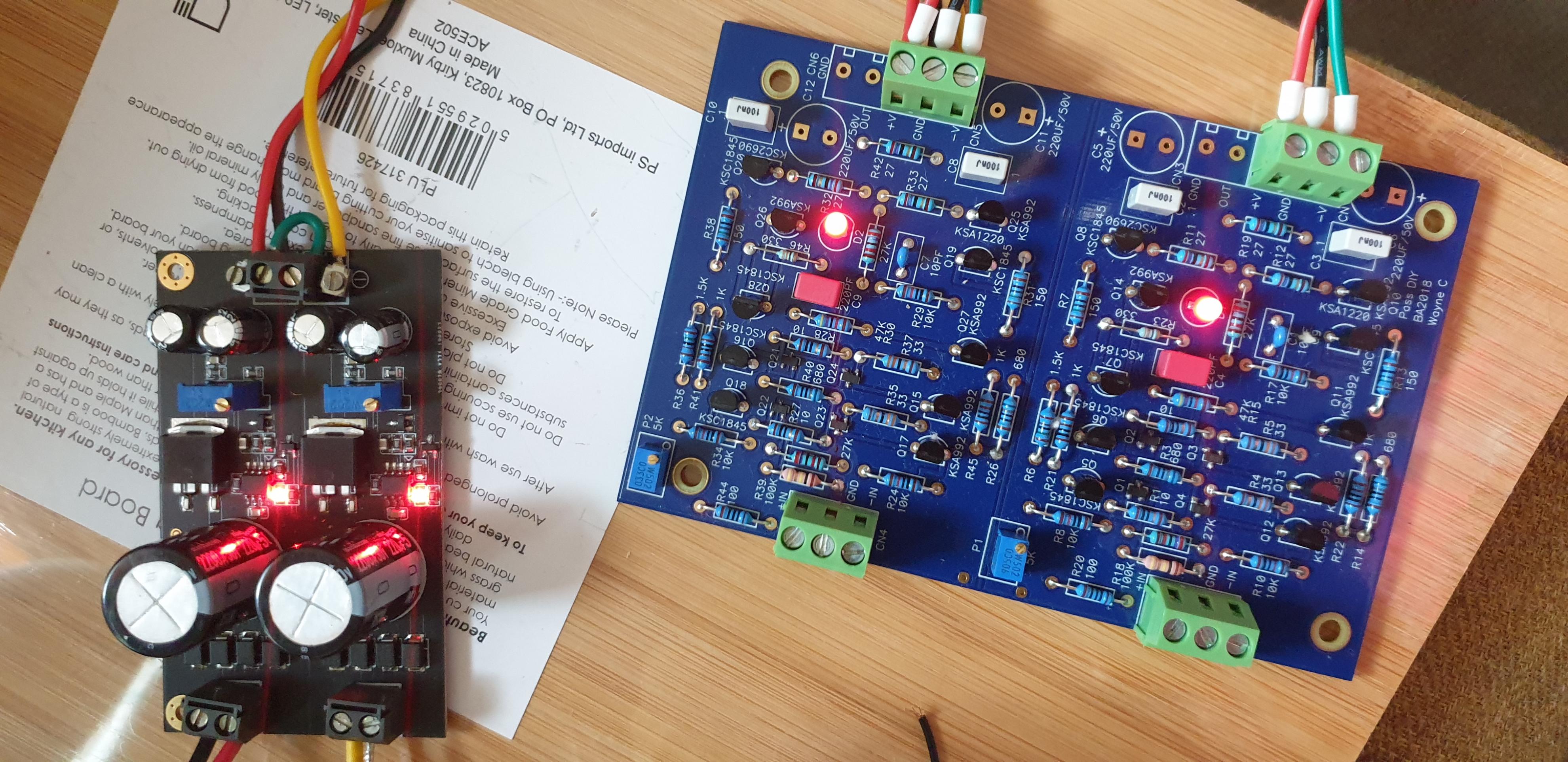

Finally managed to power up yesterday. Using a Chinese opamp buffered thing for now set to 15v.
Leds came straight on so that was reassuring. Left it for a while and checked for magic smoke/heat. All seems well.
Measured the offsets and they were both initially 0.5v but got one easily down to a steady pretty much 0v. At most it reads 0.005v so very please with that channel. The other one was much trickier. Just looking at the VR and the reading would shoot between +/- 20mv. Managed a fairly solid 0.010 or so.

Congrats, James! Glad to see the parts having come to life in circuit. And I myself am very excited about the parcel you have sent me, what exciting stuff is in there I am yet to see 😀
Wrt the offset drift, as long as your listening test is quiet on that chan, I would preliminary conclude the JFETs are OK, and proceed with measuring the voltage drop across R1 and R2. They should show stabily about 3mA/30-ish mV drop if I remember correctly. Any instability there will amplify downstream causing offset drift. Though 20mV drift is probably OK, I believe some have experienced more than that - and I more on my first go.
If there is any instability in the CCS, that is not there on the other chan, I would recommend you carefully reflow the JFET legs and then clean again. I don’t see the inputs shorted, that might help as well. Make a wired B shorting everything to center of the euroblock.
PS: If you cleaned with isoprop before testing the first time, first try again after a while before doing anything else. My circuit went ape when the JFETs had hidden isoprop under them
So basically, if there is drift the first likely culprit is the CCS/JFETs. If stable there, issue is downstream where parts are bigger and the fix might be easier.
Or you could prolly live with it 🙂

Thanks for the input Andy. I wouldn't say it has instability, just that one channel was harder to nail down the offset. Once I leave the trim pots alone the offset measurements are stable. It was populated some time ago and thoroughly cleaned. It will be dry!

I see. Sorry, James, I misunderstood then. The pots can be quite sensitive 😀 Build looks smooth!!

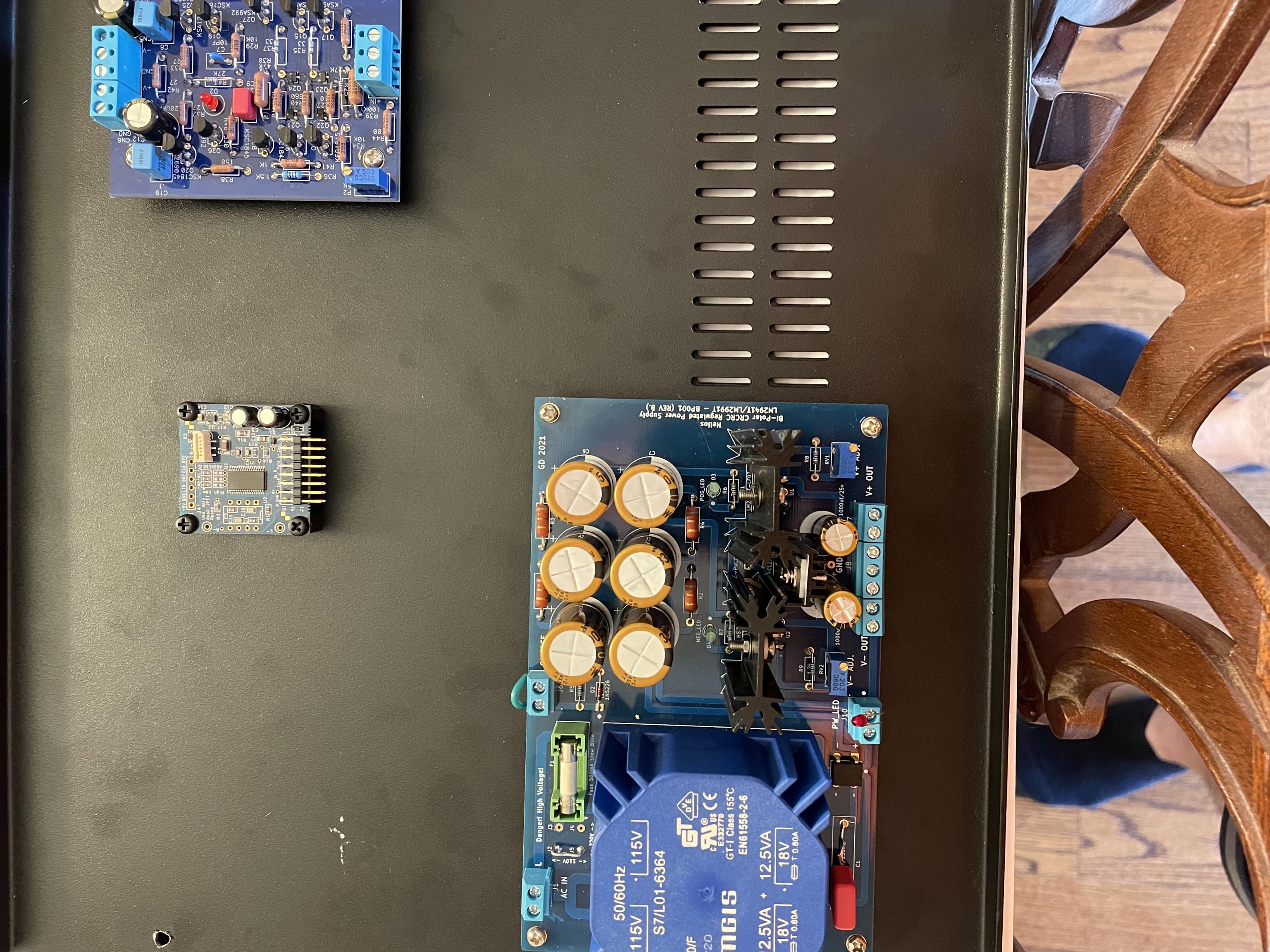

Hello Gang, I’ve finally getting back around to getting hopefully getting Wayne’s Linestage together and hopefully operational. I’m having a major brain fart and perhaps you guys will have a viable solution. I’m planning on using the Muses VCM volume module along with the Muses MCL display. I need a connector that will plug into the header on the VCM that’s will go from a male connector to wire where they can land on the psu, Linestage board and lastly to the RCA in and out. I hope something is available. If not perhaps a suggestion of how to make all this happen. I’ve attached some pics. Thank you in advance. Joe

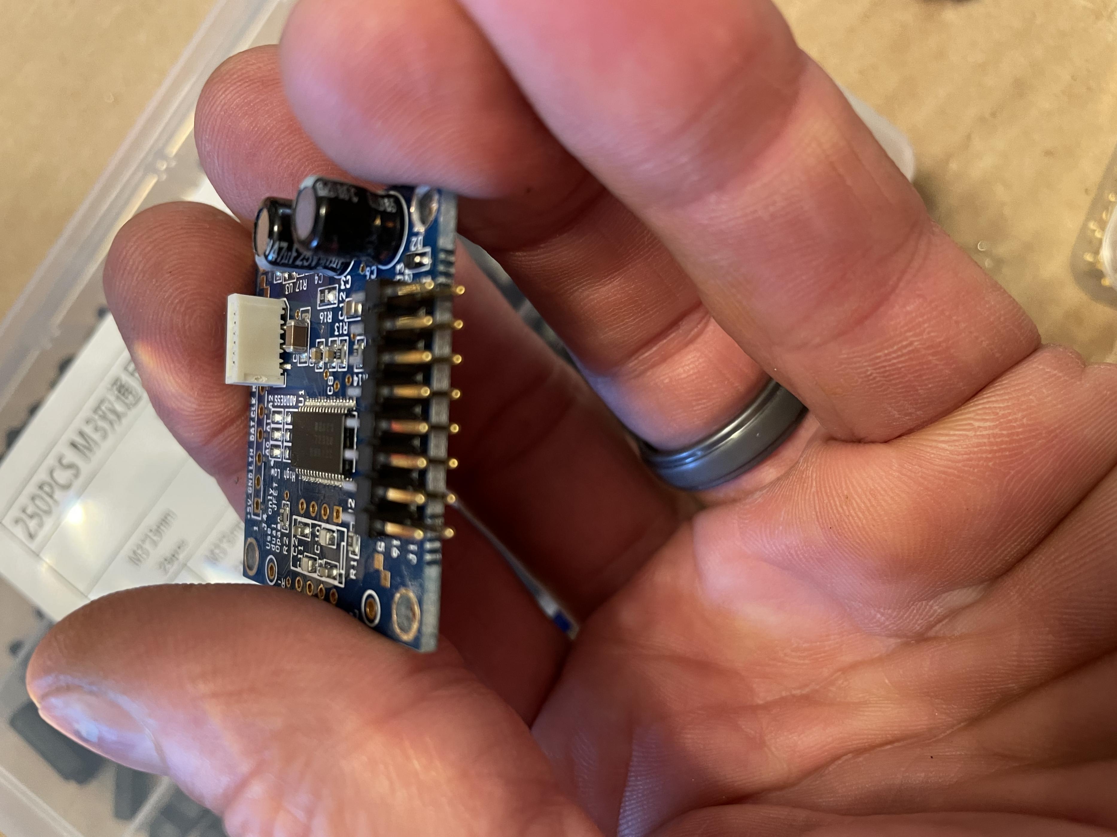

In the user manual the connector is described as:
A universal connector J3 combines all audio, power and control connection points. J3 is arranged as a 16-pin dual row 0.100”x0.100” PCB pattern that can accept a standard straight or right angle header.

On mine Project I did not use the header and instead soldered wires between pcb hole pads and other circuit pcbs directly with less connection points of failure.

@Dane, thank you for the reply. So was your VCM was sent without the header connector already soldered in? This is how I received mine already soldered to the board. I’m thinking it would be a tedious surgery to remove it at this point?
