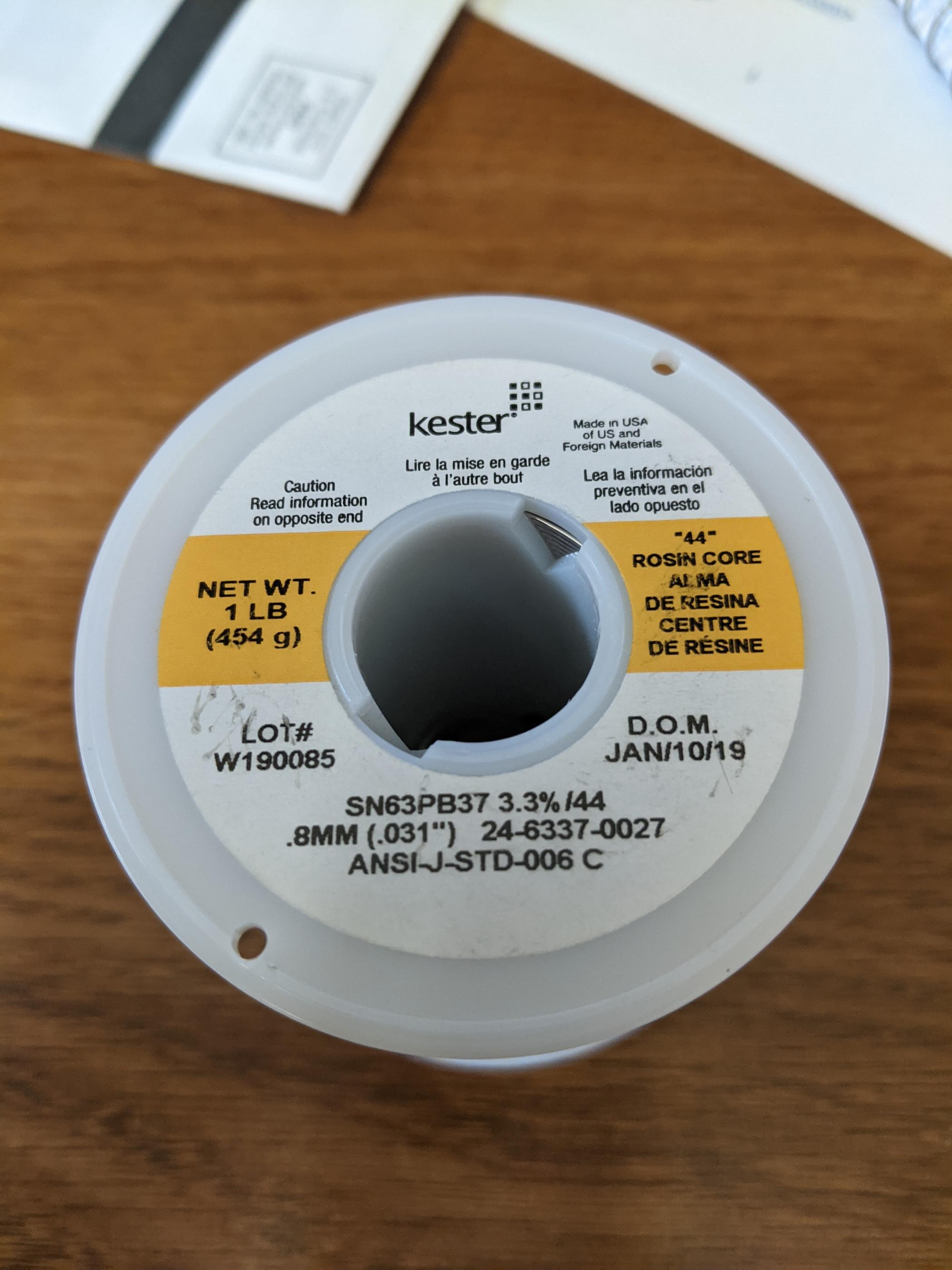

I've already ordered a tiny solder tip. Can someone give me a link to the "no clean eutectic solder" that was referenced? And maybe a temp recommendation for that solder? Below is what I've use all previous builds very successfully. Doesn't sound like it's what I need to go SMDing with though. Thanks for help folks!
Multicore is a way better deal than the AIM version I am using, but it lasts a long long time.

I also use a very small chisel tip, I found the weller pointed tips always oxidize on me, hard to keep them tinned. 600F tips or set your iron temp that low. 700F is too hot imo.
