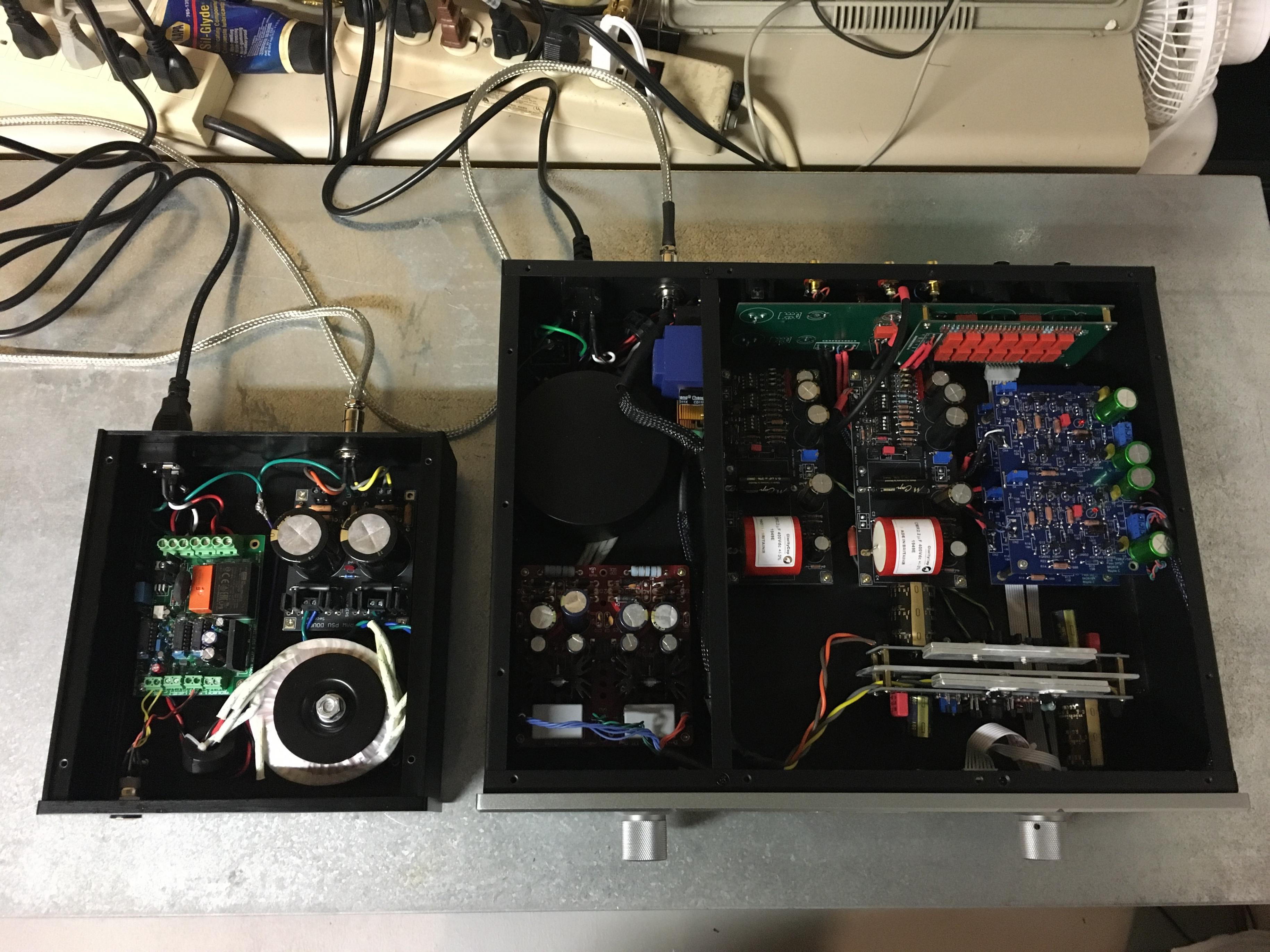

I built a balanced version of the BA2018 integrated with a UFSP phono section. I feed it into my Aleph J amplifier, the BA2018 replaced the Balanced B1 Korg, I used with B&W 804D speakers.
When I first installed the BA2018, the magic of 2H was gone with the B&W speakers. I replaced the B&W speakers with Lowther PM2A speakers in Medallion 2 cabinets, the 3D soundstage was back with a clarity of sound I did not hear with the Balanced B1 korg preamp.
I stacked the BA2018 boards in the enclosure to save space.

Thanks. Very cool looking build. Quite a bit more professional than mine.
A couple of questions. What did you mean by the "magic of 2H" and why do you think that was specific to the B&W speakers?
Also, it looks like you went with much beefier capacitors than the BA2018 kit comes with. Do you think that made a difference?

When the balanced B1 korg preamp was used, the B&W speakers had a wide and deep soundstage. I've had friends who heard the system say they heard instruments playing next to them. When I switched to the BA2018 preamp, that 3D soundstage was missing with the B&W speakers. The sound clarity was exceptional, yet it lacked the depth I so enjoyed.
The Lowthers changed the depth issue I had with the B&Ws, not sure why the B&Ws didn't like the BA2018.
I used Nichicon green capacitors because I remember reading some where that Wayne preferred them. Not sure if it helps or hurts.
I do enjoy the BA2018 with the Aleph J, I am hearing a sound from the system that I enjoy immensely. The UFSP phono section adds even more to the sound quality.

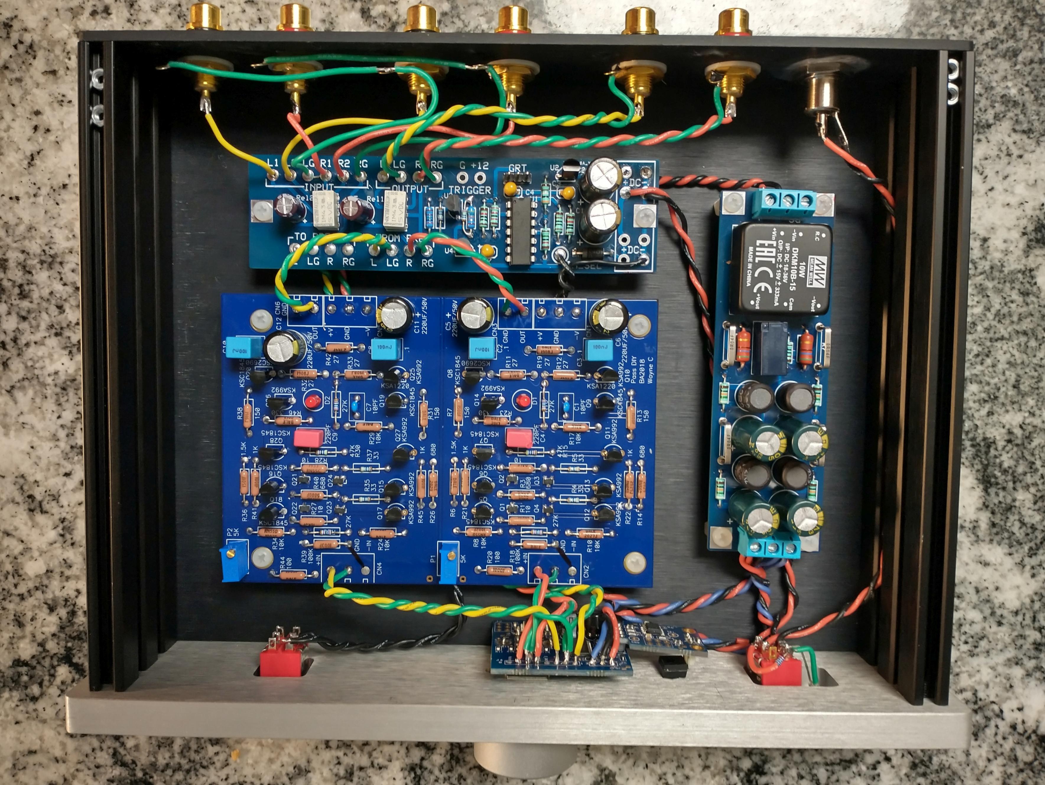

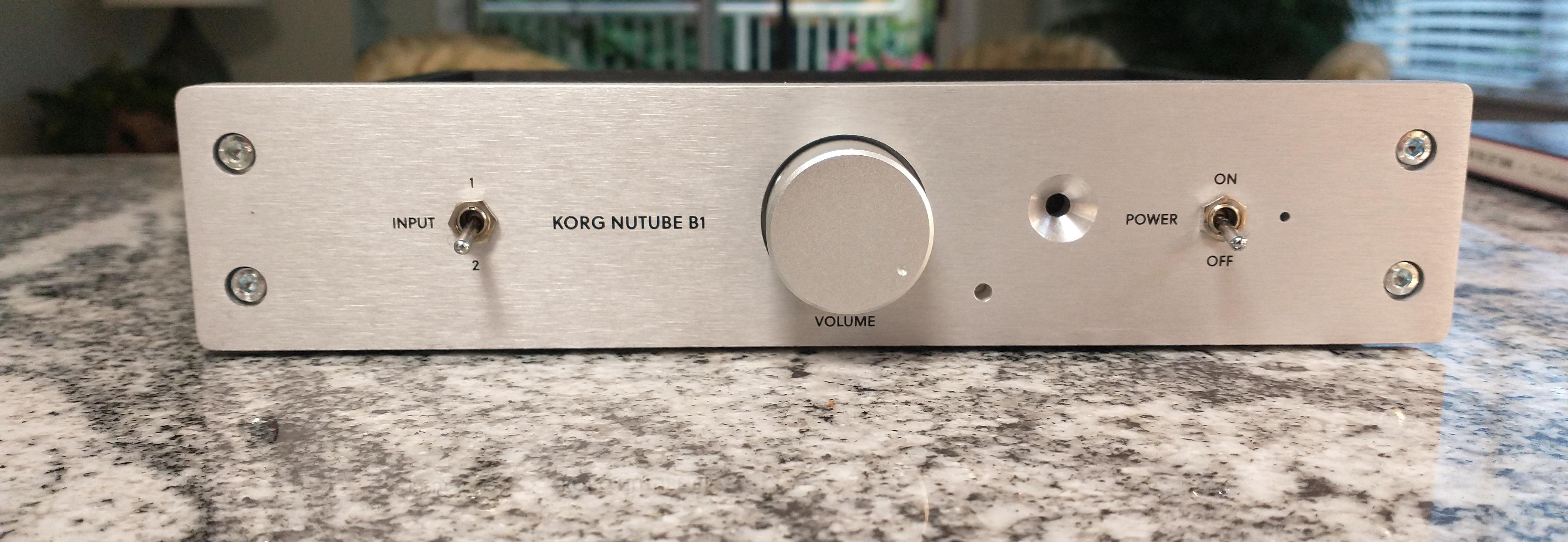

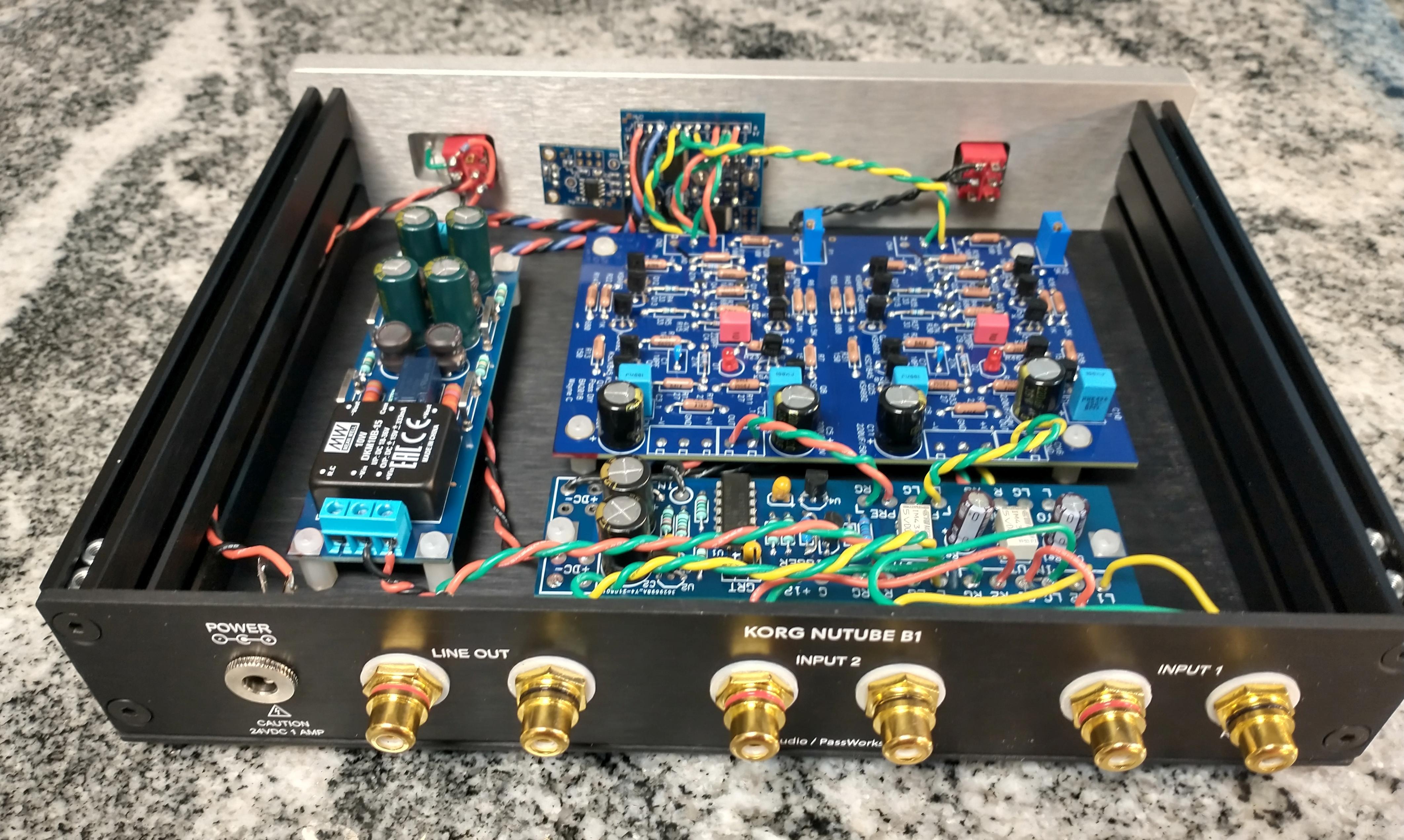

My version of the BA2018.
To save time and effort I decided to install it into my Korg B1 chassis, with a PO89ZB-based +/-15V power supply and my own pcb for delayed turn-on, relay-switched inputs, and a 12V 25mA Trigger circuit.
It all fit nicely into the 6.5” x 8.25” Korg chassis along with a Muses chip-based IR remote controlled volume control and, surprisingly, I didn’t have to pack it in.
Tomorrow I will recheck every connection and then have a listen. I already know that I can keep the offset in the 0.4~2mV range so that's OK.

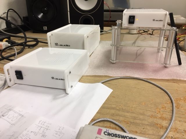

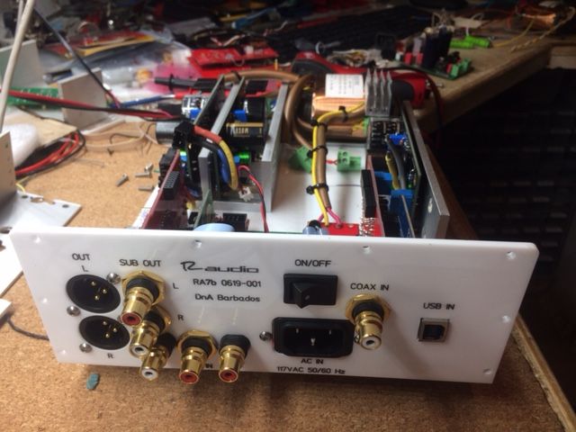

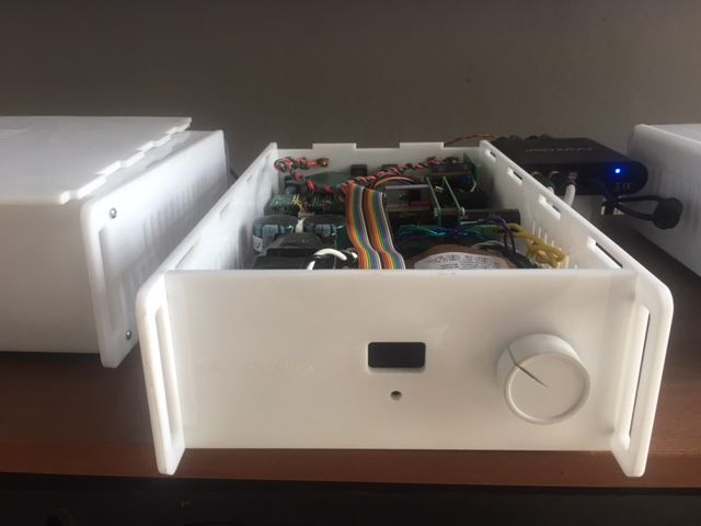

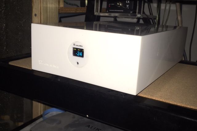

I do most of my chassis in perspex - except the amps, of course - so the error in this case wasn’t the end of the world. I used the incorrect dimension (now corrected, thanks Jason) in a design using Front Panel Designer. Saving the design as a 100% PDF allows any laser-equipped trophy engraver business to precisely cut a complete chassis, lettering and all. Quite a bit cheaper than metal. Water-jet cutters should allow the same in metal, I’d think.
The FPD/perspex approach allows almost limitless possibilities. It’s fun to design and the ability to get precisely centered, accurate holes is satisfying. You quickly get accustomed to ‘perfection’ so, having gone ahead and done a chassis before I took delivery of the BA2018 I was taken aback when it didn’t ‘bolt in’. Thought I’d made a dumb mistake but tracked it back to the 70x100 dimension I’d used from the store page.
Apologies for the off topic. The DAC (first image) is actually made of Corian. Others are perspex. Should give an idea of how its done - all secures with two stainless screws on sides near front.
