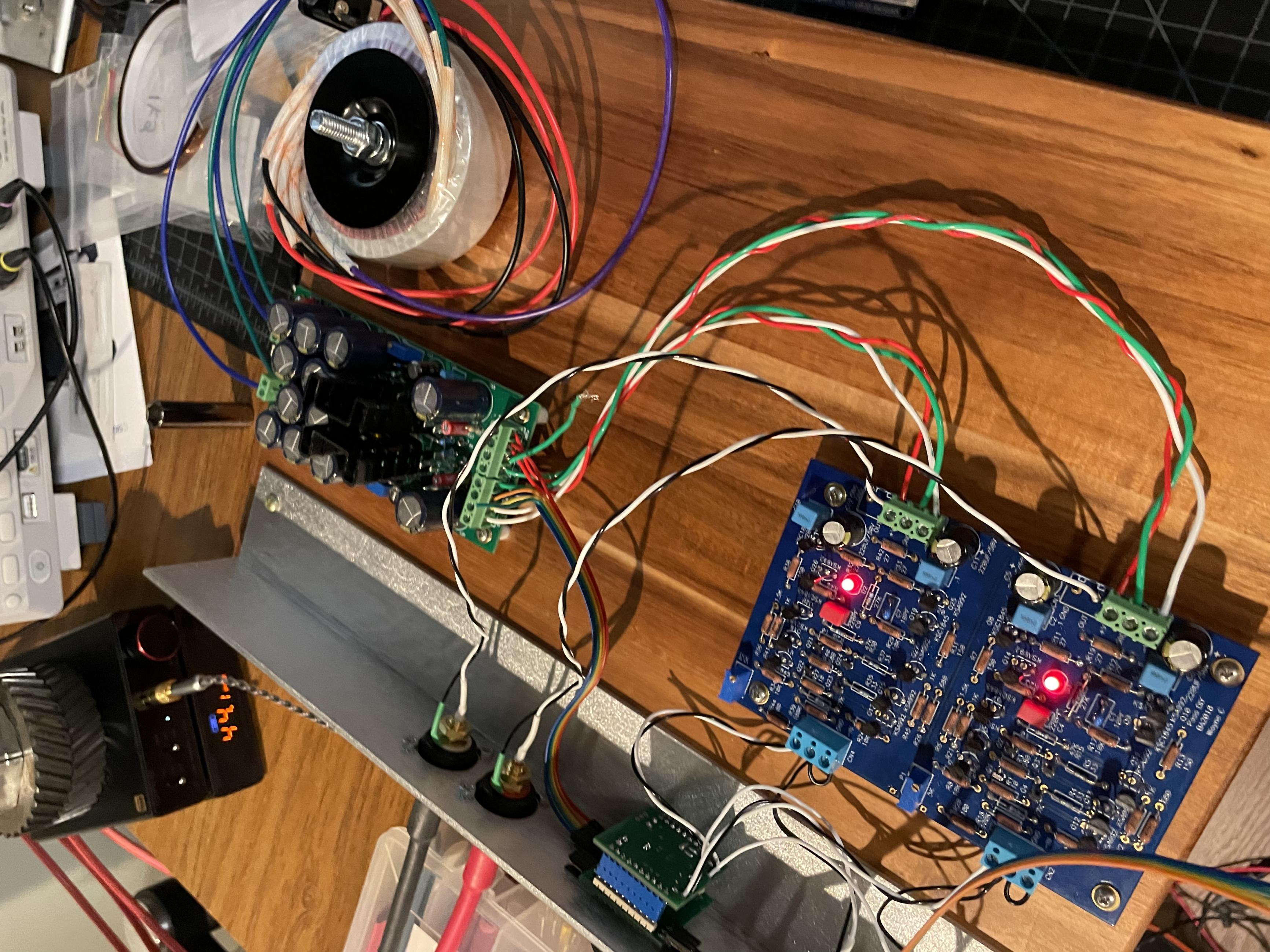

Success, prototype in action. WLS started up perfectly. Muses gave me a couple issues, but all are resolved and it sounds excellent. Using VRDN power supply for everything, set at 18.5V, equates to about 17.5V at the muses chip. Next up trying to get display working without interference, deciding on input switching and box it up.
