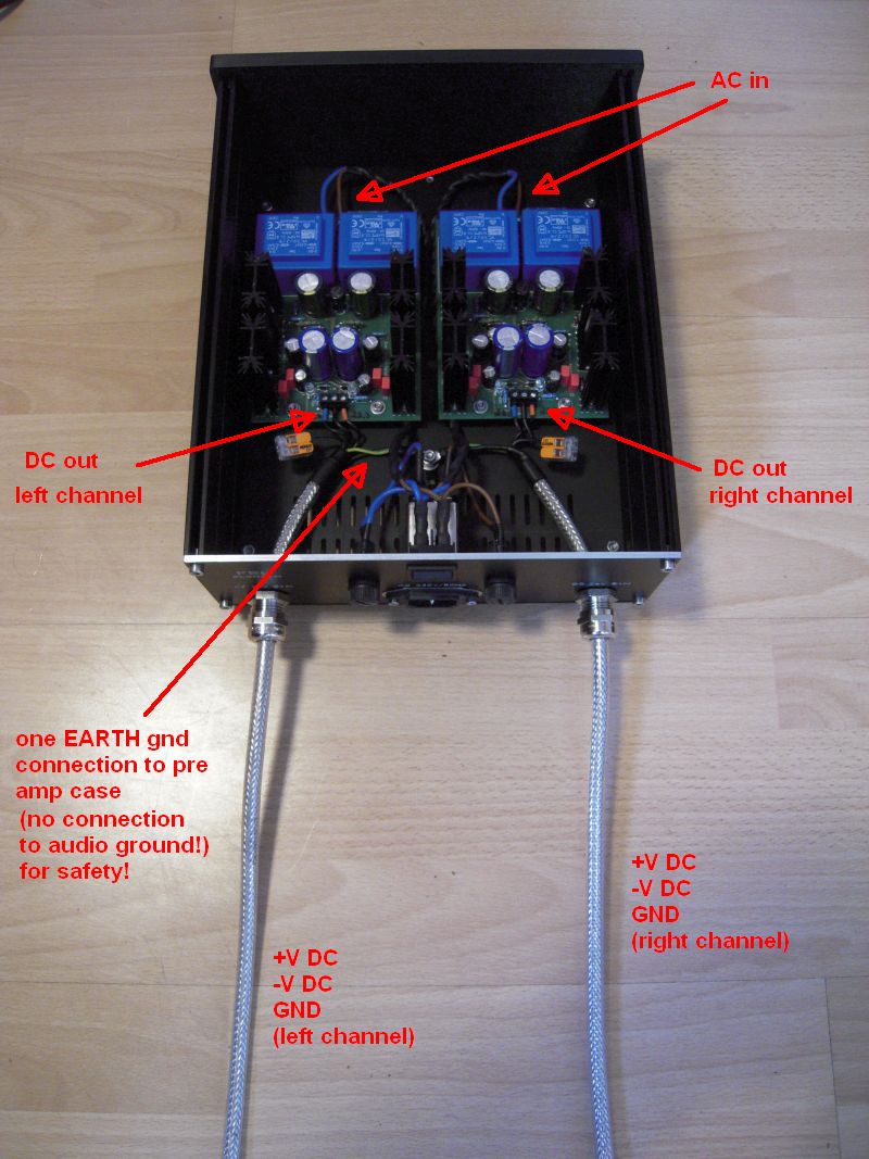

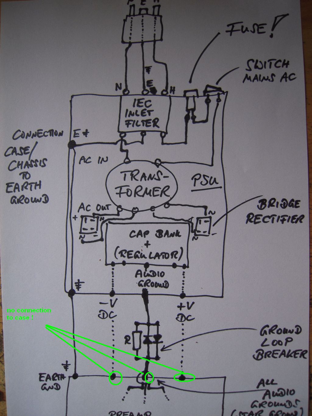

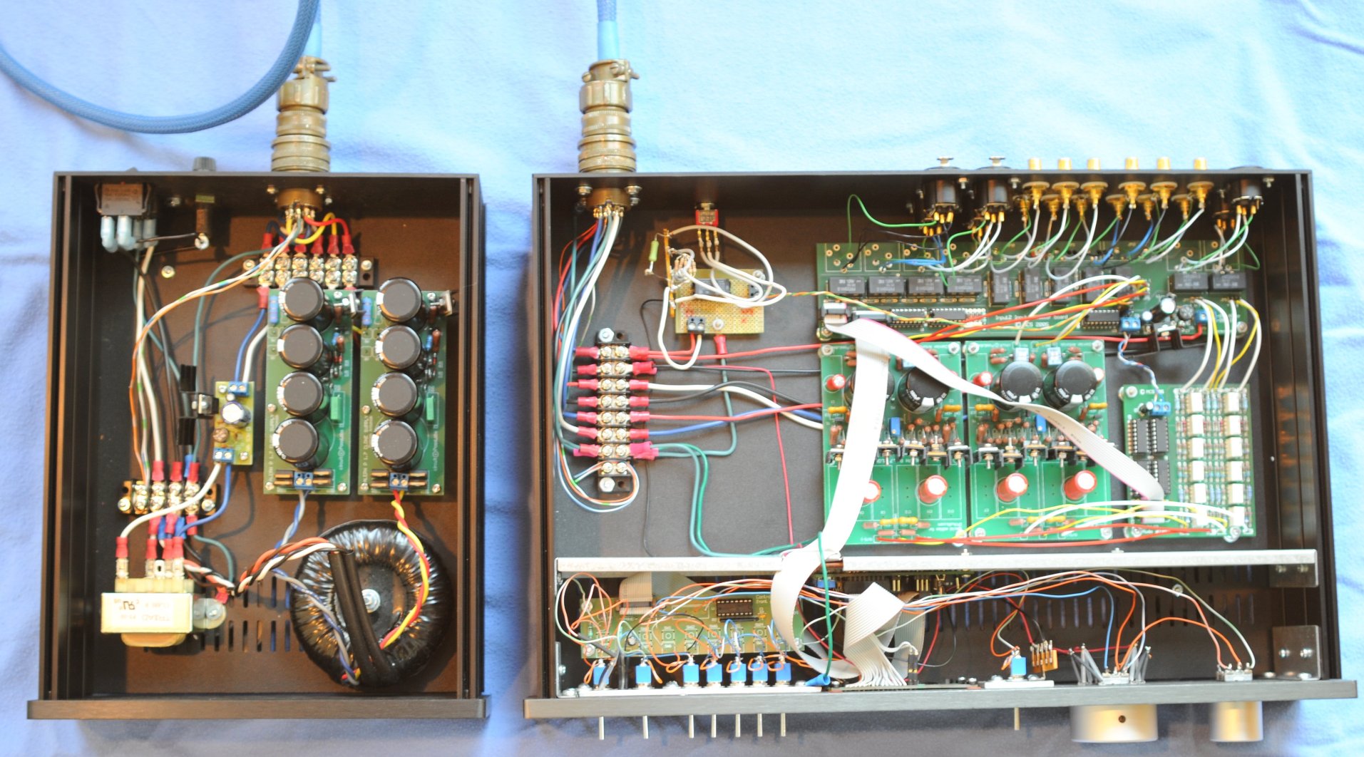

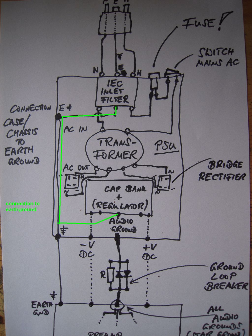

Hello Waynes-Line-Stage-builders,
there are many ways how to connect a seperated PSU to your preamp. 🙄
some of my rules:
-the earth ground of the PSU is connected to the AC inlet (for sure!) ,to the case of the PSU and to the seperated case of the preamp. This is absolutely necessary for safety reasons.
-no audio ground gets connected to this earthground / case directly
-audioground (from the preamp -pcb) gets connected to the symmetrical PSU-output / 0 V / =PSU ground via a ground-loop-breaker.
-there are different ways to make a groundloopbreaker. For a preamp I prefer
a combination of a 5 to 10 Ohm resistor (3 W) in parallel two diodes in parallel-reversed connection (check pic). Sometimes I use groundloopbreakers
made of a bridgerectifier and a CL-60 thermistor (recipe from Nelson Pass).
- all audio grounds in the preamp case (RCA-ground, volume -pot-ground) are connected to the preamp-pcb-audioground. Try to make a starground. Avoid loops in your gounding scheme. Keep groundconnections short.
I am not the 'master of preamps' and I don't know everything, but my preamps are extremely silent.
Sometimes you have to test different grounding connections by using wires with alligator clamps. but don't connect/disconnect during your preamp is switched on.
This can cause ugly noises or perhaps destroys your speakers... 😕
greets
Dirk 😀

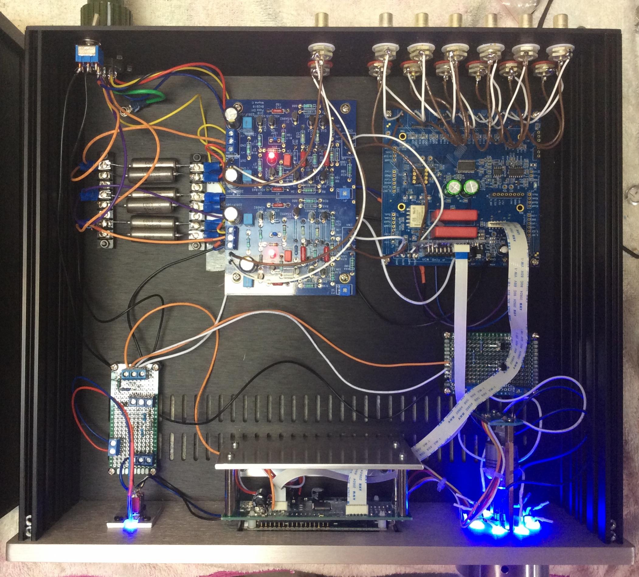

to bonacciomj #2715
Hello bonacciomj,
as I see on your pics, you are using a digitally controlled relais switched resistor
ladder volume control. This can cause other problems. Digital or switch noises from the relais to the audio signal...
Try to isolate the digital section from the analog section....
greets
Dirk
Great info, thank you!

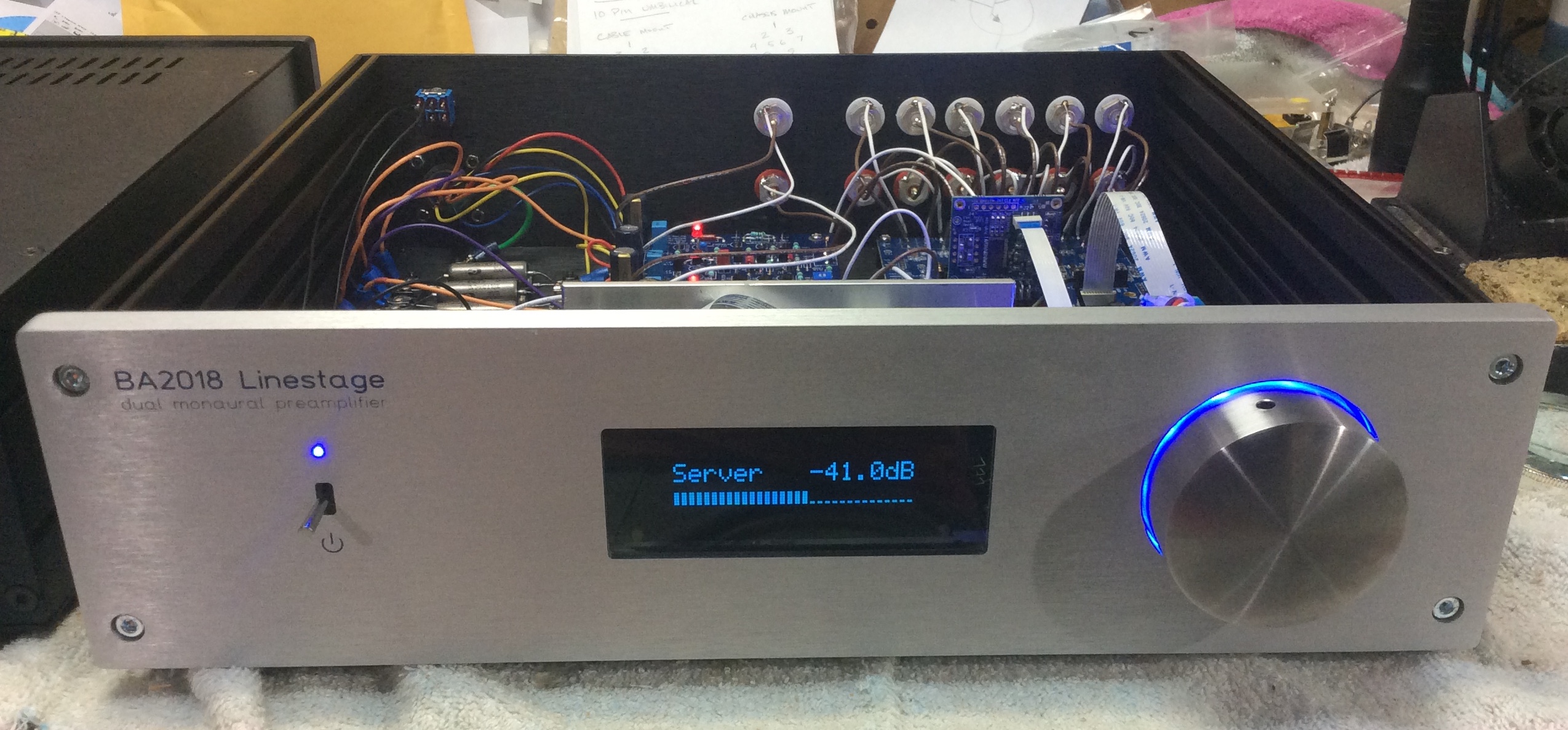

Dirk, amandarae, thanks so much for your help!! I apologize if this sort of thing has been repeated ad nauseam in various other places, but I'm glad the discussion has resulted in really good info on grounding with separate enclosures being collected all in one place. Hopefully others will find it helpful as well.
RE: The volume control -- it will be on its own circuit essentially. I have a small transformer I will use for it, and the board has been designed to keep the digital and analog sections completely separate from one another. In short, it should not present much of a challenge.
One last question: Since this project includes an onboard phono preamp, there is a ground terminal for a turntable ground wire. Should I just connect this to the signal ground of the phono preamp boards?
I am away from the project at the moment, but once I'm back I'll get everything all hooked up and send an update, *hopefully* along with a report of a working preamplifier!
Nice clean build. Love the cork standoffs.
Haha. Glad you liked those. That's what you get for editorializing on an existing design -- I had calculated that Elna Silmic capacitors would fit in the case no problem, but alas, with the little plastic standoffs I got, they were just barely too big to close the lid. They only need about a millimeter more clearance, too... live and learn, I suppose. The makeshift cork standoffs seem to be working perfectly though!
