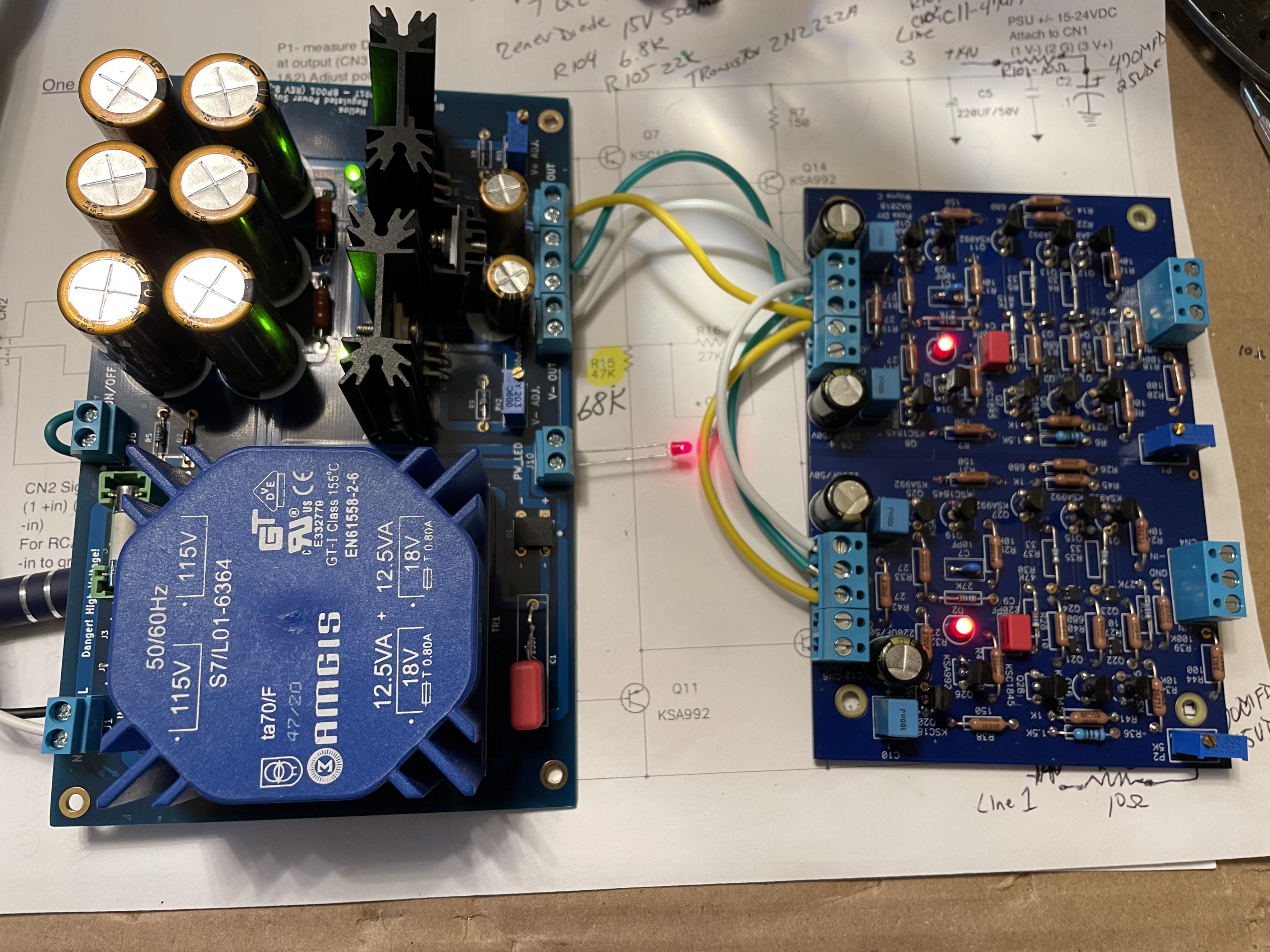

Thank you myleftear & 6L6. I found the notes on the schematic I hadn’t printed out. Am I reading it correctly as myleftear suggested, the alternate parts are more for headphone use? I’m really not into headphones and am just looking to build a linestage to drive the F5T. Am I safe thinking to use the 1845 & 992’s and not make the capacitor and resistor changes?

Luvrockin,
Checkout post #1188 from 6l6. At the lower right hand side of the schmatic you will see the note about the parts to use for a straight build vs a Headphone build.

Hello luvrockin,
your WLS-build looks really nice so far.
But wait, till you have listened to it.... 😉 And no hurry on the last few miles -
no silly mistakes please! 😀

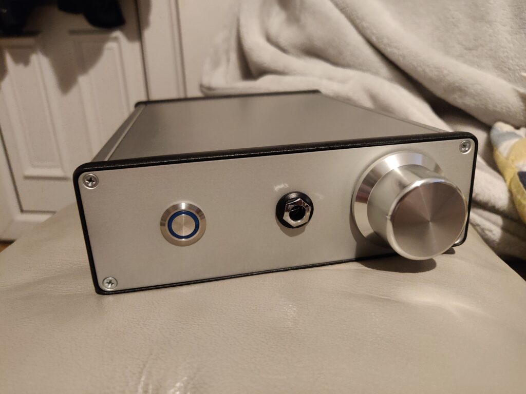

Thanks for the info Anand. Dirk, will take it slow and steady. My biggest hang up is how to incorporate this into a chassis that will like decent. Joe

Luvrockin,
I am sure you will find a really good solution for the case! 😉

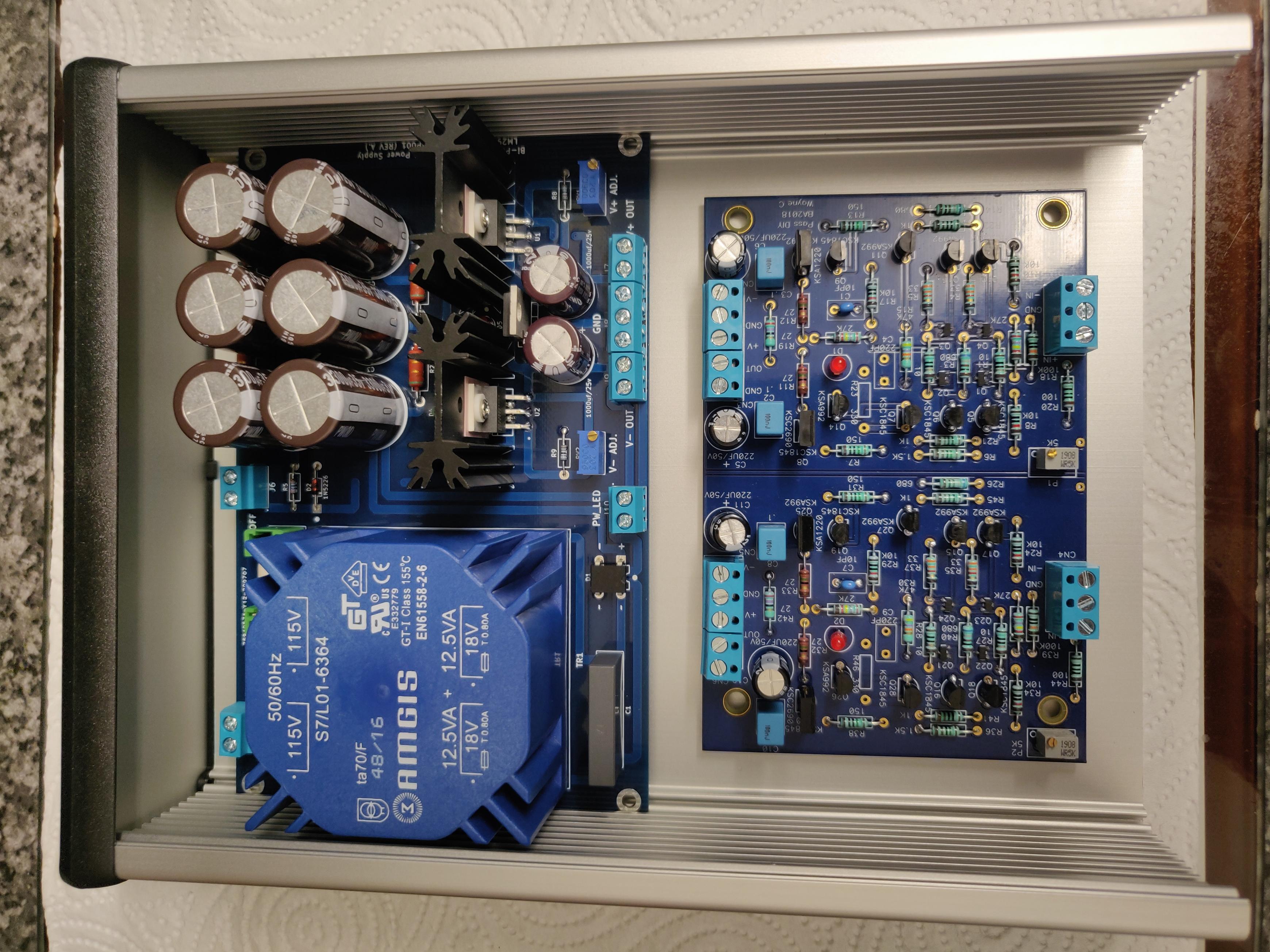

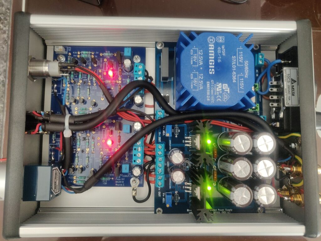

My BA2018

May I ask:
- what are these caps between umbilical and the line-stages, and what they‘re for?
- how did you fix the blue led‘s around the volume-knob, are the glued into place or is there a nifty magic behind?

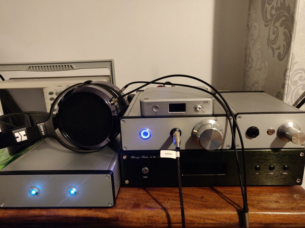

SRMcGee- Scott, beautiful work. Using the program you shared with me, did you actually then do the machined and printing yourself?

Why not do what I did and use the Hammond 1455T2201 enclosure? It looks neat and my Helios PSU was design to slide into the rails of it.
May I ask:
myleftear:
The caps are 0.1 uF and are intended to filter away any noise that might have been picked up by the rails between the power supply chassis and the BA2018 chassis. There are three bipolar power supplies in the power supply chassis; hence, there are six incoming power lines (3 positive, 3 negative) to be cleansed.
I use Front Panel Express on most of my projects and years ago worked out a nifty way to showcase knobs. In the case of my BA2018, the knob is made of steel and is 54mm in diameter. I put a 56mm diameter cavity on the front panel; that allows the bottom of the knob to sit just below the surface of the front panel and leaves a 1mm ring around the knob. There are eight 3.1mm diameter holes drilled from the rear side of the front panel into the cavity, and a 3mm LED has been inserted into each hole. The LEDs are held in place by clear silicone glue (clear silicone caulk could be used as well).
luvrockin:
No, the design was created using Front Panel Designer and then sent, along with the front and rear panels, to Front Panel Express for processing. They drilled the holes, etched the aluminum and added the color in accordance with my design. FPE isn't cheap, but they do a nice job implementing your vision.
All:
There is no rocket science to my designs and I'm happy to share. The .fpd file for the front panel on my BA2018 is attached. I'm always looking for ways to improve my designs, so feel free to suggest improvements.

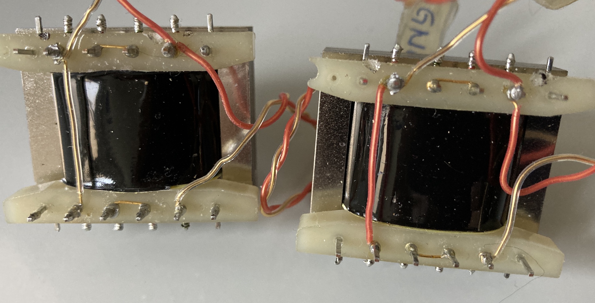

Cinemag's strange behavior
Here I am again.
My WLS is wonderfully playing, I enjoy it very much.
I then connected the cinemags to the output, and whoops, one channel is being upped like the expected +6dB (listened, not measured), but the other stays the same.
THIS IS PUZZLING. How can it be, I mean, if one channel was noisy or dead, ok, broken part, but no effect?
