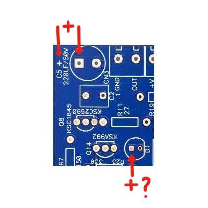

Question! I could be wrong but I always considered the square solder path to be - (minus). The PCB clearly states that the capacitor + (positive) should be soldered at the square solder path.
I the square solder path also the + (positive) side of the LED?
Leuwarden,
The flat side of the emblem near D1, is for the cathode lead of the diode, D1. The anode lead is inserted in the hole where you have labelled in red +?.

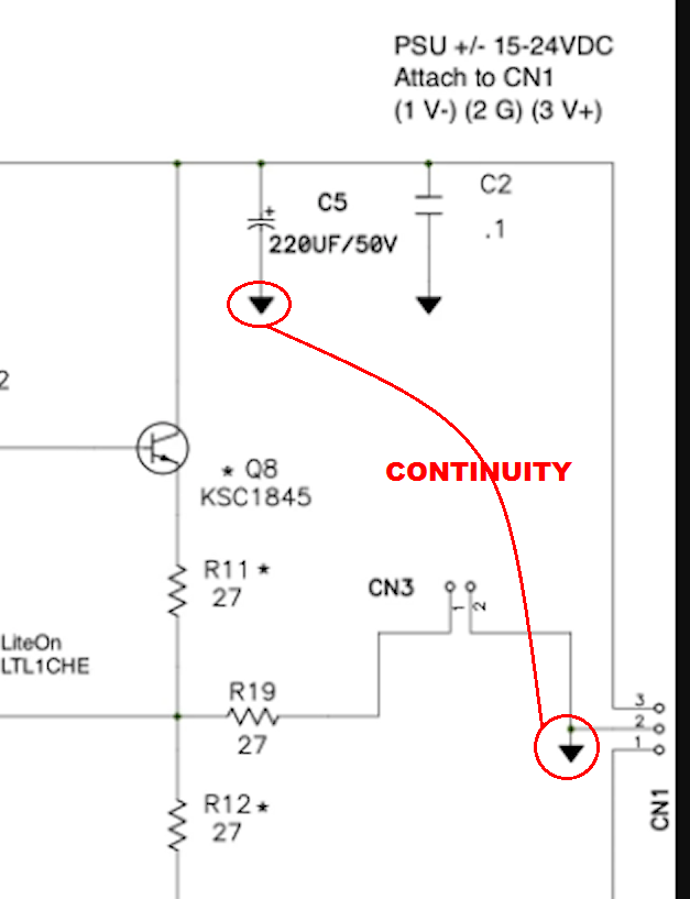

When in doubt: buzz it out. Using the continuity tester / beeper feature of your DVM.
The schematic tells you which terminals of which components, should be connected together by PCB traces. Get out your continuity tester and verify. There's only two terminals on C5, so there are only two possibilities to test: which of them has continuity to the middle pin of CN1? That's the MINUS terminal of C5! You've done it!
Square terminals vs non square terminals on PCB layouts, are placed at the whim of the PCB designer. The shapes have no meaning to anyone but her/him, and different PCB designers use them differently. Some PCB designers only use round terminals; no square ones anywhere. Other designers mix them at random.
Continuity testing, on the other hand, is a firm guarantee. Whichever terminal is connected to the places where the "-" terminal is supposed to go, IS THE MINUS TERMINAL. No matter what the shape of its copper soldering pad.

MJ is right! Best to learn and associate with the schematic instead of associating symbols if something doesn't make sense or needs verification.

I agree that is the ideal way. But Leeuwardens question was regarding this specific circuit, not in general. The long lead goes in the square hole regardless on this specific circuit, and many know this. Good thing that the wizards assistant/maker had to turn up to provide this simple answer to someone just trying to finish without further adue. For some, the mere soldering process on these boards is a challenge. I perfectly understand why Leeuwarden asked this question, and I don’t think it is fair to procastrinate the answer instead of just providing it. Yes, it is possible to deduce the answer from the circuit. It is however just as possible to just help the guy.

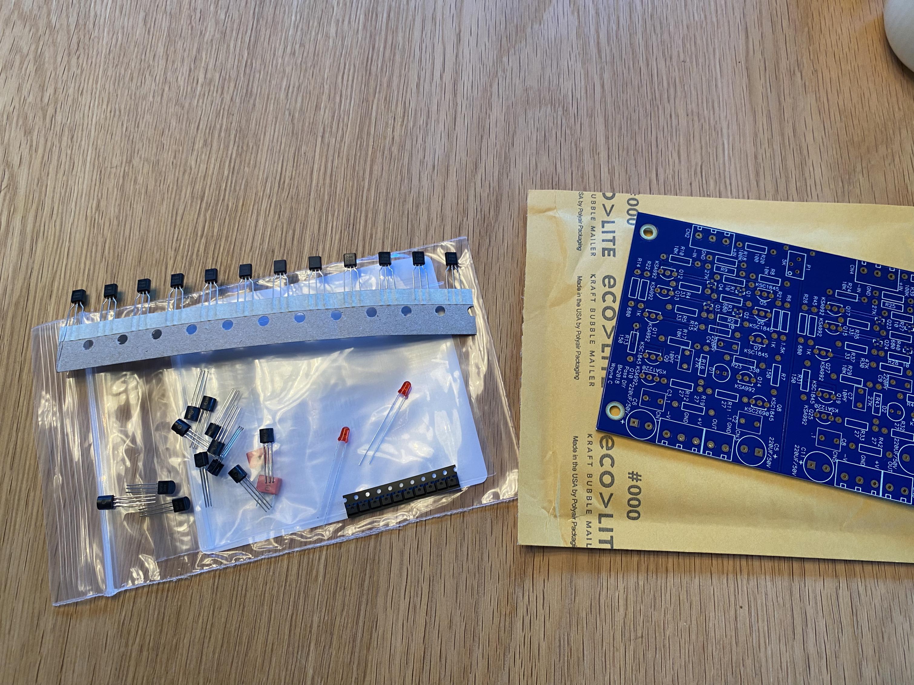

Hi, James!
Finally found the time to collect the stuff I promised you. Depicted are all semis required for the standard circuit. I also threw in some original Lite-On LEDs and 220pF Wimas, along with the PCB. I’ll ship it to you tomorrow.
There are two extra of all semis, in case you screw up
I don’t know how experienced you are, but start with the JFETs, and plan and prepare for the job, and do a beep test in diode mode afterwards. And clean, yes clean. Liquid flux is preferable, and apply with pen or toothpick to pads. Currents are low and small errors equate to instability. It is an extremely stable circuit if done right. I know, I always mess up the first time

OTOH, it is extremely precious to know a square terminal hasn’t a specific clear meaning… (only trust a square terminal after you found out what it stands for on the specific board)… or, well, never forget to doublecheck it [emoji6] and find the other signs on the board, likethe flat part of the diode‘s outline.

Andy what can I say other than a huge thank you. You are a gentleman.
Shall PM you regarding payment!
Thanks again
Thanks again
Giving something back is the least I can do. This community is awesome. I promised 6L6 to return his favour to someone else some time, and I am simply honoring that. Others too have shown me the same courtesy. Hope it all arrives safely and that you get to enjoy this wonderful circuit! Don’t sweat payment. Join me for a beer after BAF, at the Trubadour or something, and I am happy. Cheers
