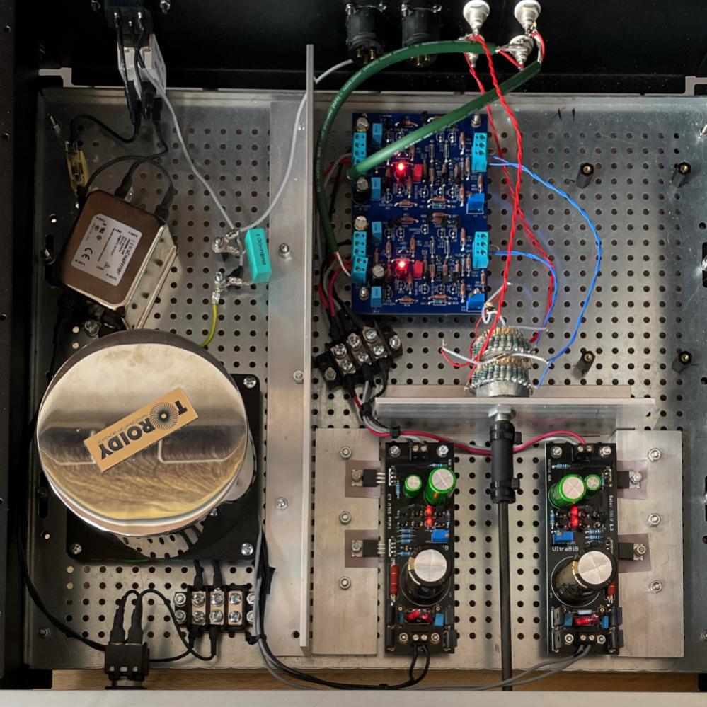

I replaced some jfets and things got worse. I re-flowed them again and things got a little better. I readjusted the output from the VRDN boards to exactly 18v again, and adjusted dc offset, and now everything seems to measure properly. So, I have no idea if it's truly fixed or not.
Thought I'd hook it up and see what it sounded like but realized very quickly from the foreboding hum that I did not properly ground my RCA inputs and outputs.
Right now I've got the mains and the VRDN boards grounded to the case bottom. I connected all of the the line level signal cables to the source selector and volume pots, but that obviously wasn't the best idea. I've been reading forum posts and white papers for two days now, and feel like I know a lot more, but not what to do.
Should I just connect all of the signal grounds to the case?

Hum might have many causes. To rule out the JFETs, measure R1 and R2 and their equivalent voltage drops on the other channel to get four readings. Also note how stable those readings are. If they are dissimilar or unstable, you still have JFET issues. If stable and alike (around 3mA give or take), proceed to wiring. Offset drift at the outputs should be no more than +/- 0,1mV read rapidly, and +/-1 mV read over time (after equilibrium and in case), IMOE.
In general I like to have absolutely none of the signal grounds attached to chassis, as a starting point. I have only 1 - one - gnd cable going to chassis, and that is PSU gnd, and it is not directly connected to the chassis, but through a ground loop breaker. The audio gnds join hands at the PSU gnd. Dead silent on first go. 6L6 posted a hand written schem in this thread and I followed it.
Of course, what works will vary from build to buld, and attenuators for example may have different needs.
But as a general rule, never connect signal/audio gnds to chassis, and absolutely never directly. If you have to, something is most often amiss. Audio/signal gnd and chassis gnd are not the same!
Hope you solve it.
Andy
Regarding to Audio-input, I put an 0.1uF Y2 between Input-GND and chassi. I did the same in Whammy(see Waynes presentation 27min 16sec). The linestage is dead silent with isolated standoffs for pcb.
Good point. Such a solution can make a even quieter gnd, particularly for hf, but not doing it should not cause hum on the WLS.

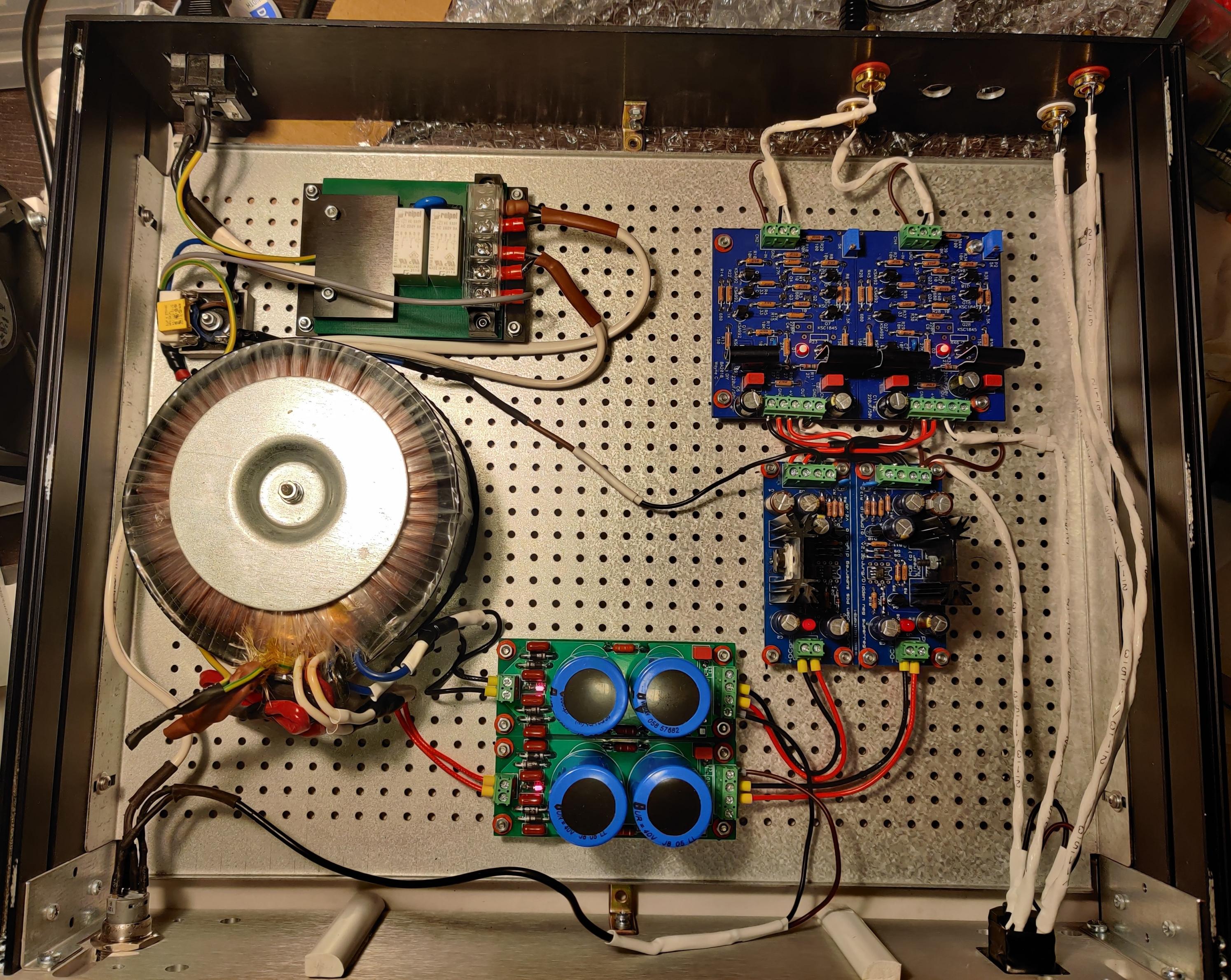

Margol,
Nicely done!
I like your use of a rectifier as a ground fault device and to minimize potential ground loops.
You did a good job minimizing the path length from the output of the Super Reg’d supply to Wayne’s BA2018. This makes sure that the supply impedance is kept as low as possible which is one of the advantages of the that supply. Let us know what it sounds like!
