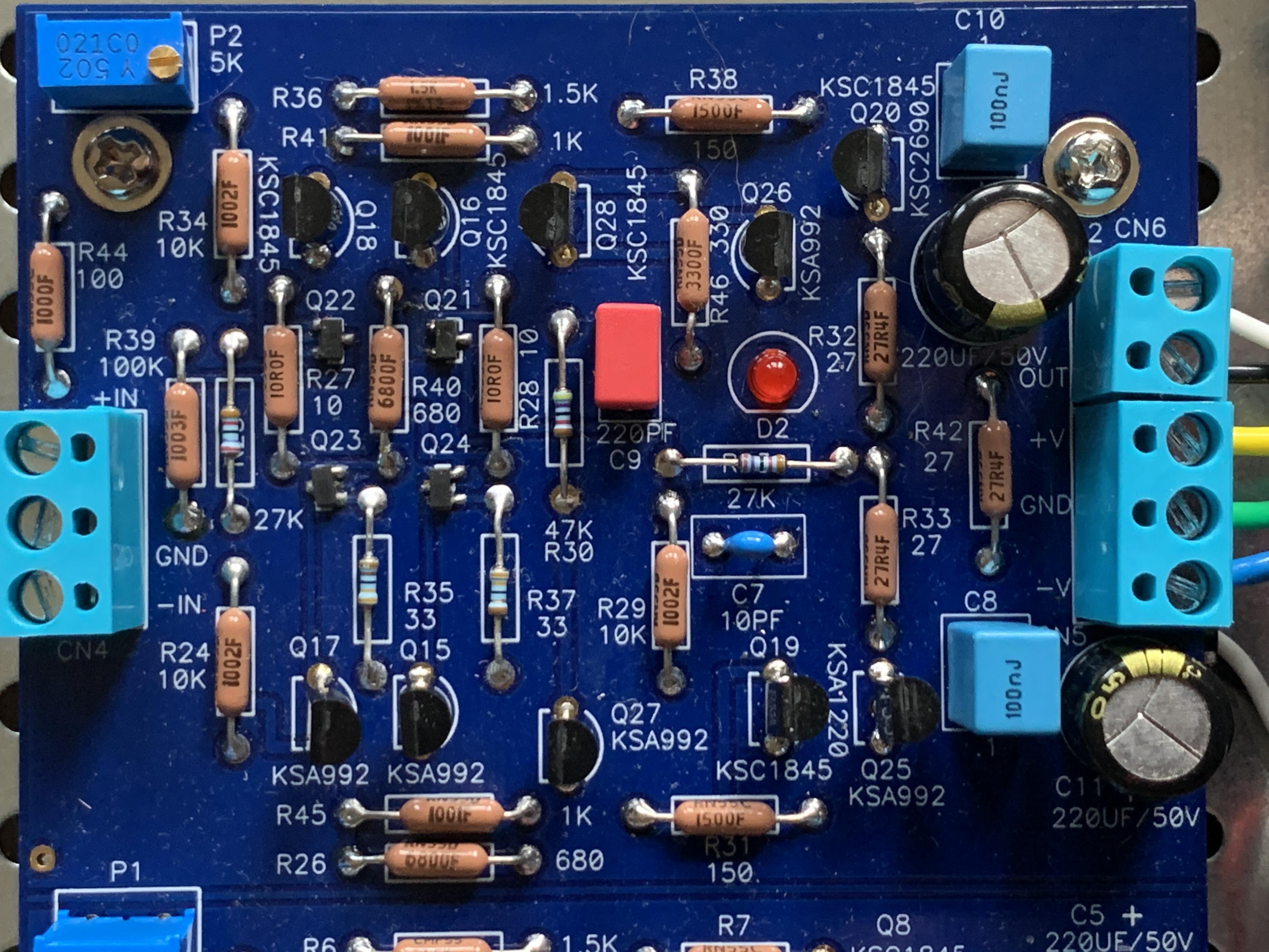

My BA2018 is finally complete. Dual mono VRDN regulators at 18V. One channel of the BA works perfectly and I can get offset to 0mV. There's an issue with the other channel, which is pretty much passing 14V dc right to the outputs. So, I tested all of the suggested resistors and I'm getting zero volts across R28. Everything else seems to match up and look good. All voltages from the power supply check out, and the leds on the BA2018 illuminate.
R1 - 36.5mV
R27 - 43.1mV
R2 - 36.7mV
R28 - 0😡
R7 - 2.5V
R38 - 2.6 V
R11 - 373 mV
R32 - 376 mV
R13 - 2.46V
R31 - 2.54V
Did I maybe not properly solder down that very tiny Q21? Or worse yet, fry something? I'm still green when reading schematics, so go easy on me.
Any help would be appreciated.
Thanks,
Brad

Photo of the wonky channel is attached. I will figure out how to do a diode mode test, and report back with what I find out.

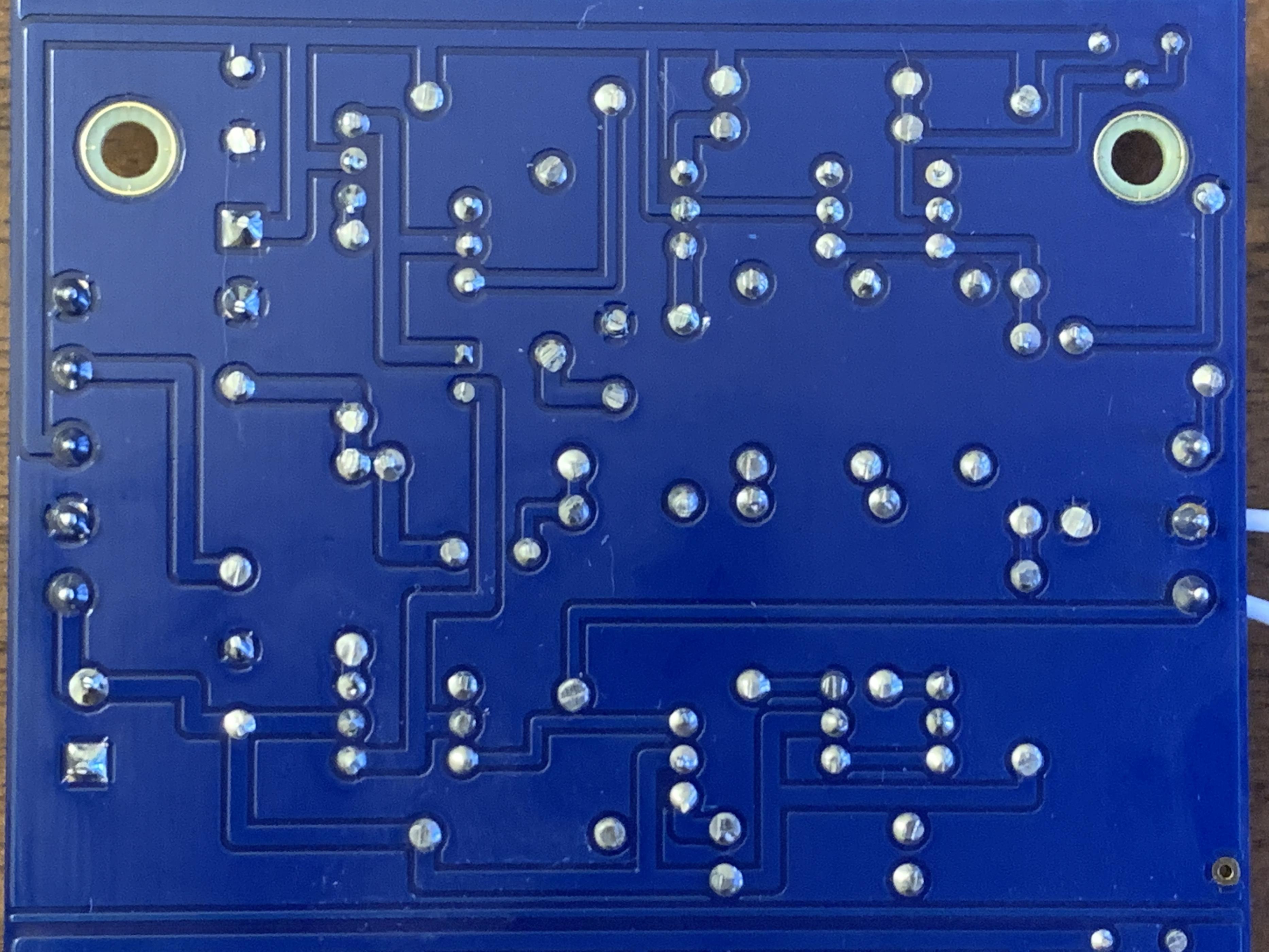

underside, pls
and try bigger resolution ........ every hair counts
Thanks, Zen. Photo of the underside attached. I think you need to open it in a separate tab, then you have the option of full glorious magnification. The photo is full size out of my iPhone XS, so I know it's big enough. I can't get it to fully magnify when I simply click the inline version. Am I missing a setting for image upload that allows full size access in the forum post when clicked?

pic looks good - same as soldering, as far as I can see

I’d do exactly as Choky and PJN prescribed. And focus my beep test to the cold-looking joints of Q21 and Q24. Reflow with liquid flux is preferred, as grease might make contact between legs if it gets under the transistor (tight space, difficult to clean). Careful when reflowing, they aren’t too happy with high temps and multiple reheats, imoe.

Checked the JFETs and the continuity was bad on Q21, which seems to make sense based on the issues I've been having. I will remove, clean and reflow that one and see if it fixes the problem. All of the others seem to be working properly. Thanks again for the guidance. I'll report back with results.

I checked and reflowed the jfets which solved a number of issues. I can now adjust dc offset on the output of that channel via P1, and all but two of the resistor measurements between channels are the same. The only two that are still off are R40 and R43. Does that mean it's a Q21 issue, like maybe the jfet is bad? Good idea to replace and measure again?
