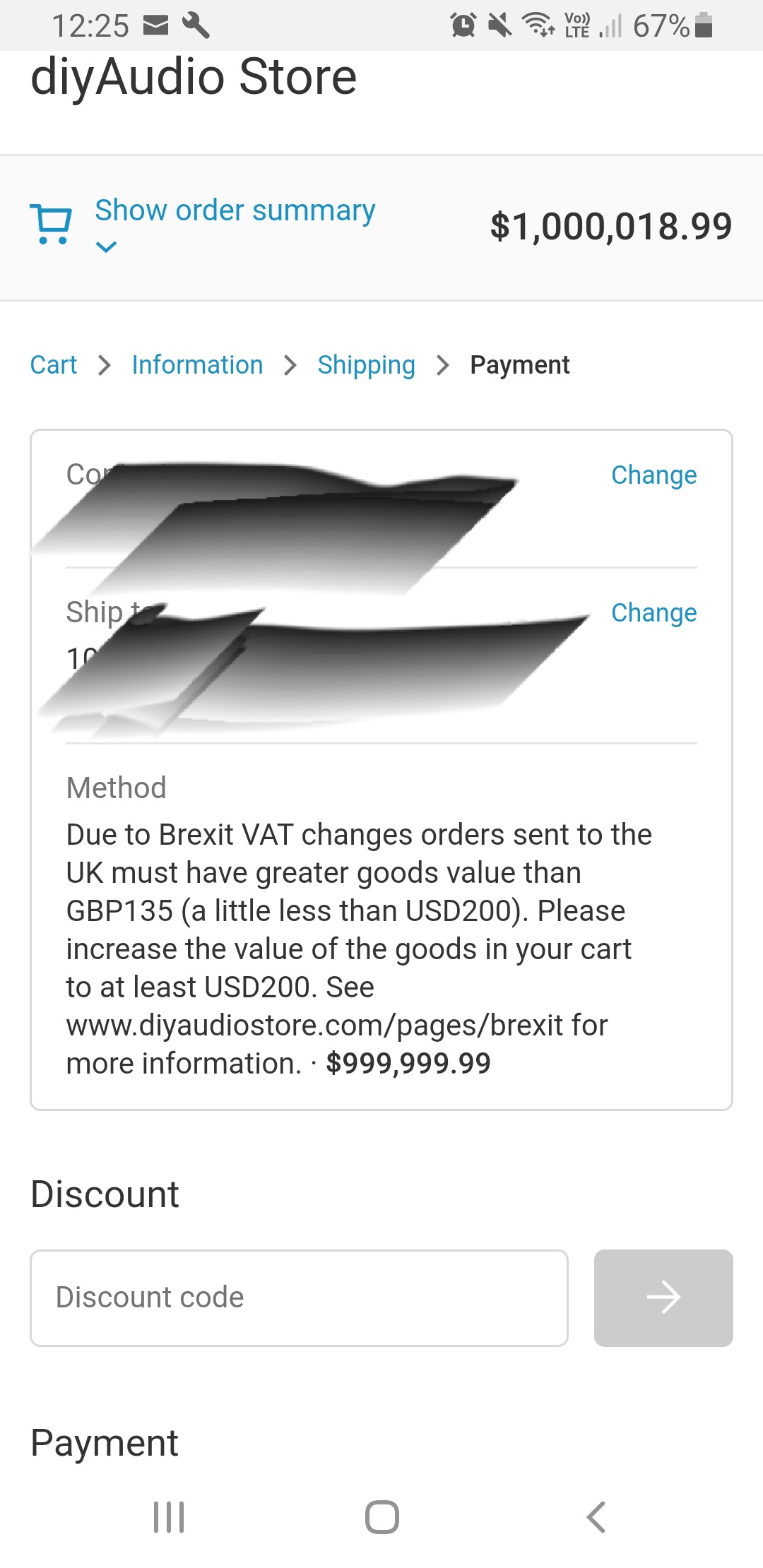

I'm afraid this changes 1 July. As of then you will pay always VAT no matter what the price is.
Joined 2018
And the Royal Mail will add their £8 for handling an import.
Wayne, I wish I was capable but alas I'm fairly green to all this. Thankyou for the design though.
And it would seem I cant buy the boards from the store anyway due to a Brexit issue. Well I could for a cool mil.!
Luckily a member has offered me a spare pair of his early pink boards here in the UK. Happy days.
