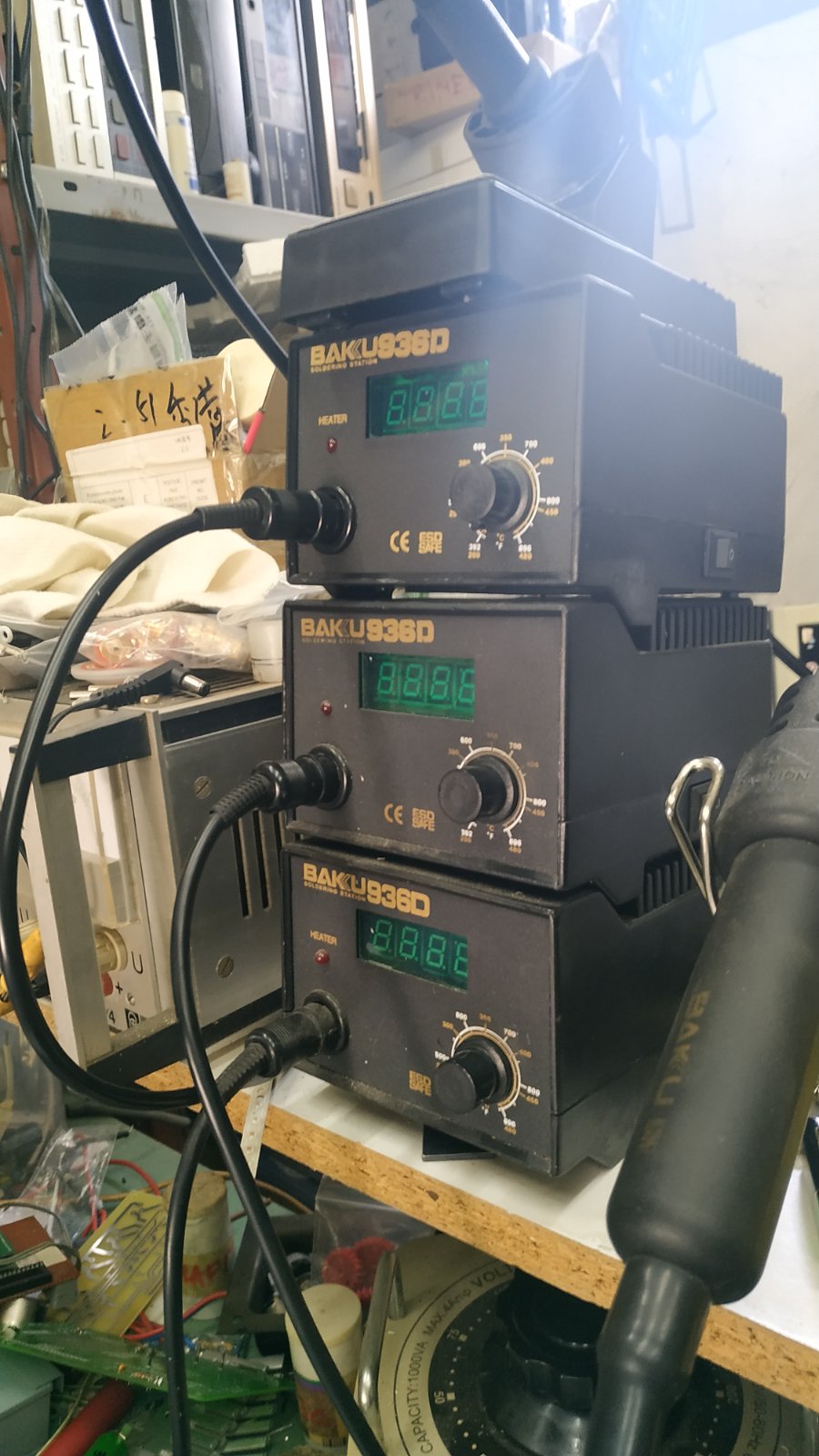

Thanks turion64. There seems to be a limited selection for my Stahl DDSS system which has been so effective for me in the thru-hole projects. I have this tip set on the way but nothing there that seems like a "chisel". Do I need to invest in a better iron with more flexibility for the SMD stuff? https://www.amazon.com/dp/B004D06QM4?psc=1&ref=ppx_yo2_dt_b_product_details
Investing in a good soldering station will make your building life much easier but what you have will probably work fine. Don’t spend money if you’re not serious, or crazy, about this hobby. BTW, I don’t think the tips you posted are made for your base model. Chisel, or screwdriver tips, just heat better (IMHO) but don’t spend $ just to put 8 SMDs on, especially these on the BA2018. I finally bought this one (ADS200 AccuDrive Soldering Station with TD-200, ISB Cubby & 3 Tip Bundle (120V Only) | Pace Worldwide) because it gave finer control for soldering. It was my gift to myself and it wasn’t terribly expensive (but it was not cheap by any means). You can see the two chisel tips that came with the kit. The SMD parts for the BA2018 are small, but easy. Fine diameter solder will make your life a lot easier. I’ve always used 620F (326C) for all of my work, including SMDs, and nothing ever got destroyed as long as you worked quickly. Polystyrene caps are the only exception to the temp rule that I’ve used and heat sink clips are used with soldering them.

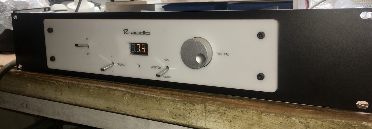

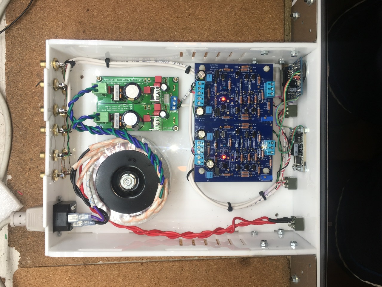

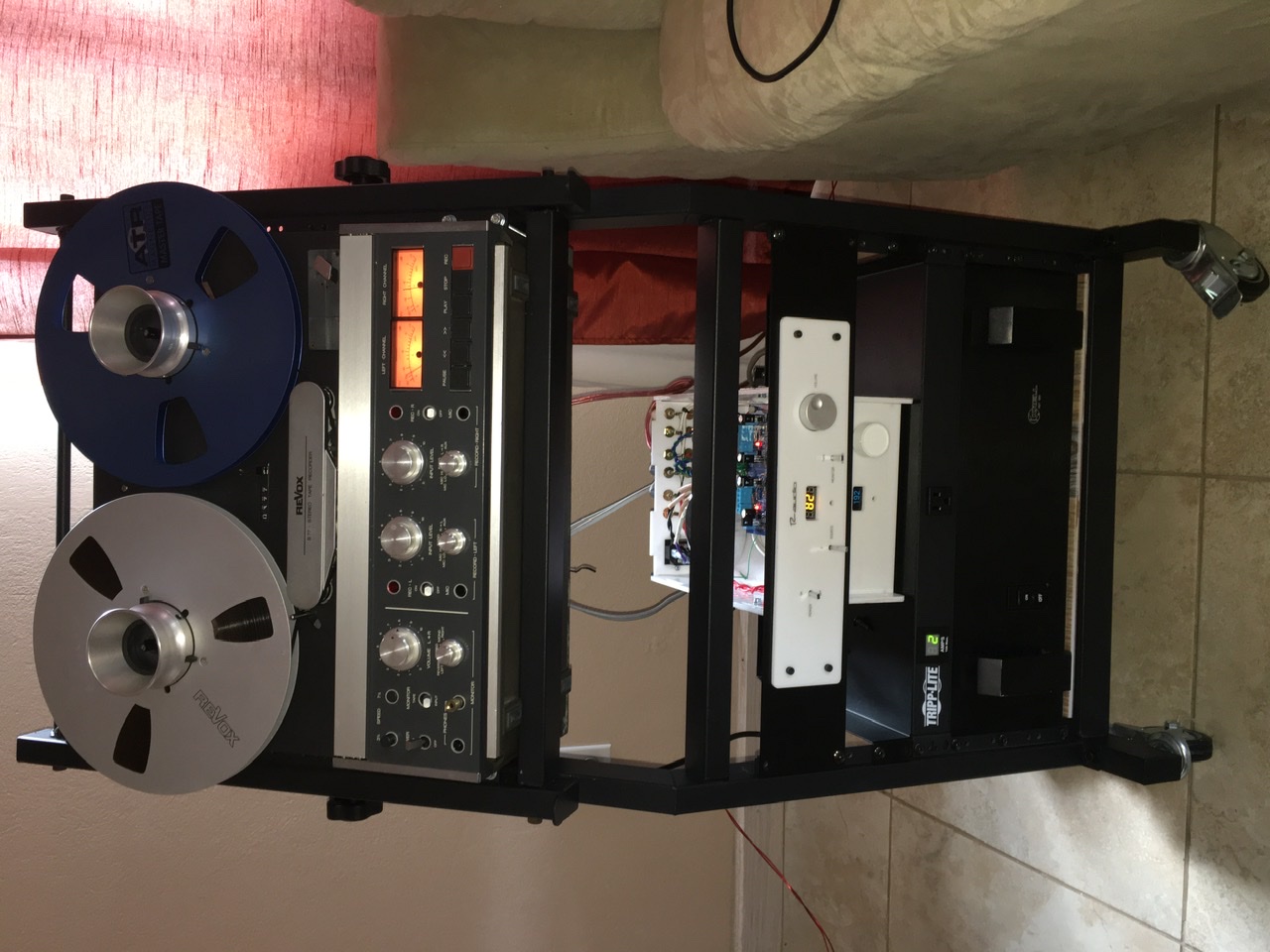

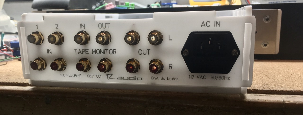

Another of Wayne’s BA2018s. Incorporating Lenny’s VCU Muses board/display/remote offering - great value for $100, IMO.
it’s done in laser-cut perspex and attached to a 2mm-thick 2U blanking plate for use in a rack. I am waiting on a Faraday cage enclosing the BA2018 that one of the local metal-working concerns with an industrial punch has been promising for about a month - but the manager is family so I’m low priority.
It has two source inputs and a tape monitor. The Krell chassis in the last image is an M2X in disguise 🙃.

The Revox in the image came in to my possession at the beginning of this year in terrible condition. I paid $150 for it and spent about $500 restoring it, with valuable help from a retired senior BBC engineer. Took months but it was a labour of love kind of project and it’s now working great - calibrated and completely rebuilt mechanically and electrically. So go for that Dokorder….
