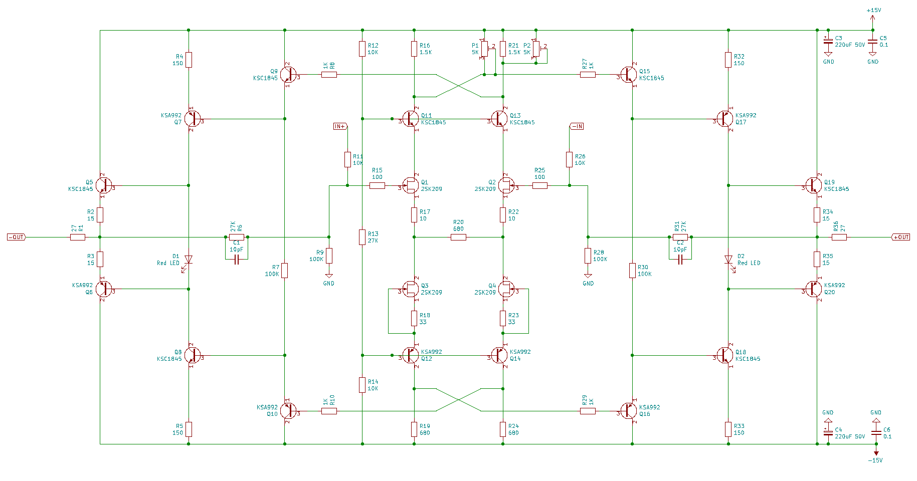

you id mention balanced inputs, I did this with original schematic from post #1, where input is strictly SE
can't remember where iteration with Bal input is posted

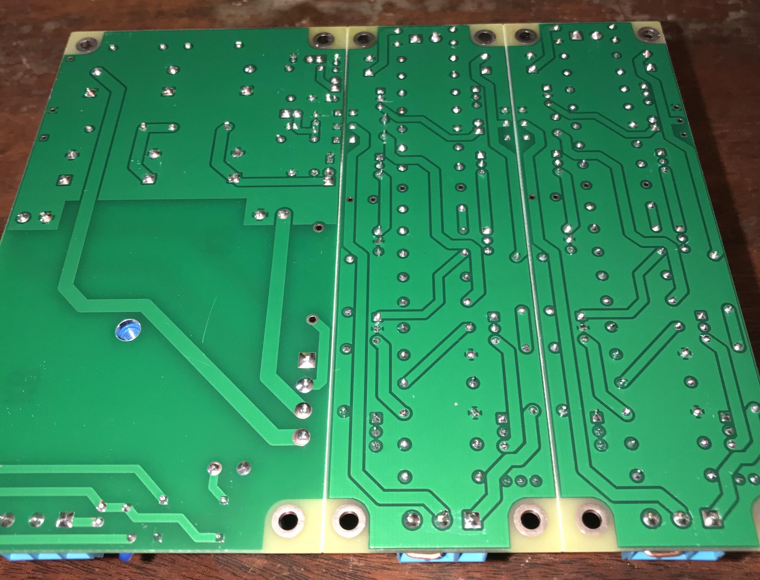

Last year I saw Zen Mod scheme of X-ed Wayne Line Preamp and drew it in KiCad.
Yet I could not drew a decent layout so I decided I will try again someday in future.
But X-ed scheme look pretty in my opinion and so I felt a big urge to post it.. again. 😀

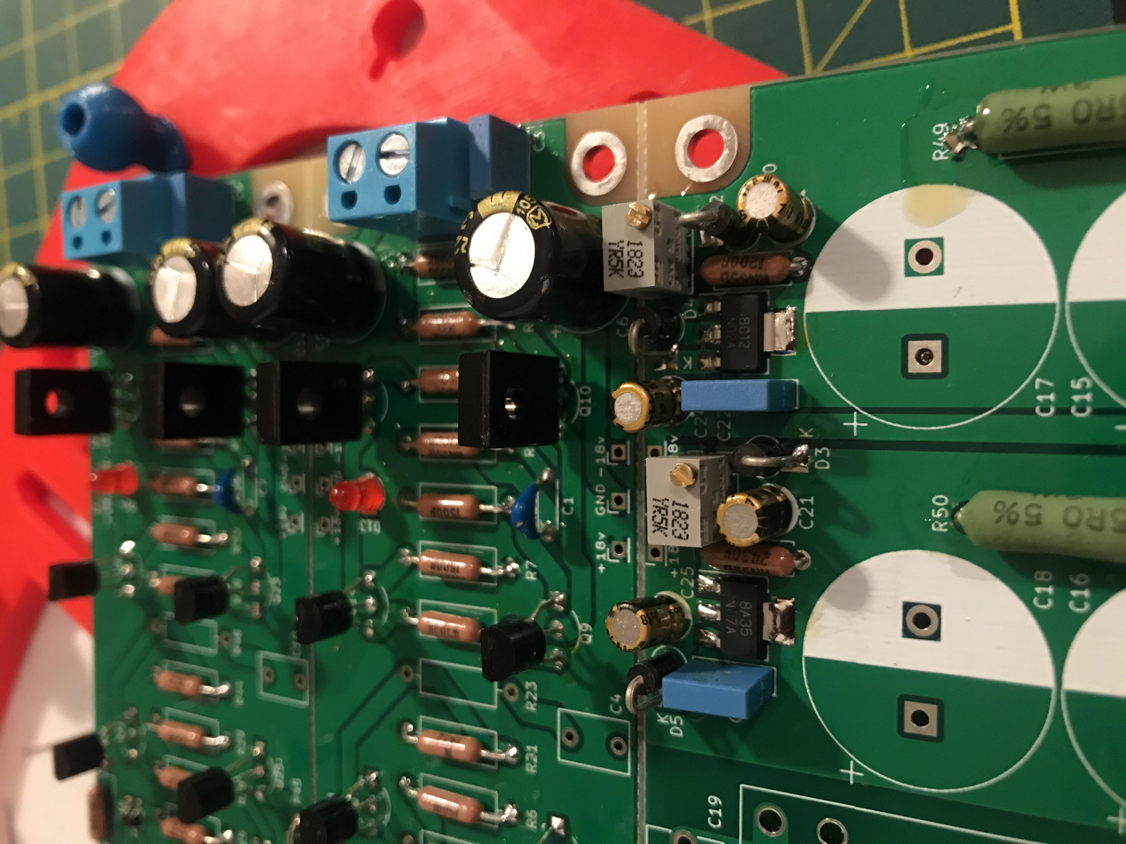

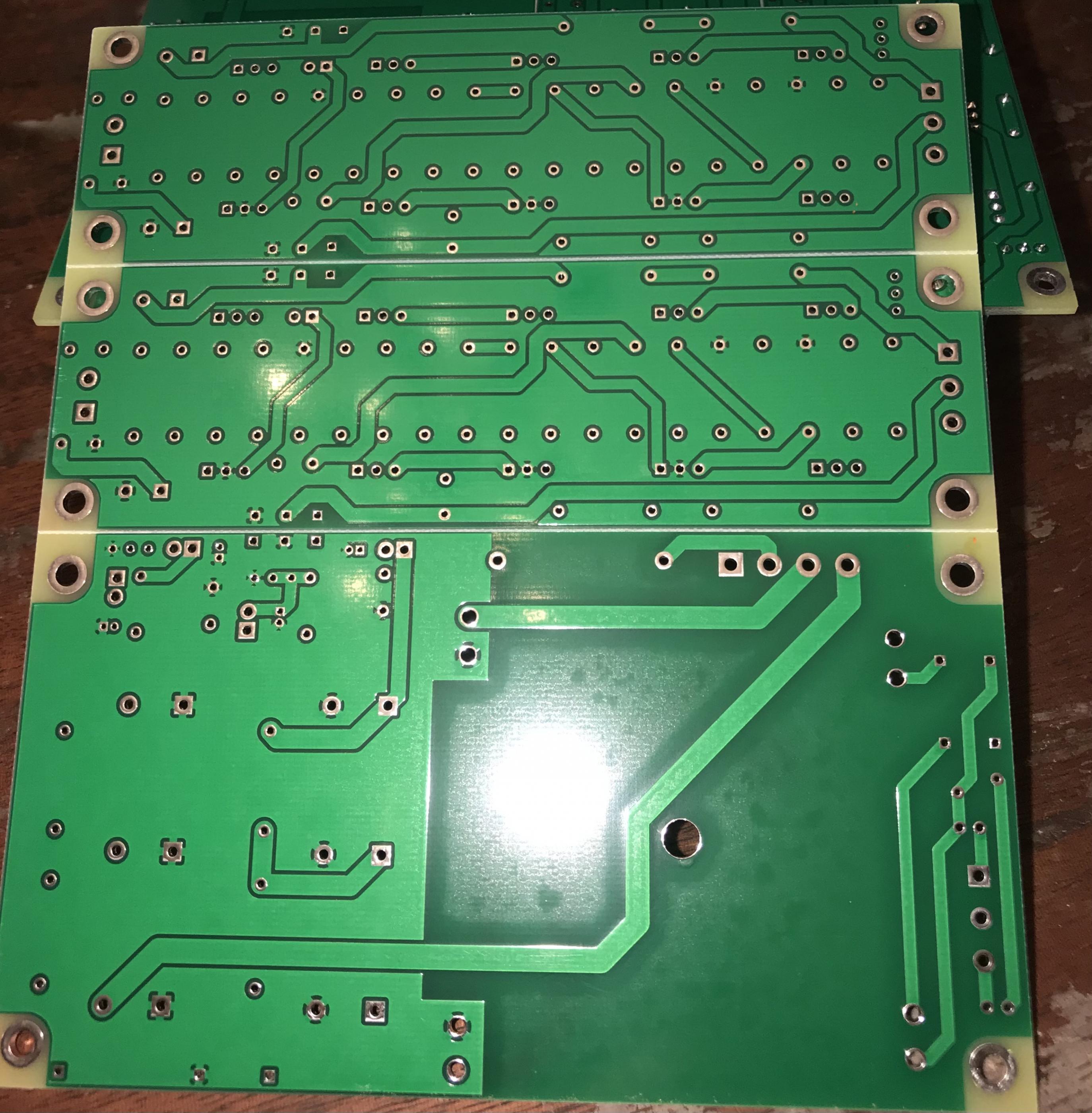

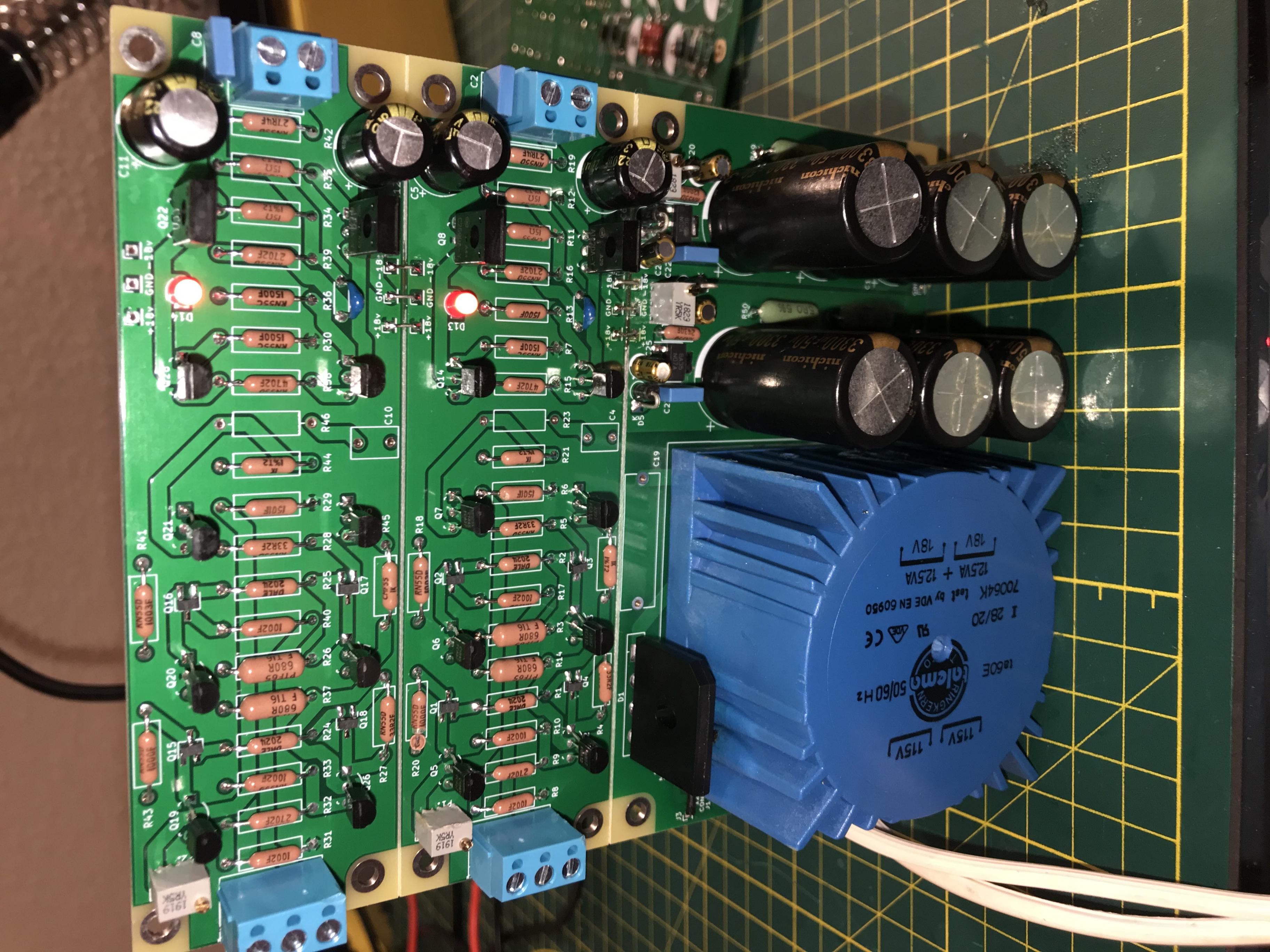

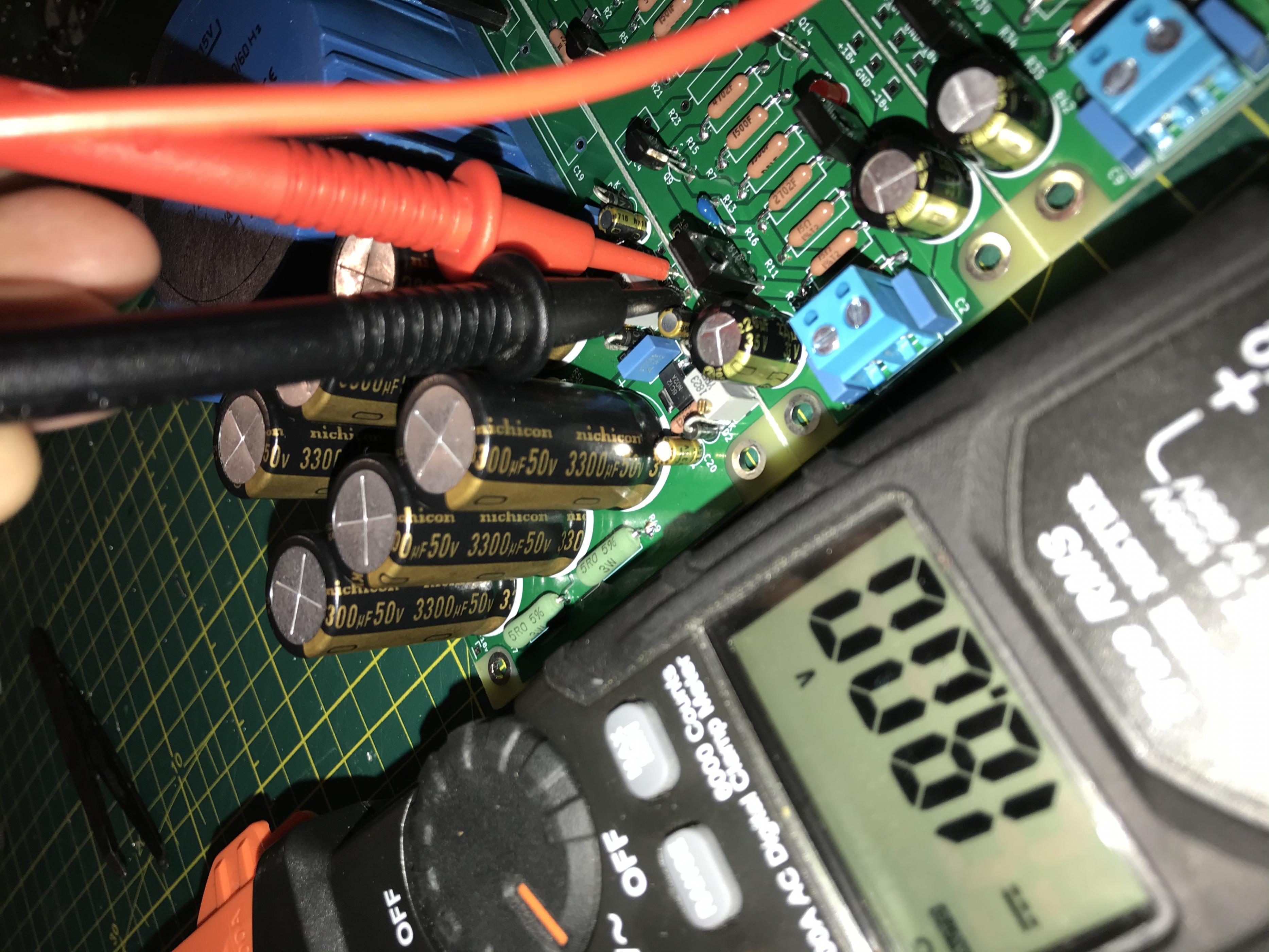

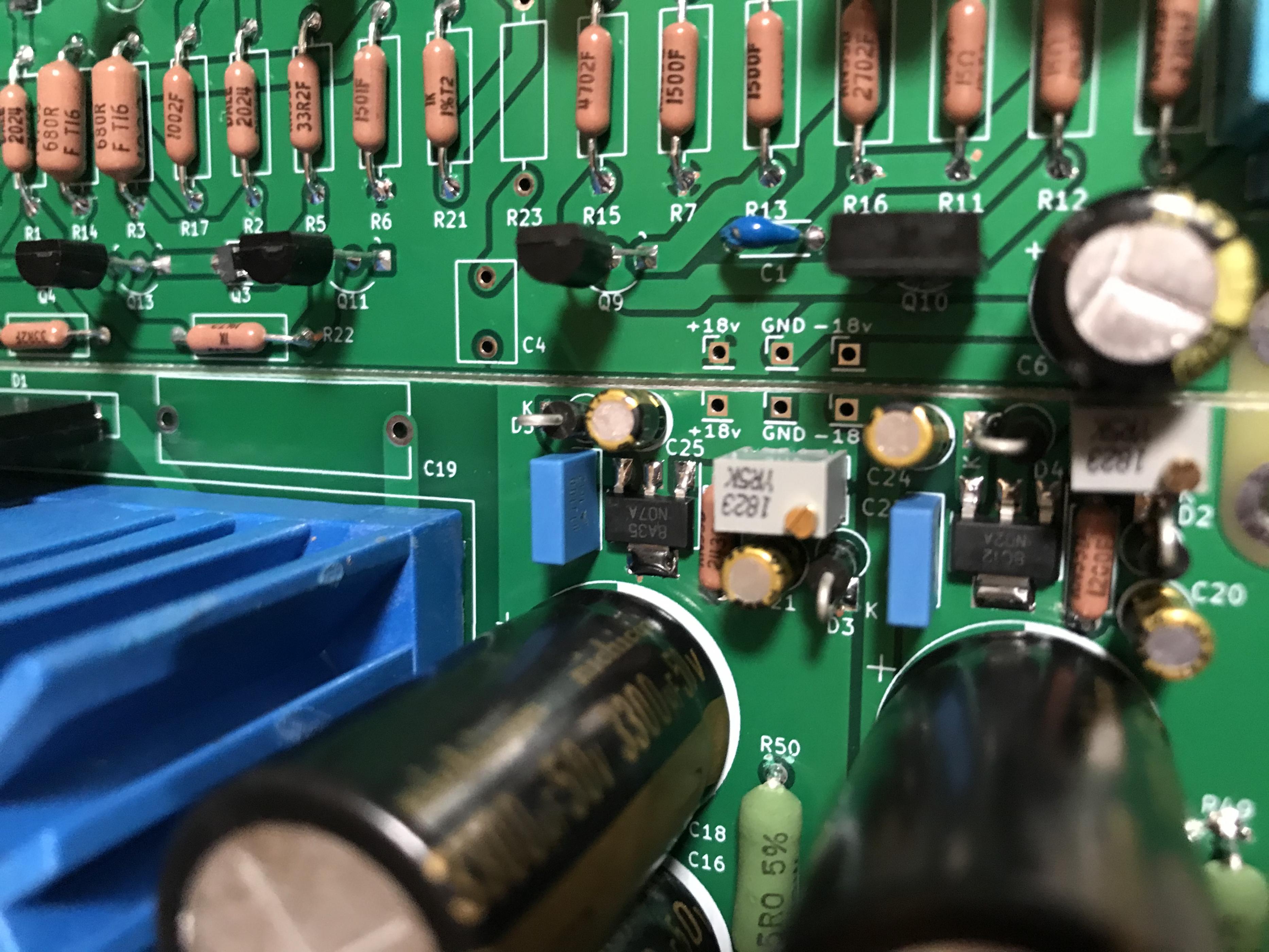

New design seems to be working! Voltage is set and line out offset is 2.2mV. Now all that is left is bench testing it to see if I need to relocate the power supply further away.....

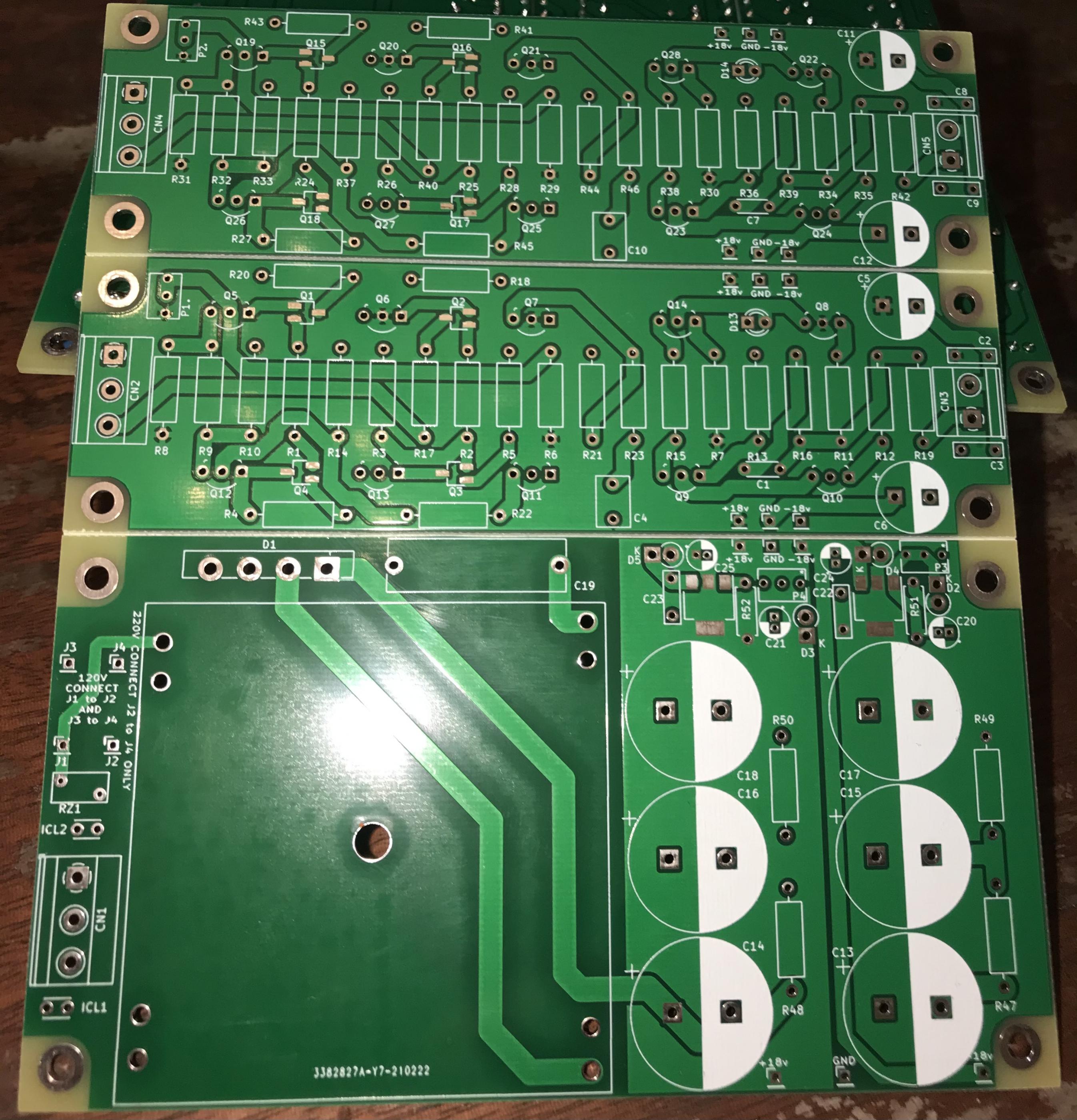

congrats!
I'm simply unable to get them ( parts ) so nicely aligned, and not-complicated routing, in same time
Very well thought out! Good job. Will enjoy final outcome.

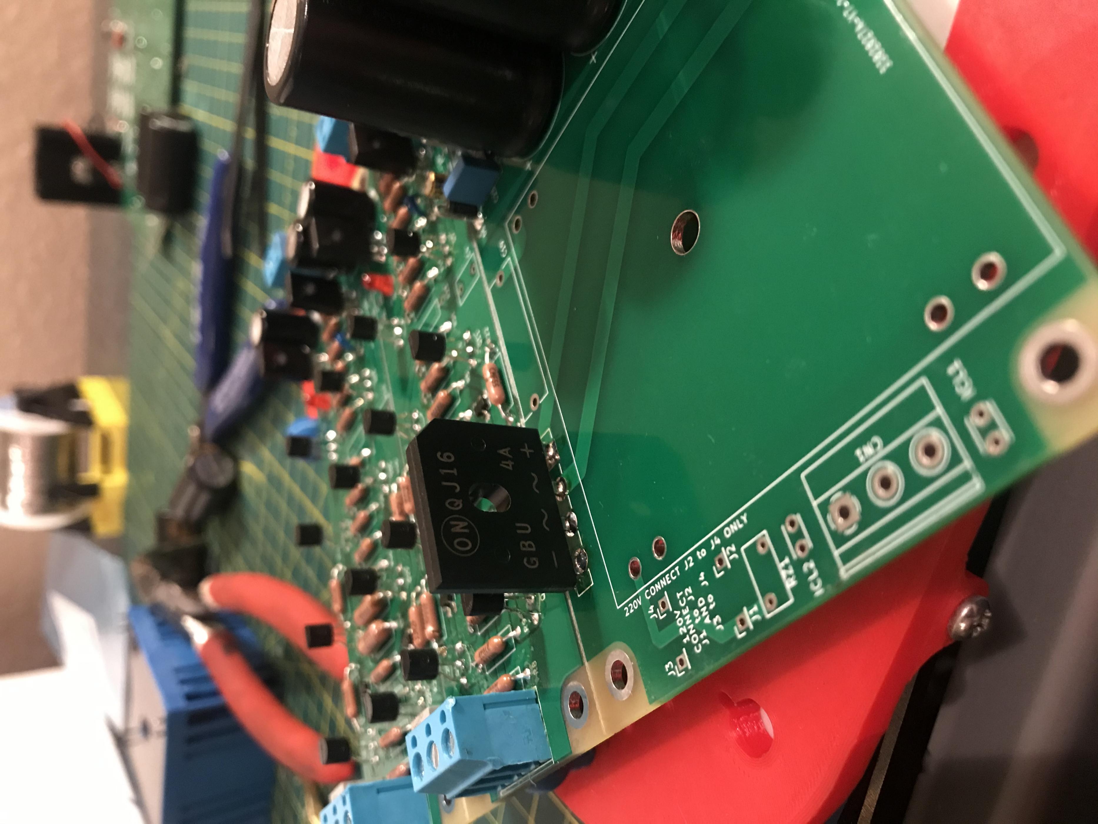

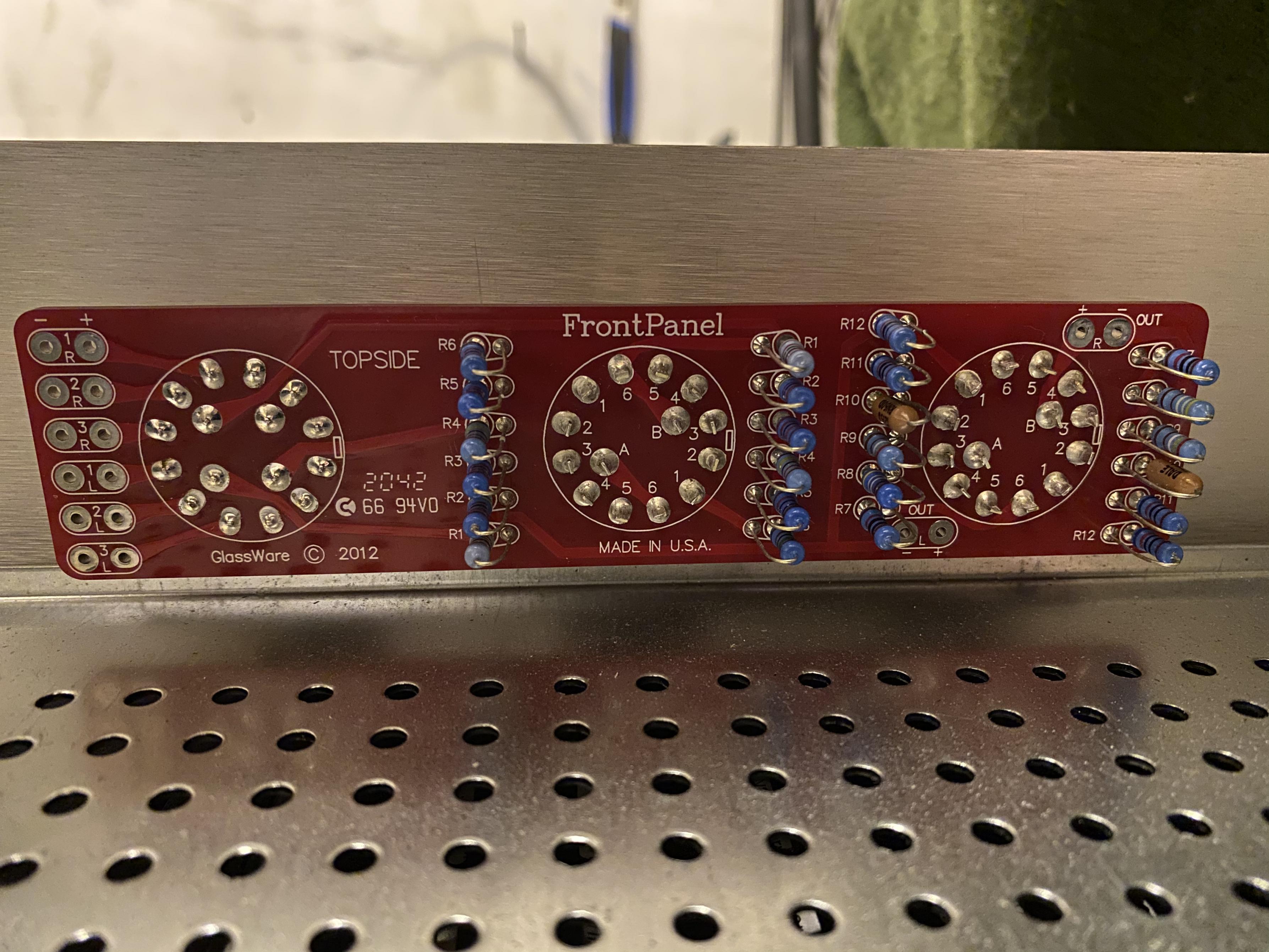

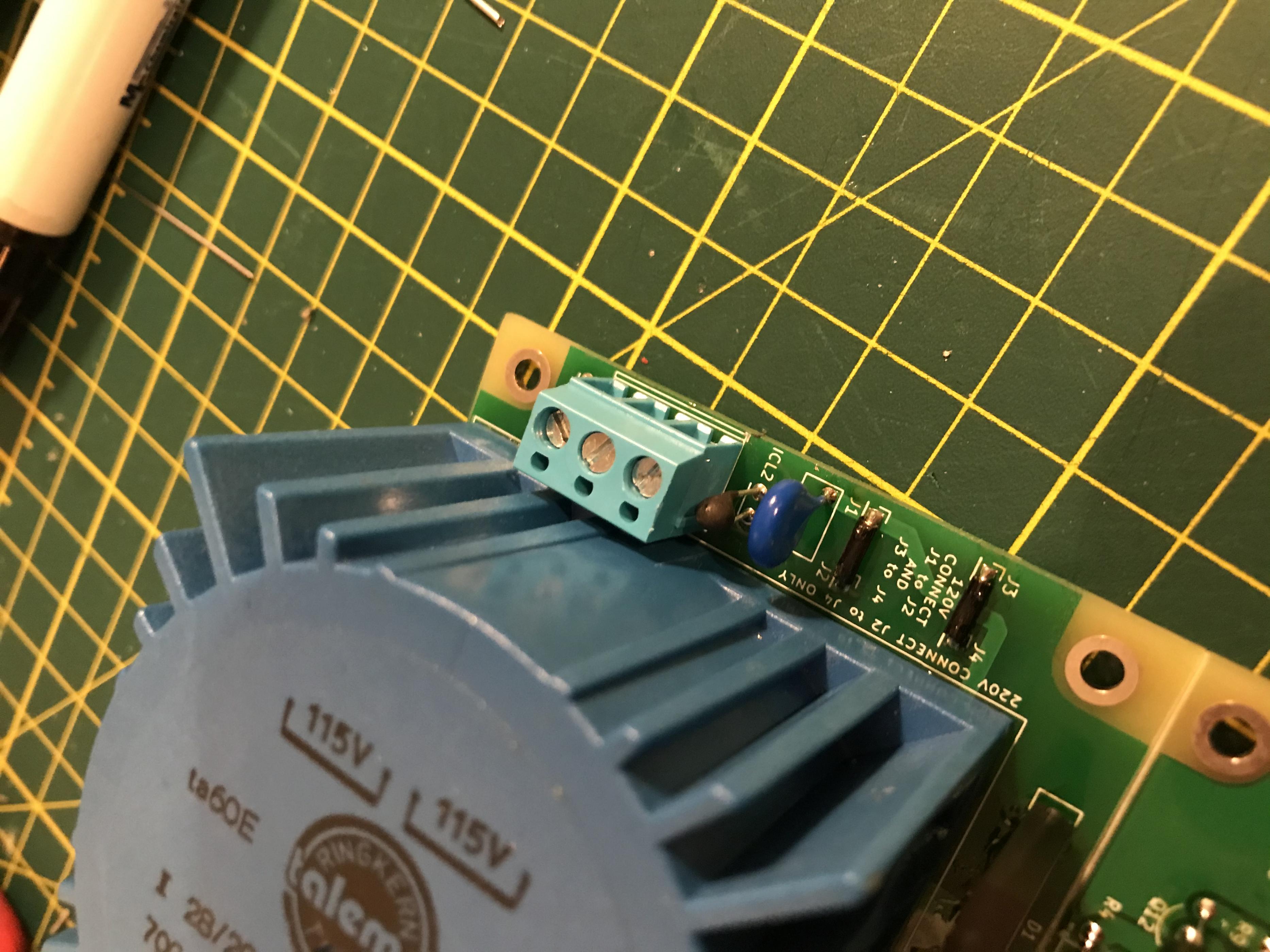

In the meantime, I have started working on the preamp. I have assembled the Galaxy 388, and behold: there is just enough room for everything. Pic shows case with UMS base plate and Gaz’s PSU board. Cap included to check if there is enough vertical room, and there is. Smooth.
Currently soldering the Glassware Frontpanel for attenuation and source selection. Got some Modushop knobs to go with it. Needed to drill larger holes (0,5mm larger), and they fit snugly. Next up is PSU, and then some metalwork.
Maybe just as well getting my soldering skills up to speed with a soft start, before doing the JFETs. Looking forward to that!
Plan is to put in the supperreg set up for 18 volts once everything else is working, there is room and I have them, so why not.

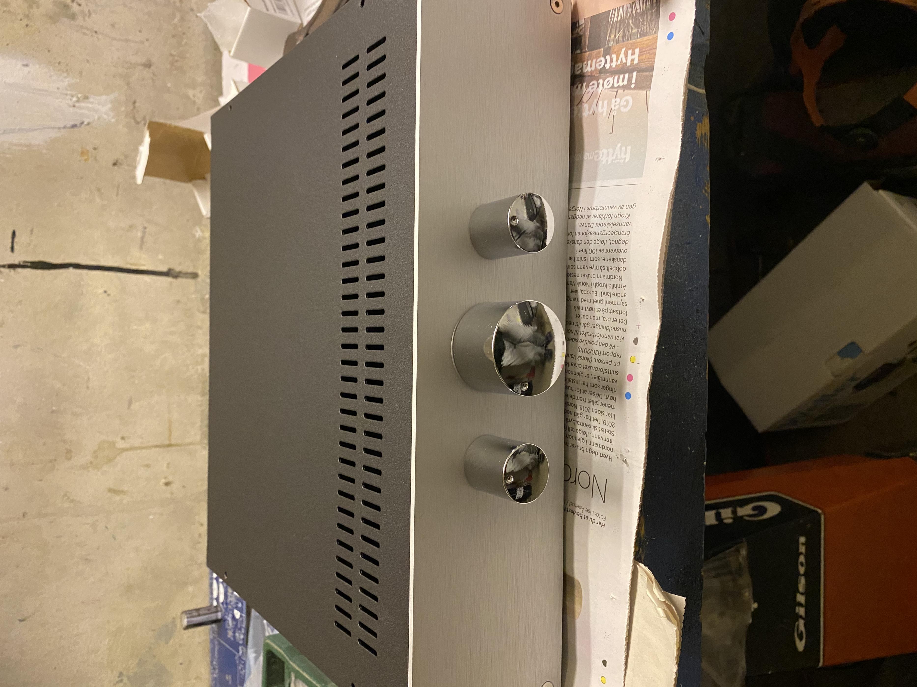

A bit of late night progress in a moment of solitude. Managed to finish the Glassware Frontpanel, drill and mount it. And those knobs don’t look too bad imho. Misses should be pleased, or ar least not displeased. It is a balancing act, from transistors to wifes. Best not get either to hot in the negative sense. Positive sense hot is good though. Maybe the end result makes so beautiful music my hobby becomes an afrodiziac. One can only hope.
