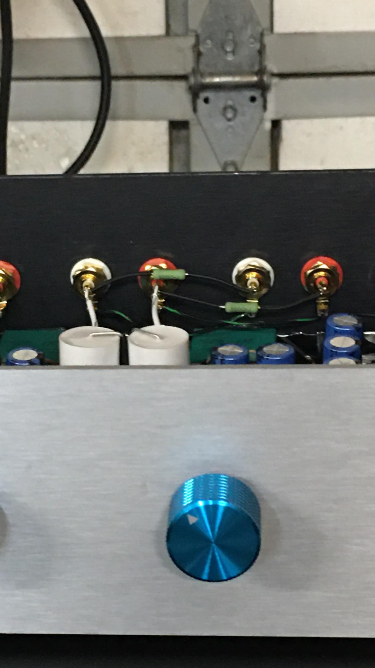

In case you are talking about my preamp and not String Emil, thanks, man! And don’t say you ain’t relevant! Like your work, your thoughts and your advice. Thanks for your advice on Mogamis btw! Know where to buy some for the preamp? Rather not in 500 feet rolls... which is most of the wire I look up is sold in.
Here is a few photos of the progress so far. First pic shows the rca and headphone jacks that were very low quality. I will finish the 120v wiring tomorrow but I’m waiting for a better headphone jack to arrive to finish the output. Also thank you for all the kind words! As always, if you see something that could be improved, please let me know.
Looks marvelous! It is really cool you made your own boards. Could you drop a note on the source of those signal cables?

How does it sound?
I just had a quick ear on it—yes it is very promising! But already very livid(?), clear, quiet... I'd prefer not to further comment right now, it has to settle in, and some parts aren’t in the final stage...
(missing the new attenuator, and I'll have to check out if the cinemags are really required for the f4...)
