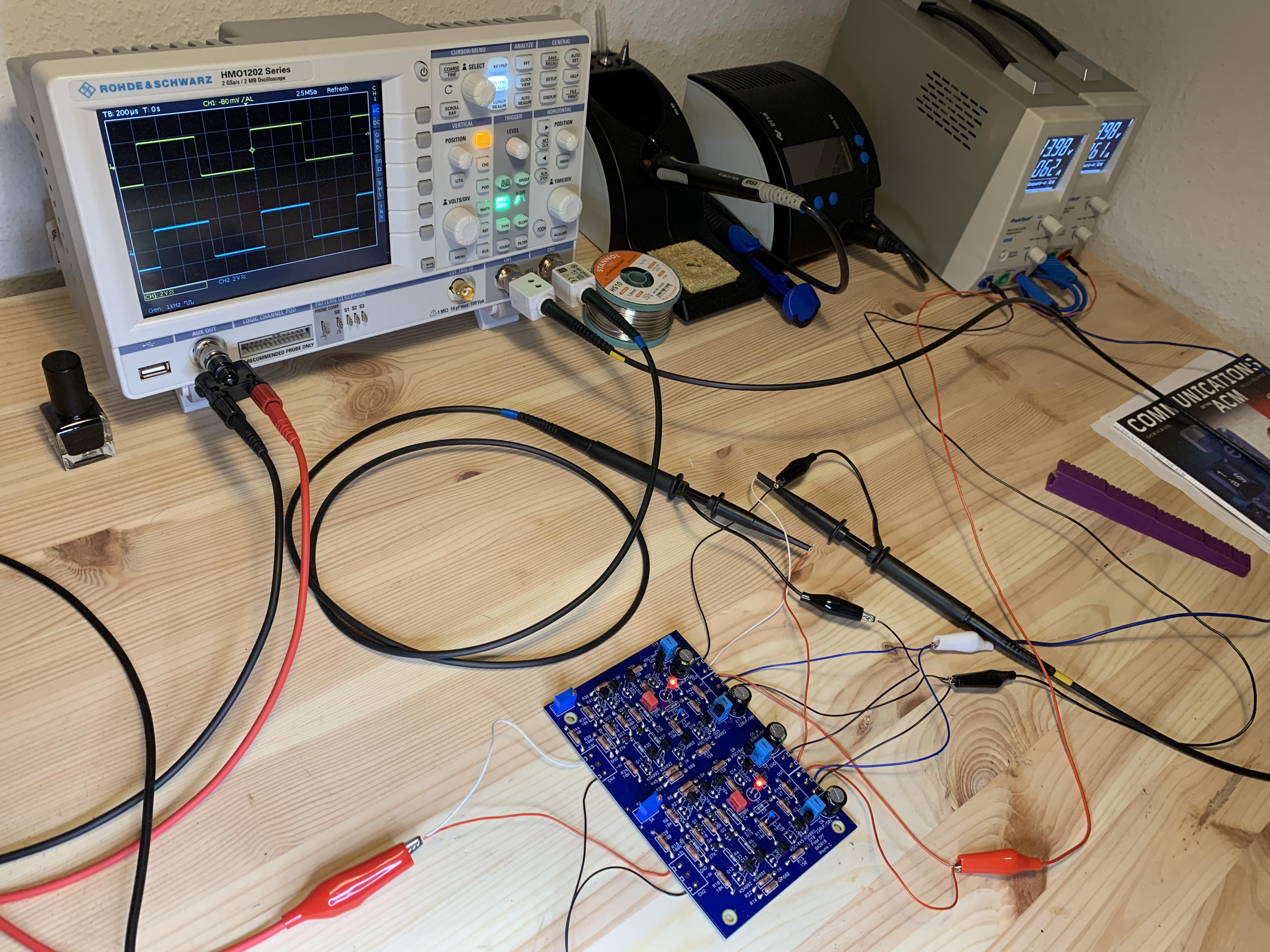

Another line stage is born
Testing it with a 1kHz rectangular signal looks very promising.
Running it with 2 daisy chained PSUs at +/-14V. Looks also very good.
Next step: 2 GoldPoint virtual ground (VG2) as PSUs. The GoldPoint VG2 will
allow only for +/-14.5V at 30V DC input (my estimation).
Hope that this will work without clipping. Any experiences with this anyone? Would be glad to hear about this or 14.5 V in general..
Thanks to everybody here. This thread gave so much input for me.
Best regards
Detlev

This thing makes a fantastic balanced to single ended converter. My DAC is balanced so I took full advantage of that feature.

What I wanted to build is a non balanced version. When I later tested it with real audio signals I noticed that I made a mistake connecting the outputs. I have no clue, why the scope showed the correct signal. However, it masters music very well.

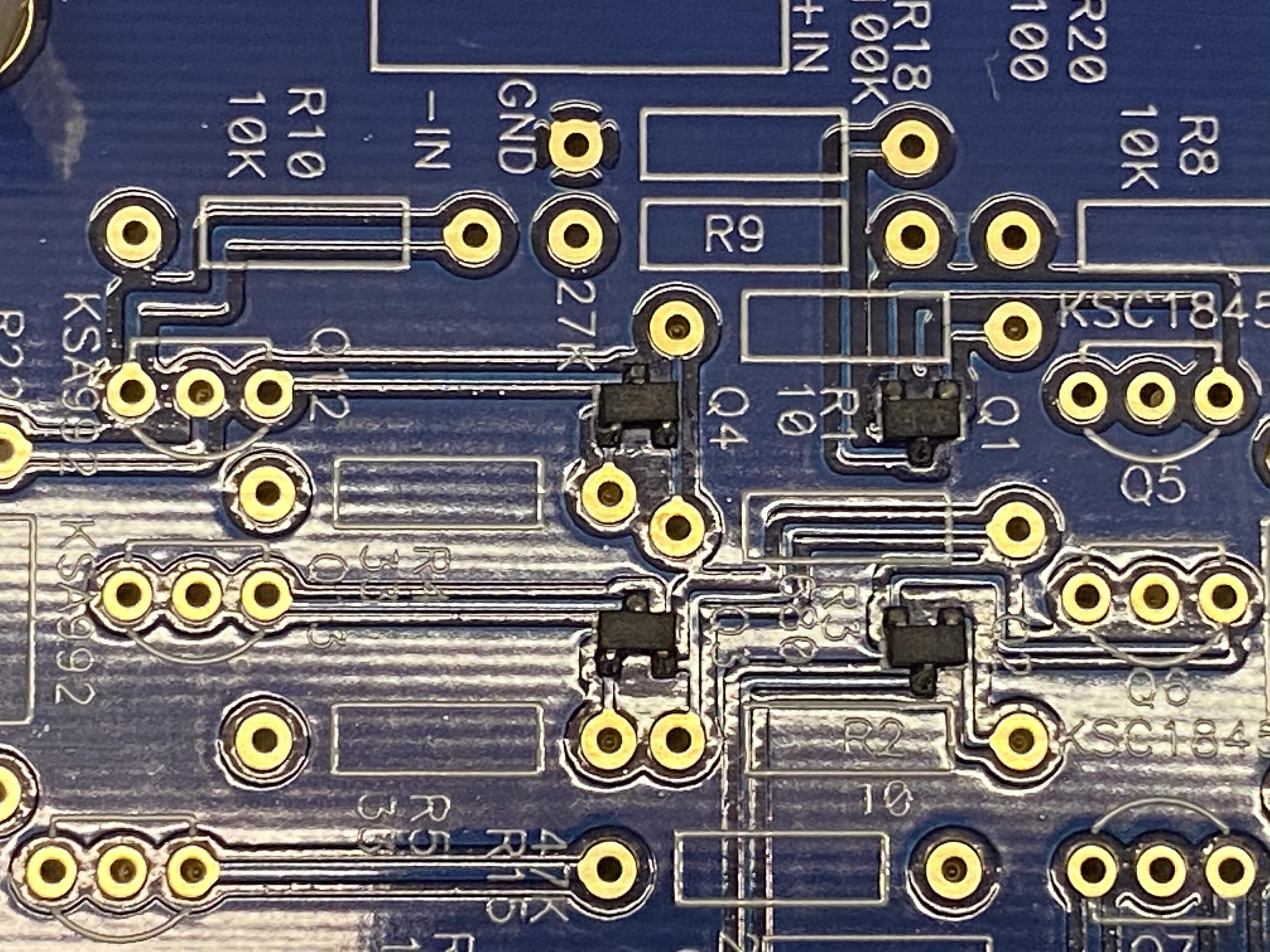

I finally got to working on the WLS tonight, as a generous package of JFETs arrived in my mailbox yesterday.
It is not my purpose to brag, but I wanted to share a pic of the first soldered JFETs, because I am proud of having made it with a seemingly OK result. Looking forward to the rest of the build!

Hello Andreas,
soldering on the JFets is looking good and well aligned.
Continue going the quality - work - road....😉
Greets
Dirk

Thanks guys! Really appreciate it.
