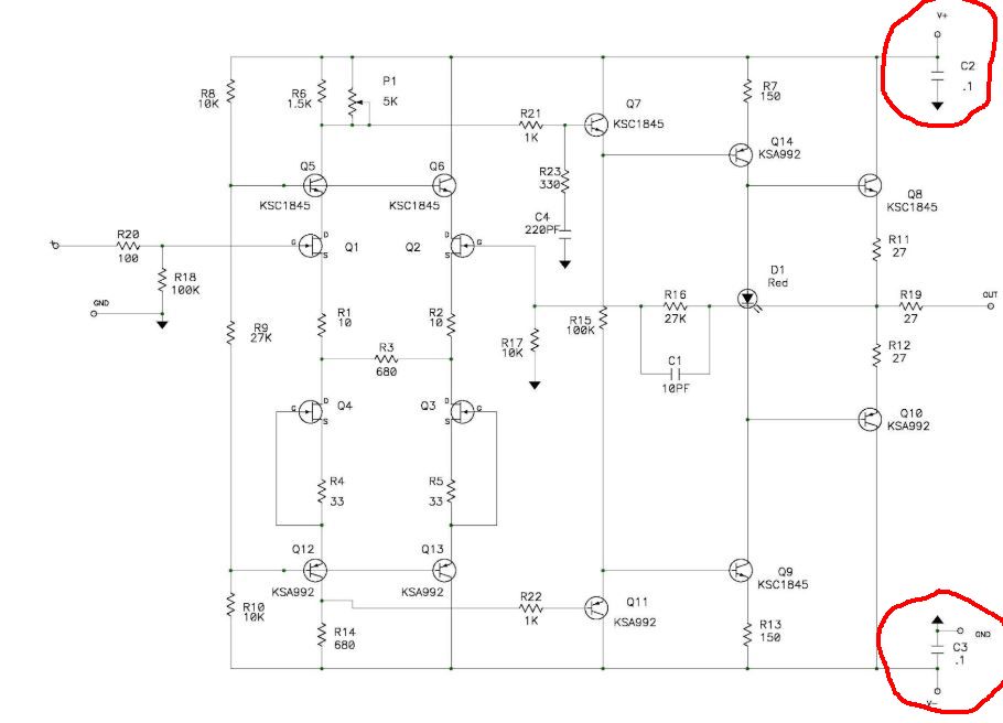

Then I have only one concern:
My transistors for the almost finished channel, now has transistors all from the same reels.
If I get the ones from leftear, one side will have transistors from different reels. This is because I gather he as just as many parts as I lack. Is that an issue?
I am not talking about the importance of matching, I know that is not vital in this circuit. But in general it seems most people, also using the kits from 6L6, use transistors from the same reel and so they are likely to be alike.

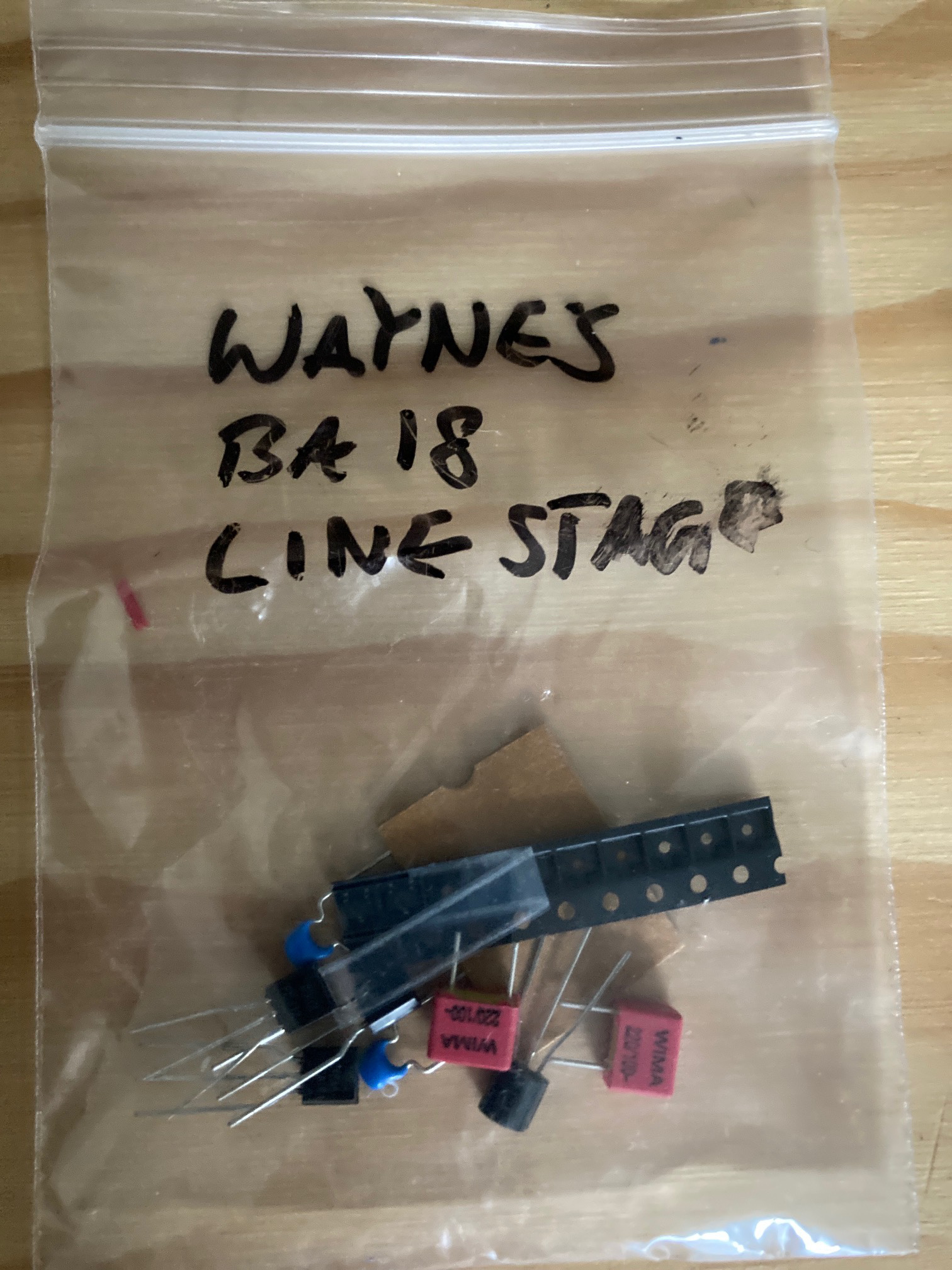

As I neared completion, I discovered that the shopping list used from this thread, lacked 4 transistors to complete the small output stage version. I lack two 992s and 2 1845s to finish the preamp.
And... both Mouser and Digikey are sold out.
Anyone by any chance have some leftover transistors to send me?
I should obviously have double checked... but here I am.
Andy
I have lots of these. But I am halfway around the globe.
Thanks to all of you!
Fortunately Myleftear has helped me out, and they will be on the way in a few days.

So the first channel is fired up, could’t wait for leftears parts to arrive and did have enough parts for one side. And after some mismounting, pulling and resoldering, it look quite allright.
Offset also zeroed, hovering +/- 3mVdc in a drafty cold garage workshop. But seems very temperature sensitive, kinda like the BA-3, if not as touchy.
Would some TO-92 heatsinks on the bipolars benefit this circuit? They cost a penny, but not super expensive at approx 25 dollars for 20 pieces.
Here: 575200B00000G Aavid | Mouser Norway
Worth it? Or just be patient and adjust offset for lid on room temp operation? I think I know the answer that will come, but some experiences are valued.

Good to hear. Thank you, and good morning to you too! Also I did not let it get to equilibrium. Guess What I am really trying to do is find out if it works. Had some mishaps, you see, but gonna run a square wave through and see if all is good. Also gonna heat up the workshop and leave the circuit on for a while and see what happens. Don’t get me wrong: it zeroes, but if I blow on the parts offset drifts quite heavily. Perfectly normal I guess, and I see from other posts on the subject that this is normal also for the WLS.
I’ll drop the heatsinks for now, put it in a case once finished, do final adjustments in a normal living room, don’t worry and be happy! =)
BTW: those caps in the output section, do they take care of residual DC like in the BA-3? Or is it fired straight down to the poweramp?
Andreas
which caps?
The Wima or the 50v’s. To rephrase: is the DC residual removed or passed on to the poweramp?
