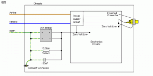

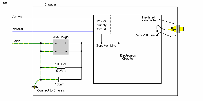

- The implementation of a line-capacitor across the mains, as in other Pass-gear (Pearl2, F-n etc.) is recommended/mandatory? (Same value (0.0033uF?)
- Ground loop breaker: a bit an obsolete question—Thermistor, Bridge à la Pearl2 or Elliott's loop breaker? 😕

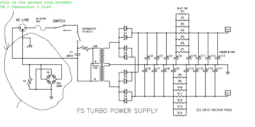

I second the loop breaker question! Planning on doing the grounding in chassis tomorrow, ao it is ready for the WLS.

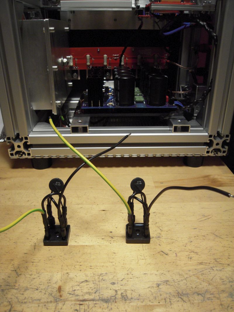

I have a 35/200 bridge and an NTC. How do I wire this up correctly? Wich wire goes where, and where does the thermistor go?
David I’ll check the Pearl 2 manual right away, see if I can grasp it.
Stupid question maybe, but I am no expert schem reader as you will know from the question...

With the thermistor, you'd connect the psi-ground to chassis. (PSU-GND — CL60 — Chassis)
Many say that's absolutely sufficient, 6L6 says Pearl2...

I have the thermistor solution on my BA-3. and while it is good enough for function, I find it not such a flexible solution, if not on a PCB of some sorts. So I wanna do the bridge/NTC solution for mainly that reason.
The bridge pics in 6L6s Pearl 2 build are excellent. If using an NTC too, does that replqce the black wire between audio gnd and the bridge positive post? Anyone?
to andynor #2297
Good morning Andy,
you connect your ground (audioground) of your PSU to the groundloopbreaker -
and
from the groundloopbreaker to the earthground.
You can find many , many recipes for groundloopbreakers....

Thanks so much, Dirk, and for the e-mail about the subject this morning! I guess the different ways of doing this is one of the reasons for my confusion.
I have worked the front panel and back panel today, and am now ready to start with the gnd scheme. I think I’ll go for the Pearl 2 variant, meaning bridge without NTC. Thoughts appreciated.
