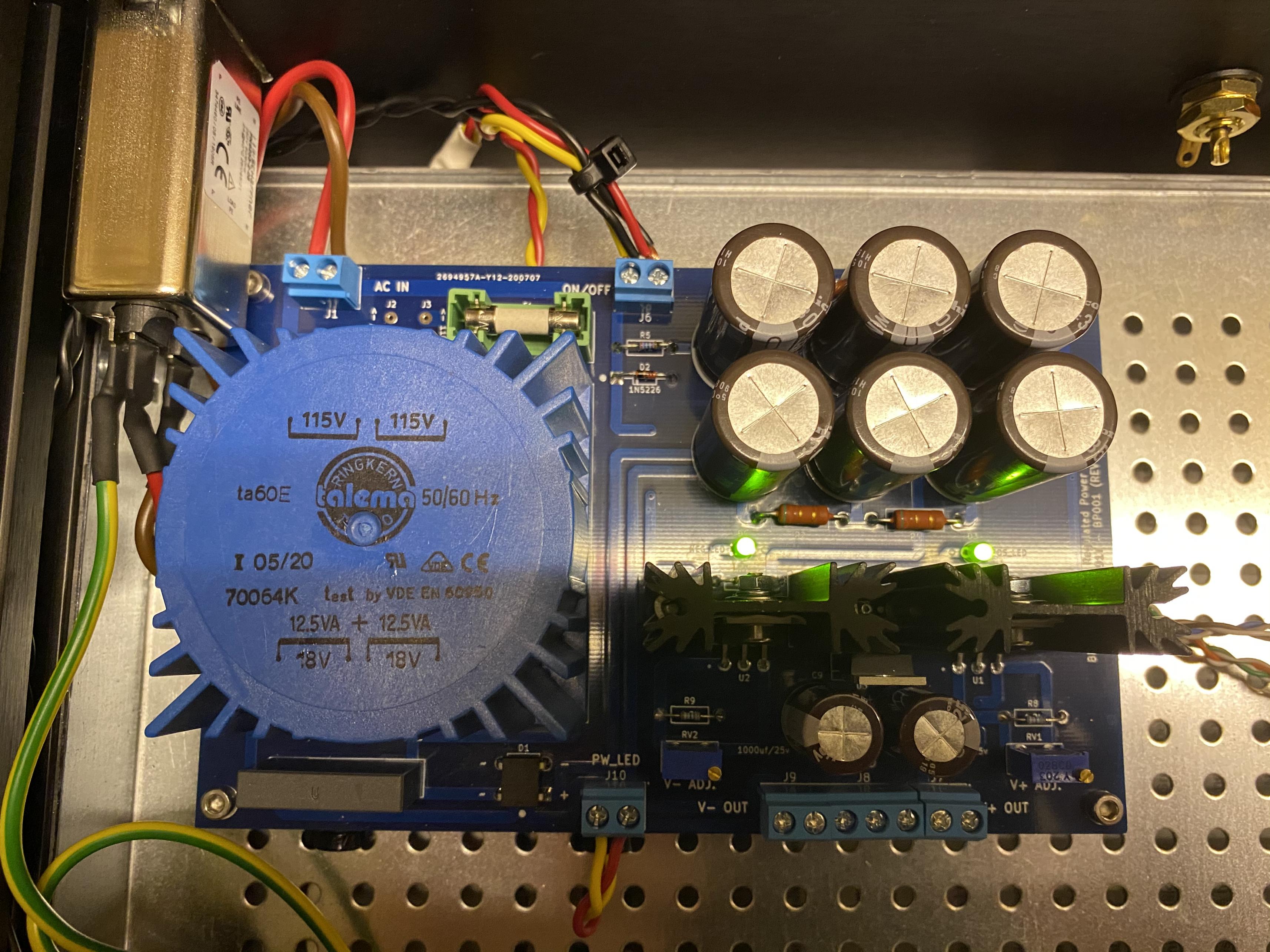

I am building it right now. I use the Whammy-inspired PSU from Gaz at audiosy.net. It is regulated, at 18 volts max (safe and tested), any more than that is at own risk according to Gaz.
The PSU is regulated and adjustable. It also has some neat features, like switch function without need for AC-carrying wires, on-led and standby LED in addition to rail LEDs.

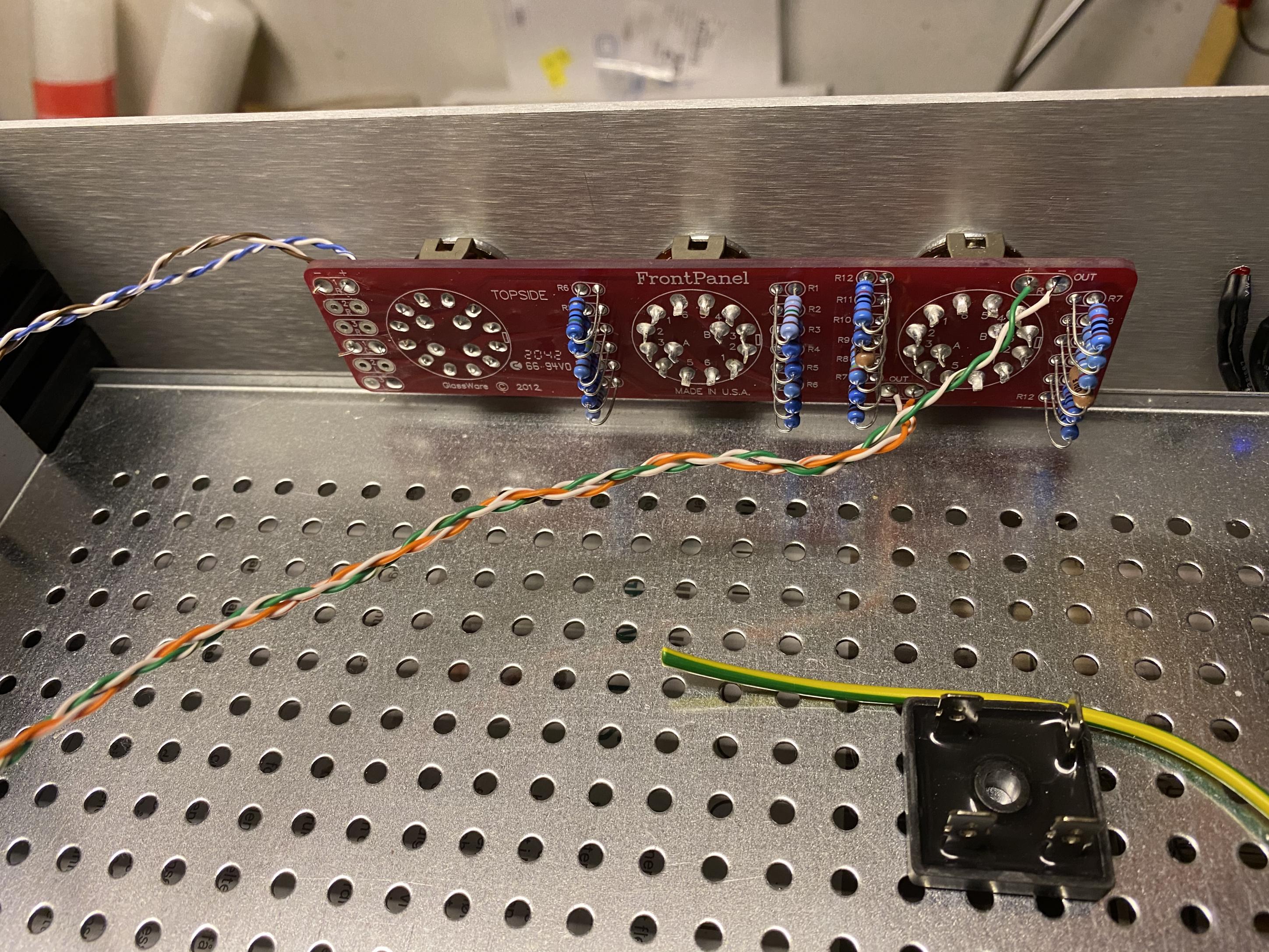

Thank you, Russel! Really looking forward to it. Only fear is that there is not enough attenuation on my Glassware Frontpanel. So I ordered a 20k bluepot that I am waiting for. Will redo the front of my chassis if I go for that solution. But first try as is 🙂
I am using a 25K series attenuator, and the attenuation seems just right to me, I would think 20k would be fine

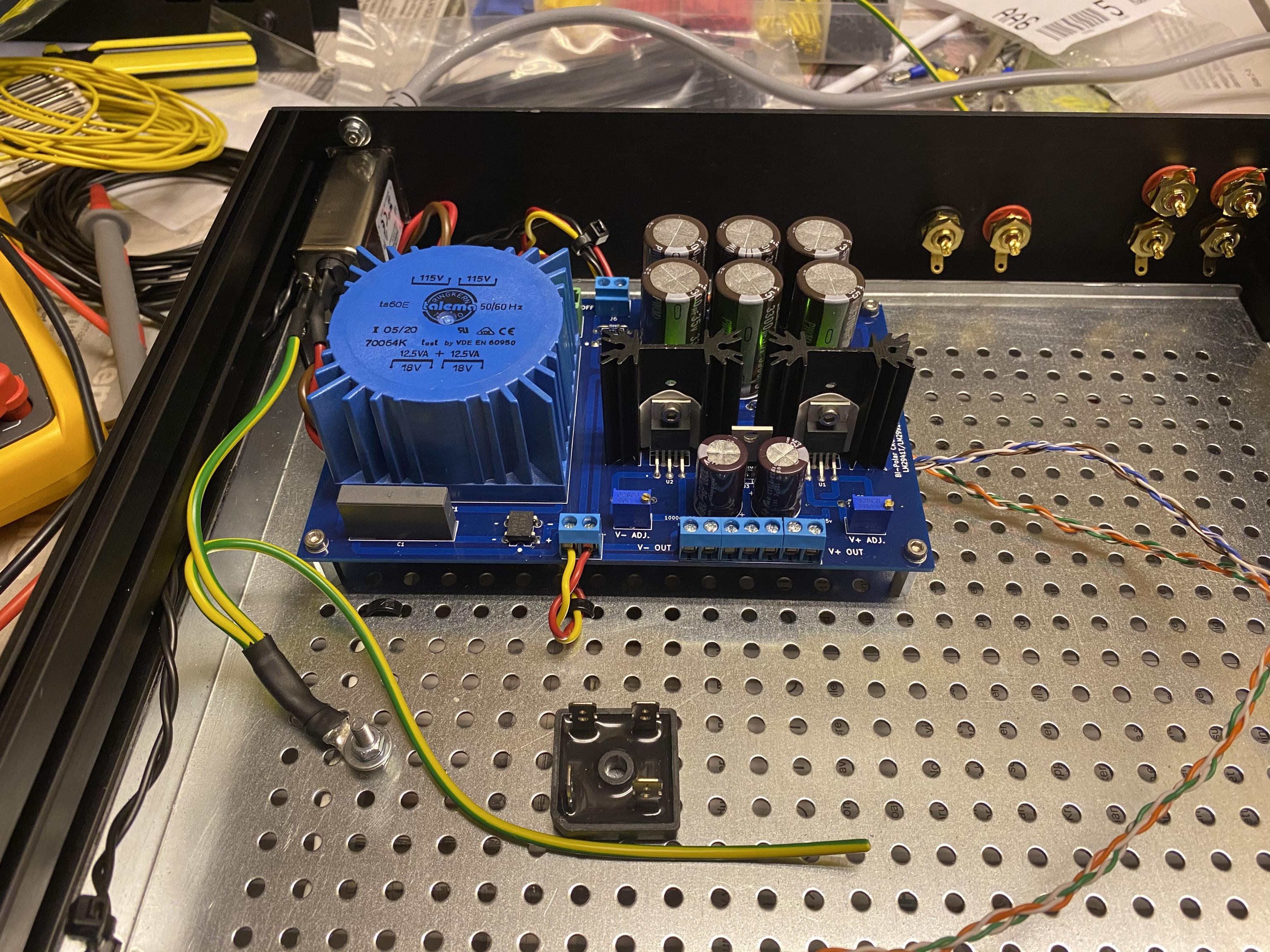

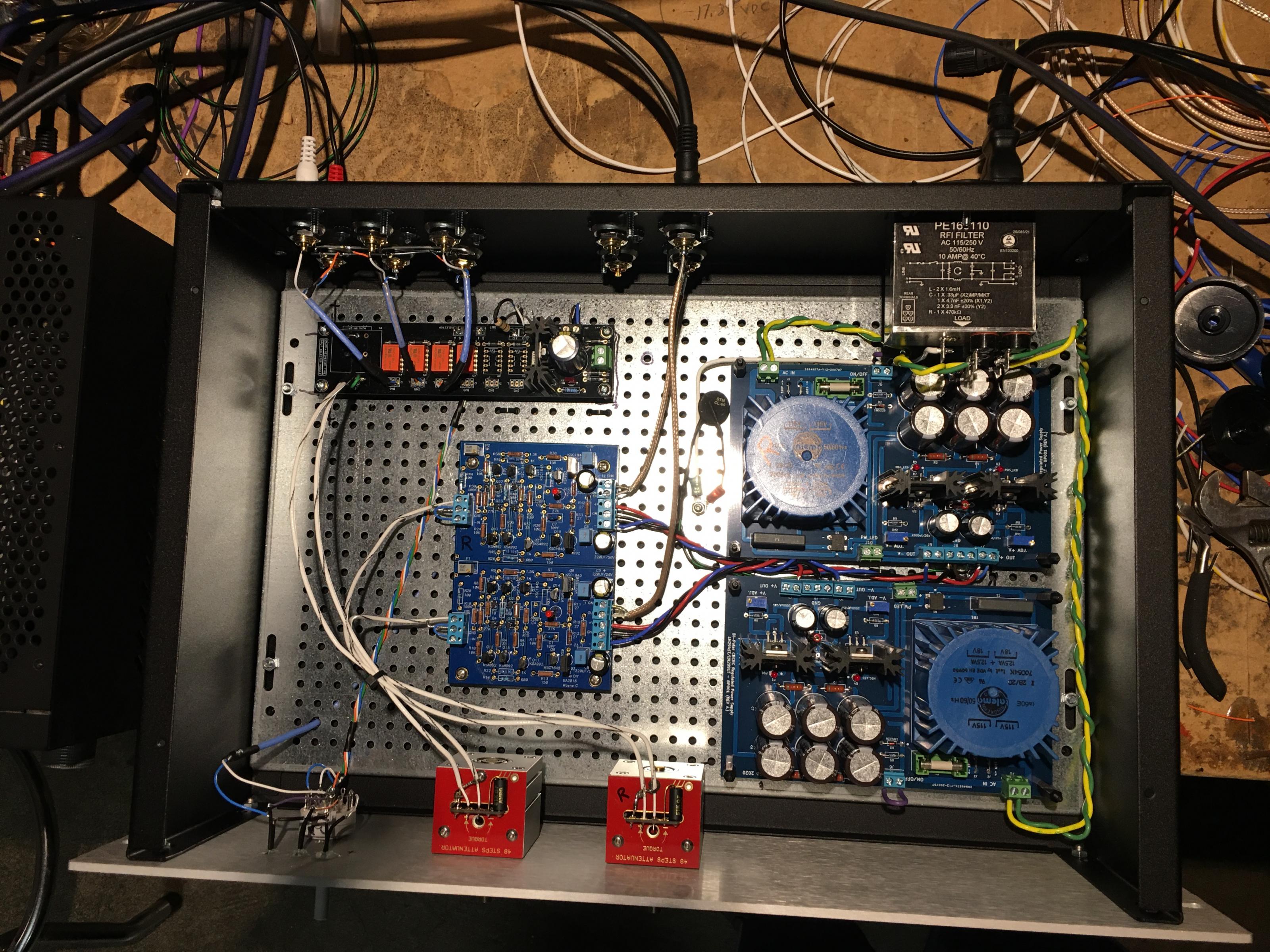

Here are some in-progress photos. Next move is to mount and solder the ground loop breaker, seen in the pics near chassis ground.

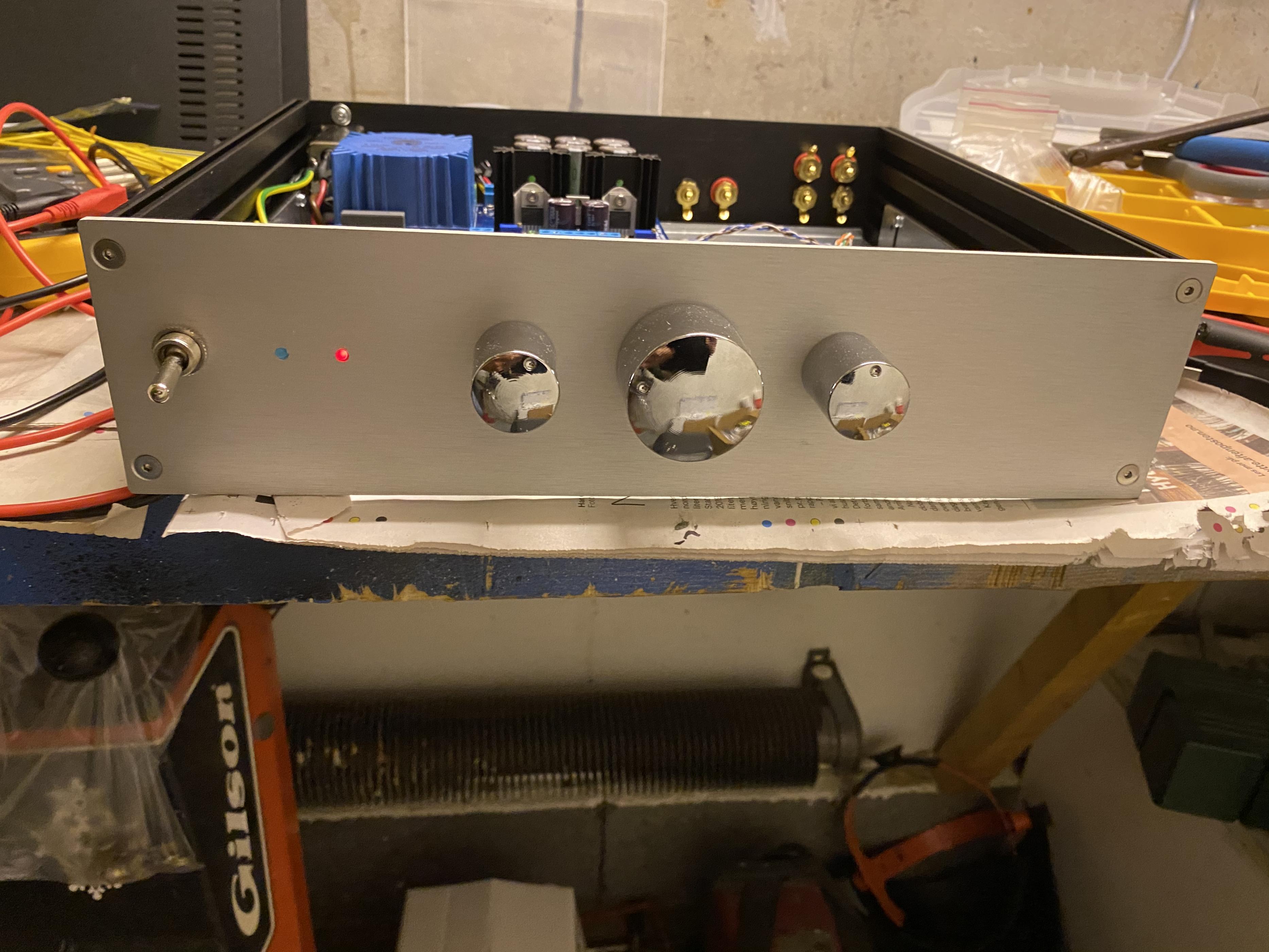

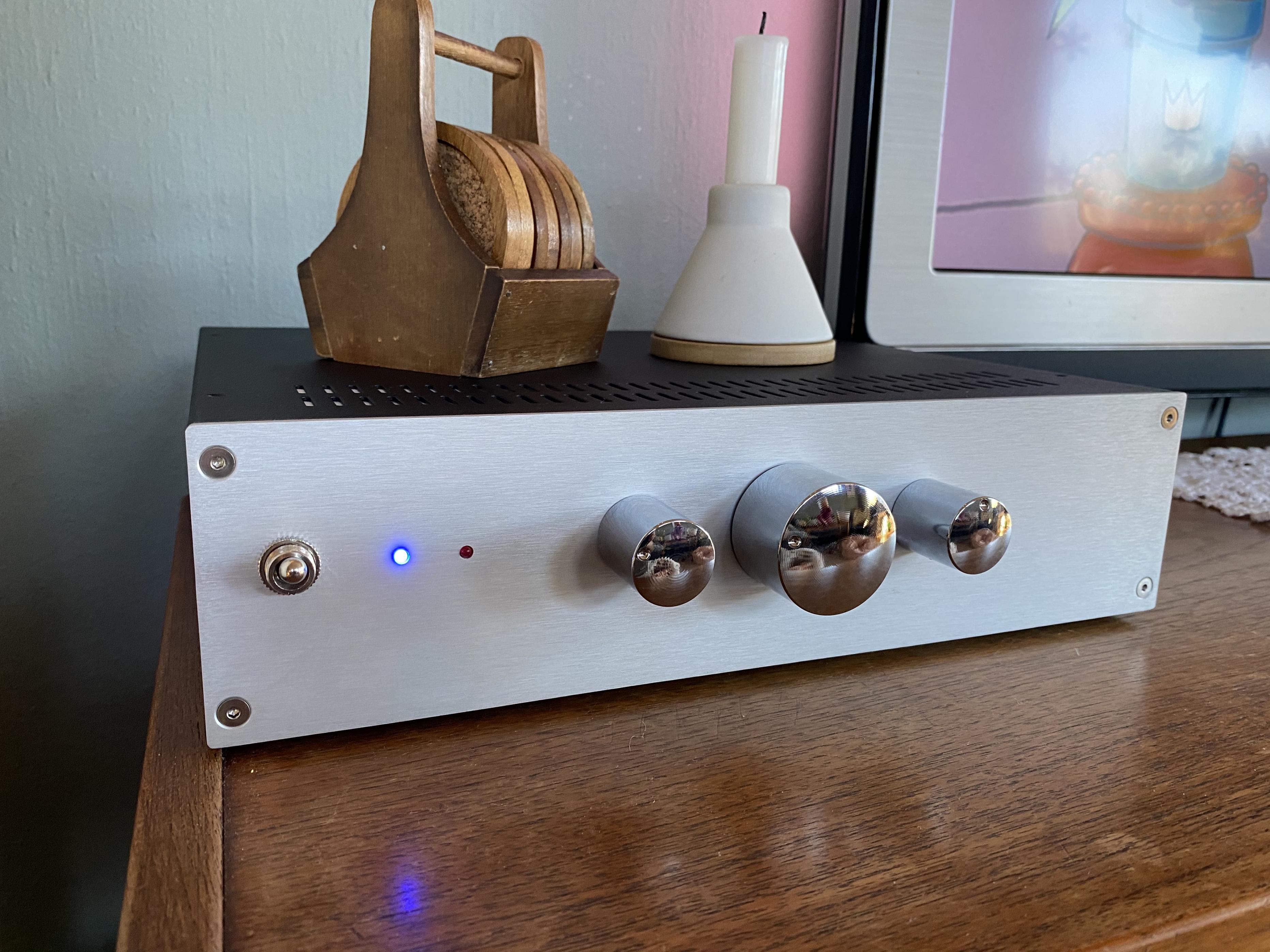

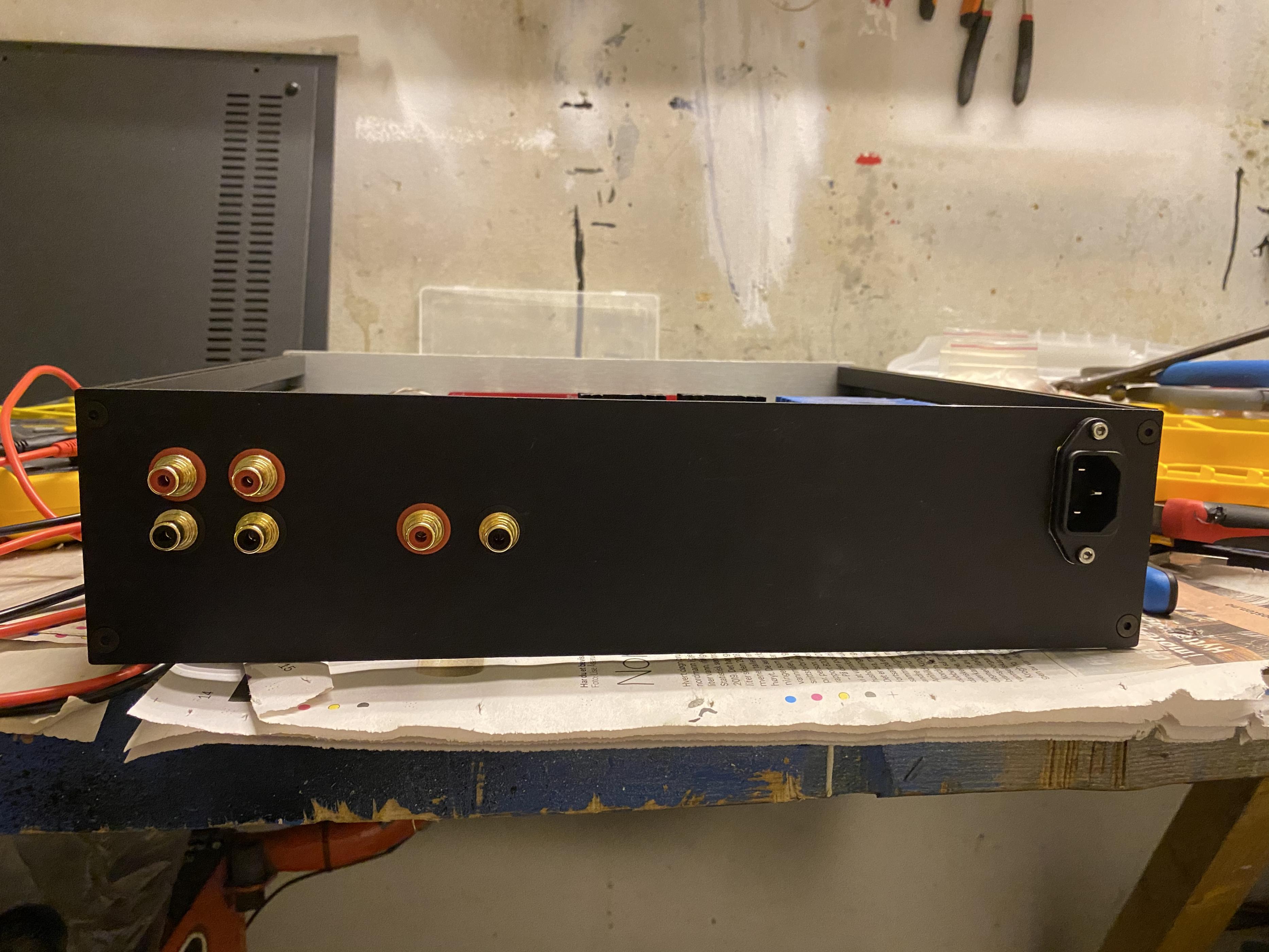

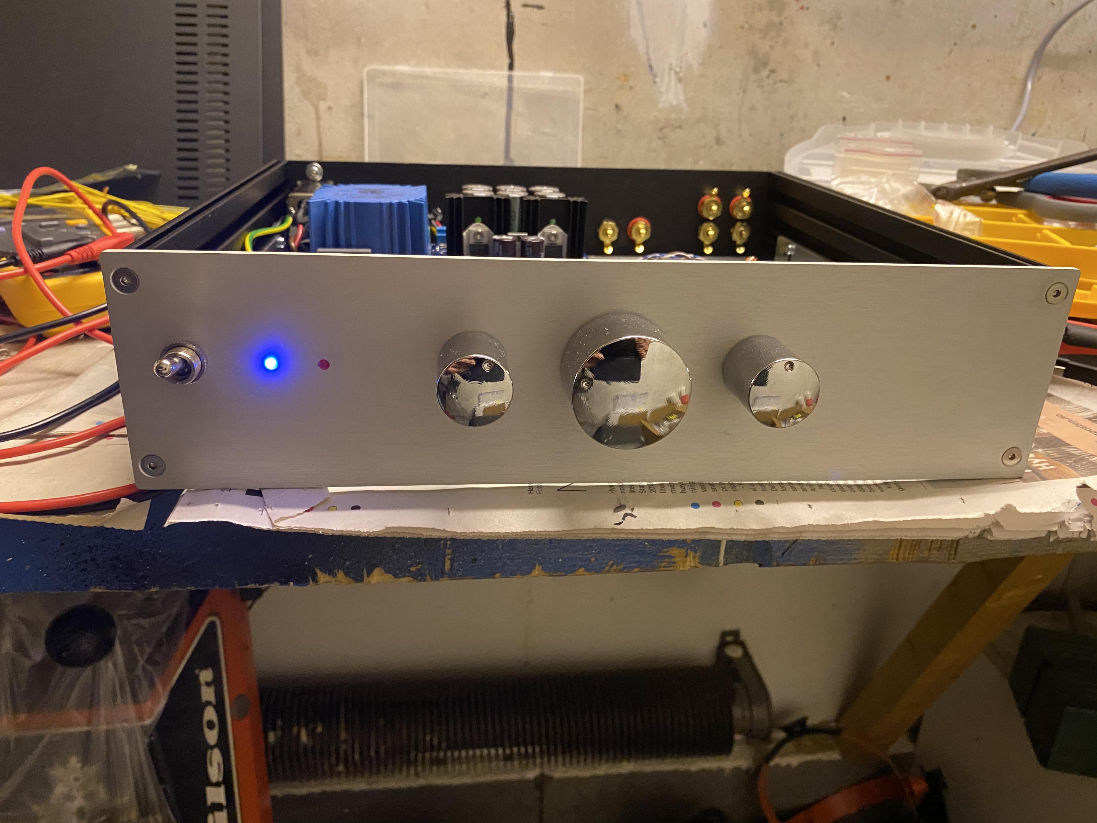

As said my latest work had been finishing the front and back panel. Also note the red and blue LED on the front. When I switch the rails off, the red light turns on for standby. When I switch them on, the red light turns off and the blue LED lights up. Pretty neat imho. Don’t quite like the look of colored LED lenses on the front, ideal would be LEDs that turn dark/colourless when off instead of native color. Looks kinda like an arcade machine, but who cares for now.

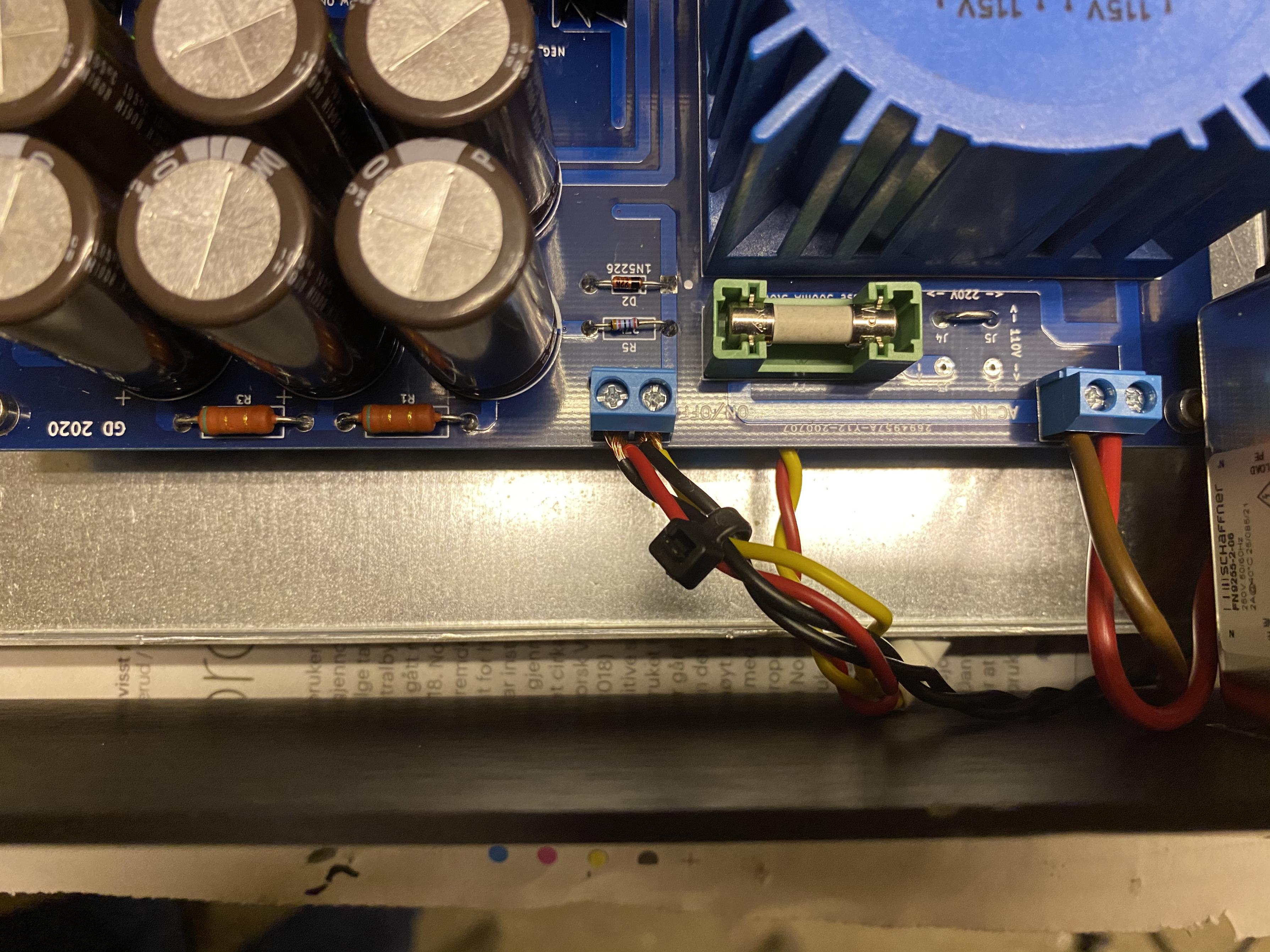

Note that the filtered AC inlet is connected straight to PSU without switch, and is fused after the transformer, with the jumper right after which I have chosen to connect a switch to mounted on the faceplate. I have an extra switch and an external fuse that I consider adding later, but for now this works quite smoothly.
Not entirely happy with the metal work, it was a mess, but think I managed to cover up most of the errors 😀

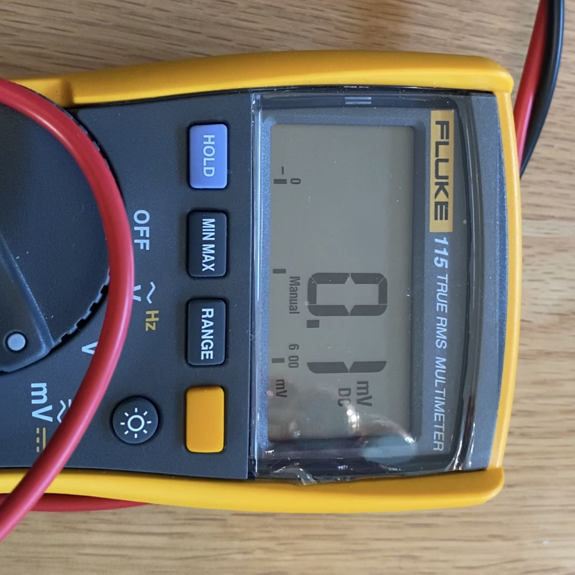

So, after some nervewrecking behaviour yesterday, hopefully caused by isoprop residue under the connection blocks, I woke up to a very, very stable one channel WLS today.
Offset at cold was 27mv, slowly and steadily declining to 2mv within 5 minutes, and then settling around 0,1-0,4mv after 20-30 minutes.

Btw, funny thing and an interesting ovservation: I knew high offset could cause hum. Well, it sure does. Yesterday I observed this as the offset went apeshit. Completely silent now. The residual noise is from my poweramp, which is quite low btw.
Still, will prolly put in some shielded wires and add a small cap and resistor on the ground loop breaker, and maybe add a gnd bus. We will see if it is needed or not.
I attached some pics showing the preliminary result and offset measurements (very stable).
Have a good weekend guys, thanks to all of you! A special thanks go out to 6L6, Wayne, Dirk, Dennis Mr. FAB Hui, David (Myleftear) and Russel. And to all good experiences read in this thread! Hope I did not forget anyone.
