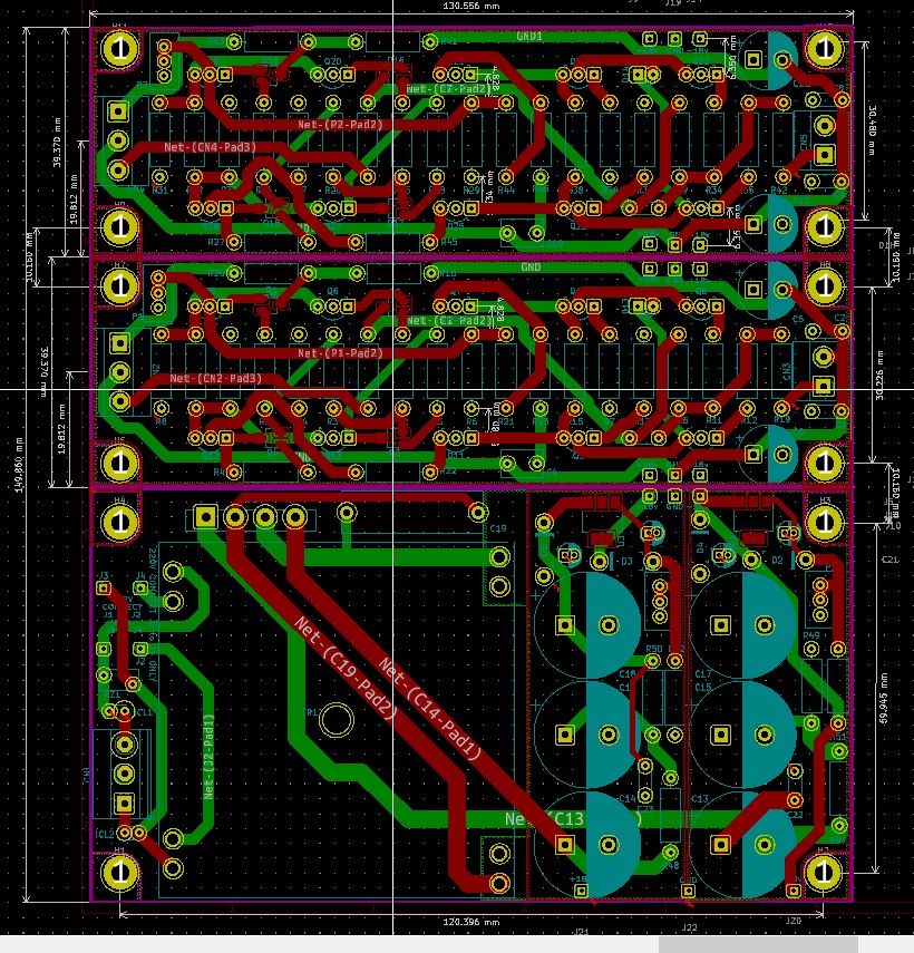

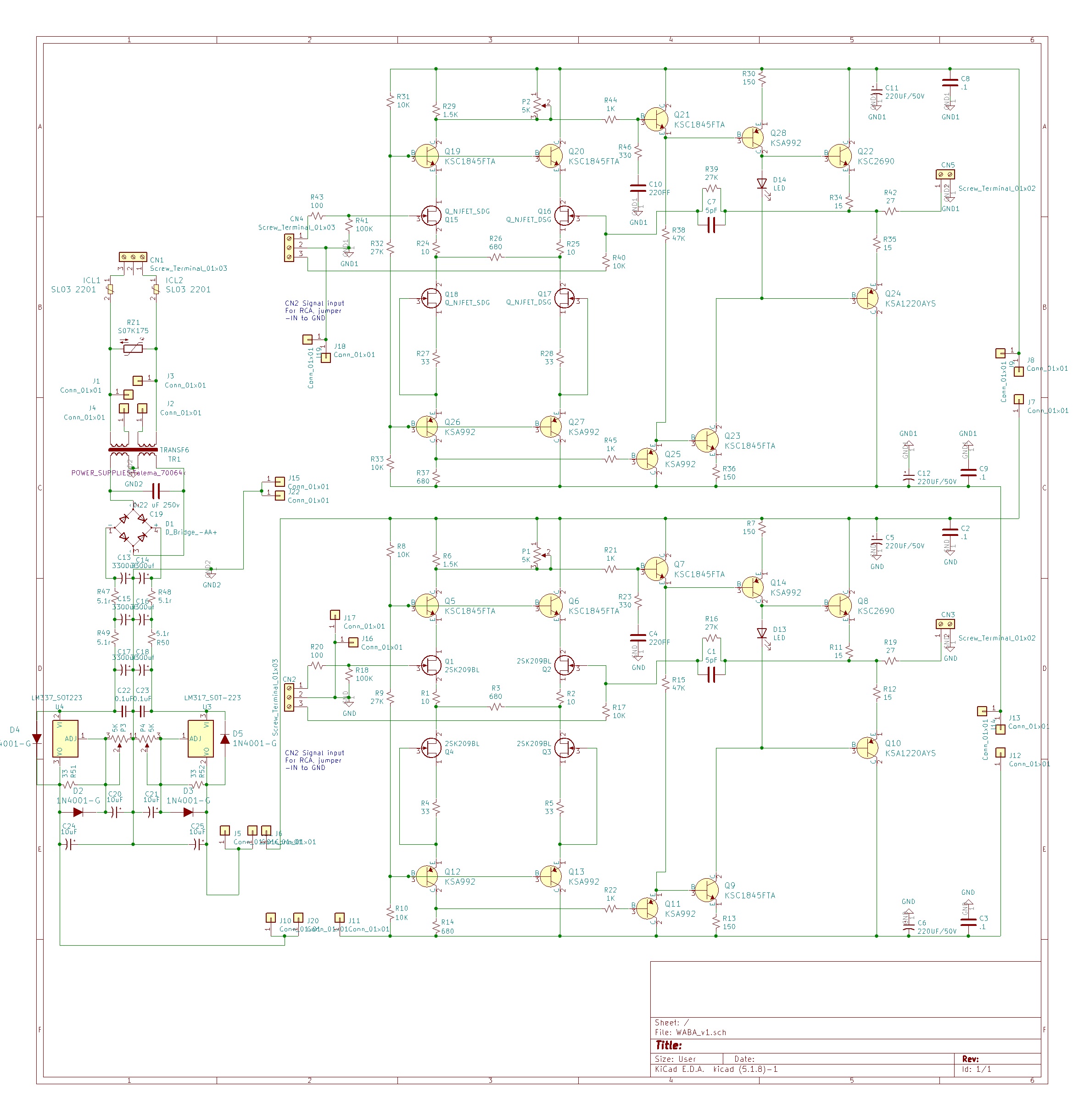

The last board I sent to the fab house was absolute garbage. Can someone please look over these to make sure I didn't mess anything up?

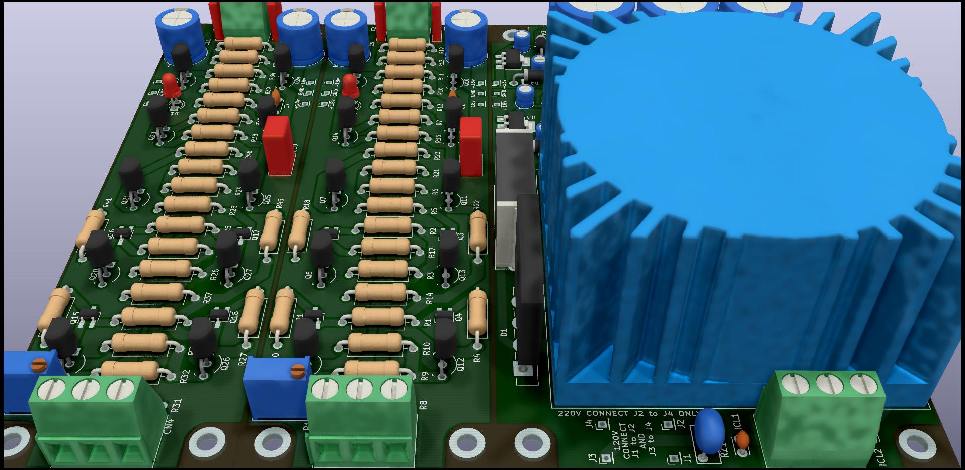

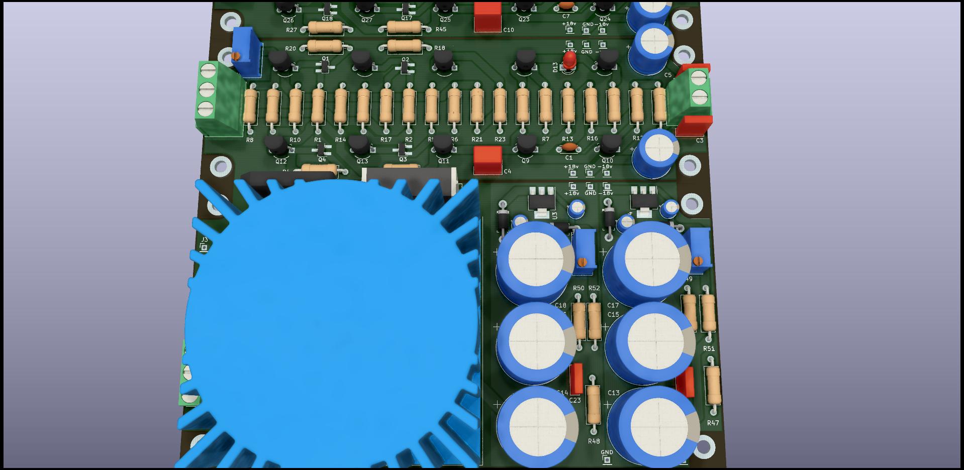

Wow, that's a crazy impressive board! Any problem having the transformer so close by or is it not so much of an issue at these levels?
I notice you use copper pour to fill in the empty space between tracks. Any pros or cons on doing this as a general practice?

I designed it in such a way that if I am getting noise from the transformer, I can just break it off at the V-cut and relocate the power supply.
I have no idea about the copper pours, top is +18v and bottom is -18v. After thinking about it, I just might have to go change it......
lay out like this?

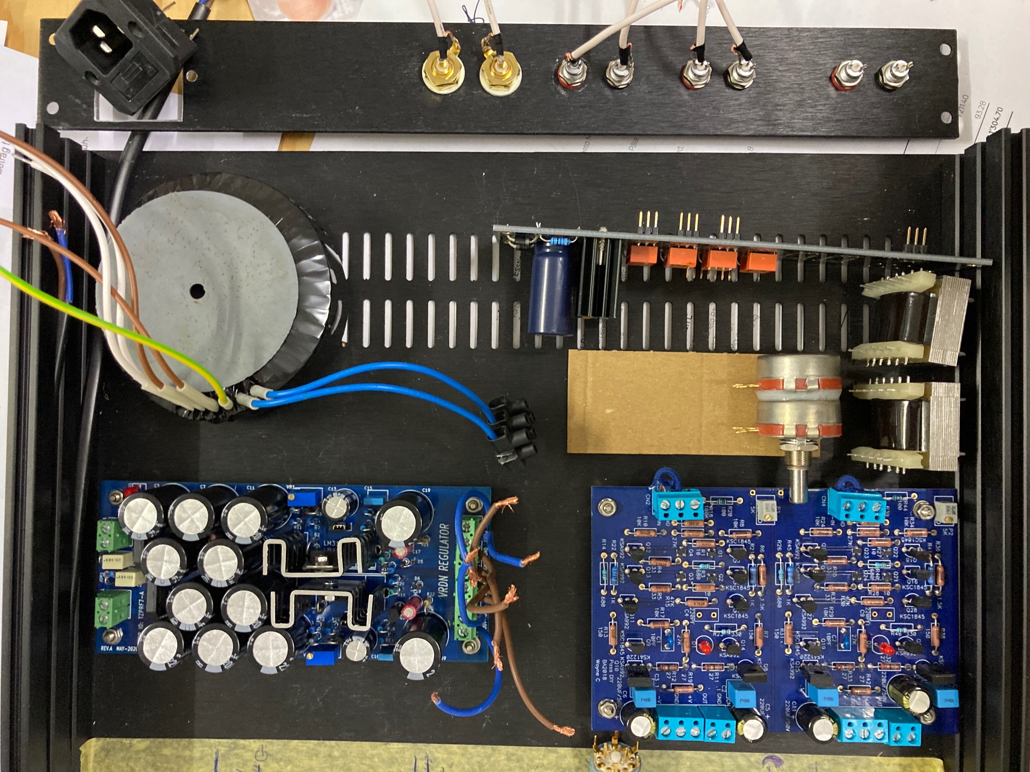

Hi friends
I'm in the midst of the build... Will have a BA-18 with a Toroid 18-18 50VA, VRDN-PSU, i-select, either a 20K Precision Electronic Pot or a Elma Relay-attenuator, and a pair of output-transformers for the oomph...
It will all end in a 1U chassis, so space is a bit scarce. The Capacitor on the i-select is just that tiny bit too high, so I'll mount it vertical...
Does anyone spot any flaws in this layout? (Don't think there are until now, but you see and know more than I...
Thank you!

„Not needing _smaller_ donut“?
Oh mighty zm, I hope you’re fine? [emoji83]
(I don‘t 100% recall the value of it, but it is a working one—has been confirmed many times already...)
It‘s the CineMag CMOQ-4HPC. I got them in a wave of absolute greed (and anxiousness the Linestage wouldn't be sufficient to drive F4. Which will not be the case I am convinced by now 😉 ). Just copied the work of william2001
