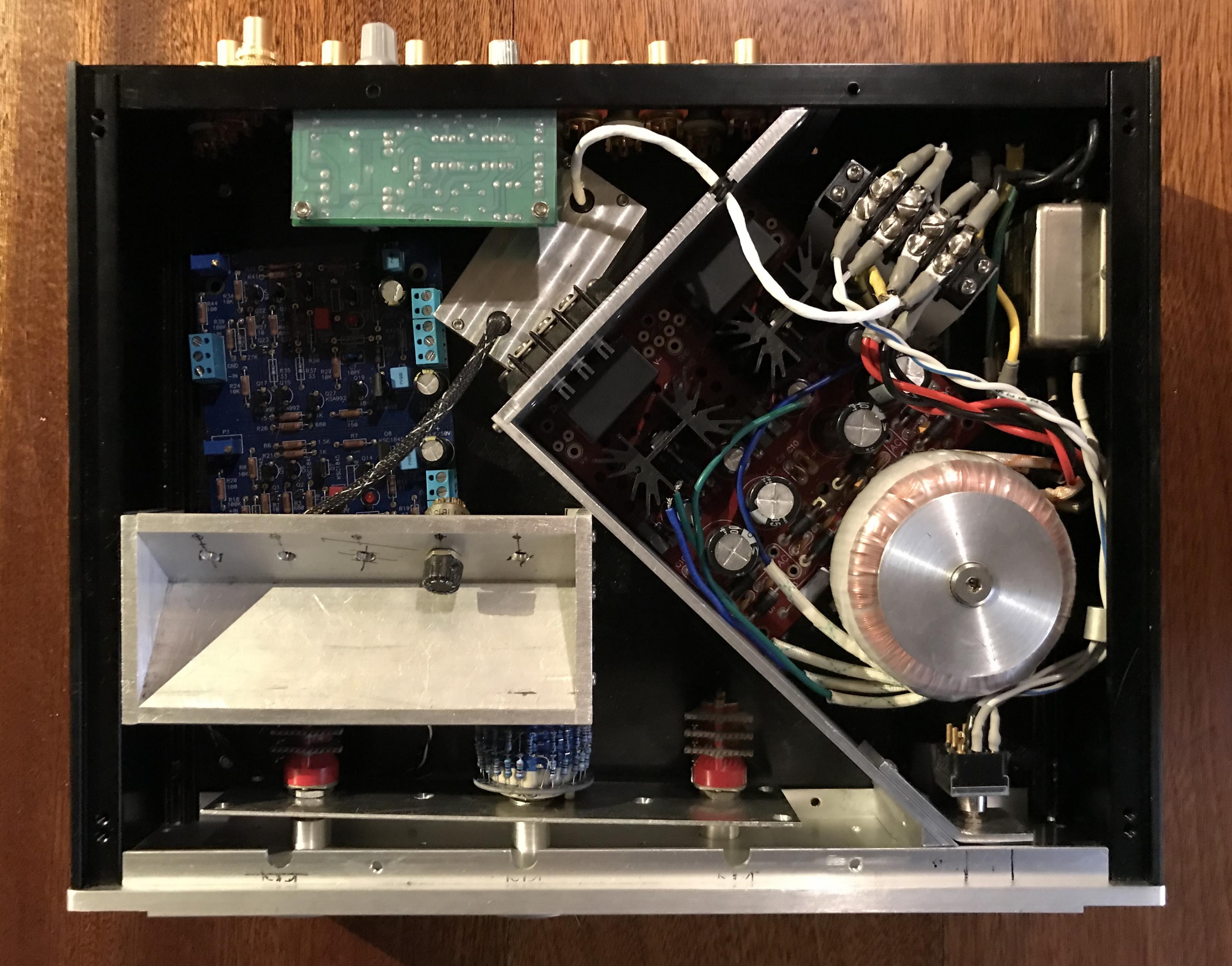

Hi All. Another build. Wanted to make it pretty compact. It's still pretty rough, and everything is floating inside right now.

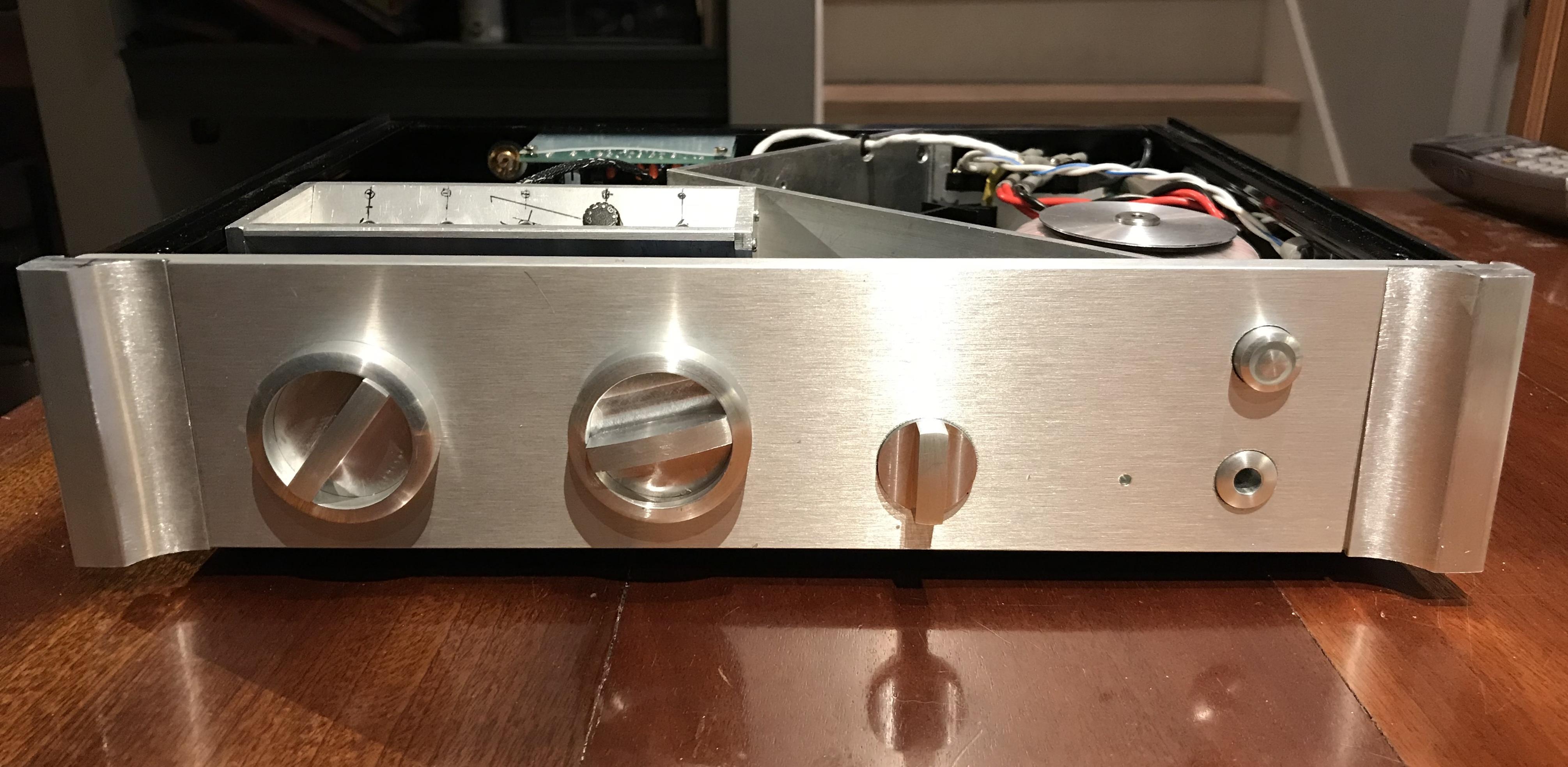

Stock case, but with some cosmetic modifications. Volume/selector knobs inspired by a Nagra tape recorder. Diagonal internal division in unconventional, but was best way to fit things in.
- Tubecad bipolar PS, 18v; Antek tranny
- 5v switching PS for colored LEDs that will be used for positions on the selector
- Trough-like thing on left will hold multi-position switches, used to tweak volume of inputs to match levels
- Crossover for sub, knobs on back
- Balance using another multi position switch; just for subtle tweaks
A couple questions on grounding. I have star safety ground that will be screwed into the base plate.
1) Do I connect the signal ground to the safety ground and if so, is there a best place to connect, or just run input and output grounds to the star? Connect to ground directly, or with a resistor, or a thermistor, or a diode/bridge? There are so many different ways of doing it and I can't make any sense out of the choices.
2) Regarding this anodized case, putting the ohmmeter on various points there's a lot of resistance from piece-to-piece. Not, I think , much of a shielded enclosure. Is there a best practice for tying them all together? Link panels together or star everything?
Any help appreciated.

Hello Monk55, are those Khozmo attenuators?
Indeed they are. A bit spendy but I like um so far. Figured what the heck...we’ll see how long they last. Go.
Did you get the one with remote control? From what I can see from the picture you have two attenuator did you set it up so you have a separate volume control per channel?
Are you running balance in and unbalance out?
Thanks!!
Thanks!!

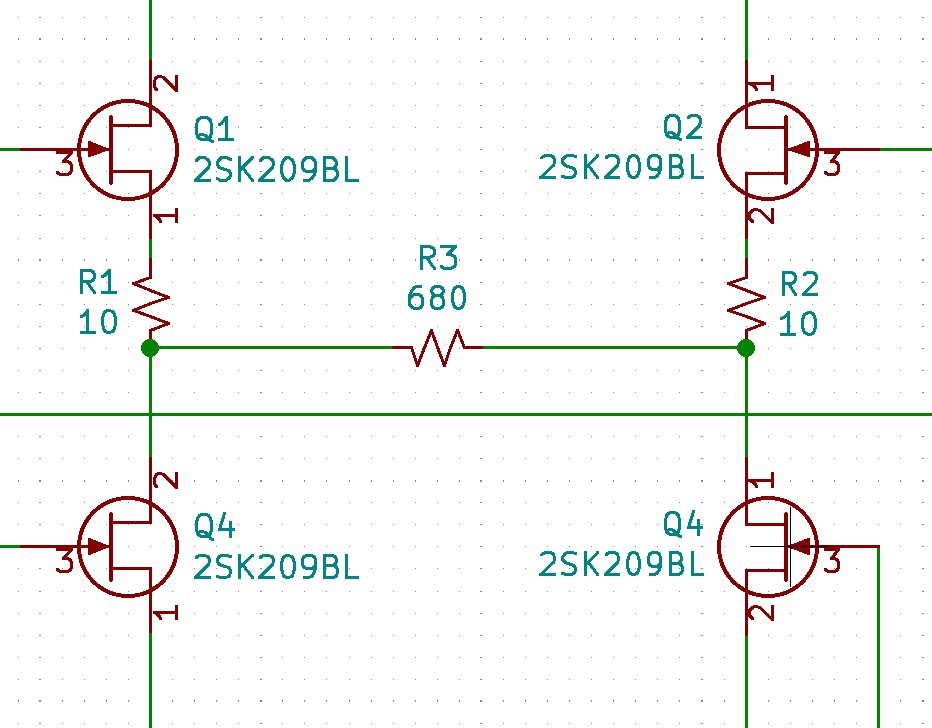

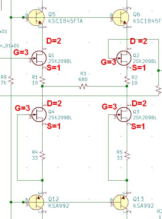

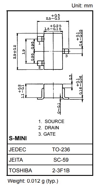

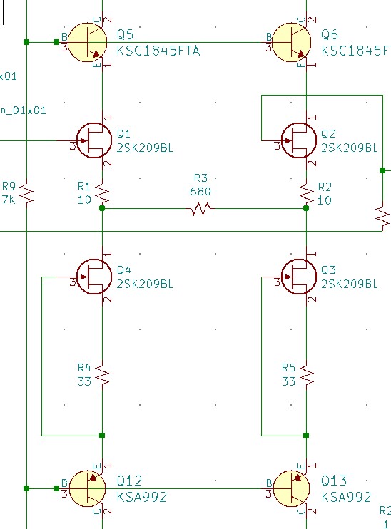

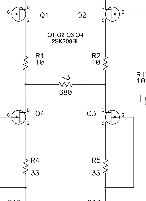

I designed my pcb all jacked up and doesn't work. Now that I found my mistakes and corrected them, I found some other stuff.... I want to make sure I have dotted all my i's before I get my 2nd batch made. My question is, which of these two are correct?
JFet symbol is not good, so we can't tell, especially not knowing whatdf 2 and 3 means
in any case, Drain goes up, Source goes down
