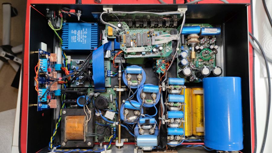

Looking good!
I think my next problem may be justifying to my better half why I need two or three preamps and three or four power amps!
Gary
Easy! Tell her just what I told my wife long time ago. "One for each genre!" Just kidding of course. They already know your addiction. No point in hiding it. Great build by the way. One of the best I have seen here!
… items in the wrong way around…
While I was admiring your build, I thought those diodes on your preamp-source-selector-board where looking in the wrong direction (according to the symbol on the board and what I'm used to see elsewhere)?
But hey, there's your name on those, you made them I guess?
Even more admiration!
Ha ha! Well spotted on the diodes.
If you look even closer on the 5V supply to that board you'll notice the red wire is connected to 0V and the white wire to +5V. I had a slight 'moment' when laying out that PCB and misread the data sheet for the relays and so ended up transposing the coil connections. Easily fixed though by turning the diodes around and reversing the 5volt supply connections, and much cheaper than getting a new set of boards fabricated. But it does still bug me that it's not right. It also meant a little logic change in the microcontroller monitoring the input selection.

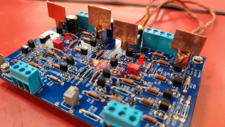

Hi all,
after finishing my F3 I wanted to gear up the frontend as well.
After challenging the SMD-stuff (SMD? There's a reason I normally prefer tubes ...) the rest was easy going.

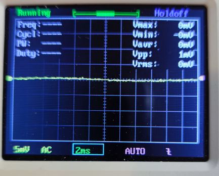

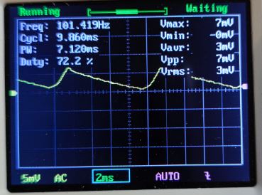

My modular pre-amp (WIP since 1997) lost his tube line-stage and the BA2018 went in. PSU +/- 18V with active hum-compensation. See pictures of scope before/after below. Added some copper on the outputs, even if not necessary.
Measures very good, THD 0,007% 1,41V Output 10-30kHz. The pre has a high accuracy relay volume control and a tube-filter (on the right upper corner in the capacitor-box 😀) as well as a passive source selector.
Sound is very relaxed and detailed with deep soundstage, first time almost no difference with or without tube-filter. Like it!

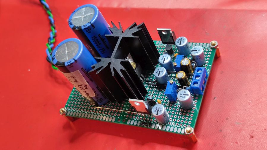

Perhaps wrong translation, and as this is not my idea, just let me post the link to the article my PSU is based on:
Spannungsregelung, elektronischer Brummsiebung (Komplementär-Darlington, low-noise)
Have built it for my MC and MM RIAA-stages with very good results before.
