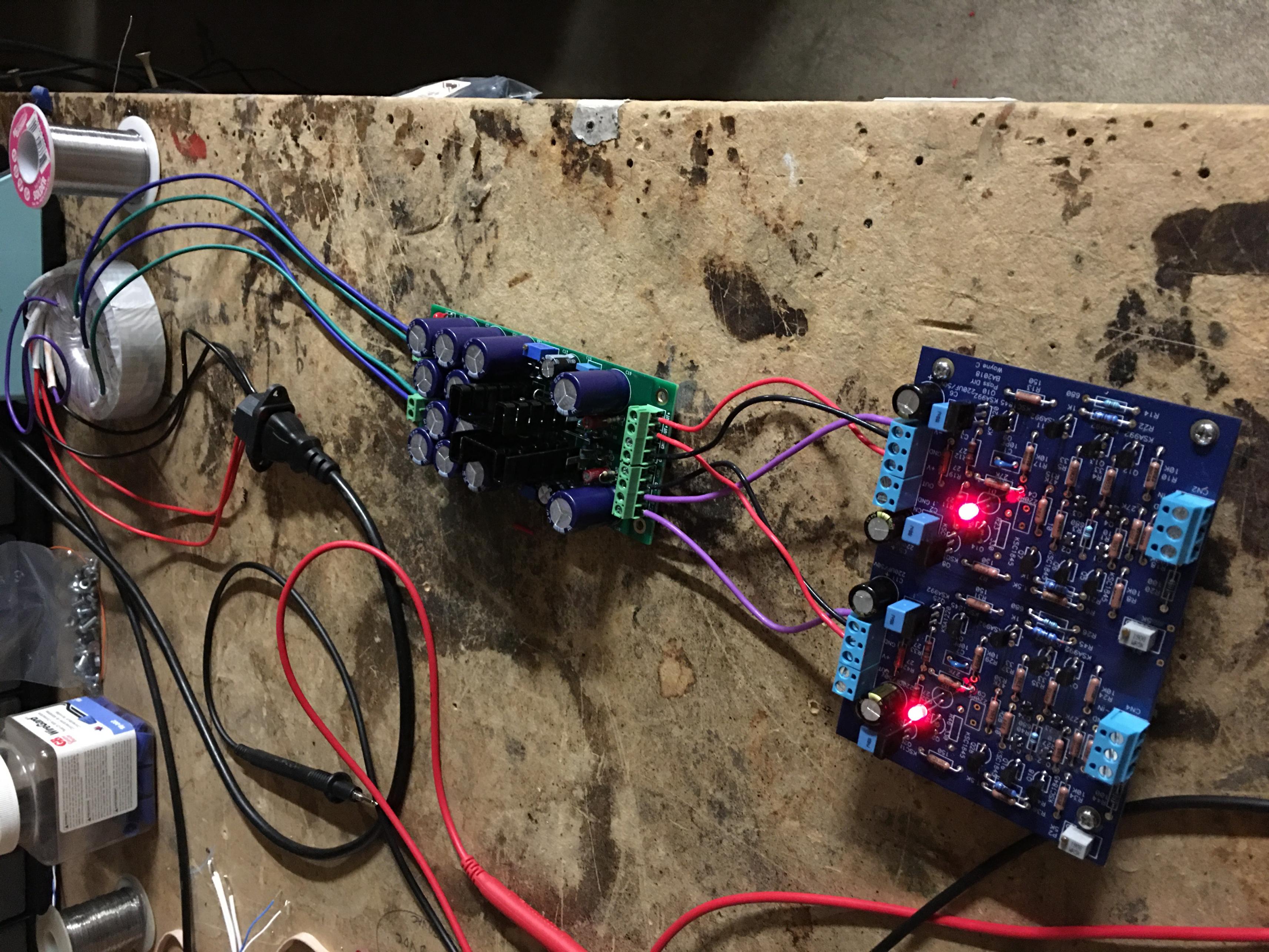

Had a little time off for the holidays and managed some progress.
Nice layout Flame
Yea Greg! Looking great.
Hello,
I just finished building the preamp (standard version, not high current) using a Salas UltraBiB supply. I would like to check to see that I have enough current for each channel. The UBiB guide says to leave at least 50 mA current over the peak current demand. I only had 5 ohm resistors on hand for the UBiB current limiter, which gives a total of 118 mA per channel. Minus the at-least-50 mA for regulation, that leaves 68 mA per channel for peak current needs of the WBA boards. I thought I read that the boards only use 25 mA per channel, but there was some other figures thrown about as well. Is 68 mA per channel for the board sufficient?
Also, the preamp measures better than any other DIY or commercial preamp I've looked at using a very simplistic RMAA setup. The noise floor is at -107.5 dB, cross talk is at -94 dB, distortion is very low and the spectra looks great. I was originally thinking of putting in an extra UBiB for a dual mono power supply, but I am already using a largely over-specified transformer because it is what was on-hand. Would there be any advantage of a dual mono power supply if I already am using too much transformer for the job?
Thanks,
Alan

Has anyone built this preamp using the Super Regulator?
Any advice on where best to connect the sense leads?
I power Waynes line stage with Belleson Super Regulators...
VS lm317/lm337 regulation...I couldn't say if it is overkill or not...
I have tended to not like anything powered by switching power supplies.
They are connected to the regular inlet...I kept the connection leads very short. I asked Belleson about sense leads and they said a sense lead would not make much difference to the regulation. In fact, I don't think there is provision for a sense lead on a Belleson Regulator. Belleson has a theory on whether or not to have sense leads...and I don't remember what it was.
I built a number of DIY superregs...I connected the sense lead to the device at the power inlet of the device.
I have been using Belleson because they are easy to use, fit on a circuit board where an LM317/LM337 would go and they are pretty good regulation. Not much more expensive than the muss and fuss of building the superregulator board.
I can't express an opinion on how they sound vs no regulation, or lesser regulators...I just use them as a matter of principle. That good DC is important to audio.
Agreed about the necessity of good regulation.
My current thinking on the layout has regulator to circuit leads of ~1.5" or so.
With the Jung-Didden design the sense lines are evidently integral and essential.
