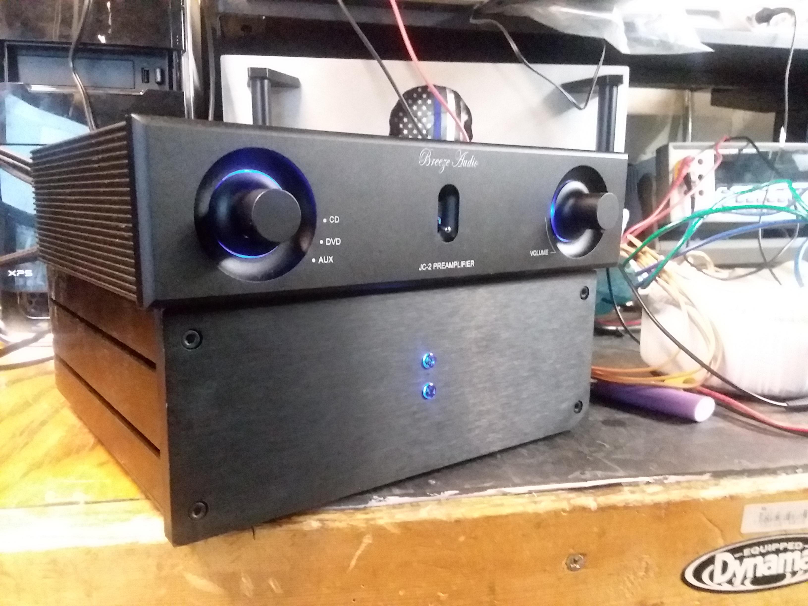

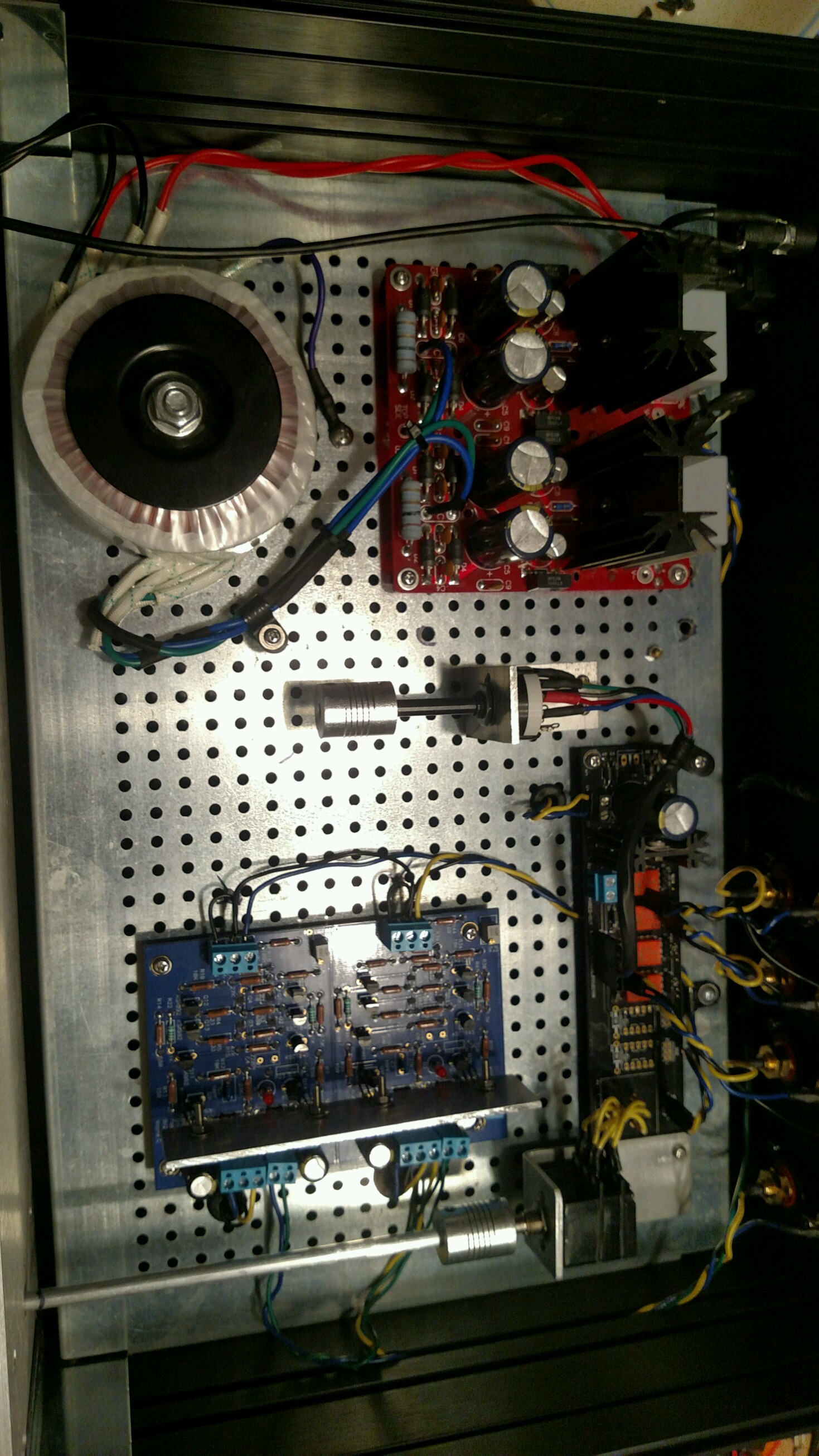

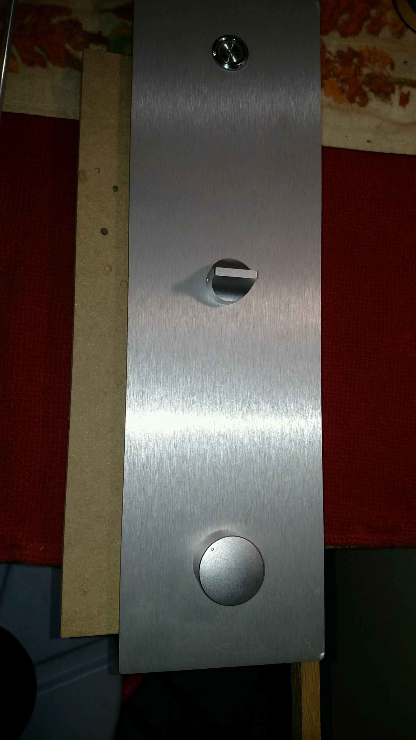

Put the covers on the build today... Don't care much for the face plate, I guess I need to have them re-anodized, but it probably won't happen. I'm very pleased with the sound driving an MX2 with Pass original design.
The switch on the front is a dummy the supply is below with two VRDNs driving a full mono design, and 2 umbilicals delivering 18v +- t
Back to the Badger build now... 🙂
MEK should soften the silkscreen paint to the point it will wipe off. Test first on inconspicuous part to see if the anodizing is effected.
Thanks guys... I might have some MEK... nasty stuff that.. gloves and well vented for anyone using this stuff. Just a safety FYI for those thinking of trying this stuff kills livers and causes cancer.
JT,
Have you tried the black marker trick? Sometimes the results are pretty good and you can't make out the handiwork from a distance. 🙂
The sharpie thing leaves the color off, I use it for small scratches and stuff, but don't really want it on the face, but thanks for the input. 🙂
