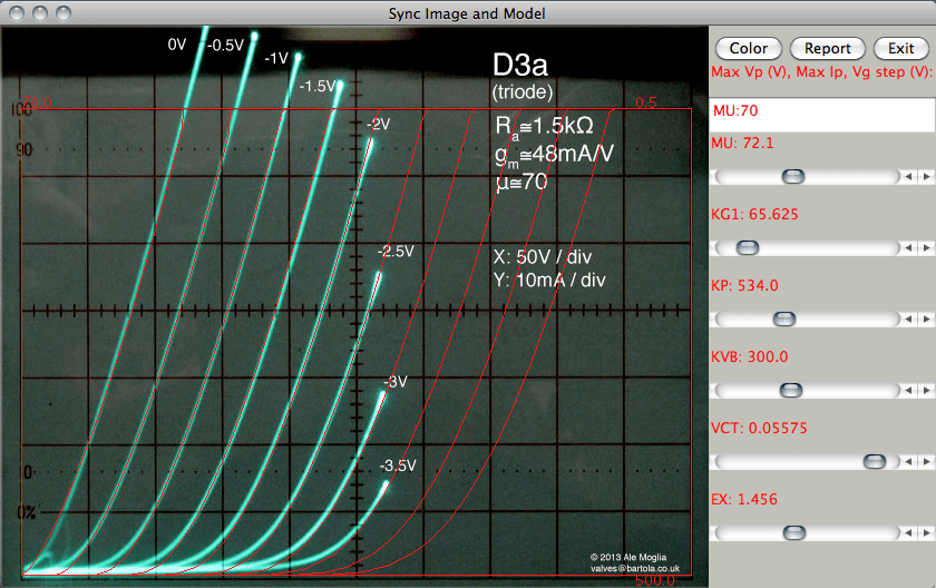

Triode-Connected
Code:
* Generic triode model: D3A_PT_AN
* Copyright 2003--2008 by Ayumi Nakabayashi, All rights reserved.
* Version 3.10, Generated on Tue Dec 24 08:47:57 2013
* Plate
* | Grid
* | | Cathode
.SUBCKT D3A_PT_AN A G K
BGG GG 0 V=V(G,K)+0.38087015
BM1 M1 0 V=(0.0021582473*(URAMP(V(A,K))+1e-10))**-0.28773641
BM2 M2 0 V=(0.83904987*(URAMP(V(GG)+URAMP(V(A,K))/74.574462)+1e-10))**1.7877364
BP P 0 V=0.03039942*(URAMP(V(GG)+URAMP(V(A,K))/88.879654)+1e-10)**1.5
BIK IK 0 V=U(V(GG))*V(P)+(1-U(V(GG)))*0.018902992*V(M1)*V(M2)
BIG IG 0 V=0.01519971*URAMP(V(G,K))**1.5*(URAMP(V(G,K))/(URAMP(V(A,K))+URAMP(V(G,K)))*1.2+0.4)
BIAK A K I=URAMP(V(IK,IG)-URAMP(V(IK,IG)-(0.015714194*URAMP(V(A,K))**1.5)))+1e-10*V(A,K)
BIGK G K I=V(IG)
* CAPS
CGA G A 2.7p
CGK G K 7.3p
CAK A K 3.1p
.ENDS
I'll throw my triode connected model into the ring. Made using Curve Captor from Siemens data sheet.
Code:
* D3a triode connected pentode LTspice model
* Modified Koren model (8 parameters): mean fit error 0.499405mA
* Traced by Wayne Clay on 6/24/2015 using Engauge Digitizer and
* Curve Captor v0.9.1 from Siemens datasheet.
.subckt D3a-t P G K
Bp P K I=(0.2505628718m)*uramp(V(P,K)*ln(1.0+(-0.1791266922)+exp((4.510443556)+(4.510443556)*((84.18566045)+(-3454.657477m)*V(G,K))*V(G,K)/sqrt((29.60063818)**2+(V(P,K)-(-4.621358765))**2)))/(4.510443556))**(1.176920934)
* Capacitances: G2+P, G3+K
Cgk G K 8.3p ; 1.0p added (7.3p)
Cpk P K 4.1p ; 1.0p added (3.1p)
Cgp G P 2.9p ; 0.2p added (2.7p)
Rpk P K 1G ; to avoid floating nodes
d3 G K dx1
.model dx1 d(is=1n rs=2k cjo=1pf N=1.5 tt=1n)
.ends D3a-t

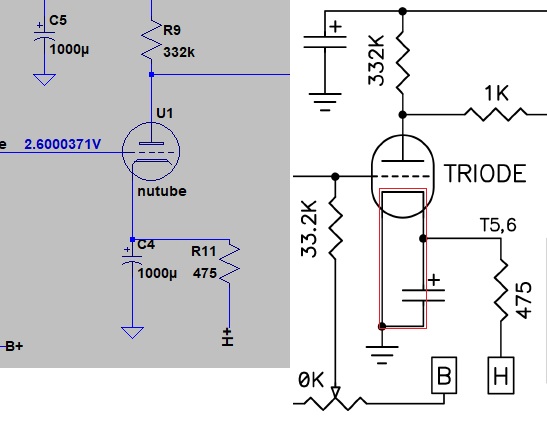

Anybody know how I can make this connection marked in red in LTSpice?
That was a section of the Nelson Pass B1 Korg Pre/buffer schematic.
B1 with Korg Triode
So the spice screenshot is ok?
Thanks!
B1 with Korg Triode
Thanks!
