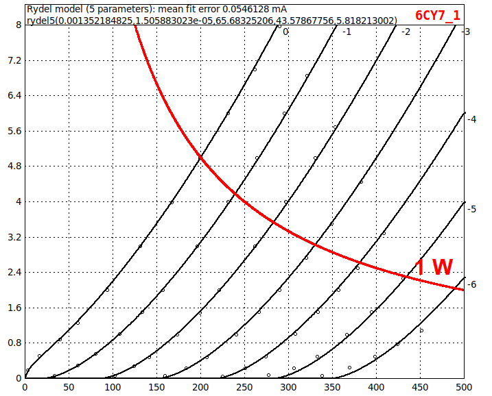

Here you go... 😉I cannot find a spice model for 6CY7 tube, maybe someone here have it......all the best
Section 1 Rydel model:
Code:
* 6CY7_1 LTSpice model (section 1)
* Rydel model (5 parameters): mean fit error 0.0546128mA
* Traced by Wayne Clay on 02/19/2019 using Engauge Digitizer 10.4
* and Curve Captor v0.9.1 from General Electric data sheet
.subckt 6CY7_1 P G K
Bp P K I=
+ ((0.001352184825m)+(1.505883023e-05m)*V(G,K))*uramp((65.68325206)*
+ V(G,K)+V(P,K)+(43.57867756))**1.5 * V(P,K)/(V(P,K)+(5.818213002))
Cgp G P 2.5p ; 0.7p added (1.8p)
Cgk G K 2.2p ; 0.7p added (1.5p)
Cpk P K 0.5p ; 0.2p added (0.3p)
Rpk P K 1G ; to avoid floating nodes
d3 G K dx1
.model dx1 d(is=1n rs=2k cjo=1pf N=1.5 tt=1n)
.ends 6CY7_1

* 6CY7_2 LTSpice model (section 2)
* Modified Koren model (8 parameters): mean fit error 0.918378mA
.subckt 6CY7_2 P G K
Bp P K I=
+ (0.2452863892m)*uramp(V(P,K)*ln(1.0+(-0.1764710313)+exp((4.52352785)+
+ (4.52352785)*((7.111931873)+(2.926804722m)*V(G,K))*V(G,K)/sqrt((1.767549921e-05)**2+
+ (V(P,K)-(-22.14179645))**2)))/(4.52352785))**(1.417654512)
Cgp G P 4.6p ; 0.2p added (4.4p)
Cgk G K 5.7p ; 0.7p added (5.0p)
Cpk P K 1.2p ; 0.2p added (1.0p)
d3 G K dx1
.model (section 2) dx1 d(is=1n rs=2k cjo=1pf N=1.5 tt=1n)
.ends 6CY7_2

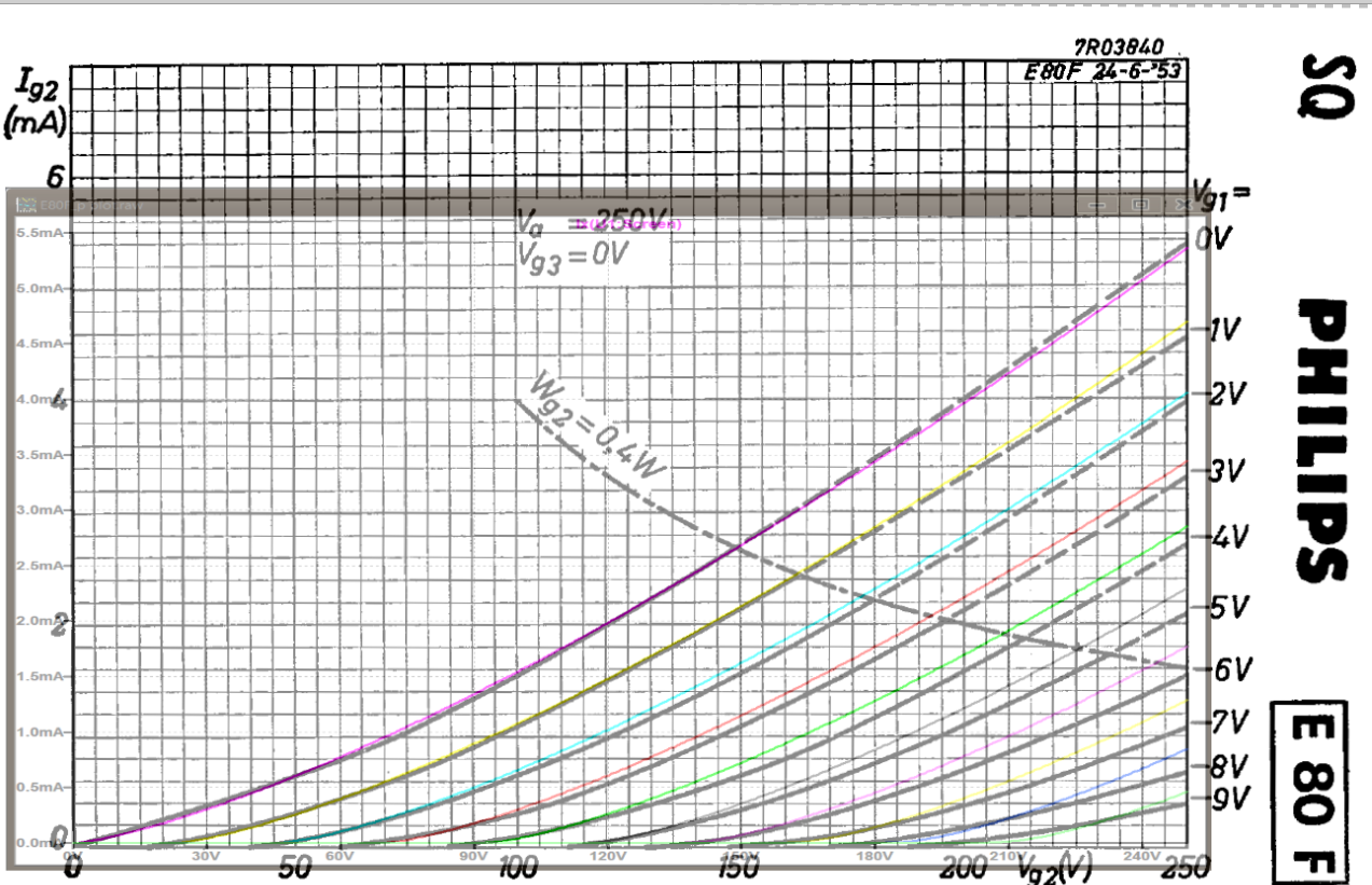

Here is my adjusted e80f_p model with the aid of g2 curve, the screen current is now better fitted than the previous model.
Code:

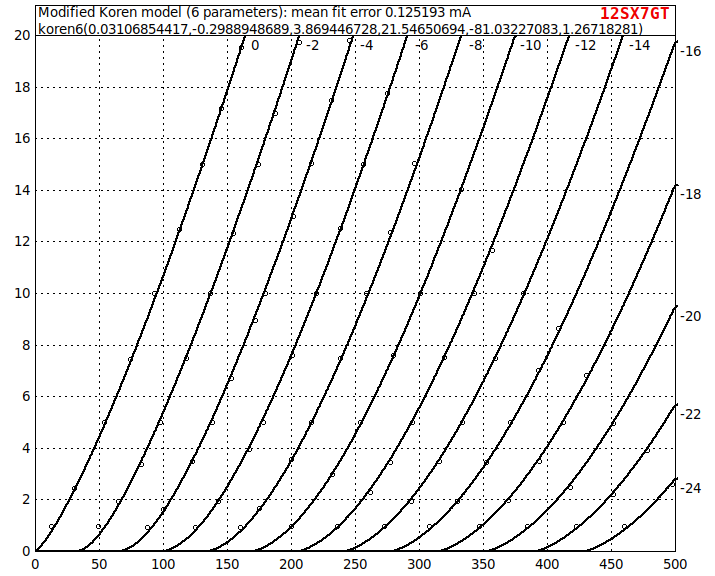

I see jazbo8 beat me to it. Here's a 12SX7GT model I made using Curve Captor awhile back.
Code:
* 12SX7GT LTSpice model
* Modified Koren model (6 parameters): mean fit error 0.125193mA
* Traced by Wayne Clay on 09/22/2018 using WebPlotDigitizer
* and Curve Captor v0.9.1 from Tung-Sol data sheet
.subckt 12SX7GT P G K
Bp P K I=
+ (0.03106854417m)*uramp(V(P,K)*ln(1.0+(-0.2988948689)+exp((3.869446728)+(3.869446728)*
+ ((21.54650694)+(-81.03227083m)*V(G,K))*V(G,K)/V(P,K)))/(3.869446728))**(1.26718281)
Cgp G P 4.1p ; 0.5p added (3.6p)
Cgk G K 3.2p ; 0.2p added (3.0p)
Cpk P K 1.7p ; 0.5p added (1.2p)
d3 G K dx1
.ends 12SX7GT

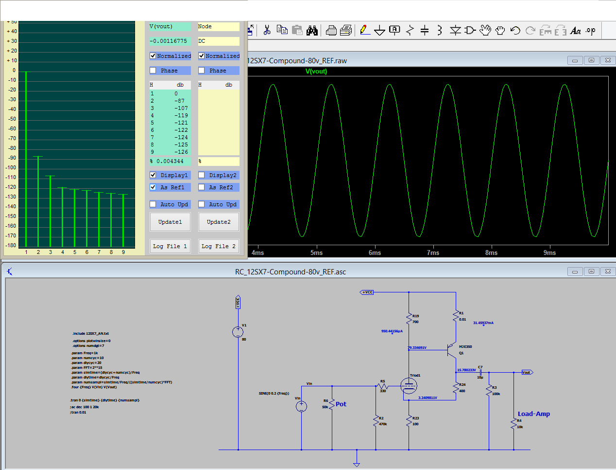

Hello !
Thanks for your help ! sorry for my approximative vocabulary
I'm a beginner, I'm trying to build a low voltage line preamp, the original schematic is from JR Broskie (Tubecad),
Pictures attached :
Jazbo model green curves : R on plate : 600 ohms
Cogsncogs model yellow curves : R on plate : 700 ohms
the results are very near with this only small modification
I'm happy with results !
Richard
