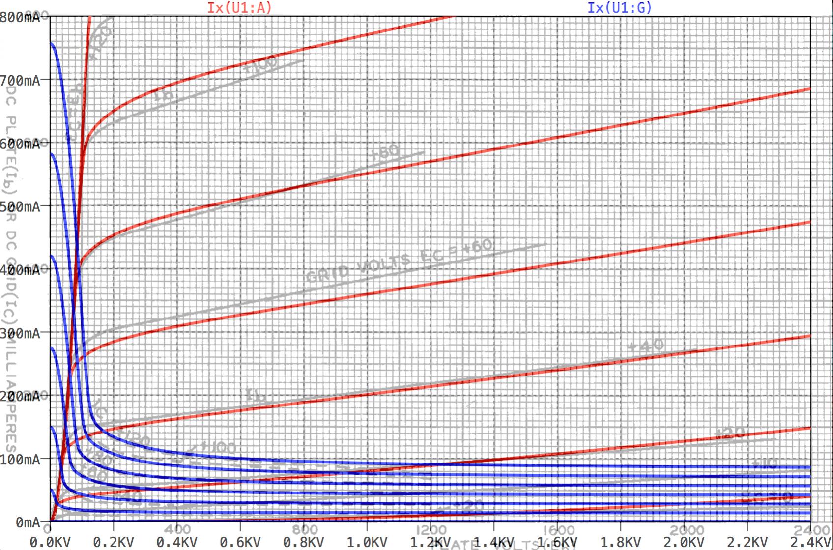

Hello Artemka

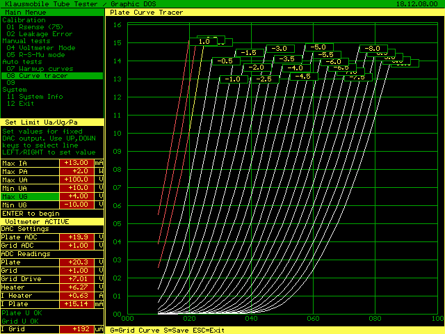

I have now found a slot to fit my generic triode model to the 811A RCA data sheet.😀
But to finish/complete the model, some further information would be helpful, because the data sheet has no traces for negative Vg...😕
If you have a 811A sample available, would you please be so kind and measure
1) if possible the heaters resistance (when cold)
2) if possible also the heaters steady state current at 6.3V
3) if possible the anode current with grounded grid at Va= 50V and 100V
That would be perfect 😉
Thanks in advance, Adrian

Hi Artemka
There seems no further information available in the web about the 811A's behavior at neg. Vg.
So, I finished my model with a hint to the unknown accuracy for neg. Vg. 😉
As my spice code is a bit larger than common triode model code, it would be an overkill to insert it in this forum. You will find my model on my website:
http://adrianimmler.simplesite.com/440956786
all the best, Adrian

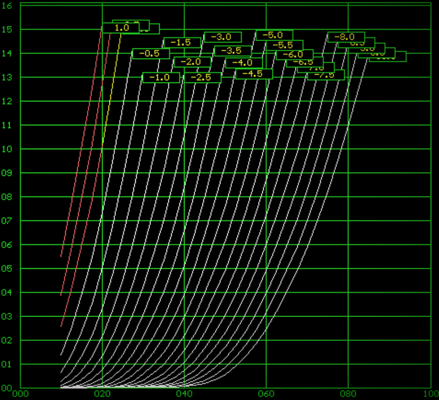

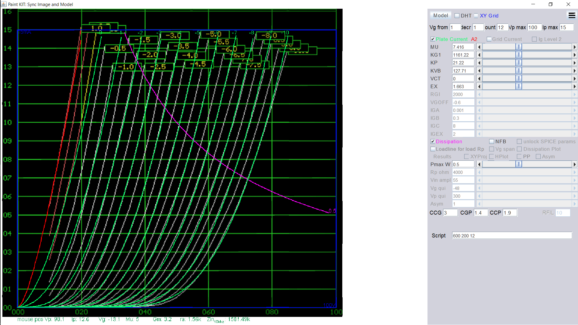

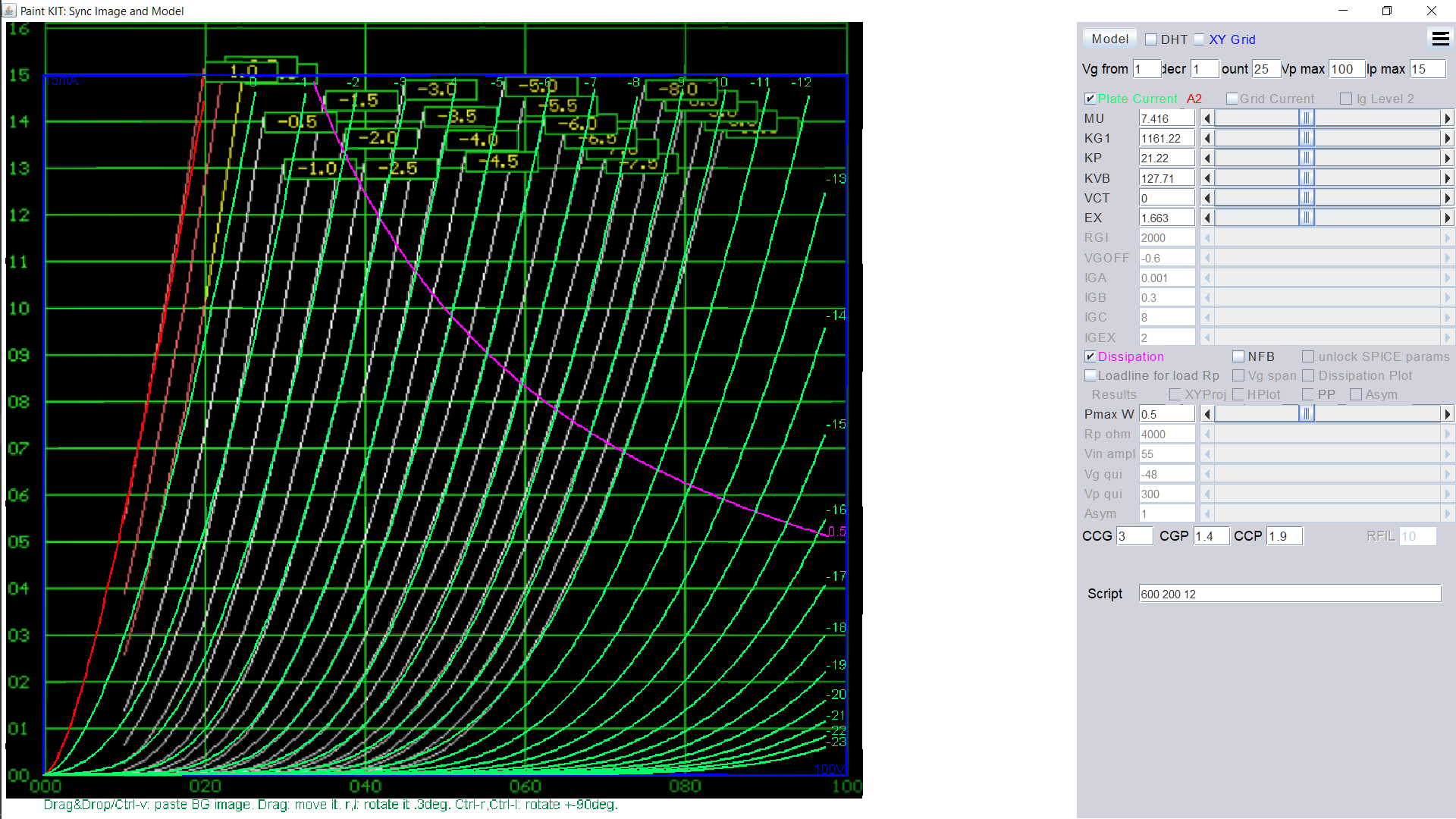

This model is based on solely on the data published on Tube Tester Files - EL82, EL84, EL86 Soviet Clones, maybe there are some differences. 0.5w dissipation is for relative reference the actual is about same as el84(?).
Code:
**** 6P43P_LOW ******************************************
* Created on 03/28/2019 11:53 using paint_kit.jar 3.1
* [URL="http://www.dmitrynizh.com/tubeparams_image.htm"]Model Paint Tools: Trace Tube Parameters over Plate Curves, Interactively[/URL]
* Plate Curves image file: 6p43p_low.png
* Data source link:
.SUBCKT 6P43P_LOW 1 2 3 ; Plate Grid Cathode
+ PARAMS: CCG=3P CGP=1.4P CCP=1.9P RGI=2000
+ MU=7.416 KG1=1161.22 KP=21.22 KVB=127.71 VCT=0 EX=1.663
* Vp_MAX=100 Ip_MAX=15 Vg_step=1 Vg_start=1 Vg_count=12
* Rp=4000 Vg_ac=55 P_max=0.5 Vg_qui=-48 Vp_qui=300
* X_MIN=46 Y_MIN=57 X_SIZE=847 Y_SIZE=738 FSZ_X=1550 FSZ_Y=878 XYGrid=false
* showLoadLine=n showIp=y isDHT=n isPP=n isAsymPP=n showDissipLimit=y
* showIg1=n gridLevel2=n isInputSnapped=n
* XYProjections=n harmonicPlot=n dissipPlot=n
E1 7 0 VALUE={V(1,3)/KP*LOG(1+EXP(KP*(1/MU+(VCT+V(2,3))/SQRT(KVB+V(1,3)*V(1,3)))))}
RE1 7 0 1G ; TO AVOID FLOATING NODES
G1 1 3 VALUE={(PWR(V(7),EX)+PWRS(V(7),EX))/KG1}
RCP 1 3 1G ; TO AVOID FLOATING NODES
C1 2 3 {CCG} ; CATHODE-GRID
C2 2 1 {CGP} ; GRID=PLATE
C3 1 3 {CCP} ; CATHODE-PLATE
D3 5 3 DX ; POSITIVE GRID CURRENT
R1 2 5 {RGI} ; POSITIVE GRID CURRENT
.MODEL DX D(IS=1N RS=1 CJO=10PF TT=1N)
.ENDS

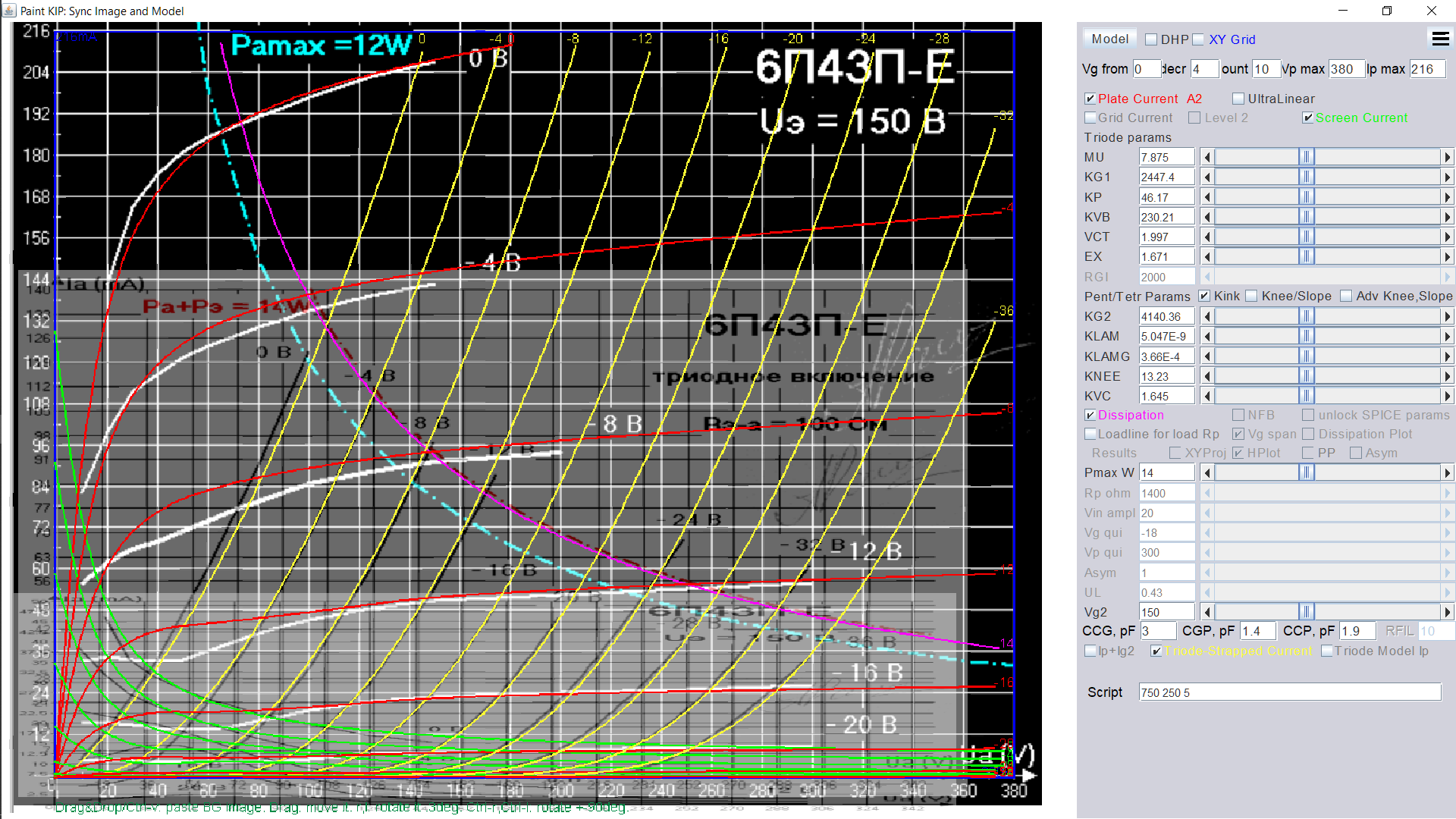

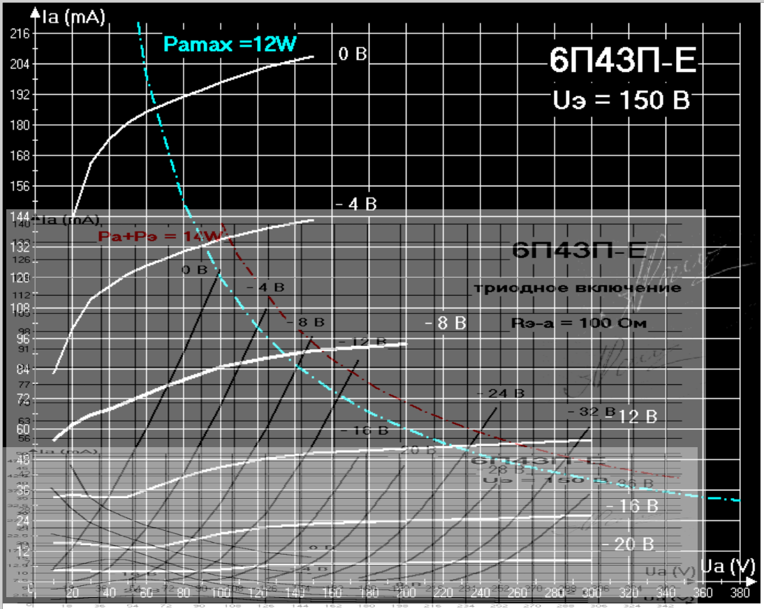

The following 6p43p model has the Pentode, screen and triode curve combined, you can plot the triode curve using the lower scale of interest to see how it compared with the tester plot. Data source: http://tec.org.ru/_bd/17/1764_643-.pdf
Code:
**** 6P43P ******************************************
* Created on 03/28/2019 16:15 using paint_kip.jar
* [url=http://www.dmitrynizh.com/tubeparams_image.htm]Model Paint Tools: Trace Tube Parameters over Plate Curves, Interactively[/url]
* Plate Curves image file: 6p43p.png
* Data source link: <plate curves URL>
.SUBCKT 6P43P P G2 G K ; LTSpice tetrode.asy pinout
* .SUBCKT 6P43P P G K G2 ; Koren Pentode Pspice pinout
+ PARAMS: MU=7.875 KG1=2447.4 KP=46.17 KVB=230.21 VCT=1.997 EX=1.671 KG2=4140.36 KNEE=13.23 KVC=1.645
+ KLAM=5.047E-9 KLAMG=3.66E-4 KNK=-0.044 KNG=0.006 KNPL=50 KNSL=11 KNPR=120 KNSR=29
+ CCG=1.3P CGP=0.7P CCP=9P RGI=2000.0
* Vp_MAX=380 Ip_MAX=216 Vg_step=4 Vg_start=0 Vg_count=10
* X_MIN=58 Y_MIN=11 X_SIZE=1012 Y_SIZE=787 FSZ_X=1550 FSZ_Y=878 XYGrid=false
* Rp=1400 Vg_ac=20 P_max=14 Vg_qui=-18 Vp_qui=300
* showLoadLine=n showIp=y isDHP=n isPP=n isAsymPP=n isUL=n showDissipLimit=y
* showIg1=n isInputSnapped=y addLocalNFB=n
* XYProjections=n harmonicPlot=y dissipPlot=n
* UL=0.43 EG2=150 gridLevel2=n addKink=y isTanhKnee=n advSigmoid=n
RE1 7 0 1G ; DUMMY SO NODE 7 HAS 2 CONNECTIONS
E1 7 0 VALUE= ; E1 BREAKS UP LONG EQUATION FOR G1.
+{V(G2,K)/KP*LOG(1+EXP((1/MU+(VCT+V(G,K))/SQRT(KVB+V(G2,K)*V(G2,K)))*KP))}
RE2 6 0 1G ; DUMMY SO NODE 6 HAS 2 CONNECTIONS
E2 6 0 VALUE={(PWR(V(7),EX)+PWRS(V(7),EX))} ; Kg1 times KIT current
RE21 21 0 1
E21 21 0 VALUE={V(6)/KG1*ATAN(V(P,K)/KNEE)} ; Ip with knee but no slope and no kink
RE22 22 0 1 ; E22: kink curr deviation for plate
E22 22 0 VALUE={V(21)*LIMIT(KNK-V(G,K)*KNG,0,0.3)*(-ATAN((V(P,K)-KNPL)/KNSL)+ATAN((V(P,K)-KNPR)/KNSR))}
G1 P K VALUE={V(21)*(1+KLAMG*V(P,K))+KLAM*V(P,K) + V(22)}
* Alexander Gurskii screen current, see audioXpress 2/2011, with slope and kink added
RE43 43 K 1G ; Dummy
E43 43 G2 VALUE={0} ; Dummy
G2 43 K VALUE={V(6)/KG2*(KVC-ATAN(V(P,K)/KNEE))/(1+KLAMG*V(P,K))-V(22)}
RCP P K 1G ; FOR CONVERGENCE
C1 K G {CCG} ; CATHODE-GRID 1
C2 G P {CGP} ; GRID 1-PLATE
C3 K P {CCP} ; CATHODE-PLATE
R1 G 5 {RGI} ; FOR GRID CURRENT
D3 5 K DX ; FOR GRID CURRENT }
.ENDS

Dear Adrian, thanks for the good model with excellent comments!So, I finished my model with a hint to the unknown accuracy for neg. Vg. 😉
However during the model import to ADS I get such warnings:
WARNING: Skipping unsupported statement ".params", line #17.WARNING: Appended "_n" to node v due to a conflict with a reserved word.
Element name = is changed to x
WARNING: Appended "_n" to node i due to a conflict with a reserved word.
WARNING: Model "x" for device "bggi" in circuit "811a_i3d" not found.
WARNING: Model "x" for device "bahc" in circuit "811a_i3d" not found.
WARNING: Model "x" for device "bst" in circuit "811a_i3d" not found.
