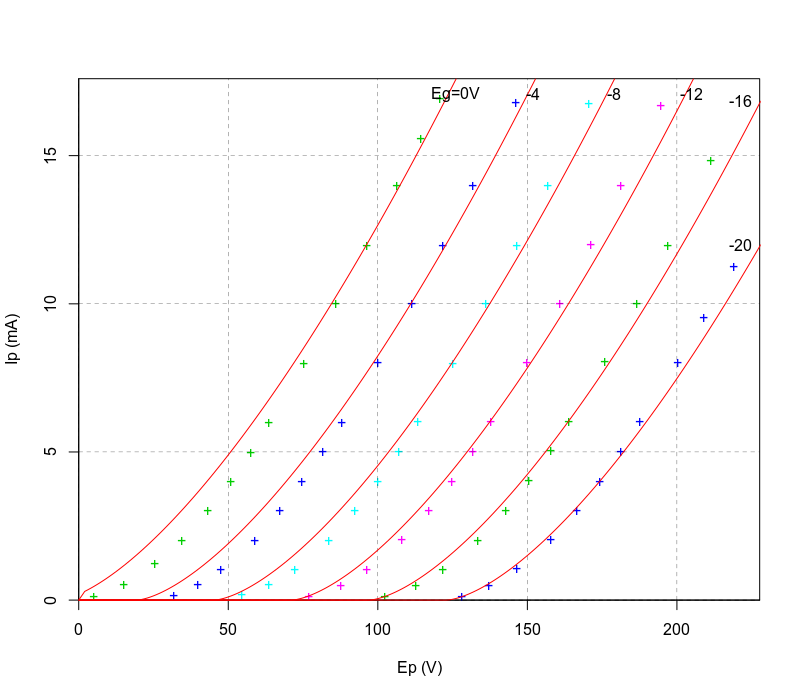

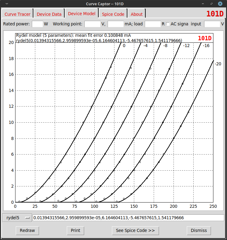

On the road now... creating triode models for most tubes is pretty straight forward, anyone can do it... I recommend CurveCaptor for those not using Ayumi’s pcTube software.
101D LTspice models
Please so kind and help me:
I looking for a SPICE model for 101D DHT tube, if someone have prease share with me.THX
Code:
* 101D LTSpice model
* Rydel model (5 parameters): mean fit error 0.100848mA
* Traced by Wayne Clay on 02/15/2019 using Engauge Digigtizer and
* Curve Captor v0.9.1 from Western Electric data sheet
.subckt 101D P G K
Bp P K I=
+ ((0.01394315566m)+(2.959899593e-05m)*V(G,K))*uramp((6.164604113)*
+ V(G,K)+V(P,K)+(-5.467657615))**1.5 * V(P,K)/(V(P,K)+(1.541179666))
Cgp G P 7.1p ; 0.5p added (6.4p)
Cgk G K 4.9p ; 0.5p added (4.4p)
Cpk P K 3.4p ; 0.5p added (2.9p)
Rpk P K 1G ; to avoid floating nodes
d3 G K dx1
.model dx1 d(is=1n rs=2k cjo=1pf N=1.5 tt=1n)
.ends 101D

What happened? 6.4+0.5=6.9 not 7.1 😀
Corrected below.
Corrected below.
Code:
.subckt 101D P G K
Bp P K I=
Cgp G P 6.9p ; 0.5p added (6.4p)
d3 G K dx1
.ends 101D
