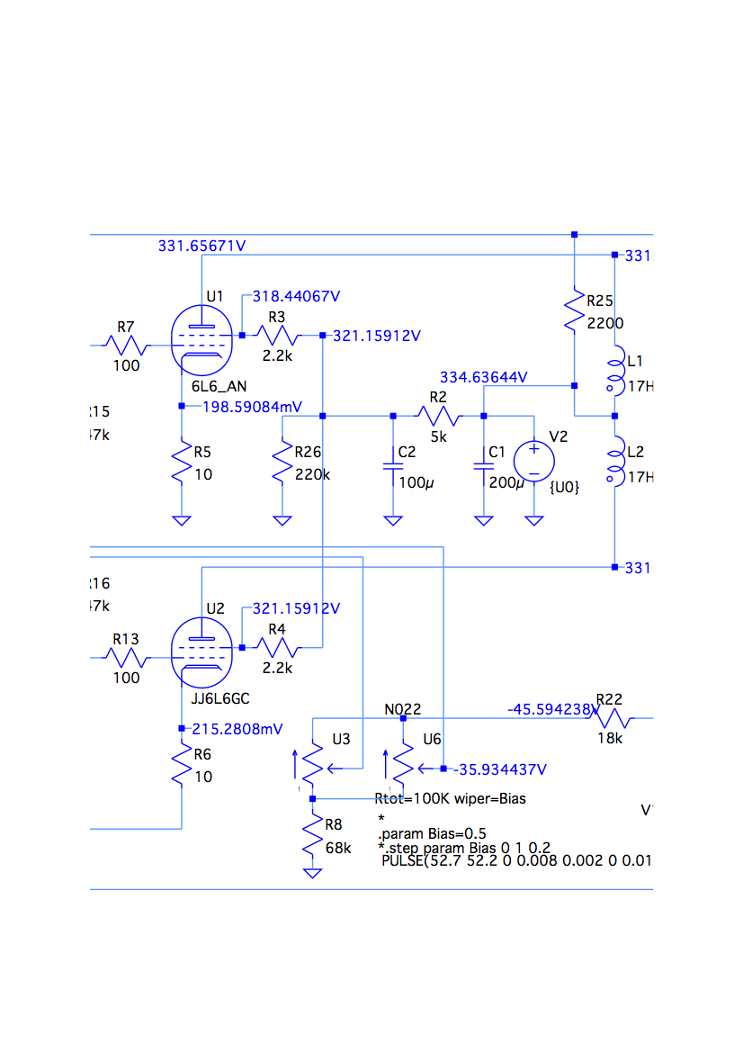

Hello,
in the example below You see a stage with two 6L6GC in push pull. The upper tube is modeled using the Ayumi model, the lower tube is done using a Koren model modified with µ-Tracer data. Only .OP analysis is done. Please note the voltage directly at G2: at least in the .OP simulation there is obviously no G2 current or an extremely small one with the Koren type model.
The .TRAN simulation does, however, show at least roughly plausible values of G2 if You check them with .MEAS commands.
So far, so good. Unfortunately the Ayumi models are computionally extremely expensive and can therefore not be used in general design work, but just "as the last step".
So there is the question if there exist other computationally lightweight models which come a bit closer to reality than the (otherwise useful) Koren models?

Well the Ayumi model seems good, except of the computational effort. The Koren model is the problem.
And what takes seconds with the Koren model might take minutes using Ayumi model (-> LTSPICE OSX), especially if i run the model close to the clipping point.
Hi Bea
Nice to meet you again, for this time on the diyaudio site ;-)
You now, Norman Koren did not spent much effort to model accurate grid currents...
Why not try the Duncan Munro model? It is also fast (as it was also developed in the past century with its slow clocked computers), and (more or less) accurate grid currents was a high priority goal for Duncan.
Pentodes
all the best, Adrian
P.S: Be aware that the Ayumi models deliver a better overall fit quality!
Hello Adrian,
thanks! Of course i am aware that the Ayumi models are good fit quality. But the can be annoying, especially if You want to do fine tuning by trial and error. (And i've observed occasional convergence problems using the Derk models i have also tried out.) BTW
Hi Bea
Occasional convergence problems of Derk models may have the root cause in the fact that they are able to mimic secondary emission effects. That means that there are probably negative differential resistances, introducing a risk for oscillations in real life or convergence problems in simulations.
... Unfortunately the Ayumi models are computionally extremely expensive and can therefore not be used in general design work ...
never experienced anything like taking minutes ... not even with my oldest Pentium 4 2GHz single core and even less so with modern 8-core 4-GHz hardware;
anyway, could it be that you use .step commands in your "general design work", maybe multiple nested ones ?
if you could post a complete .asc file (without your secret ingrediences of course) including model file we could try to douplicate your results and find a way to tune the LTSPICE setup

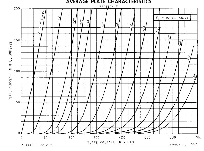

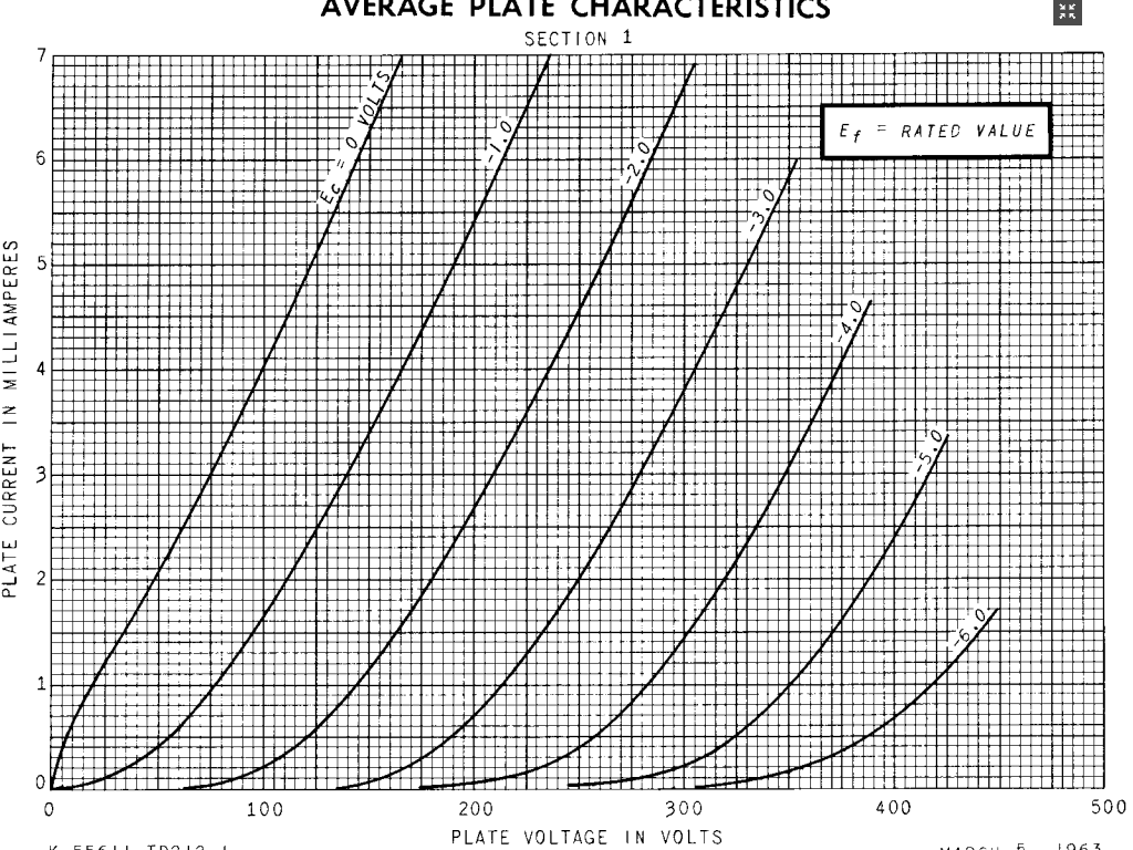

6FM7 compactron with two dissimilar triodes
#1: small signal mu=66
#2: vertical output 10W plate
can't find any Spice models anywhere ... appreciate volunteer with the necessary tools
here's datasheet: http://frank.yueksel.org/sheets/123/6/6FM7.pdf
curves attached (attention, there is an awkward intermediate at -25v in the 2nd)

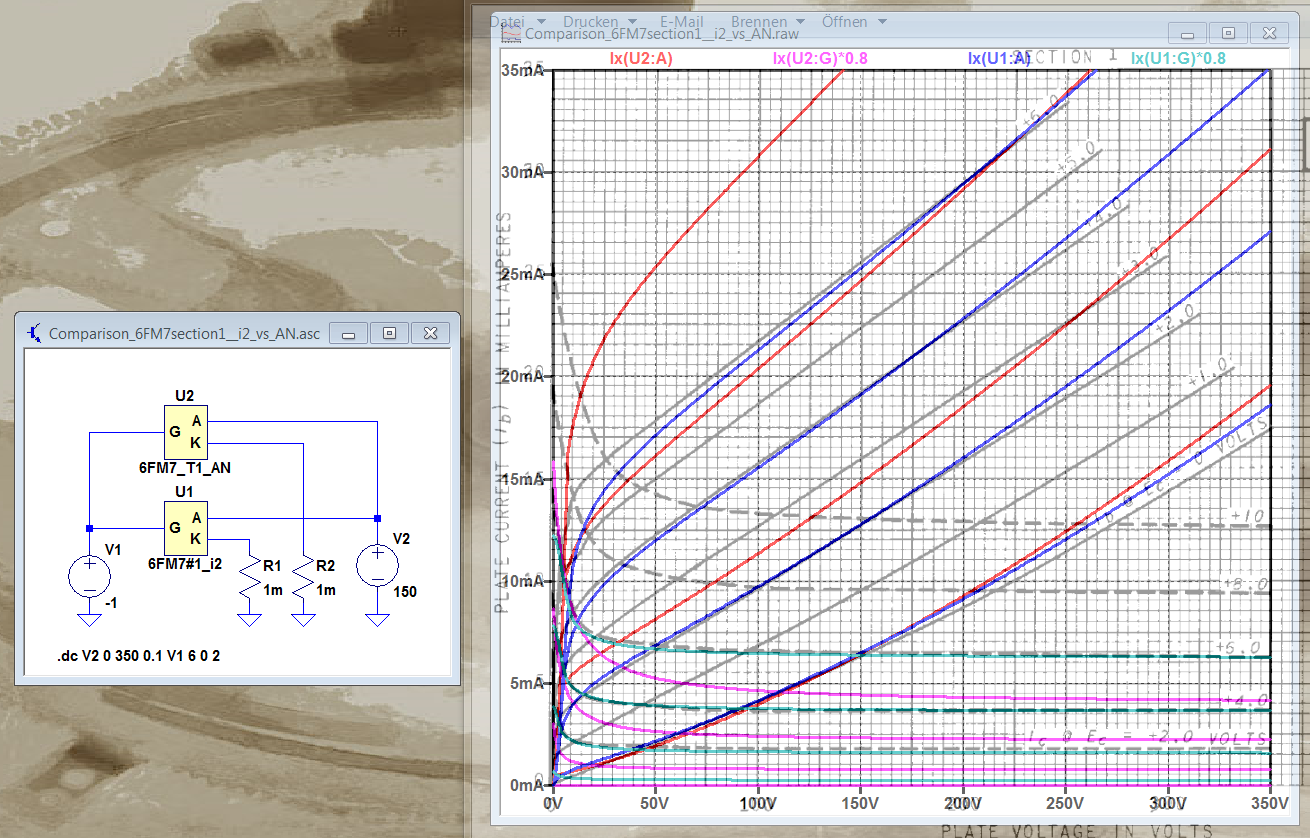

Hi Sorento
You will find the 6FM7 (section1) spice model on my website:
http://adrianimmler.simplesite.com/440956786
Same to the graphs, showing the achieved fit quality.
PS: The datasheet does not contain any grid current traces for the section 2 triode, so I decided to not fit this section (as I don't want to provide a model with perhaps "wrong" Ig behavior)
PPS: Please note that the grid current scale is different to the the anode current scale. I managed that by multiplying the grid current by 0.8 in the LTspice graph.
kind regards, Adrian
Thanks Adrian, merci, vielen Dank.
Unfortunately the # 2 is the 10W power section and quite interesting.
As I do not plan to work in the grid current region I could do without ...
So still interested in any model of section 2, albeit incomplete.
What about a P.M. ?

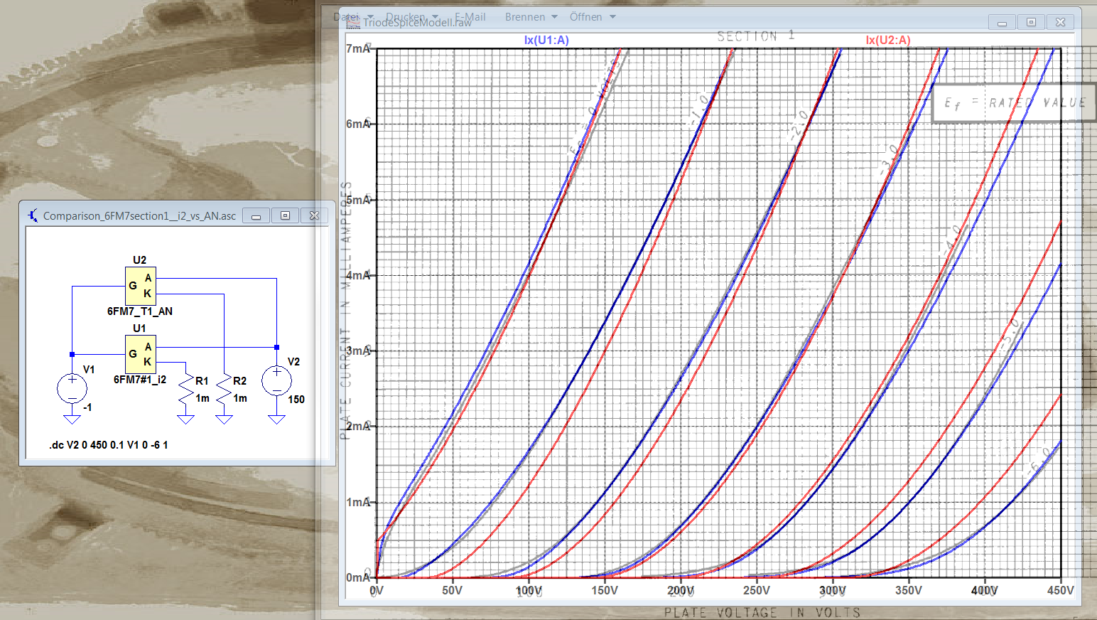

Hi all
As we have now tow different 6FM7#1 approaches made from the same datasheet, it is a good occasion to compare to see where their strengths/weaknesses are.
calculation performance:
6FM7#1_i2: 8.85s for 585k working point calculations
6FM7_T1_AN: 6.64s for 585k working point calculations
=> winner is 6FM7_T1_AN
accuracy:
see attached images
=> winner is 6FM7#1_i2 (especially for pos. Vg)
