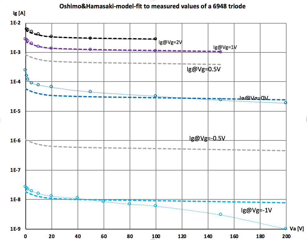

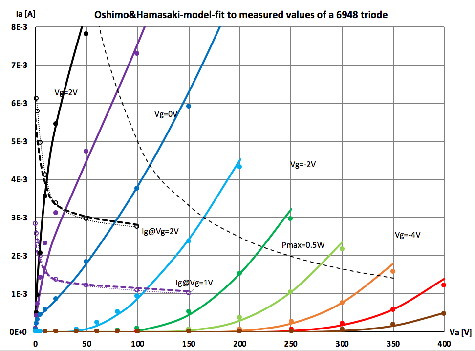

Hi all,
to satisfy my commitment I have given in #1895, here is the short comparison of the Oshimo & Hamasaki triode model vs. my generic approach. Both model were introduced in Oct 2018 and are able to mimic also the initial velocity grid current.
fit quality:
the O&H model need 17 parameters and is able to deliver a good fit quality, I would say similar the the Cohen & Heile model (12 parameters), but not as precise as my approach (14 Parameters).
See attached graphs.
calculation speed
the O&H model is around 20% faster than mine, and comparable to Ayumi's model.
parameter independence
the O&H model suffers under strong parameter interactions, making it difficult to find good fits. The least mean square method seldom delivers good results with this model, you better do that manually.
convergence performance
The main problem of the O&H model is, that the Ia-traces for positive Vg do not inherently cross the origin of the Ia and Va axes. It is a manual playing with the parameters to ensure this. When this task is not made proper, a Vg increase could lead to Ia reduction at certain working points, leading to convergence problems.
This is solved much better it most triode spice approaches, including mine.
all the best, Adrian

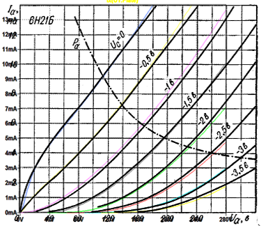

There it is:Cool, thank you rankot!
Do you also have a graph of the fit quality?
I think it's pretty close 🙂

...and rankot, you did a very good job for your 6h21b model, congratulations!
