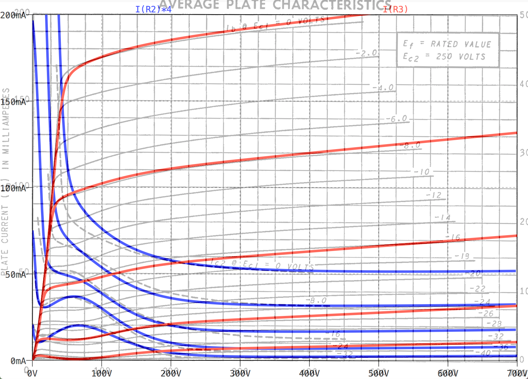

New generic Spicemodell copes secondary emission!
Hi all
One year after my introduction of new precise vacuum diode and triode spice models, I'm proud to present my new generic pentode model which is capable to mimic the secondary emission effect.
It has its roots in Derk Reefmans approach to describe this effect, but is highly improved to get the related parameters independently. 😀
As a first tube, i fitted the 6L6GC based on the GE datasheet.
You will find the spice code here:
http://adrianimmler.simplesite.com/440956786
all the best, Adrian
